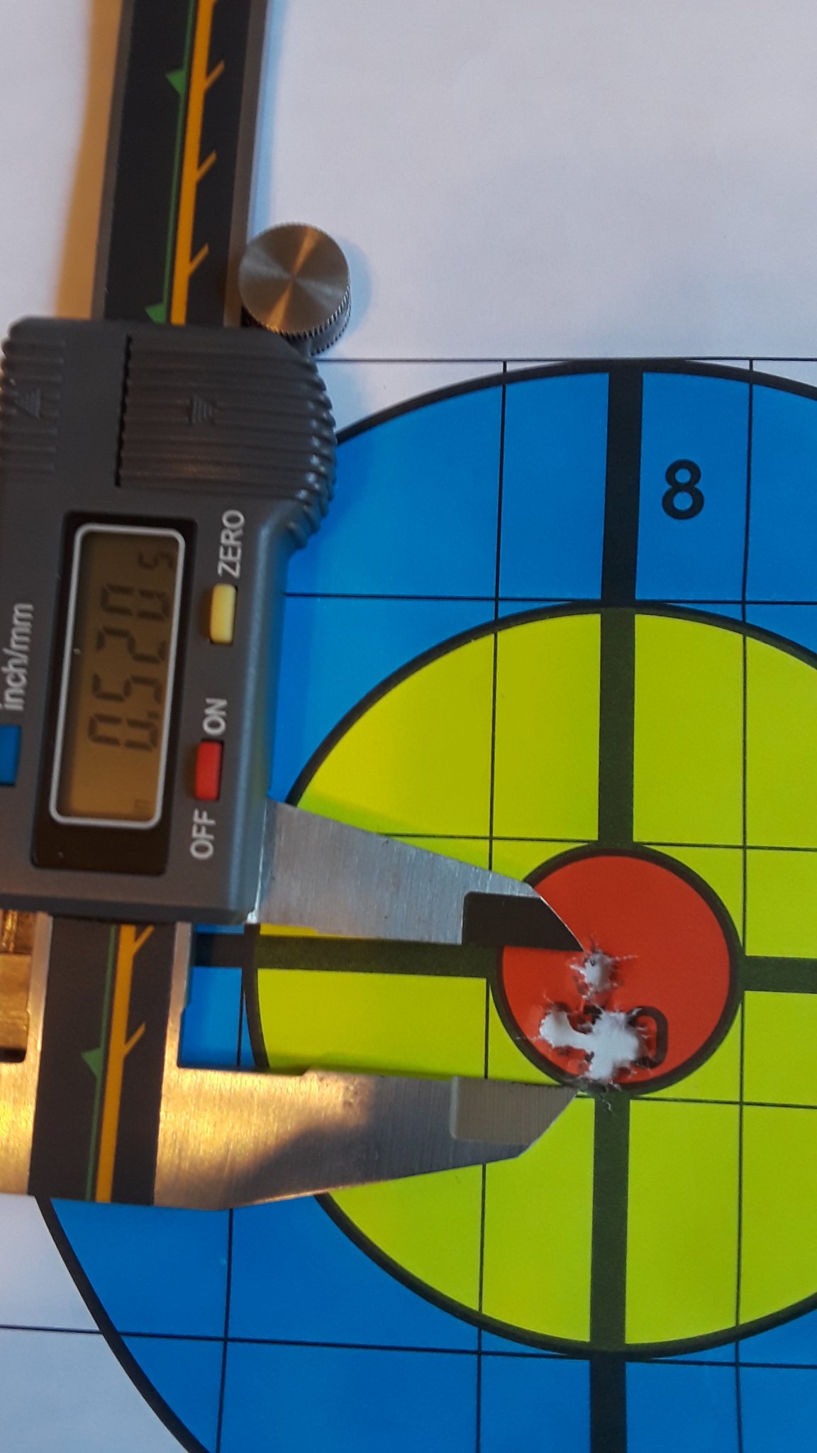

I've taken my Vudoo V-22 out 3 times now to shoot targets in the desert. The first time out was to zero the scope and plink at relatively large plates at 50 yards. The last 2 times out have been with my wife to shoot at a KYL rack whose plates range in size from 2' - 1/4' in 1/4' increments. I've been shooting bulk Federal ammo that I think ran me like $0.08/round. Based on what I've learned shooting this ammo, it is about 2 MOA in my rifle. I base this on the fact that I can hit the 1" gong consistently 9 out of 10 times at 50 yards with this ammo. I hit the 3/4" plate on average 6 out of 10 shots. My question is this; what do I gain by shooting more expensive ammo to aim at smaller plates achieving a higher hit percentage due to lower bullet dispersion? If the objective is to develop fundamentals including loading the bipod, being centered behind the scope, trigger release, follow-through, etc., do I not achieve all of those things shooting at a 2 MOA target knowing that that's the capability of the ammo and thus, the system? What do I really gain shooting more expensive ammo in a non-competition scenario? I'm not against more expensive ammo, I have a bunch of it sitting here waiting on field testing. It just seems to me that it is better to use the better ammo when it matters. Thoughts?
Let me put a little context to the question. I built a .308 several years ago when I gained an interest in long range/PRS type shooting. I had a Remington 700 SA trued by a gunsmith and had him install a HV Bartlein barrel on it. I installed the barreled action into an XLR Element chassis and mounted a USO LR-17 scope on it. With that rig and my handloads, I could hit a 2 MOA target at 750 yards 9 out of 10 times from the bench using a bipod and bag (on low wind days). At 100 yards (again from a bench using a bipod and rear bag) I could consistently print 5/8"-3/4" 10 shot groups. So, for me, that's what my personal level of precision is at with that rifle and handloads. What I have not done is spend a lot of time behind a rifle shooting on the ground, prone, or from other improvised positions. The time needed to handload and the expense of the rounds made me pause to send 100 rounds down range practicing on any given weekend. That was THE motivating factor in purchasing a Vudoo V-22. It has all the big rifle ergos and I can shoot it at a very reasonable cost with out the need to reload. So now, I can send 200 rounds down range in an afternoon and not even blink. What I'm trying to do here is maximize the usefulness of my time behind the trigger. I'll be the first to say that I need to work on fundamentals. That's what I'm doing now with the Vudoo, and that is what led me to post the original question. Do I not get value in shooting at a 2 MOA target with ammo that is 2 MOA capable? Does that not benefit me as much as shooting 1/2 MOA ammo at a 1/2 MOA target? The fundamentals are the same regardless of which ammo I am shooting.

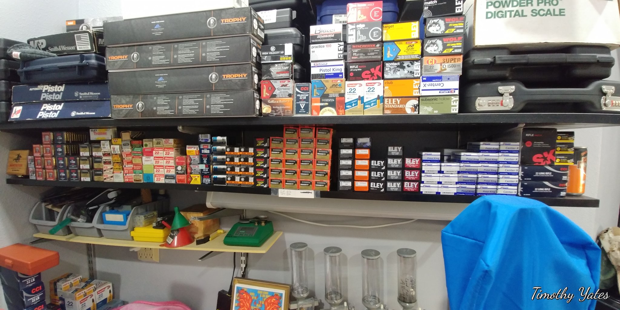

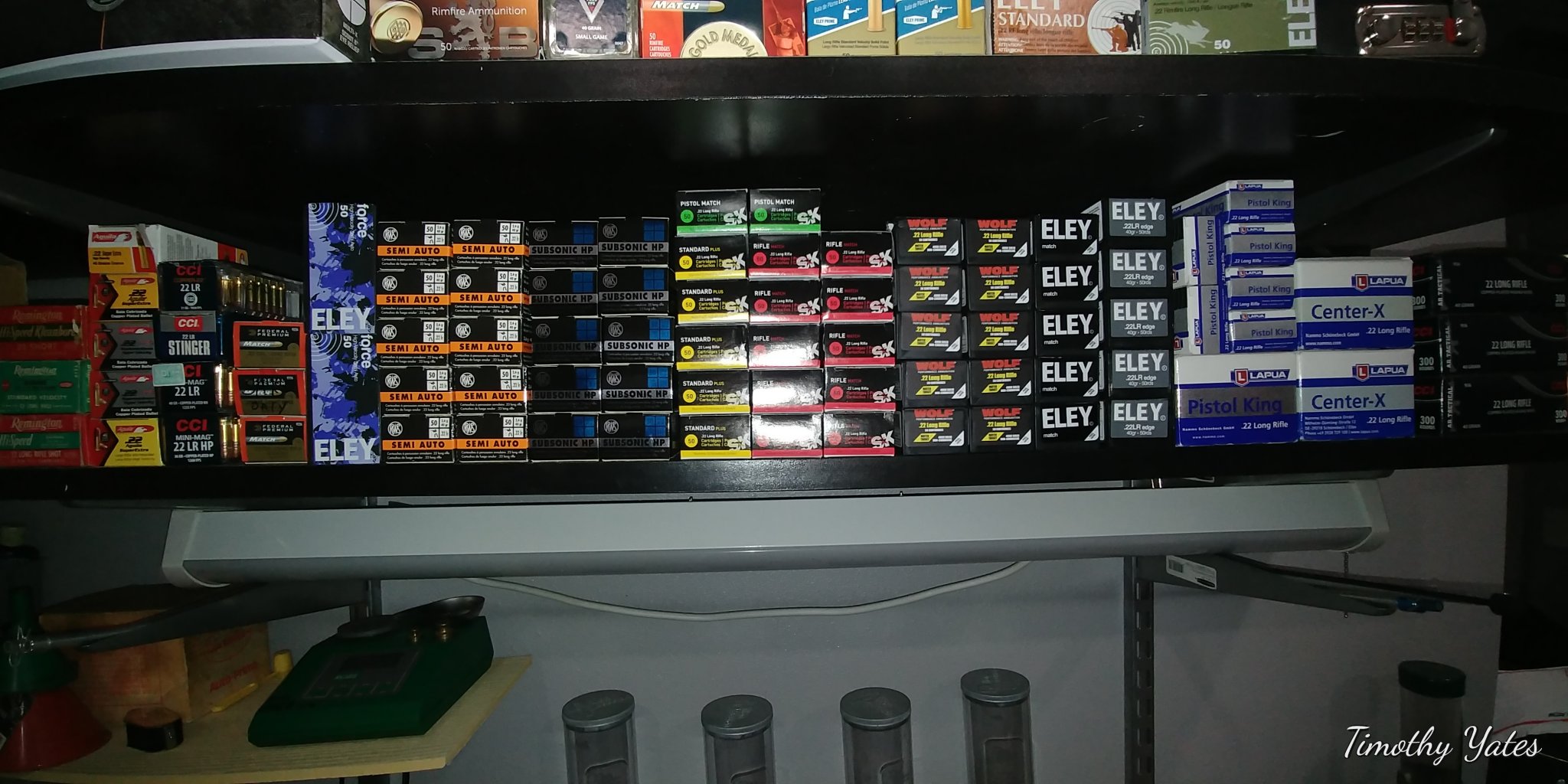

I keep a fair bit of federal blue box Ammo around in all calibers that I have just for practice. I find it shoots accuratly enough in my guns that it makes for good comparison. No reason to go shoot off a 40 dollar box of Ammo when I can shoot off an 18-20 dollar box. I just picked up a case of it in 6.5cm for practice.

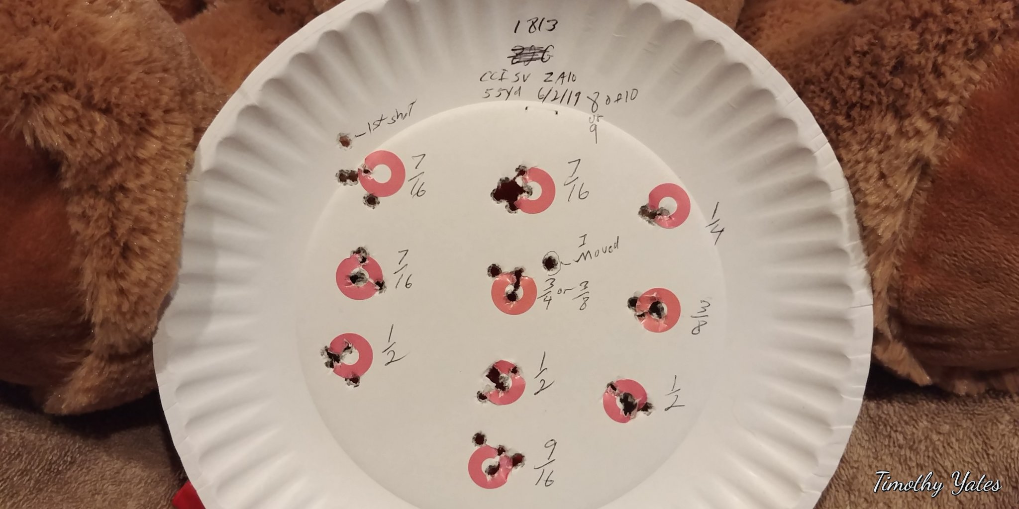

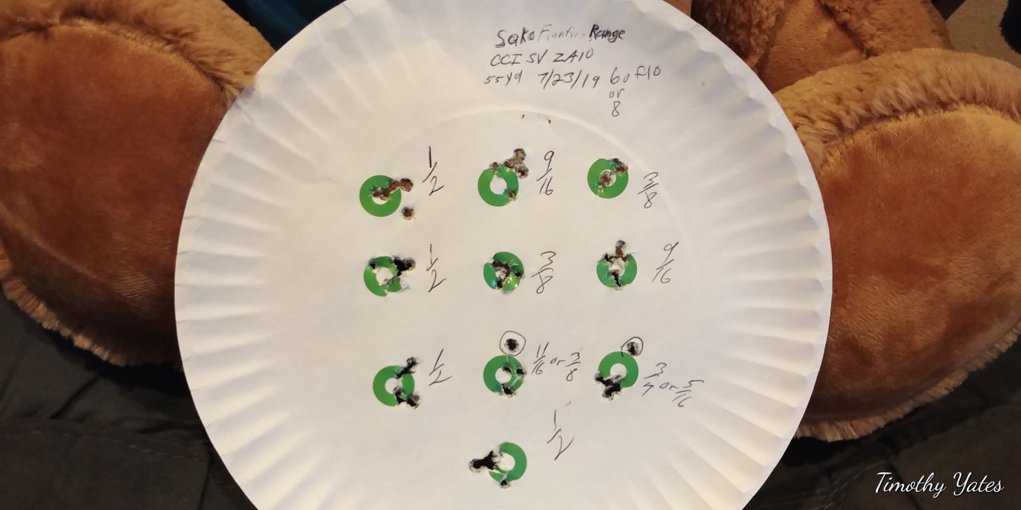

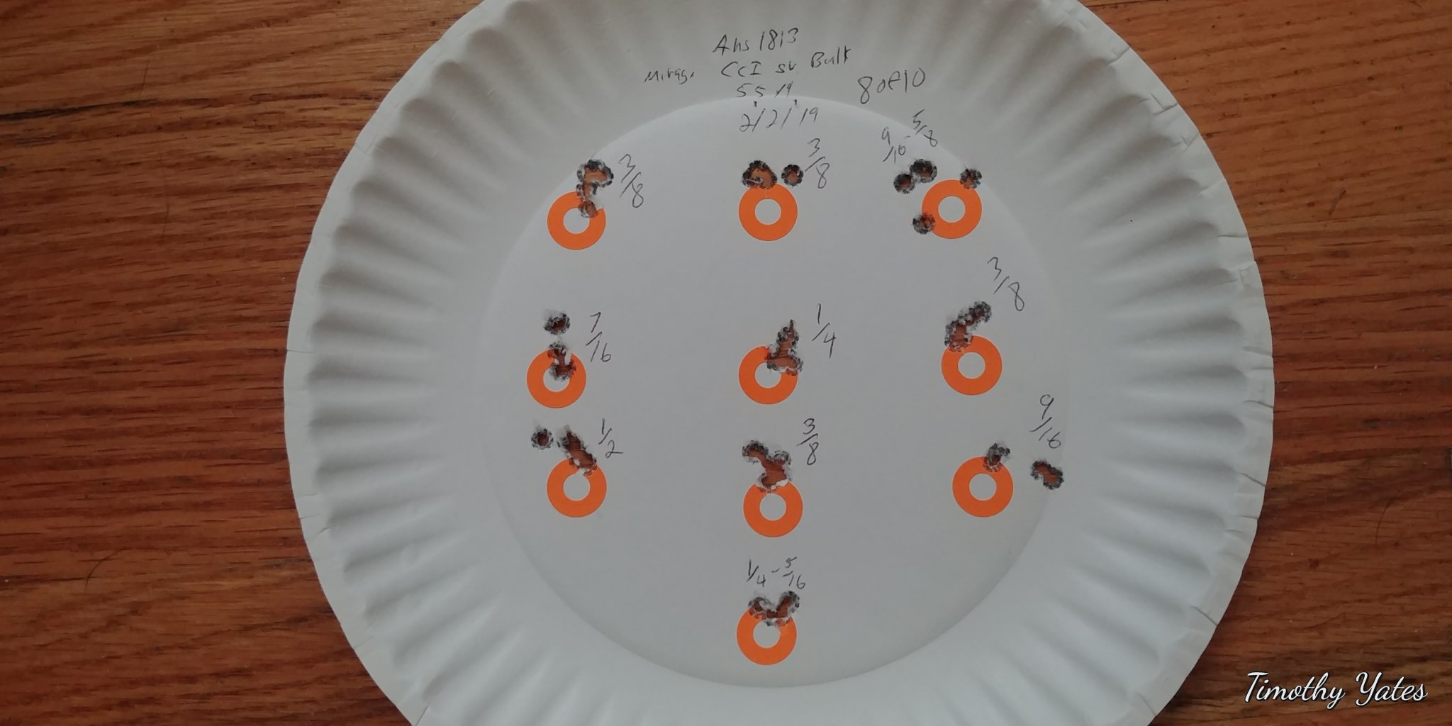

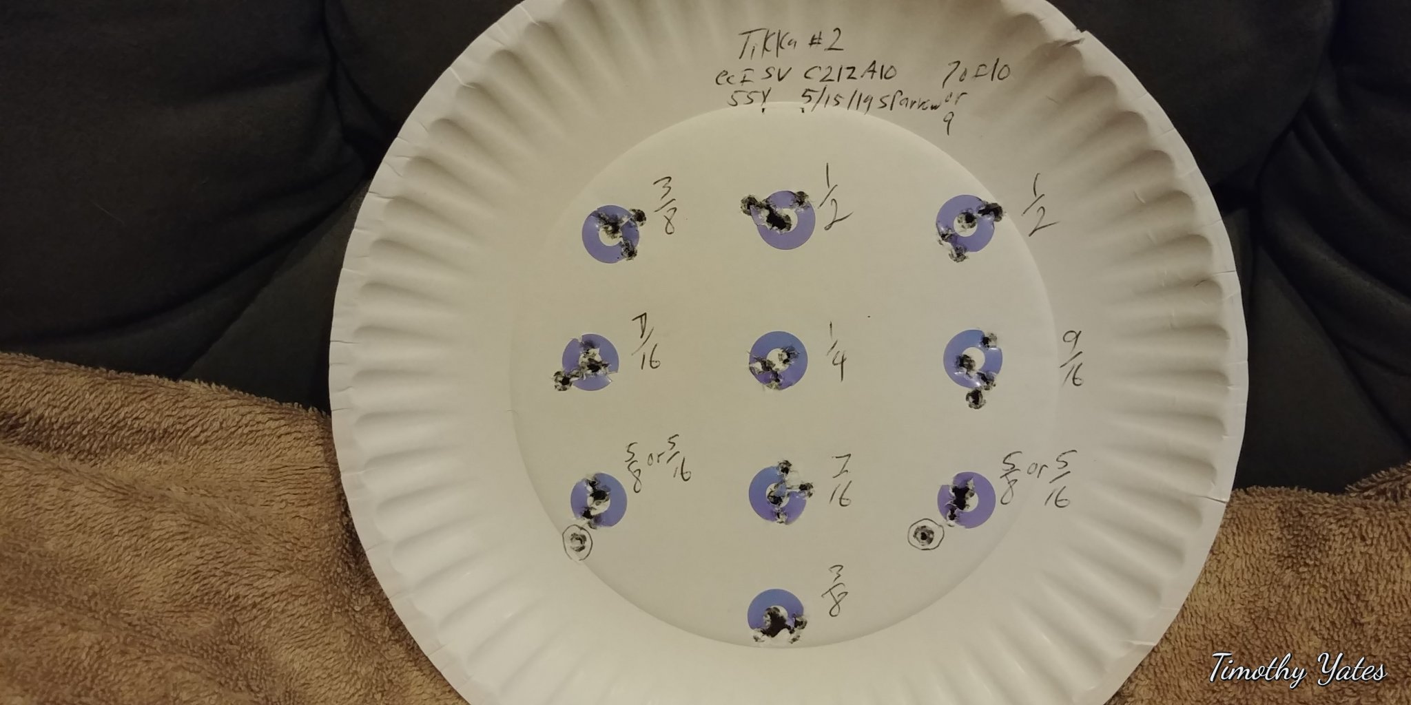

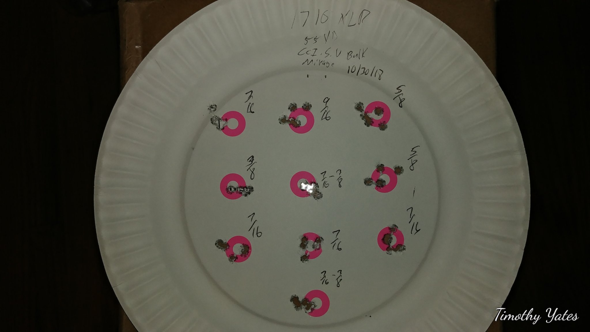

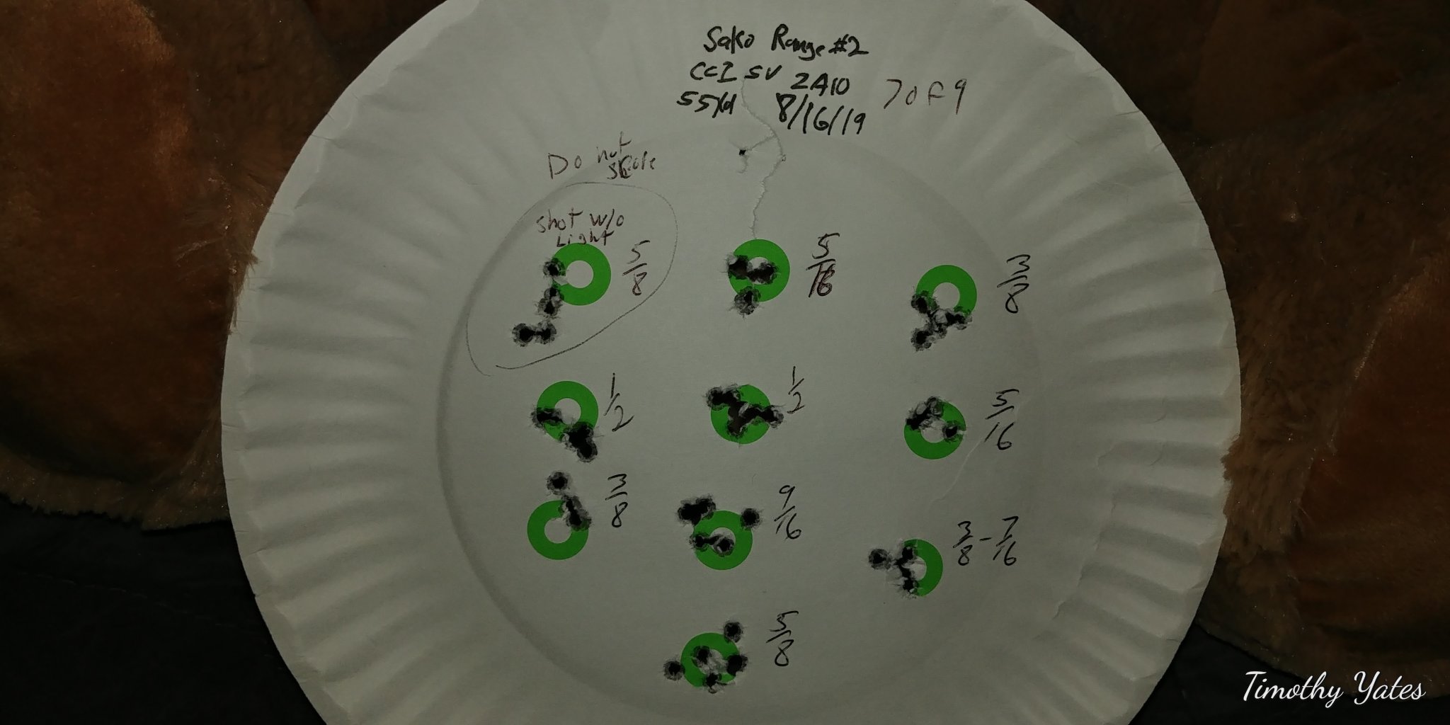

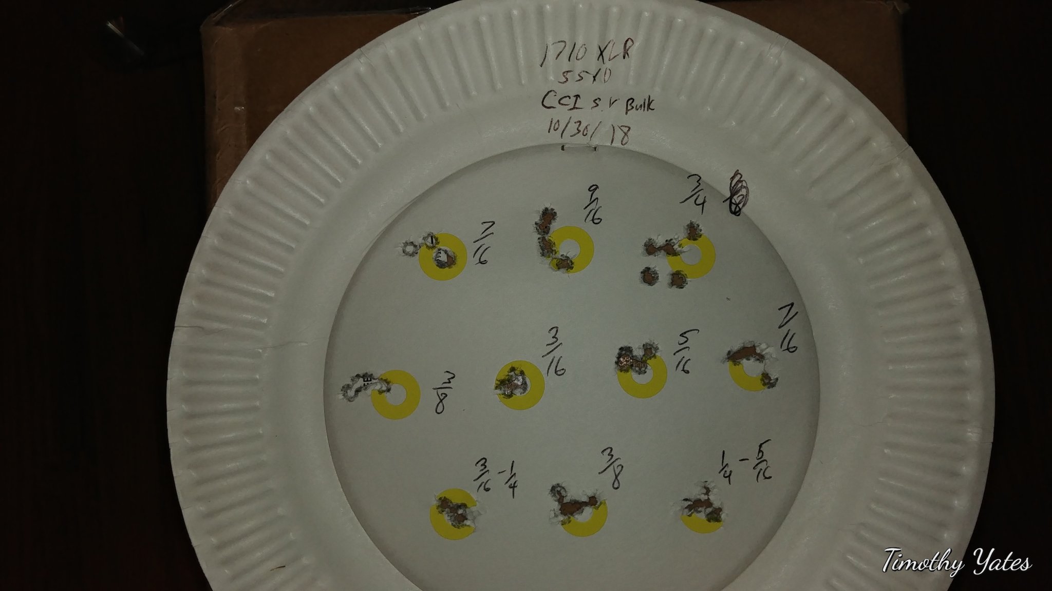

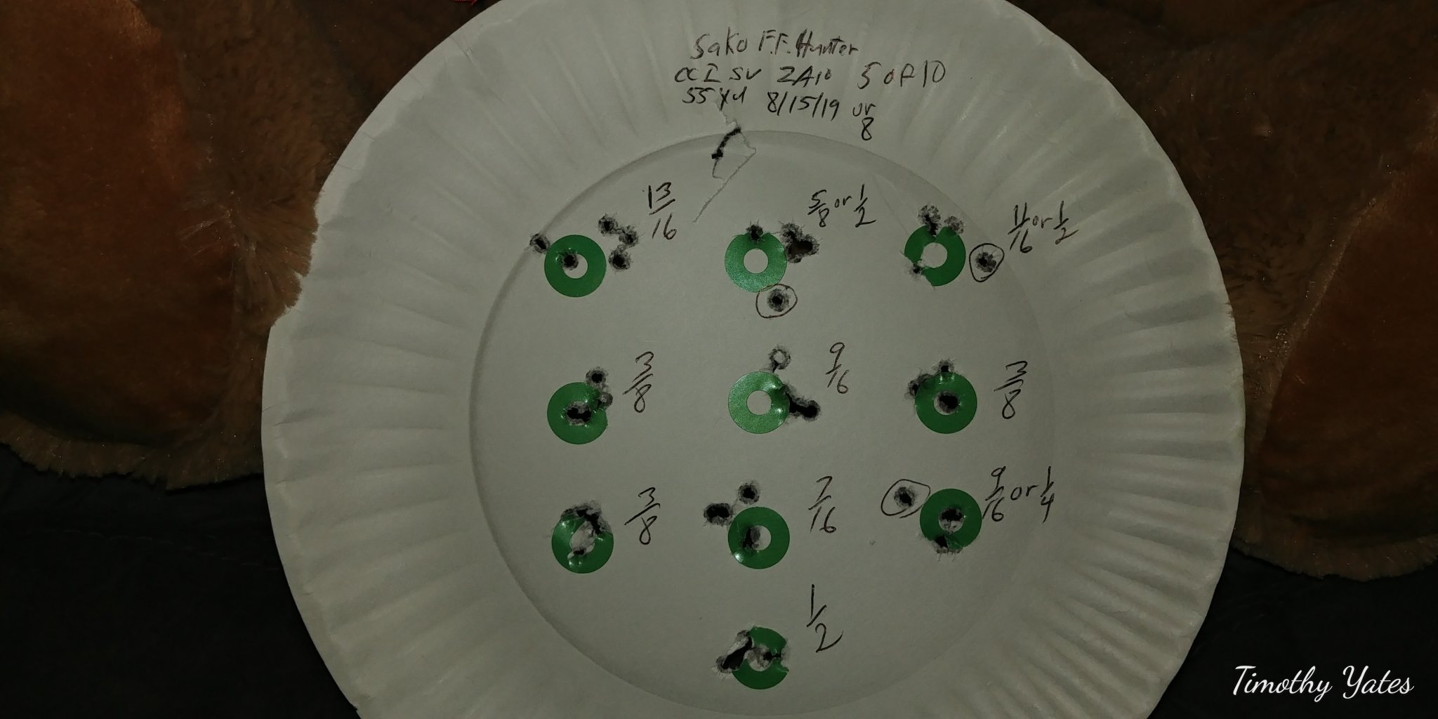

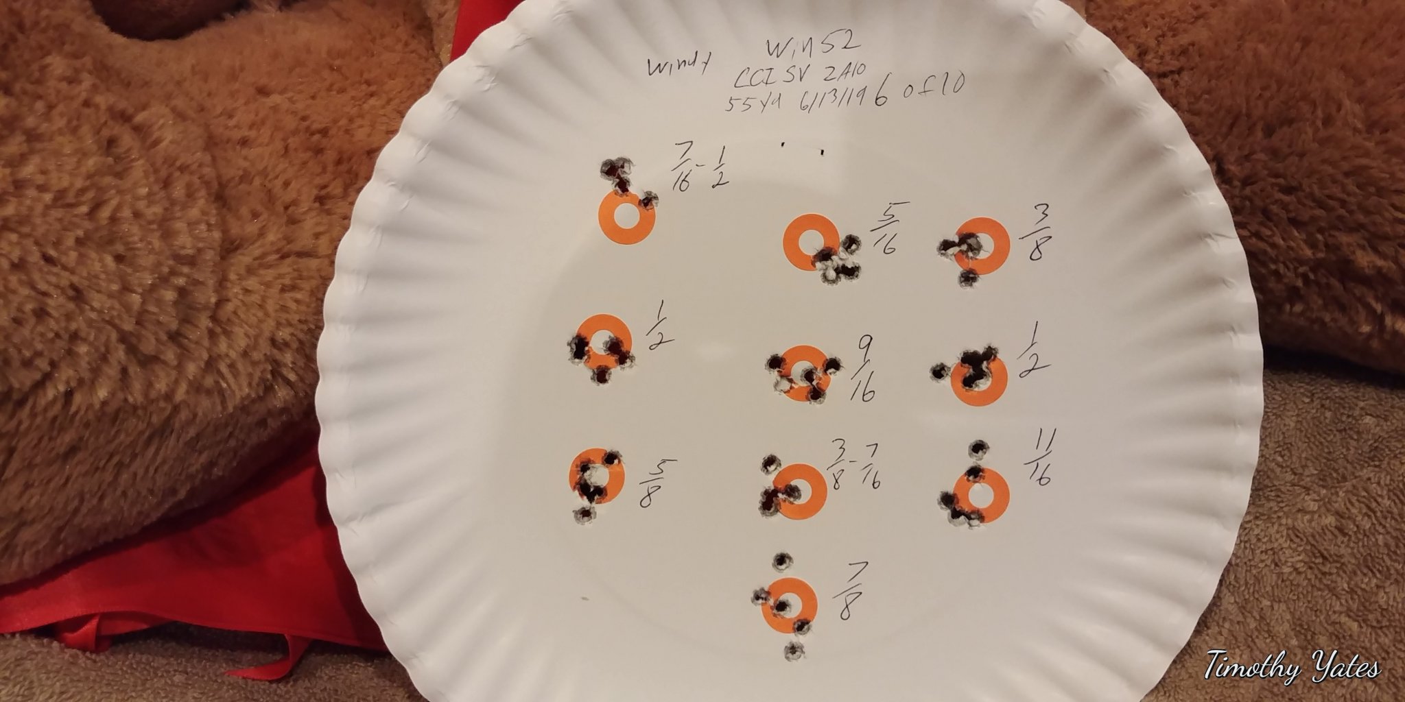

CCI SV is great ammo for the price. You should never have to pay more than $2.50 per box of 50. Awhile back, I bought 5 cases on GB for $200 shipped per case, I'm working out of my 4th case now.
Plus, how can you argue with results like this. Seven different rifles here. I know they are not one hole groups but these are real world results with $2/box ammo.

Forgot to mention, In barrels that matter, I never shoot copper coated bullets. Probably doesn't hurt but just call me superstitious.
