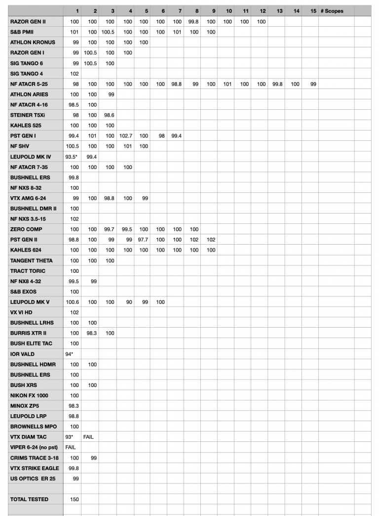

    Yeah, and guys started actually testing the scopes we use. I sold every Leupold I owned after I started testing my scopes. Low light performance, tracking, return to zero, etc. I couldn’t believe how poorly my beloved Gold Ring and Tactical Leupolds performed against competition that cost half as much.

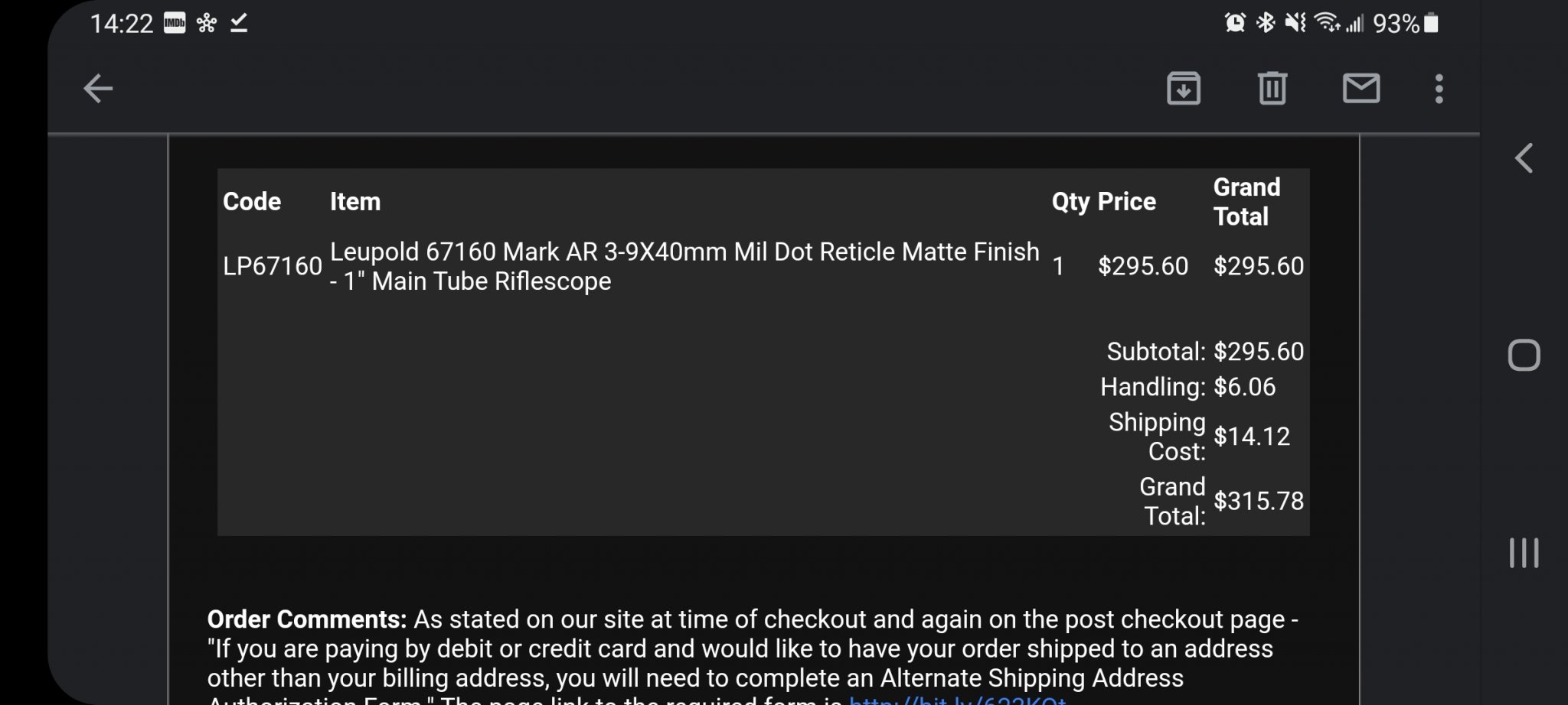

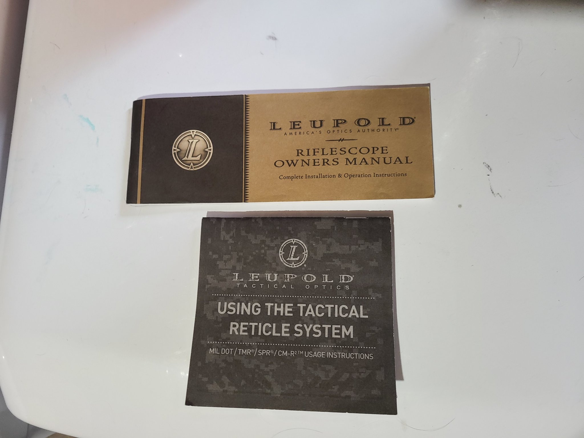

    I bought it when I didn't know any better in 2011. Still have the emailed receipt from Jan 23 2011.
    Still have everything but the box it came in.
    Just looked under the caps. 1/2 min windage. 1/2 MOA elevation and calibrated range for 55gr 3100fps 223. It is now only on my 22 til I upgrade.
    This stupid thing and this site led me to get my razor2 4.5-27 ebr7c. Only other optic I have is my strike fire red dot.
    Reactions: Sniperwannabee
    they set up alot of new shooters for failure with that scope. I shoot with a guy with the same scope, hes disappointed as well after figuring out what it means and the difference with mils and moa
    Shipmate, I am not following your graph?
    That was a tracking test done by Frank. 100 is perfect tracking over a 100 is over tracking under 100 is under tracking For elevation adjustments using your turrets.
    Reactions: godofthunder

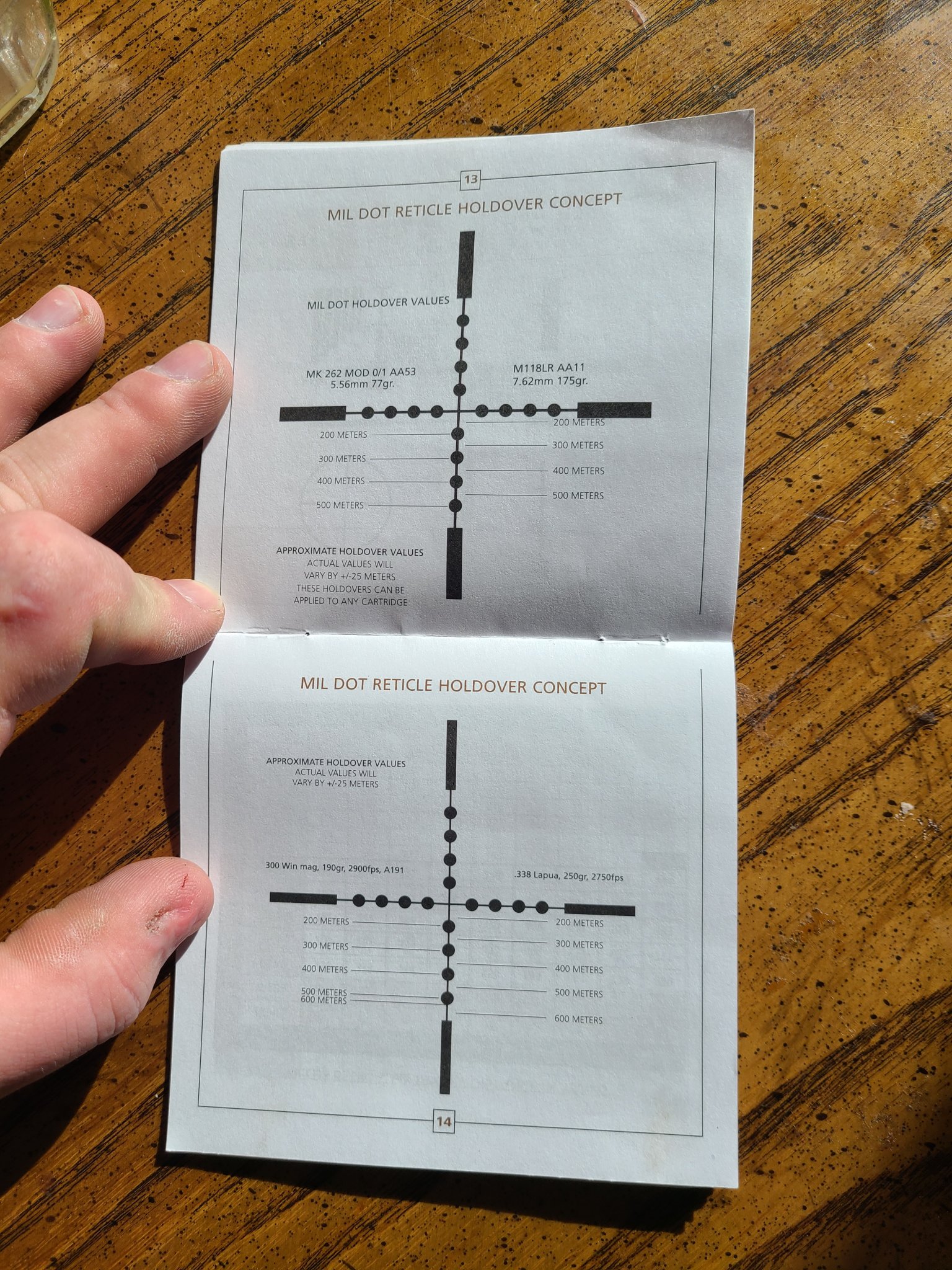

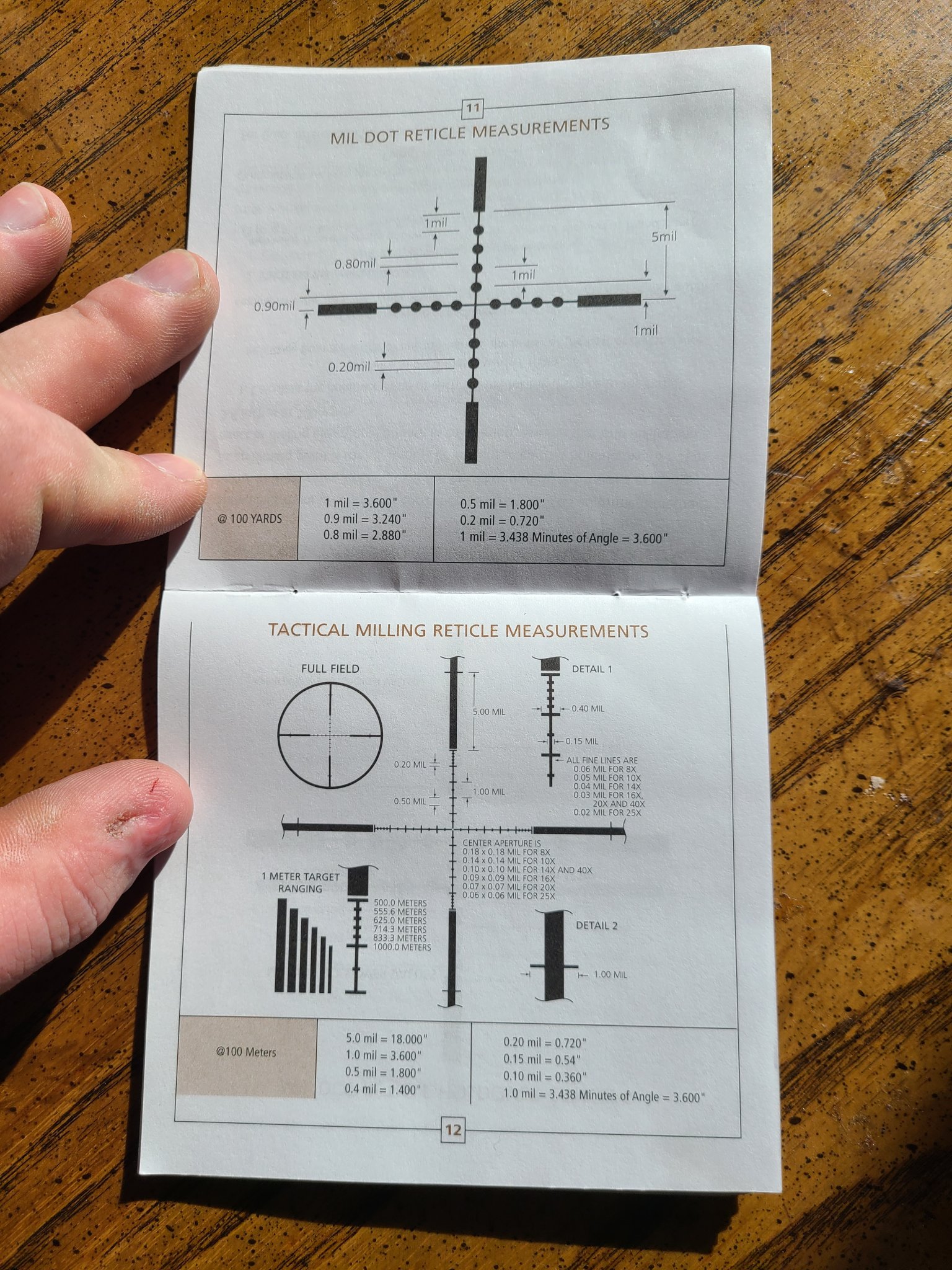

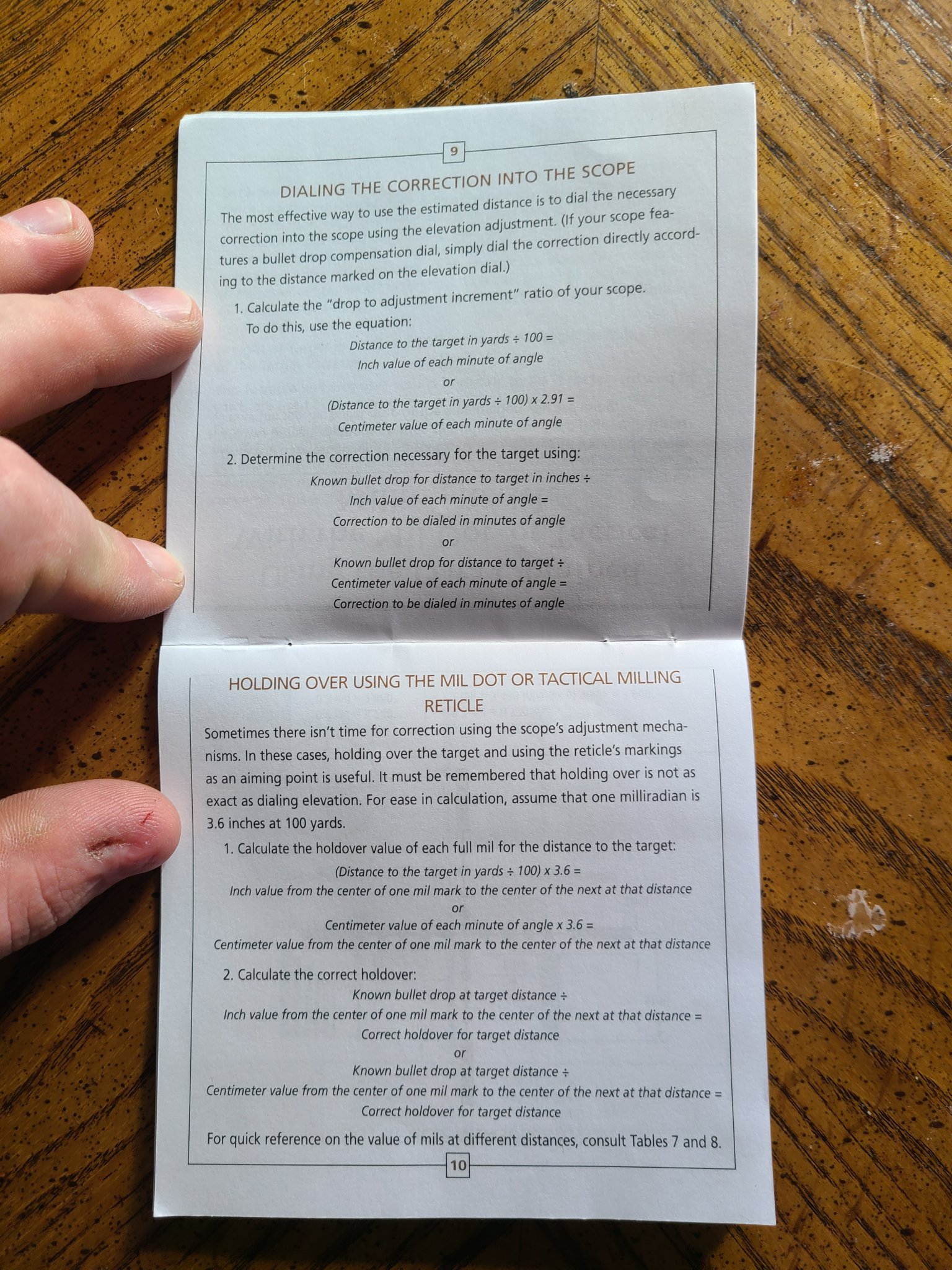

    Mil reticle and MOA turrets used to be normal around 2010 and the previous decade.
    Until the Vortex PST came out all of the major players scopes around that $1000 mark were mixed.
    All of the first scopes I owned were Mil reticles with MOA turrets, thank goodness I've sold them all over the years.
    Hmm I did not know that, seems very confusing
    I don’t even understand why they would do that and who would buy it????
    Because that's what the army wanted back in the late 70ies early 80ies and that's what they have run until prolly mid 2012ish. SF units obviously wised up sooner but yea...mil ret with moa turrets was the military norm until just recently brah.....flipping stupid.....
