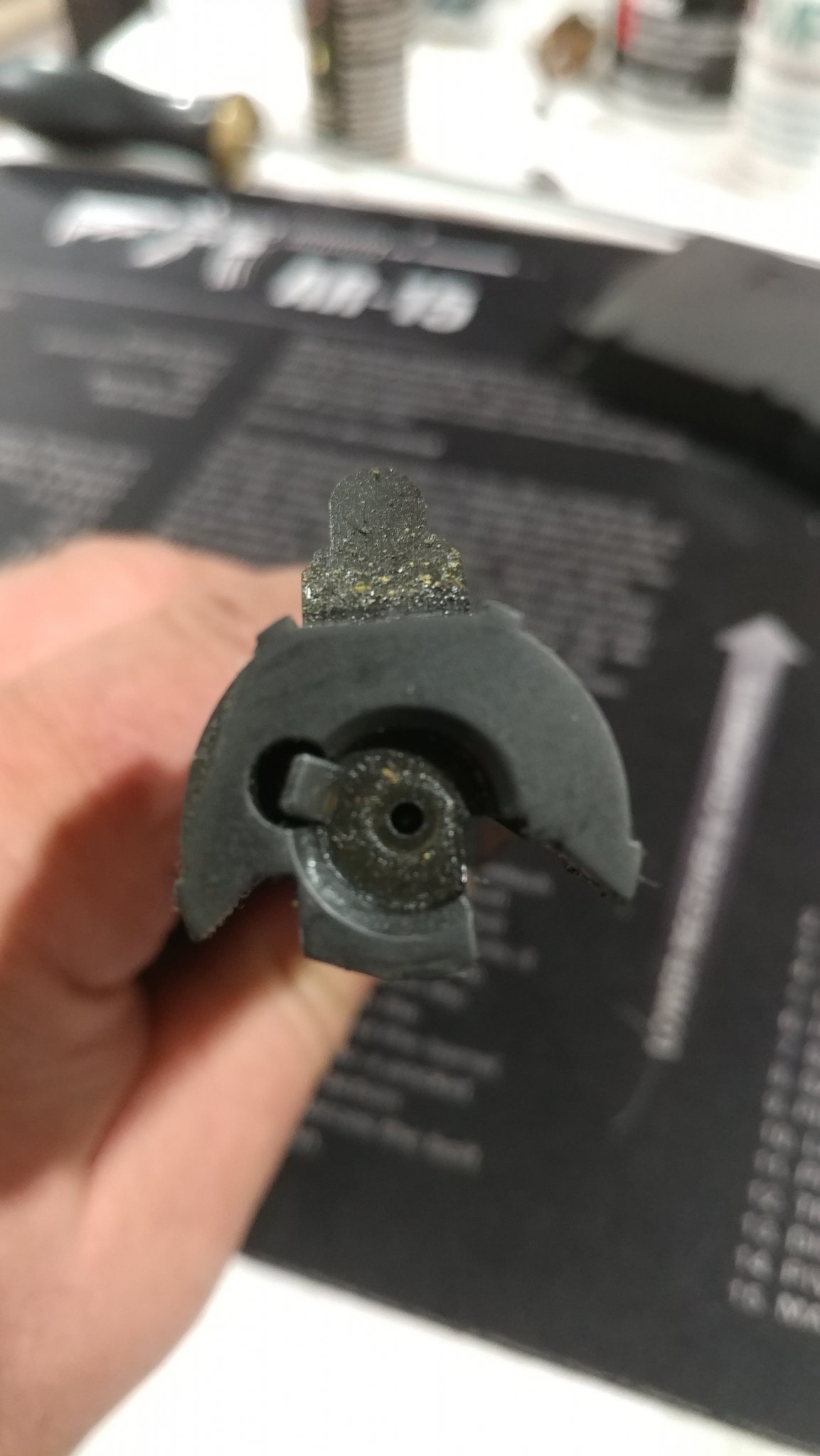

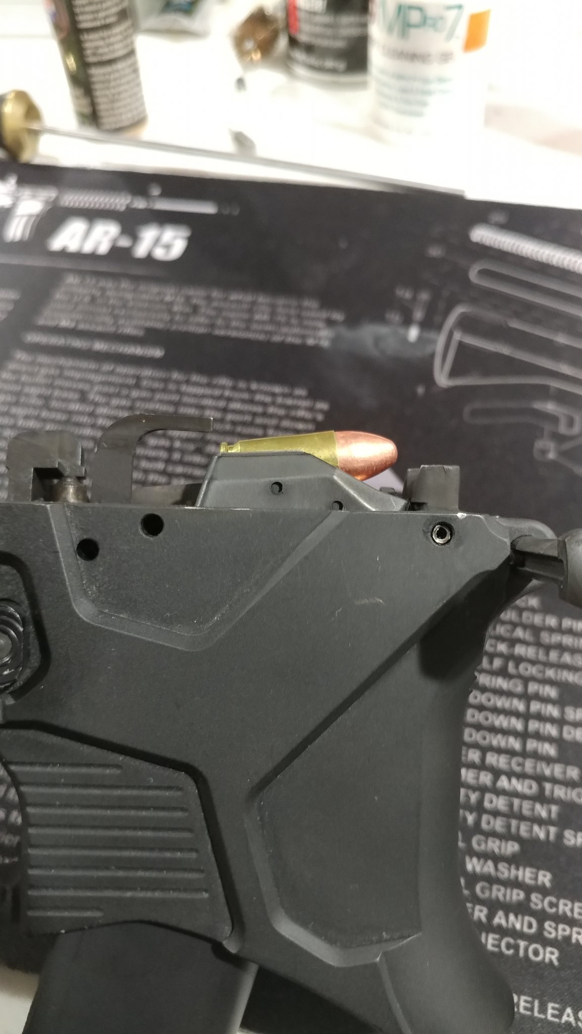

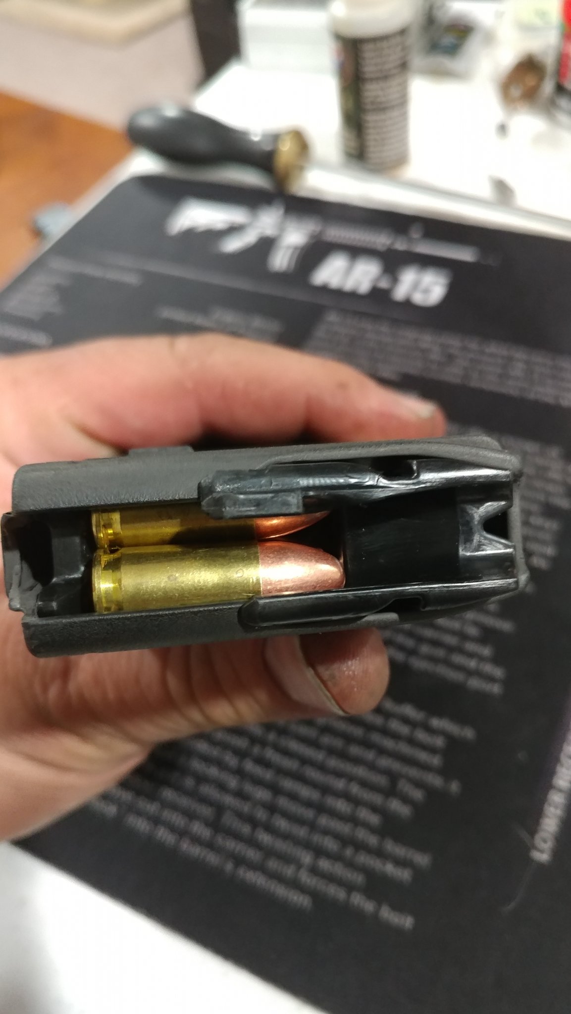

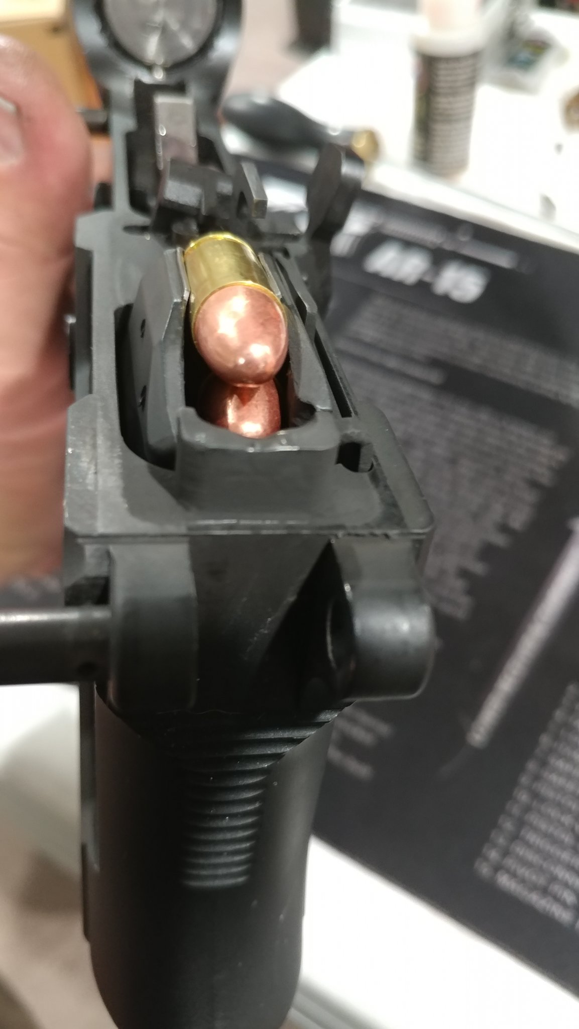

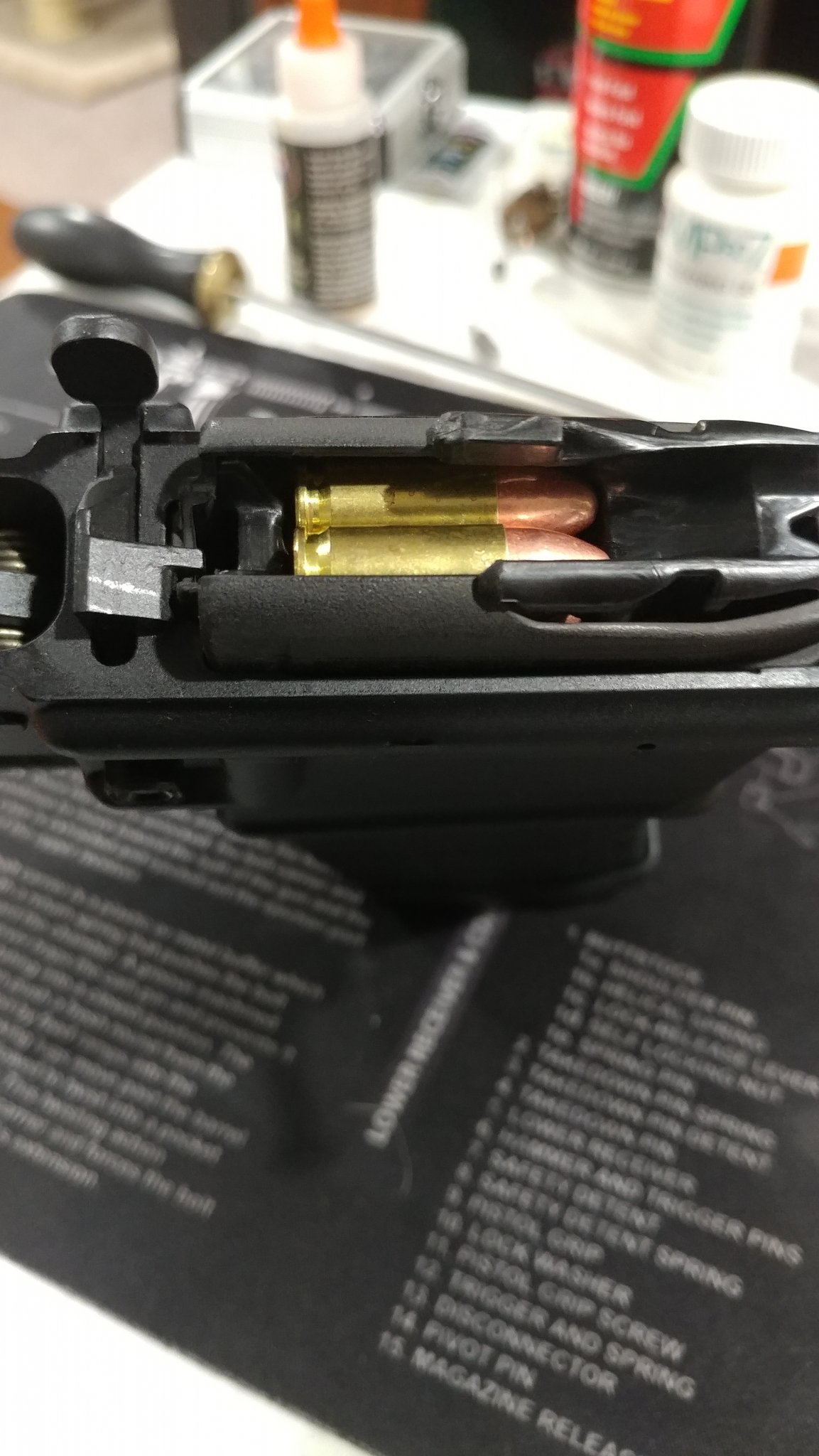

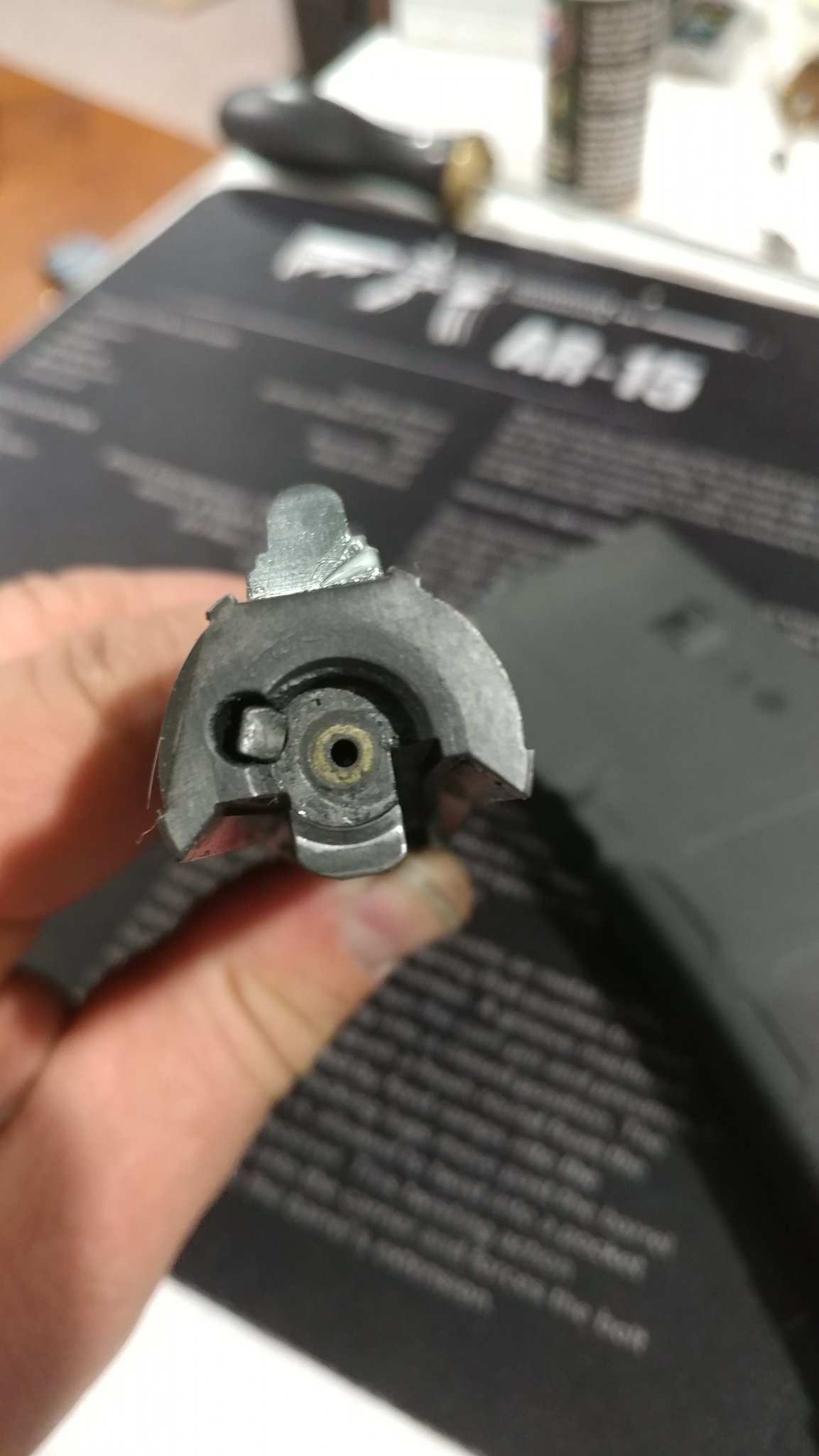

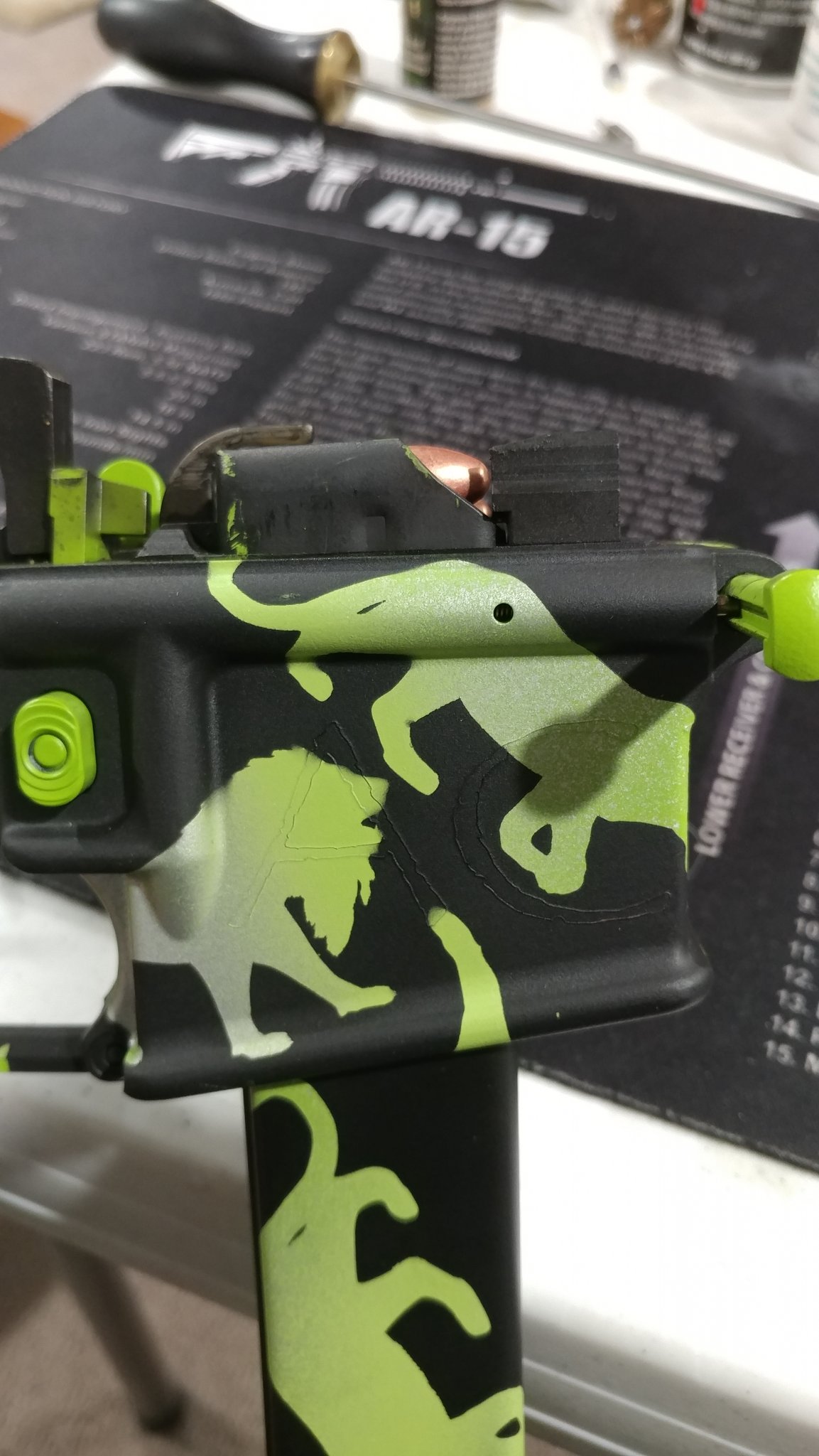

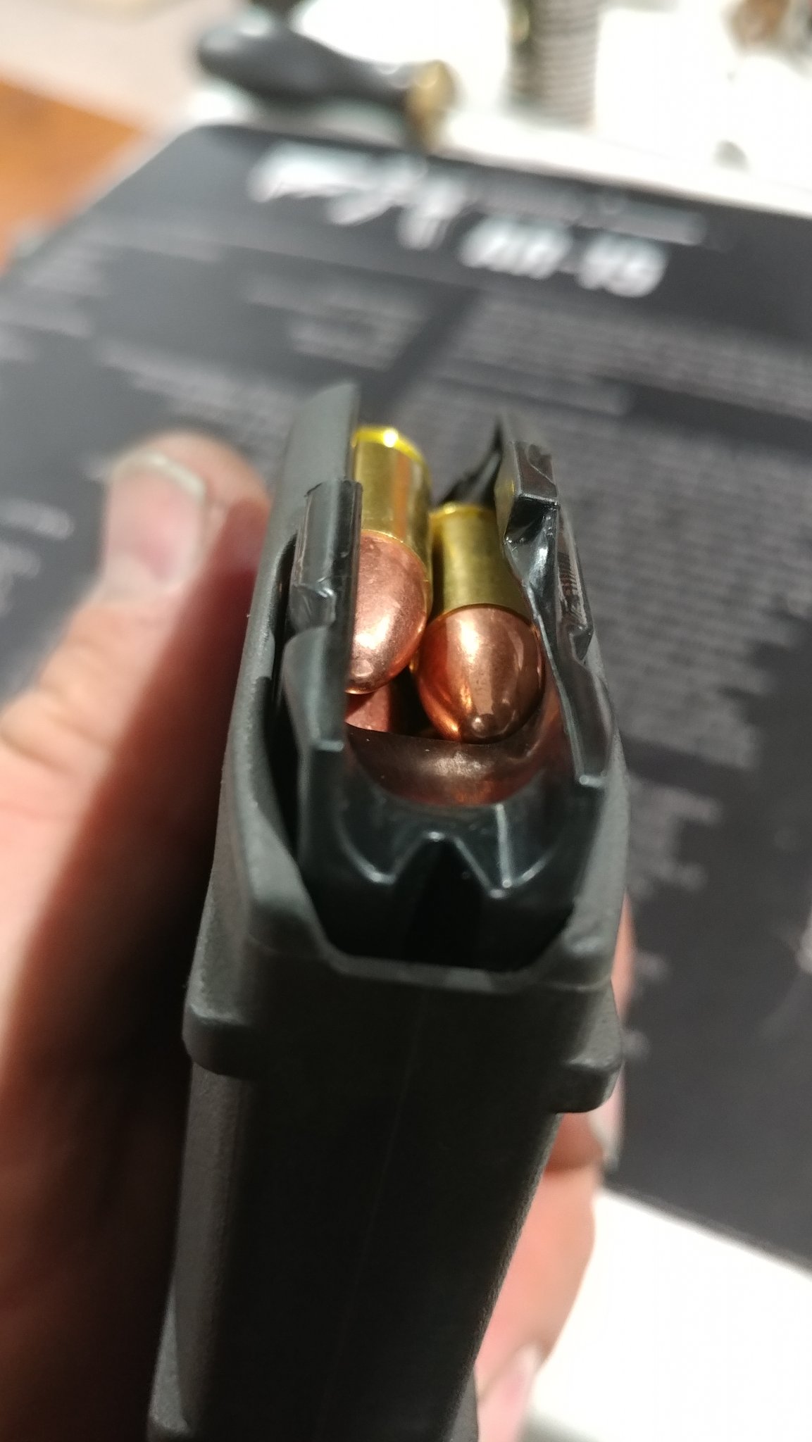

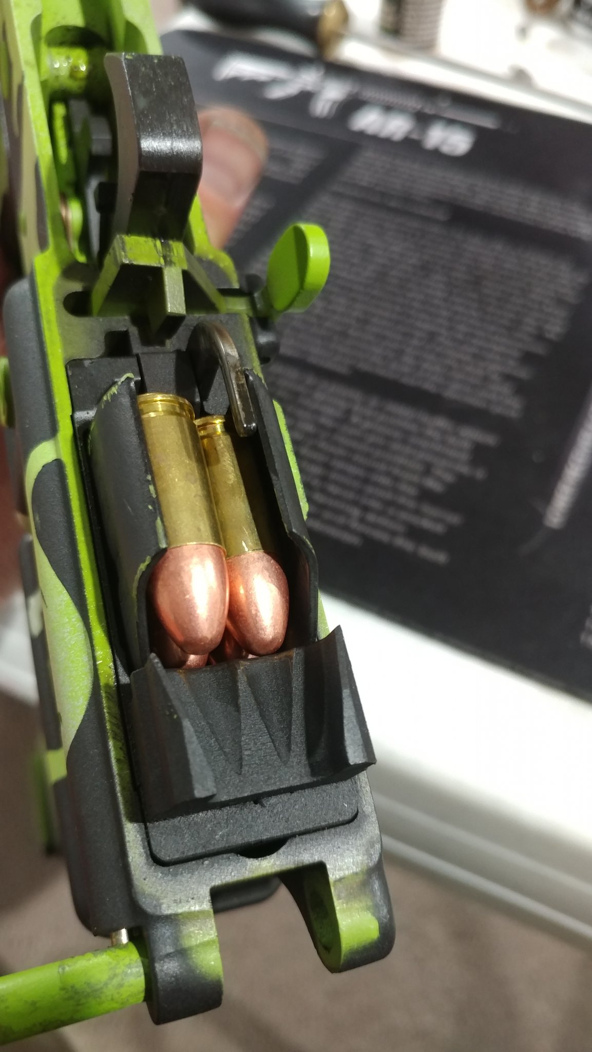

received 6 last week, installed one in a pmag and with some snap caps played with it all weekend. I will try and post some pics tonight. It has the Ejector built into the mag adapter and on the opposite side (side by dust cover) a "feed lip" the bolt has to slide over those. The bolt from my daughters colt pattern was a little tight sliding over those. My glock bolt went over smooth. I ill take pics of the bolts also, they are cut a little different. They make "hybrid" bolts now that can work with either mags so I am sure those are cut more like a glock bolt.
I have plans to take next friday off and go shooting with a buddy. I will set a gun up and put about 500rds through one. stay tuned for that, but I will try and post pics tonight. So far I am pretty impressed.
@powdahound76. Here are some pics. You can see the feed into the cahmber is a lot shallower angle. I think it will work.
first pics are of my daughter's gun (cerakoted with lions and tigers). It is a Colt pattern gun with a Hahn mag block. Then my glock mag lower. Then the two different bolts and then the mean arms endomag. Oh couple of the endomag before the bolts also.
Thanks for the pics! Makes perfect sense now how it presents from the mag based on mag height.
I am PC AR ignorant, which bolt is the Glock mag style bolt? Guessing the top on in pics based on feed lips of the colt and glock mags?

Yes top bolt is the glock bolt. The groove on the left (would be right side of the gun installed) is wider than the colt one. That is the groove that had just a tiny bit of resistance going over the endomag.
