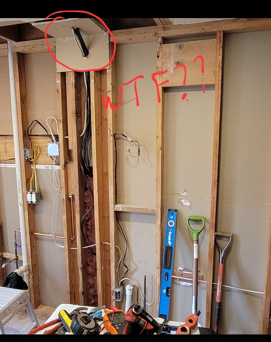

I have one for you. I was remodeling my mudroom a month ago, tore down a soffit to find 6 romex cables running from the wall through the drywall in the ceiling. The wires come from an empty space that contains the vent stack etc. And goes from the crawlspace to the attic. The space between the ceiling joists is open to the vent stack space. There is no reason not to run these wires another 6 inches over the top plate and into the open area. Would have been a pain in the ass to fix. I'll build cabinets to hide it. But seriously, wtf?
That's plum sexy right there...holy carp.

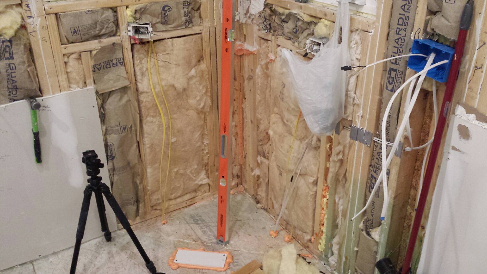

Must have been the same guy at my house, did something similar in my kitchen. Behind the sink was a small angled false back. They just ran the lines through the floor. I wasn't planning on using that space so that saves me some time. In fact, I added a few more the same way because why not. I'll let the future owner make a forum post complaining.
Looks like some apprentice drilled up from below and missed the wall. 😆
