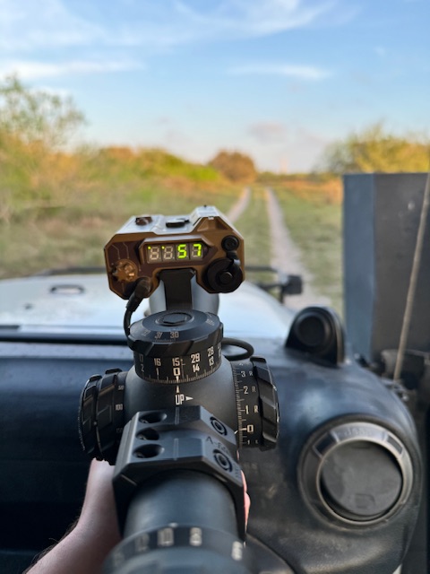

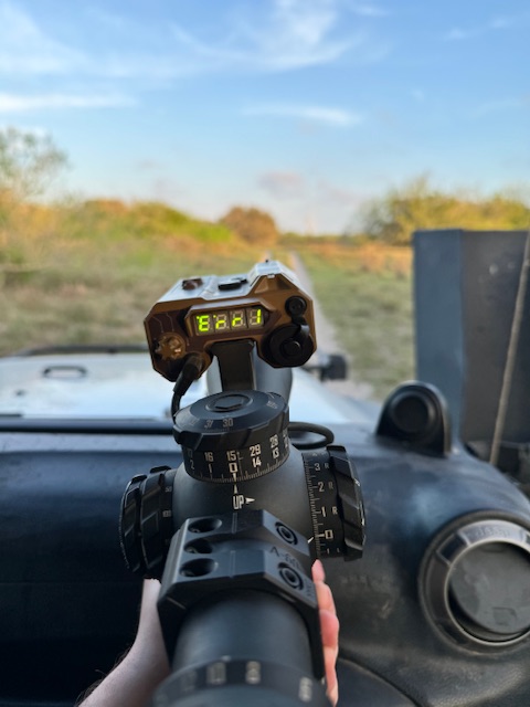

I got this unit from the group buy awhile back. The range finder has worked fine until recently when it will give me an “Err 1” code about half the time when I’m ranging. I can’t figure out what that means. Does anyone have a reference for what that means? I’ve tried changing batteries and cleaning lenses. Thanks.

Any ideas why this would happen every other time I range with it? I’ve tried various distances, days, and conditions while stable. Thanks for the manual info…I couldn’t find that for some reason.

I’ve mainly been troubleshooting at the 100y and 200y range with a large plywood target or landscape. It worked fine for like 2 years but this season has given me trouble. No windshield on the jeep 🤘
