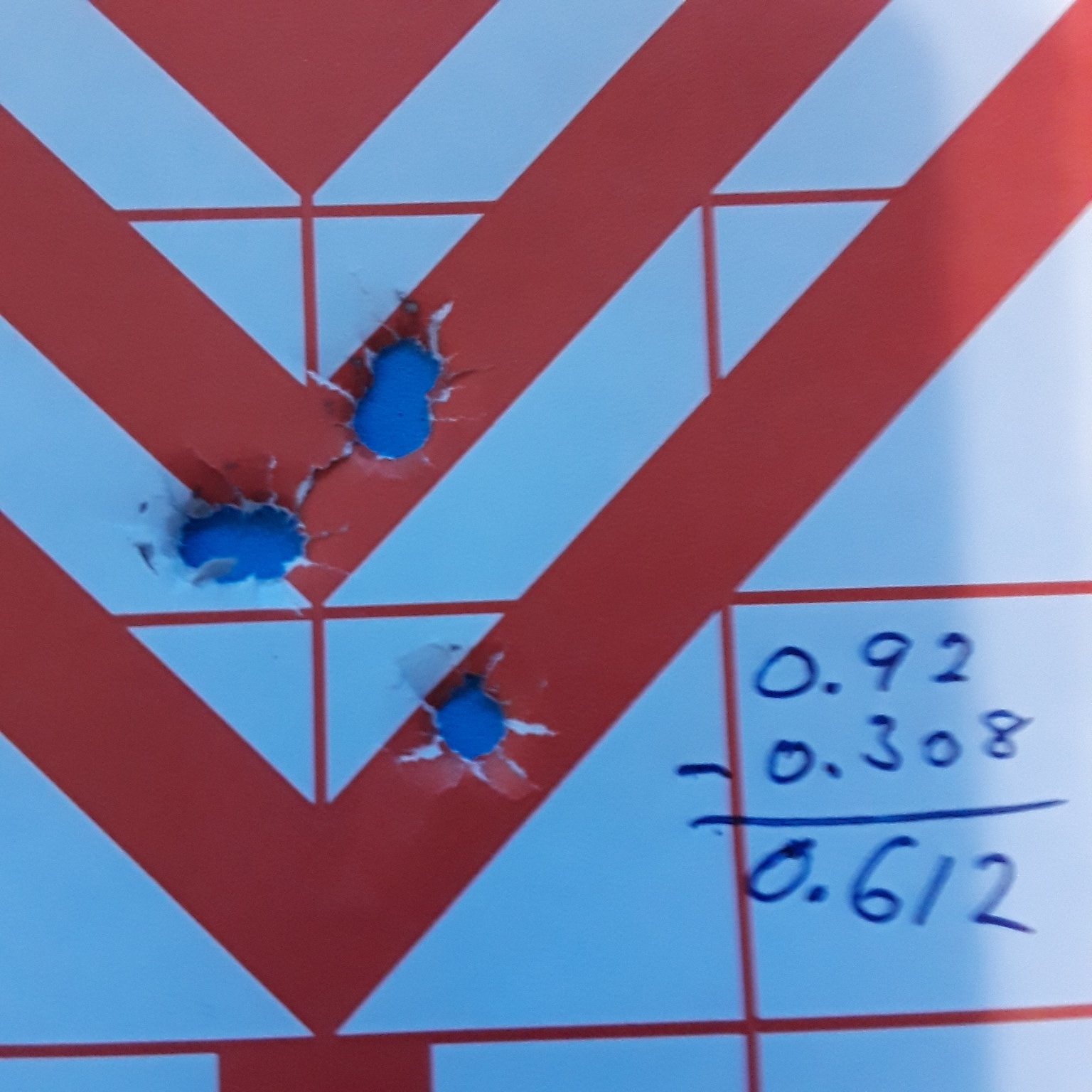

    Here's my data from back in 2015 when my Rem 700 was sporting the 20" 1:10 twist threaded barrel.
    All of these were put into a paper target ~10ft away and even the lowest/slowest charges left nice round holes.
    To the OP, not to insult your intelligence, but with subs it's generally seen as good practice to work DOWN in charge weight, stopping when you get to your desired speed and checking to make sure you haven't stuck a bullet in the barrel between each shot. I did the latter by shooting these three round "groups" in a straight line down the target to make sure a new hole appeared every time I pulled the trigger.

    All of that to say the .308 loaded to subsonic velocities can still stabilize the long 200gr+ boat tail bullets, you just need to verify before sticking the can on the end.
