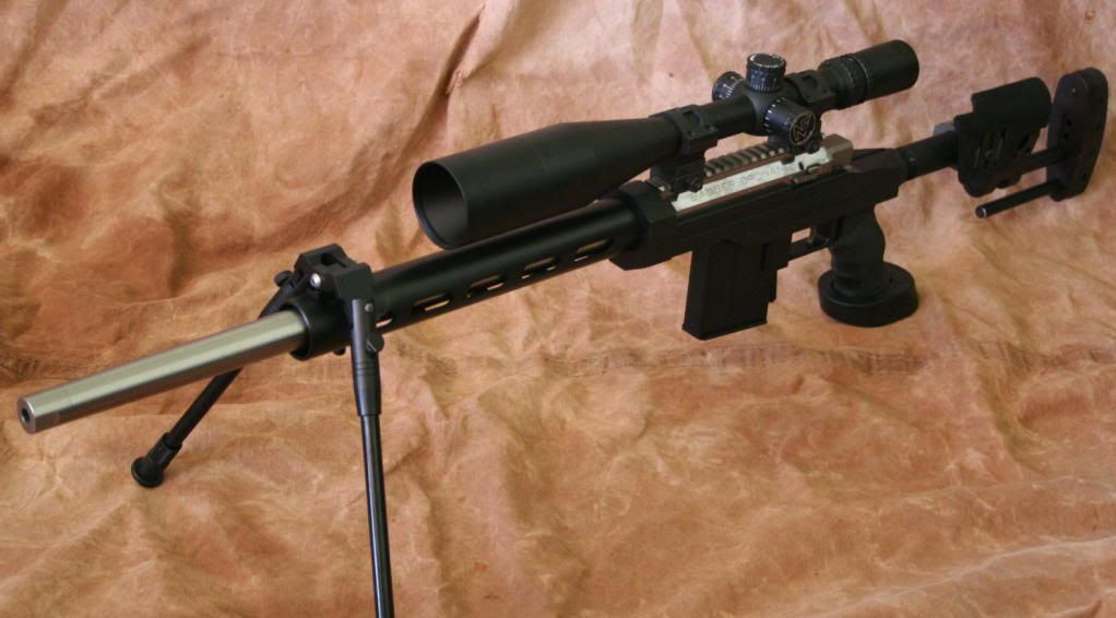

My pig gun
6.5x47 20" broughton 5C
Mostly shot surpressed
123gr bullet scenar or Amax
Going that short i use RL17, it really does give ya some more fps,sounds and feels like shooting a break barrel bb gun
Need to finalize load this weekend, but it will run 2900-2950 pert easy, just depends wot shoots best
123gr bullets 20-22" barrel
130gr 24-26"
28 and longer 140gr
FYI
my 1k rig being built will run a 31" brougthon 6.5x47 140vld
2950fps or more is goal running H4350
x47 is a very efficient design, especially with RL17 or long barrels

<div class="ubbcode-block"><div class="ubbcode-header">Originally Posted By: XLR</div><div class="ubbcode-body">I run a 22 inch barrel on my 6.5x47 Lapua with great results. It is defiantly the most accurate rifle I have owned other than my bench guns. Mine is threaded for a suppressor as well which is why I wanted the shorter length. The 123 gr Lapua Scenars work best for me and fly at about 2780 FPS. I have shot this to 1000 with no problems. I did try the 140 gr SMK's, 140 gr Berger's, and 130 grain Berger's but I get the best results with the 123's with a second going to the Berger 130's.
</div></div> How much does that stock weigh?
