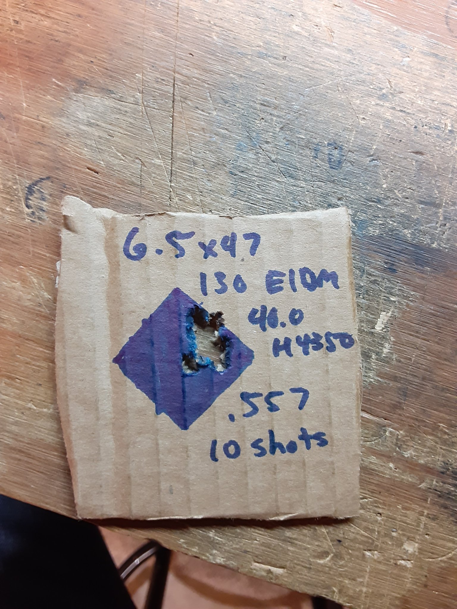

20 inch #4 mullerworks 10 shots at 100 yards with a Harvester Evo. About the same as a bartlein 3b.
