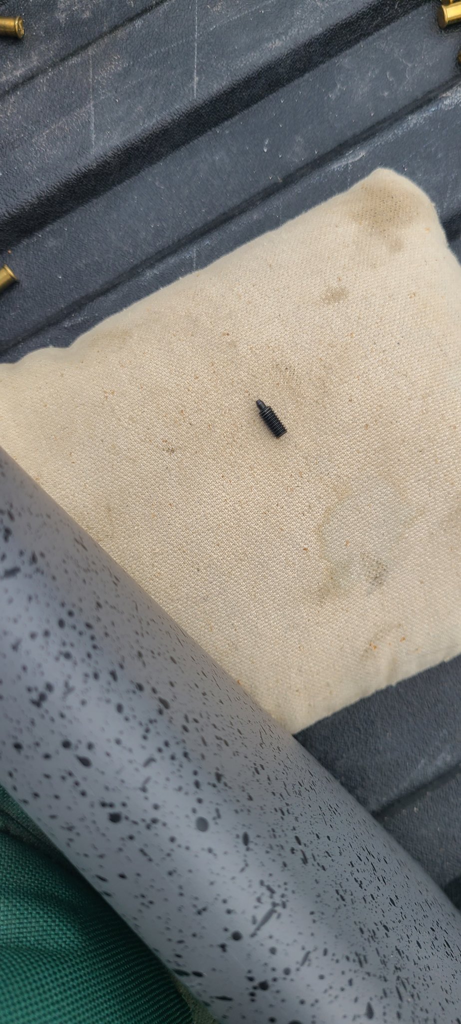

My trigger adjustment screw fell out yesterday while shooting. Is this something I'm going to have a problem with all the time?
leave it out, not needed, unless you want a trigger pull heavier than about 2 1/2 lbs.. Mine was out when I opened the box, screw was freely moving around the box.
I was worried that there was a spring there that might have fell out. I didn't know that you could leave it out.
Nothing else fell out, the internal spring is captured. There is a thread with pics of the trigger with the side plate removed so you can fully understand, just don't remember which one, maybe in the Bergara trigger mod thread. You are good to go.

The factory spring that is in the front lower corner makes the trigger heavier. It really doesn't matter if it fell out.

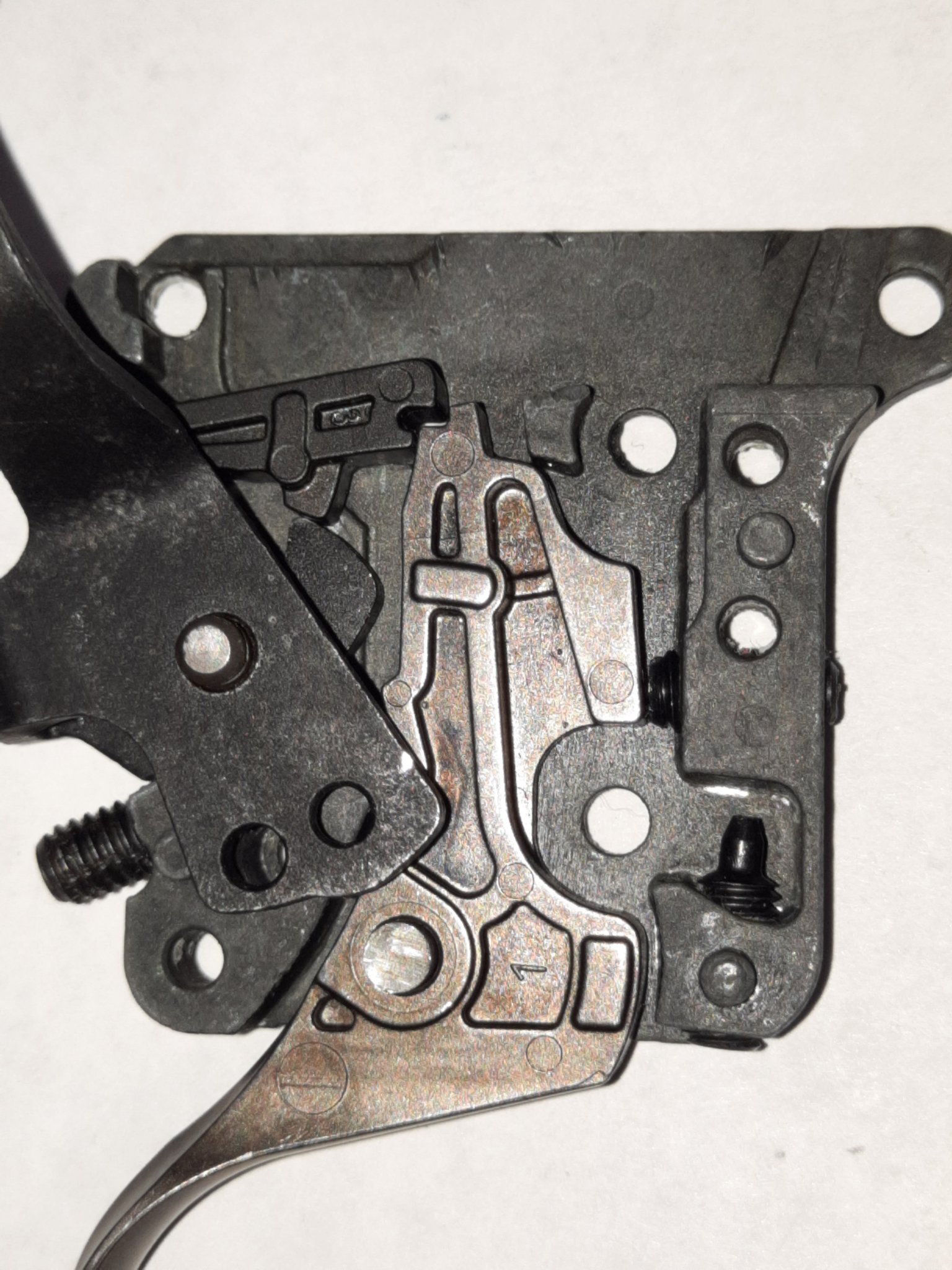

The original trigger mod was to tap out the two existing holes for a #4-40 set screw and I thought that was short sighted.
All that does is reduce the sear engagement to the point that they are riding on the radii. See the first image for example.

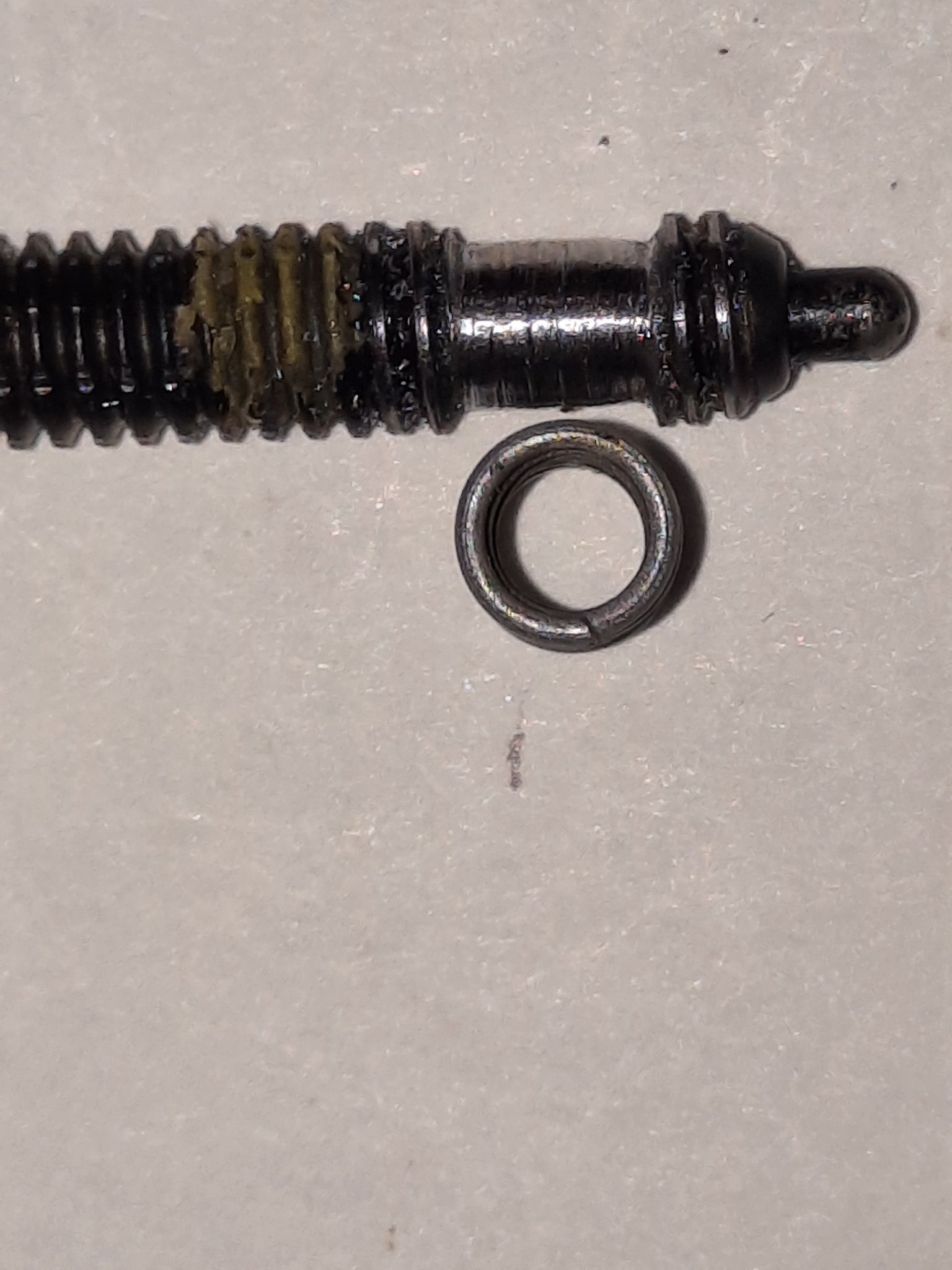

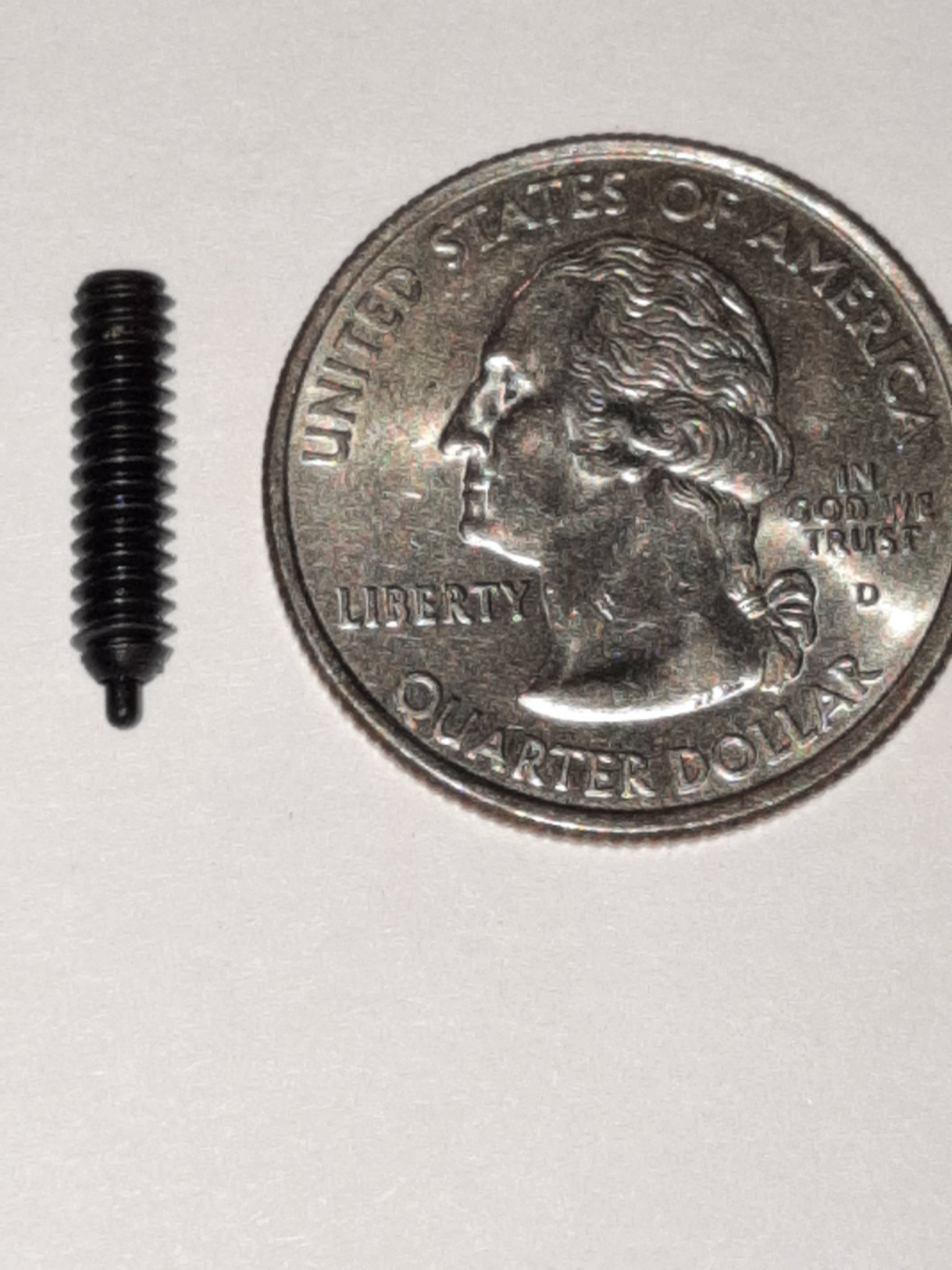

I thought a much better way to lighten the trigger was to use a long nose spring plunger. It is basically a set screw with a
nose that extends about .075" of an inch. I did my trigger and it worked great. I had good sear engagement and a trigger
weight of 11 ounces. It worked exactly as I thought it should. The #6-32 was fine even though it had about .003" of an inch
interference with the spring.

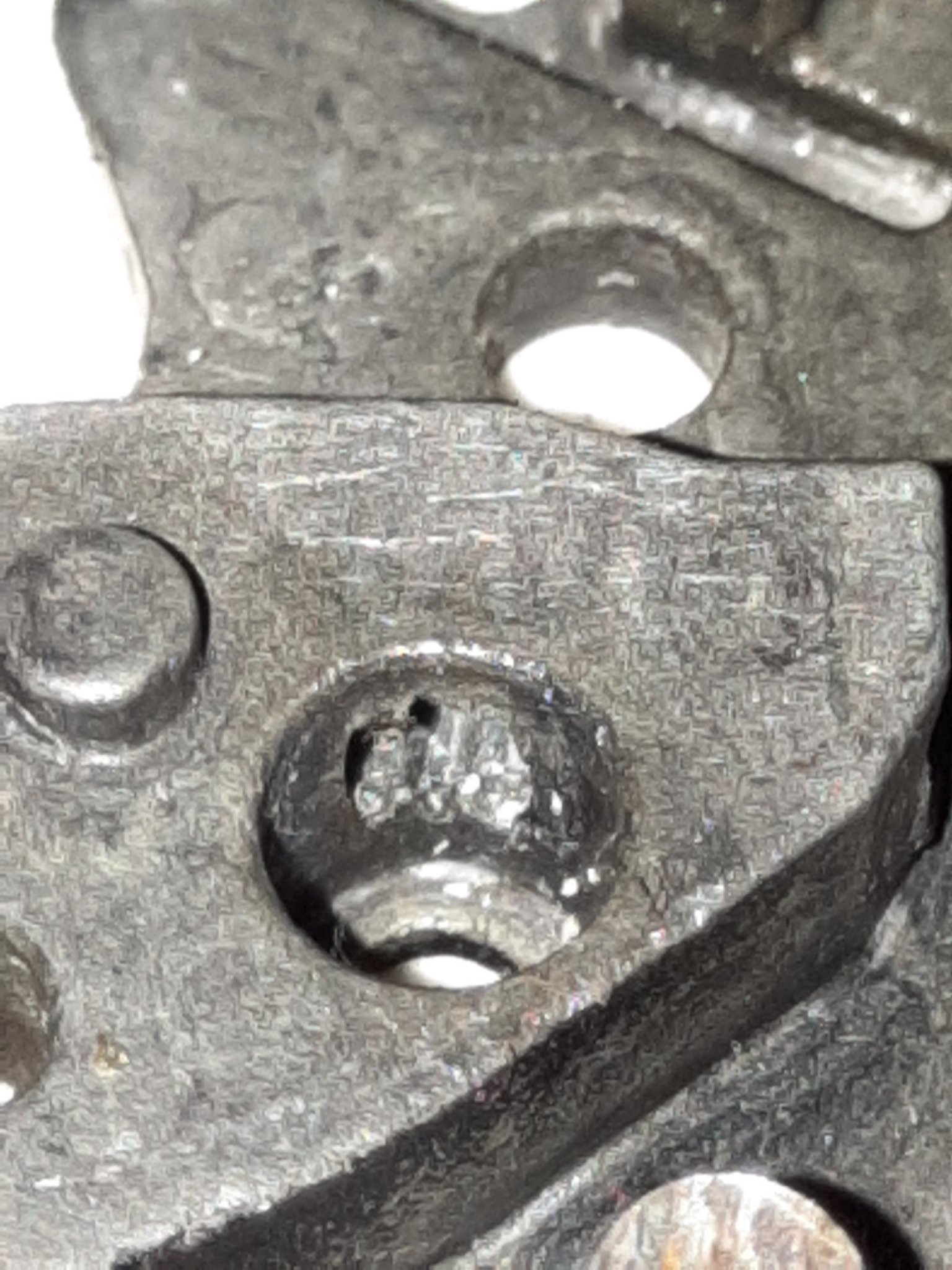

I wanted to do more so I installed a #8-32 plunger. Images #3 and 4 are the #8-32. The threads broke out into the spring
pocket hole and the threads had to be removed from the plunger as shown.

  • ROUNDED SEARS AND #4-40 SET SCREW WILL REDUCE TRIGGER WEIGHT BUT IS UNSAFE.jpg

  • #8-32 PLUNGER DOG BONED FOR SAFETY SPRING CLEARANCE  #6 PLUNGER NEEDS .005 INCH OR LESS OFF OF...jpg
