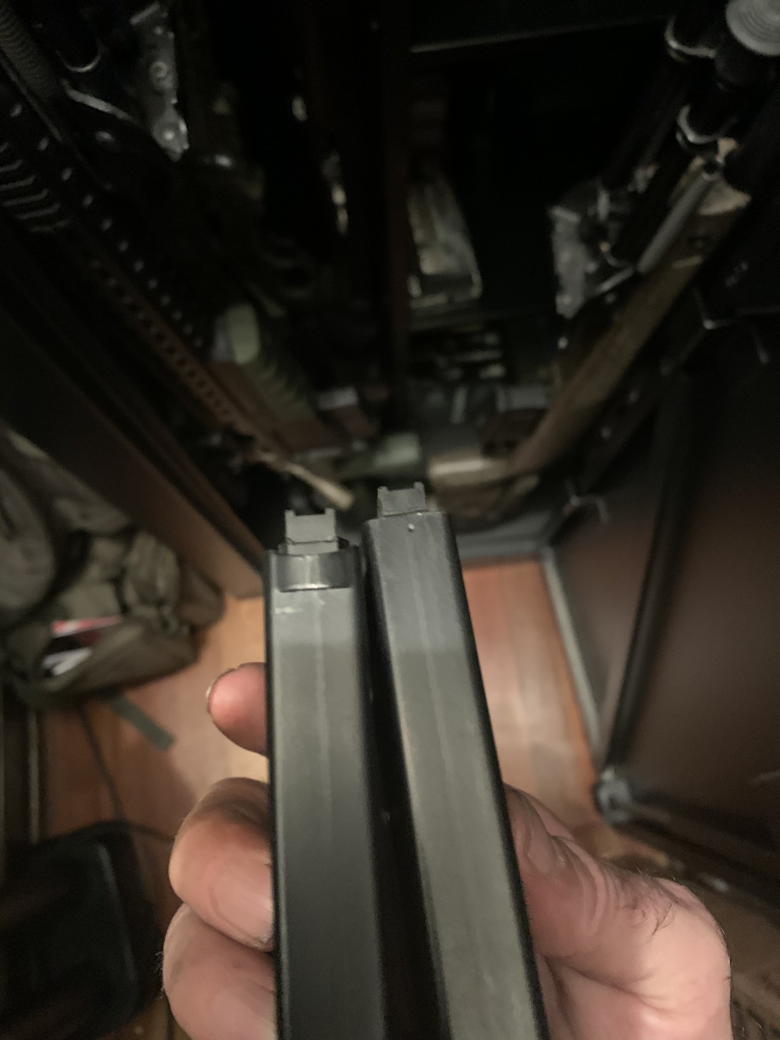

Hi All,
I own an accuracy international AXMC and am currently using the factory magazine that came with the gun for shooting 6.5 creedmoor.
I recently assembled a new rifle in same caliber (6.4 creedmoor), MPA competition chassis, timney trigger, Big horne TL3 action. My Accuracy international magazine, does not seem to work with MPA chassis. It does enter the action, but the bolt does not pick up the round, when I cycle.
Are the accuracy international magazines proprietary or are they supposed to worth MPA chassis? Can anyone please recommend some alternate magazines as well....thanks
Harjeet
Ax magazine is different then AICS magazine. There is a small lip in front of the ax mag.
