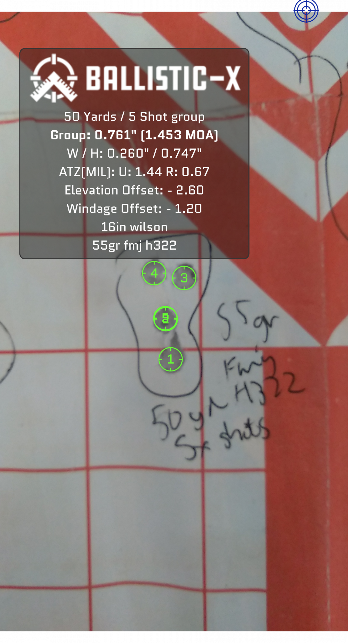

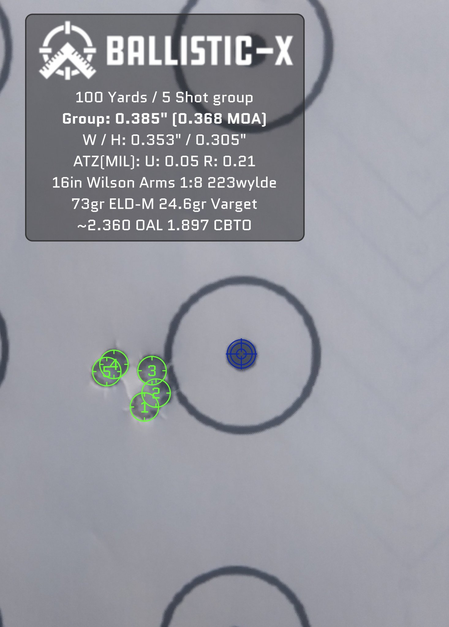

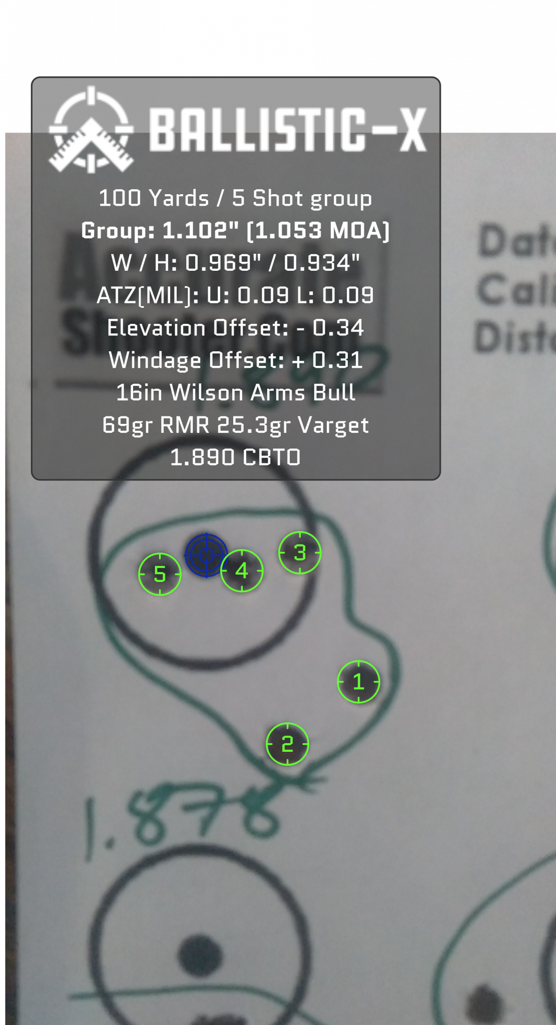

    Best five shot groups of some various bullets ive tried. Doesnt alway do this, but this barrel does seem to be more consistent on average then other barrels i have.
    My 73eld load is always under .75in at 100yds
    The 69rmrs have never been under 1in at 100yds, but never over 1.5in
    It seems to shoot basically any 55gr load between 1.5-2 moa.

    Nice info! 73 ELD's shooting well have been very barrel dependant for me. My Rainier Ultramatch (Shilen) Gen1 shot the 73 ELD's lights fucking out every group sub 0.5moa. My Compass Lake Bartlein and Keystone Krieger didnt like them but they LOVED 77smk... Glad to hear the 73 ELD's shoot well in your Wilson. Maybe Ill just start my testing with them as I have a ton of them.
    RMR bullets never shot great for me. I dont know whats up with them, they SAY they arent factory seconds but something is going on. They dont come in normal retail packaging and they have been inconsistent for me every time I tested them.... Hard pass.

    Ill be excited to see your results also. My buddy has a wilson arms barrel in a different profile that also shoots really well with a lot of different bullets. Do you get good performance from your 73s at mag length?
    I was a hoping for more out of the RMRs, but honestly for the matches i shoot them in, I dont need sub moa performance. I just need to be able to get onto a full size ipsc at 500yds, which these will do.

    Yes all my testing with the 73's were mag length. Here my OCW, Seating Depth test and 5 shot group load confirmation targets. This was shot in my Rainer Ultramatch Gen1 (shilen ratchet blank).

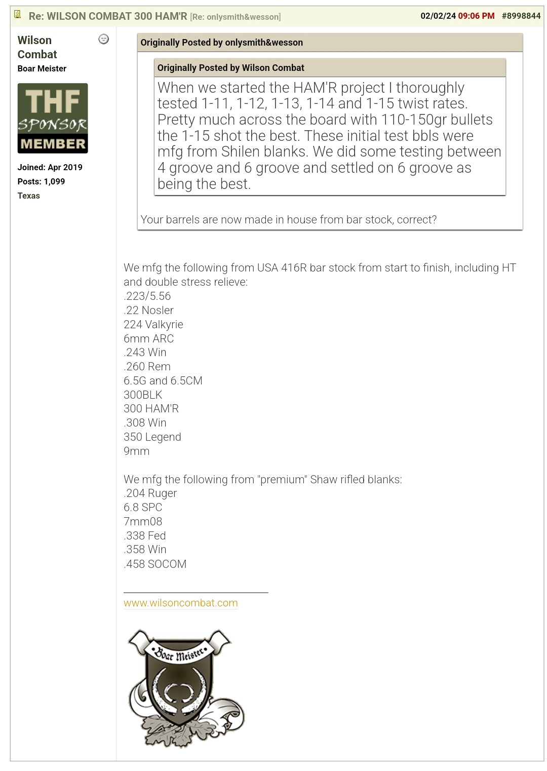

    This is what WC has posted online about their barrels
