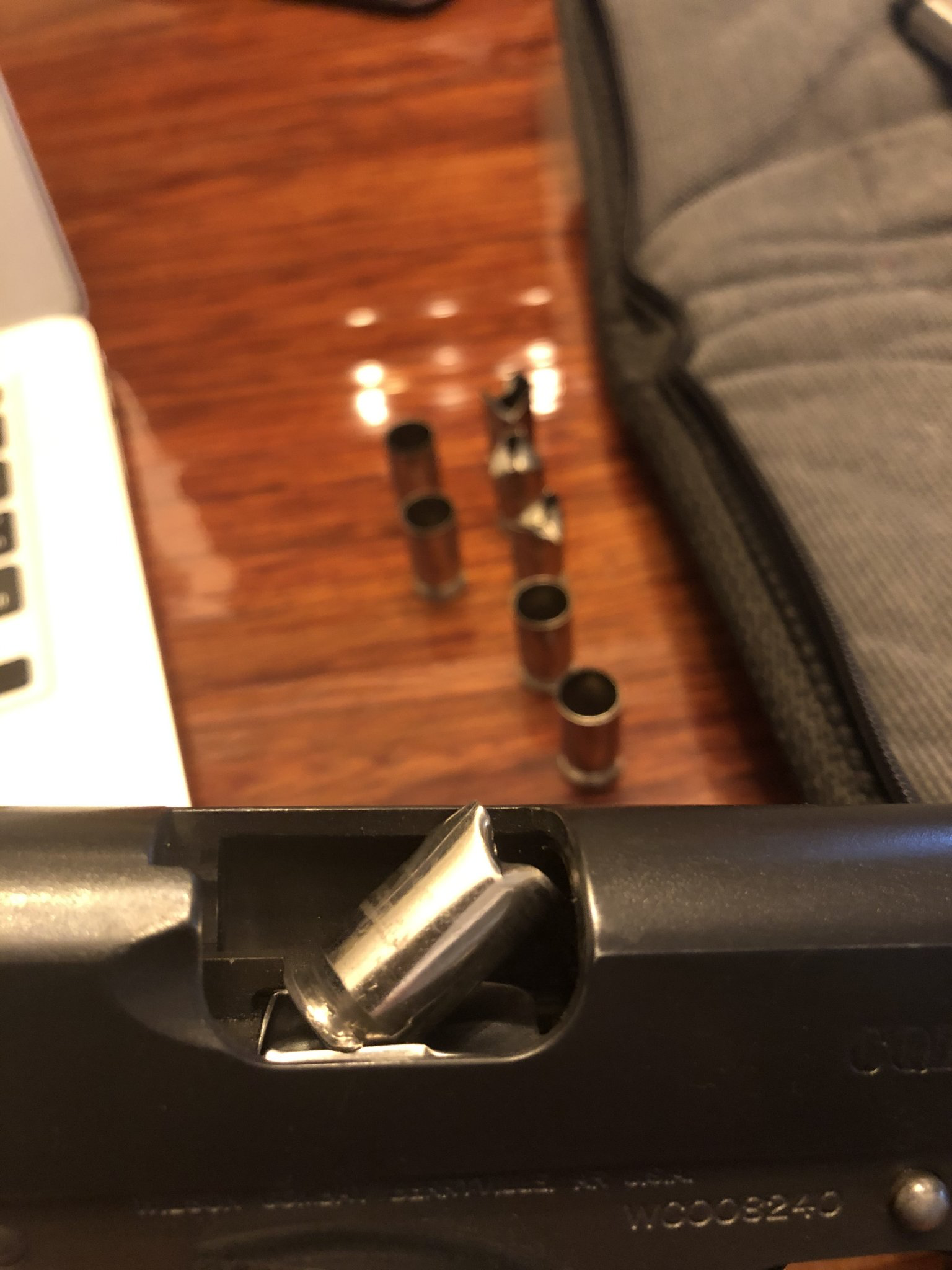

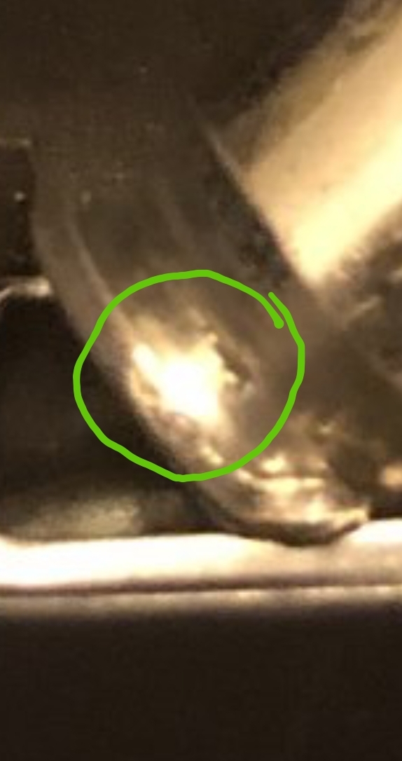

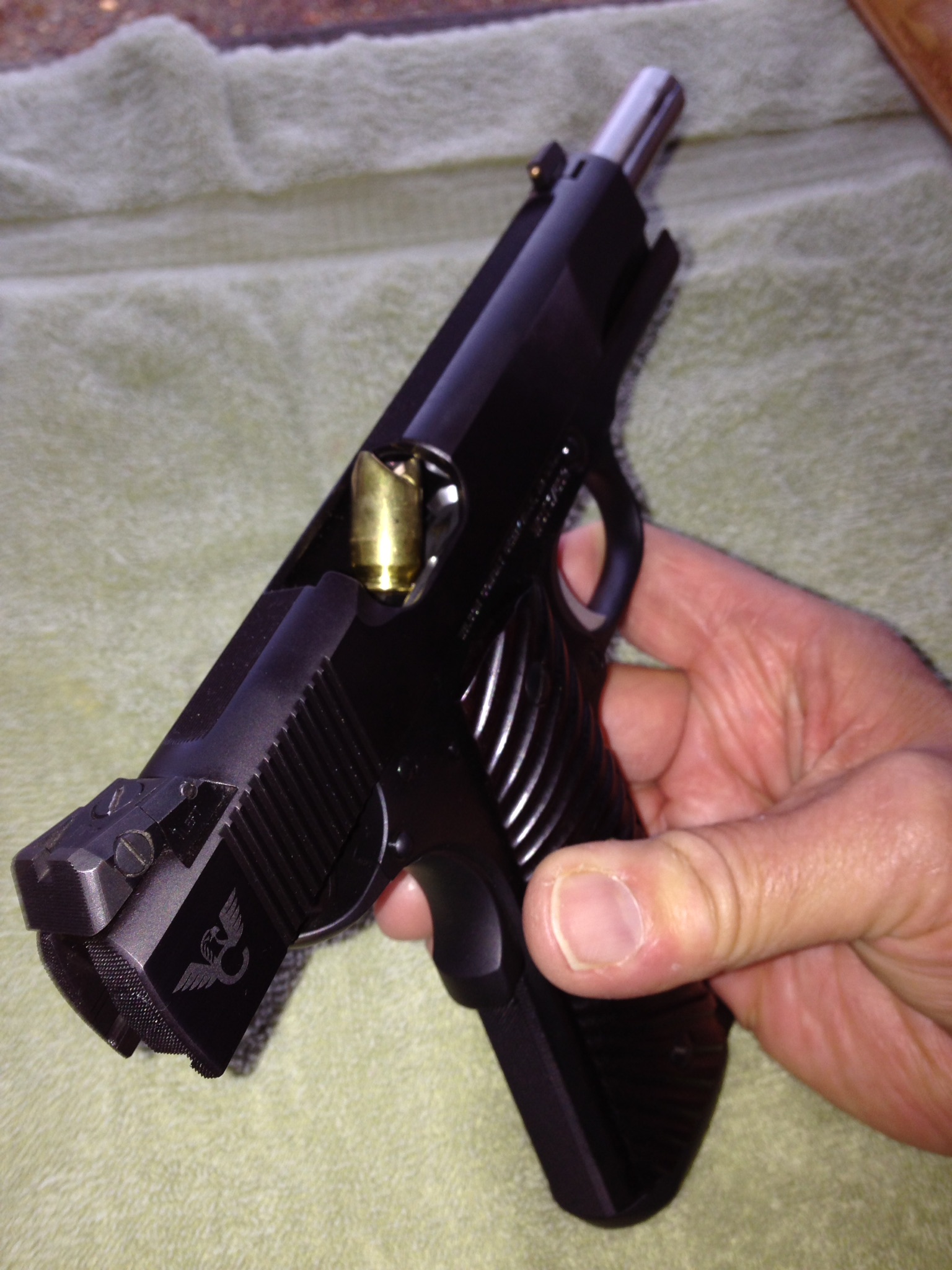

    I decided to shoot the Wilson that day. After 3 magazines I started to have problems. Stovepipes and failure to eject. My buddy with the Kimber really enjoyed that. My jokes about plastic mainspring housings no longer had an effect. I sent the Wilson back to them. They pretensioned the extractor and replaced the mainspring and the recoil spring. When I got it back I shot it with some Wilson ammo I had bought for it with no problems. A few weeks later I went to the range with T series and everything went to shit again. I just got pissed and put the gun in the safe until a few weeks ago.
    This is what I got. With the advice of a few of you here I took the shock buff out. I was told that could be the issue. To no avail. The thing is just a jamamatic. I sent it back to Wilson. Here is the email string.

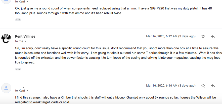

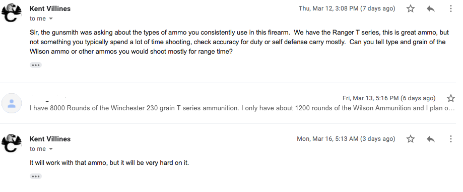

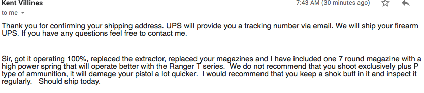

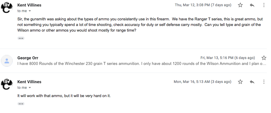

    Wilson stands behind their product and fixed it. but..... Target loads are "Regular ammo" Duty hollow points are Plus P and "powerful". and will damage the pistol "quicker" . CQB Should be changed to CQT. Close Quarters Target. The pistol will come back to me and remain in the safe and fed a steady diet of weak target loads. The heavy lifting everyday carry will be left to the HK USP. This whole thing really pisses me off. Am I just being an old fart? Should I just gently open my legs and insert a tampon and get on with life? I can't even look at my Wilson AR anymore without getting pissed and it works fine.

    I really sorry to read about your issue. Had I spent that kind of money on a pistol, I would think it would handle any kind of ammo, etc.
    That said, the Ranger +p+ ammo is loaded hot and shouldn't be run in certain guns unless they are specifically rated for it like with different recoil springs, etc. The increased rearward slide velocity can do a number on different pistols. Kinda like when an AR is over gassed, that can cause extraction and ejection issues do to timing issues. Similar concept.
    You can absolutely use standard self defense ammo with the Wilson with no issue.

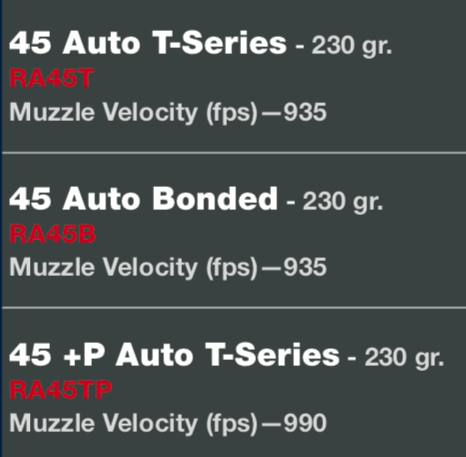

    230 grain at 850 FPS, max pressure 18,000-19,000 PSI
    935 is not plus p to Winchester but 925 is plus p to Wilson

    Well I had a hard time getting past the point where you said you have 8000 rounds of 230gr. +P T Series... I use the +P+ and at $50 a box and hard to find it took me a while to stock up 1000 9mm 127's and I was lucky to get 500 .45. That T-Series +P+ load is what I use in pistols too and it is pretty snappy for a factory load. But the Glocks don't have a problem with it.

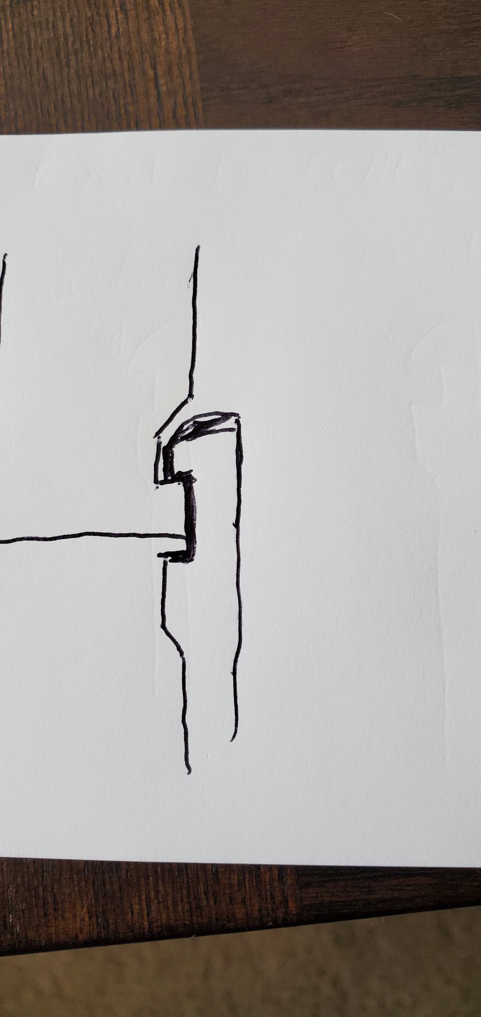

    Ok. I'll indulge your belief it's a non-lube related issue. I'll reason through this thing as I type to see if we can come to some kind of logical cause.
    In the cycle of operation of a 1911, after the bullet exits the barrel, the slide begins to move backwards, taking the barrel with it because the barrel lugs are flowing the path of the lug recesses in the slide.
    The feet of the barrel (or bottom lugs) where the barrel Link is connected by the barrel Link cross pin, move backward as well, once the barrel moves backward far enough, the barrel is pulled downwards as it is being pulled down by the barrel Link which connects the barrel feet to slide stop cross pin.
    Once the barrel stops moving downward, the rear of the barrel feet, under the chamber, should be just kissing the frame bridge. Once this movement is completed, the slide is still moving backwards, and the extractor pulls the casing out of the chamber.
    Now, here's where things can get spicy because of the 1911's co trolled feeding and extraction.
    1. Your Wilson is probably has a super duper tight chamber to have the best accuracy, because it's a Wilson. Other chambers have some more tolerance (room) for the brass to expand and contract back down.
    Potentially the ammo you're shooting may be sticking in your chamber and the extractor is coming off the rim as circled in green where the case rim is slightly pulled backward. That can cause the case head to drop down, and the top of the slide pushes the case mouth backward, causing the case head to jam in the magazine feed lips.
    I understand "it's not +p ammo" but it is exhibiting issues of increased slide velocity, even after replacement of springs and extractor tuning.
    Potential fix? Change ammo. Not every firearm likes every kind of ammo. Does your rifle shoot cloverleaf groups with every ammo? Or, if you're dead set on the ammo, maybe tad heavier recoil spring if that's going to be your primary ammo

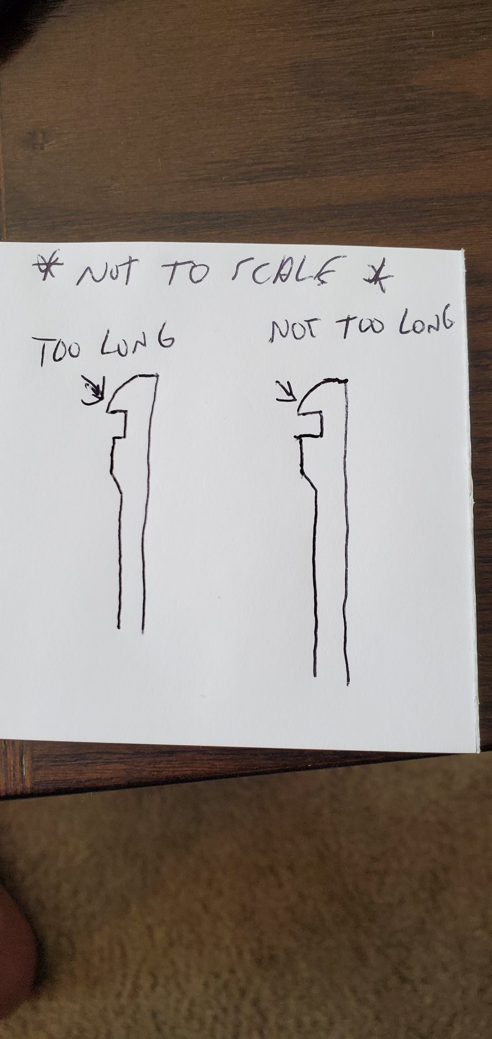

    2. Below is also a spot of concern: that area of the flat part of the extractor rim on the cartridge....
    That's caused by the claw portion of the extractor that's a hair too long.
    I've seen this cause both feeding and extraction issues. Potential fix? I've taken many extractor claws and ground them down to where they dont contact the casing in the way it's happening on your gun.

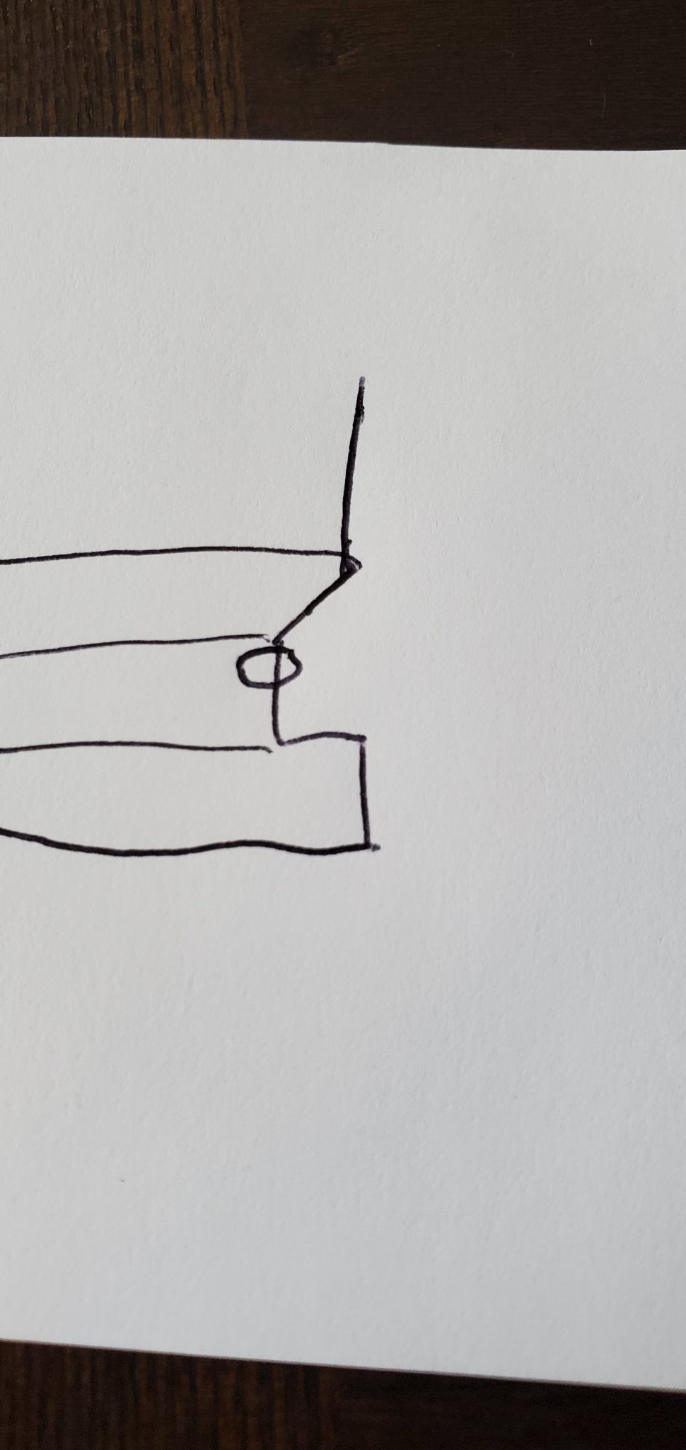

    Kinda Like this (not to scale) LOL:
    OR
    Your extractor could be fine, and your ejector tip is contacting the casing a tid bit too high, causing the casing to occasionally go downward as opposed to up. When it moves down. But that wouldn't exactly make sense because your casing is getting jammed in the mag before it hits the extractor.
    There could be a couple of the above things going on.
    I hope this makes some kind of sense.

    This ain't a lube issue.......

    Wilsons Gunsmith said the end of the extractor was "rounded off" Maybe it was rounded off because is it was too long. Thanks for the drawings. Makes sense.

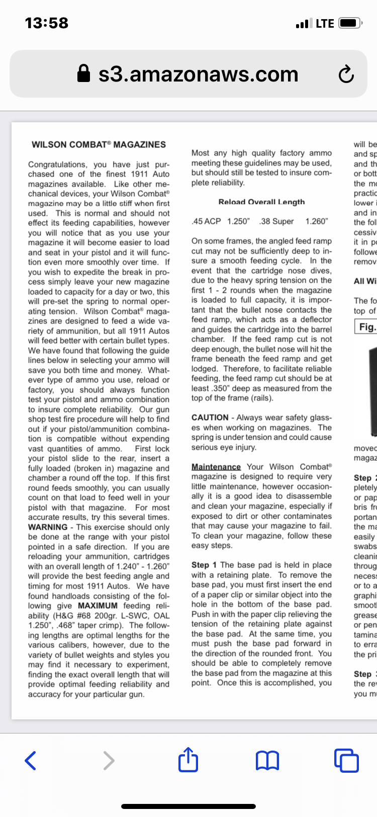

    Sucks to have a weapon malfunction like that. I basically inherited a Kimber ProCarry II HD (4” bull barrel rated +P+)from a buddy who was experiencing similar malfunctions for $200. Yes we are still friends and I even offered to return it when I figured out the problem.
    1-the springs in a lot of of the plus rated weapons suggest a more frequent spring replacement schedule, like 800 rds in the Kimber.
    2-the tolerances of the Wilson Combat magazines are very OACL sensitive. I started measuring OACL on bulk Ammo and was amazed at the variance.
    3-next issue was his magazines were filthy. Once I changed ammo to a more consistent OACL problem appeared. They seemed to work together against proper function.
    4-last issue I resolved was the worn springs in the magazines. I discovered this when I disassembled them for cleaning.
    Wilson 47D mags
    Old springs- 6.75”
    New springs-8.75”

    47D Mag info
    47D Mag info

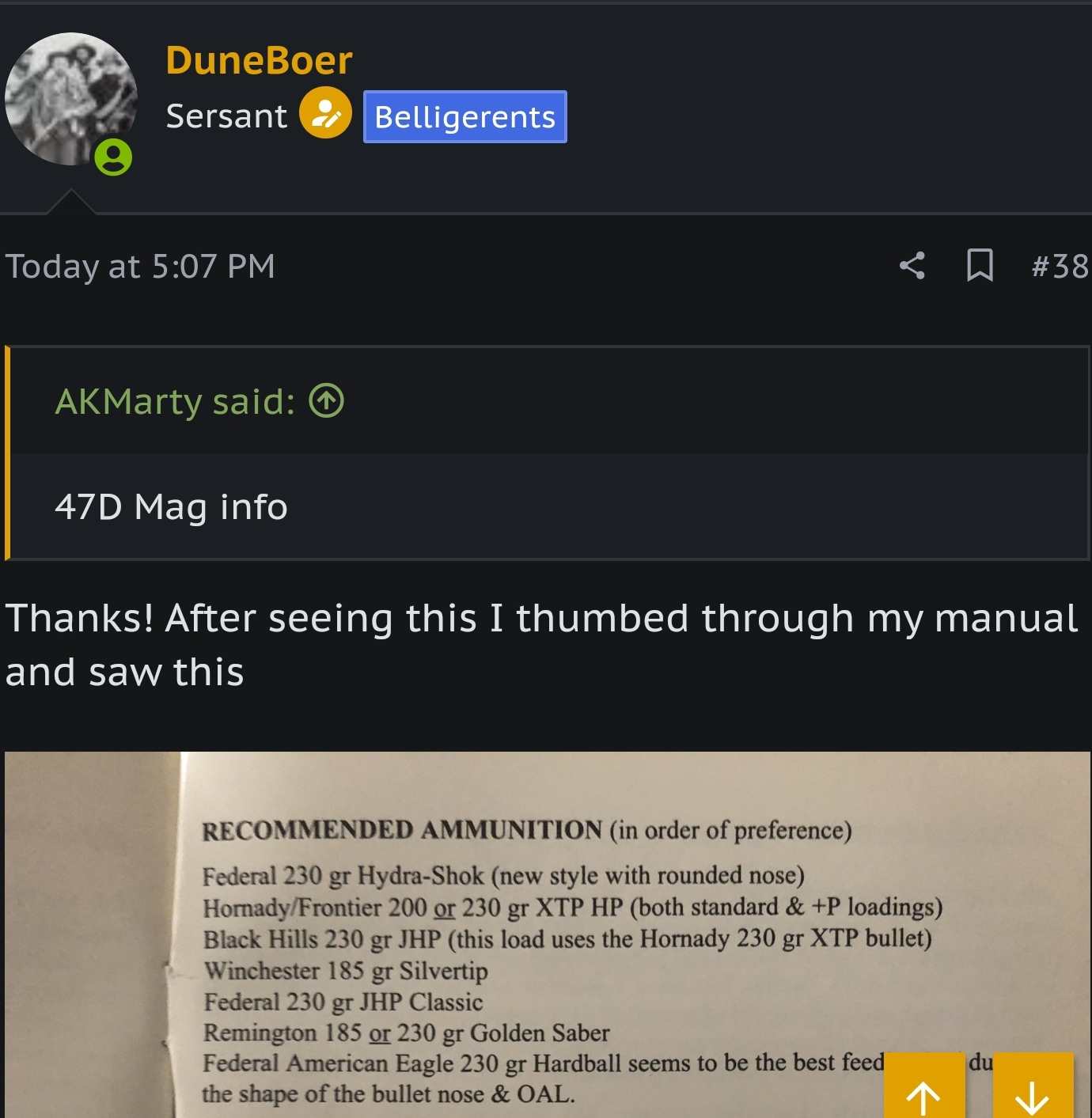

    Thanks! After seeing this I thumbed through my manual
    and saw this
    You guys are great! It never ceases to amaze me the expertise within these walls! I guess I should have read the fine print but you would think the factory would have referred me to this. If I would have known I never would have bought it. Wilson Target all I needed to know.
    and saw this

    You told me in an earlier post that you had a 15 lb. recoil spring in there AND that it hadn't been replaced by Wilson or you and had who knows how many rounds on it.
    So here's what happened to your gun: you didn't bother to make sure you had the correct recoil spring for the ammo you were using. You didn't even bother to do the basic MANDATORY safety maintenance of replacing a worn out recoil spring. The weak spring/hot ammo rounded off your extractor and caused your jam. Wilson didn't do anything wrong, you did. The rep's tone in the email indicates that he knew your negligence had caused the issue, but they fixed you up free of charge anyway. Perhaps you should rethink your plan of selling the gun and badmouthing a company that did you solid.
    and saw this
    I can tell you from lots of experience, the Federal 230 Classic hollow point, 230 Hydra Shok, and both the 185 and 230 Remington Golden Sabers shoot very well.
    When I first got my CQB (new), I ran 500 rounds through it to break it in per Wilson's instructions. At about 250 rounds, the slide locked halfway in its travel. The Shok Buff had started shredding and some little bits got between the frame and slide. Removed the Shok Buff and fired 5,250 rounds through it over the next 4 years without a single malfunction. Then this:
    Look familiar? This was the result of working up 45 Super loads to run through it for hunting season. A failed experiment. I put a 22 lb. recoil spring and a 26 lb. mainspring, but it still wasn't enough. The load that did this (twice) chronoed at 1015 fps -less than 100 fps faster than your Ranger T.
    I thought I had a 15 lbs spring in it but I wasn't sure what they placed in it when I sent it back the first time. I found the old invoice and they didn't say they replaced any springs to fix the stove pipe issue. (which they didn't fix) Yes they stood behind their product and "fixed it" for free. We will see. The reps "tone" didn't match what was in the manual about ammo. The ammo I was using Win T series which used to be SXT is specifically not recommended. I failed to read this when got the gun (My fault yes). When I asked the rep about when I should replace components he didn't have an answer for me. When I spend that much money I expect to be told the facts about what is wrong with it. I don't care if my feelings get hurt. I wonder what power the recoil/Main springs they put in it? Will they say in a note in the box? I wonder when I should replace it? Rep had no answer when I asked about replacing components.
    When I get it back if it works with a steady diet of their target loads, I think I have about 1200 rounds of their 230 gr HAP loads left. I will give the fucker one more chance with the target ammo before I trade it for a blow job and Philipino 1911 in Subic Bay.
