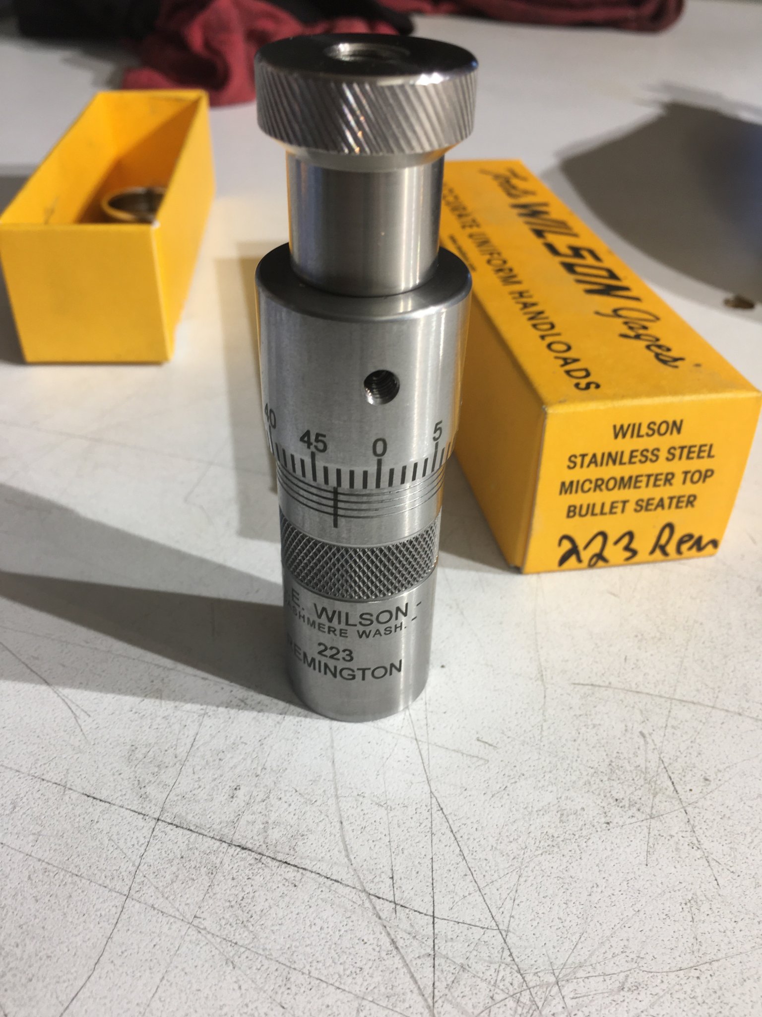

Scratching my head on this one. So Iv got a Wilson micrometer seater and arbor press. The die in question is a 223 rem die. Iv loaded hundreds of rounds on it.... with hornady brass.
Today I went to load some with Lapua brass. Brand new Lapua brass. Neck expanded with Sinclair expander, imperial neck lube used and left in the case. Vld chamfer and debur. The bullets are taking way too much force to seat, leaving rings on the bullets. Enough pressure that it’s almost too much for an arbor press.
I can’t figure out where it’s going wrong. The die is building pressure in it as well, after seating it is suctioned together after forcefully seating a bullet.
I have....
-Measured against hornady brass, headspace is within a thou.
-Length is within spec, little longer than my hornady trim length
-Lapua brass fits in chamber gauge that came with the die, and shows as satisfactory in the go/no go cuts
-NOT a neck tension issue. Measure loaded and unloaded my neck tension is .0015.
-Thought it may be body diameter, ran it through my full length sizer, didn’t do anything
-No oil in die die. Cleaned the die. Tried some lube in the die. Cleaned the die again. Nothing
-Lubed the bullet, still nothing.
-Contacted LE Wilson, their answer was to send it in, which I don’t want to do because I’m still loading hornady brass on it on a regular basis
-Tried vld seating stem, and regular seating stem, nothing different.

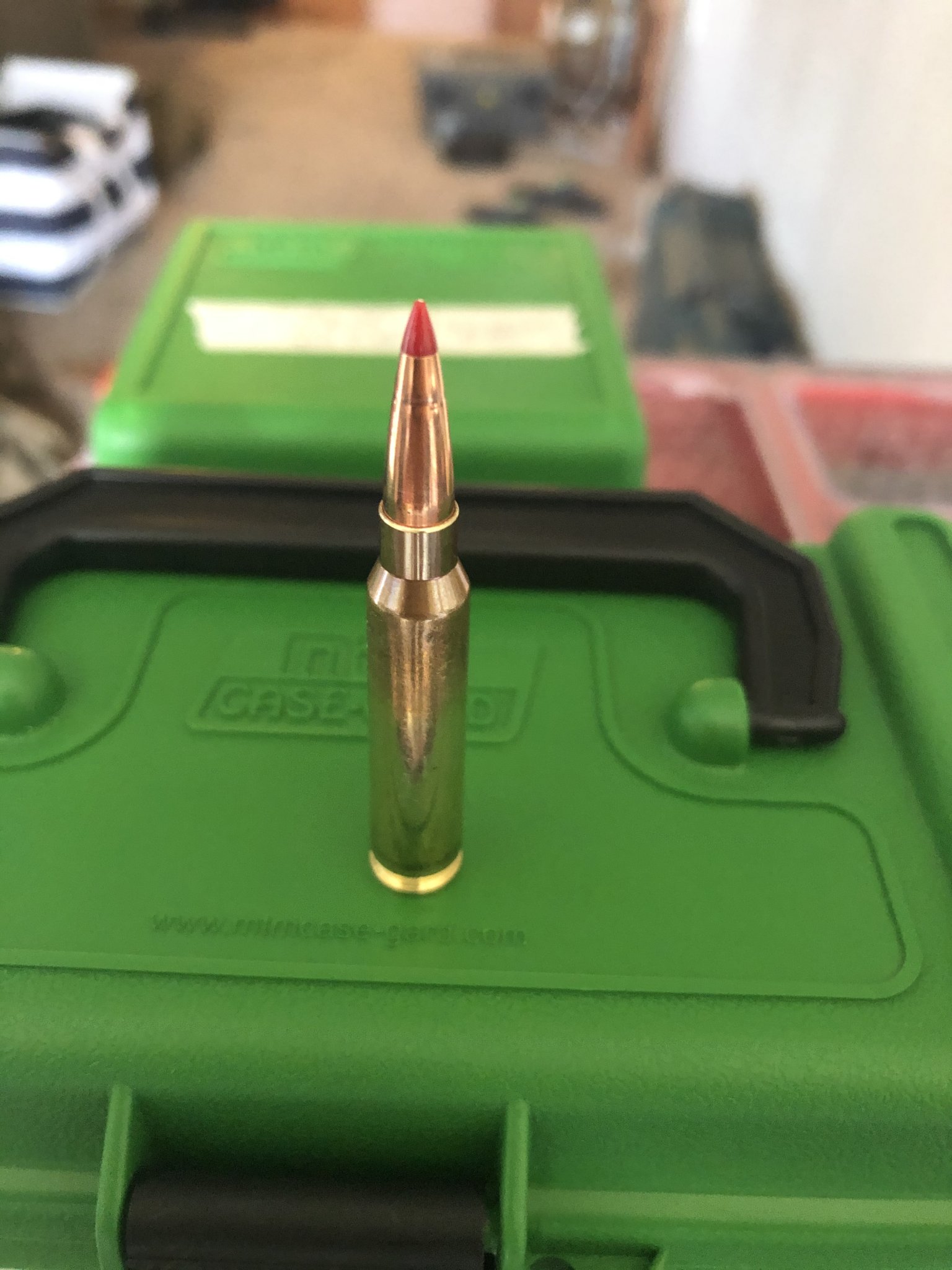

All said and done it took so much force to seat that not only did it dent the bullets, but CBTO was all over the place.
So I stopped. Decided to try the hornady brass with the same bullets. Proceeded to load up a powder charge test, which went as normal. CBTO all within a thou, seating force was light as to be expected with .002 neck tension. Everything went smooth.
I’m at a loss here. I’m considering grabbing a normal press mounted seater and seeing what the heck is going on. Or buying a Wilson die blank and sending them a piece of Lapua brass.
What do you think?
