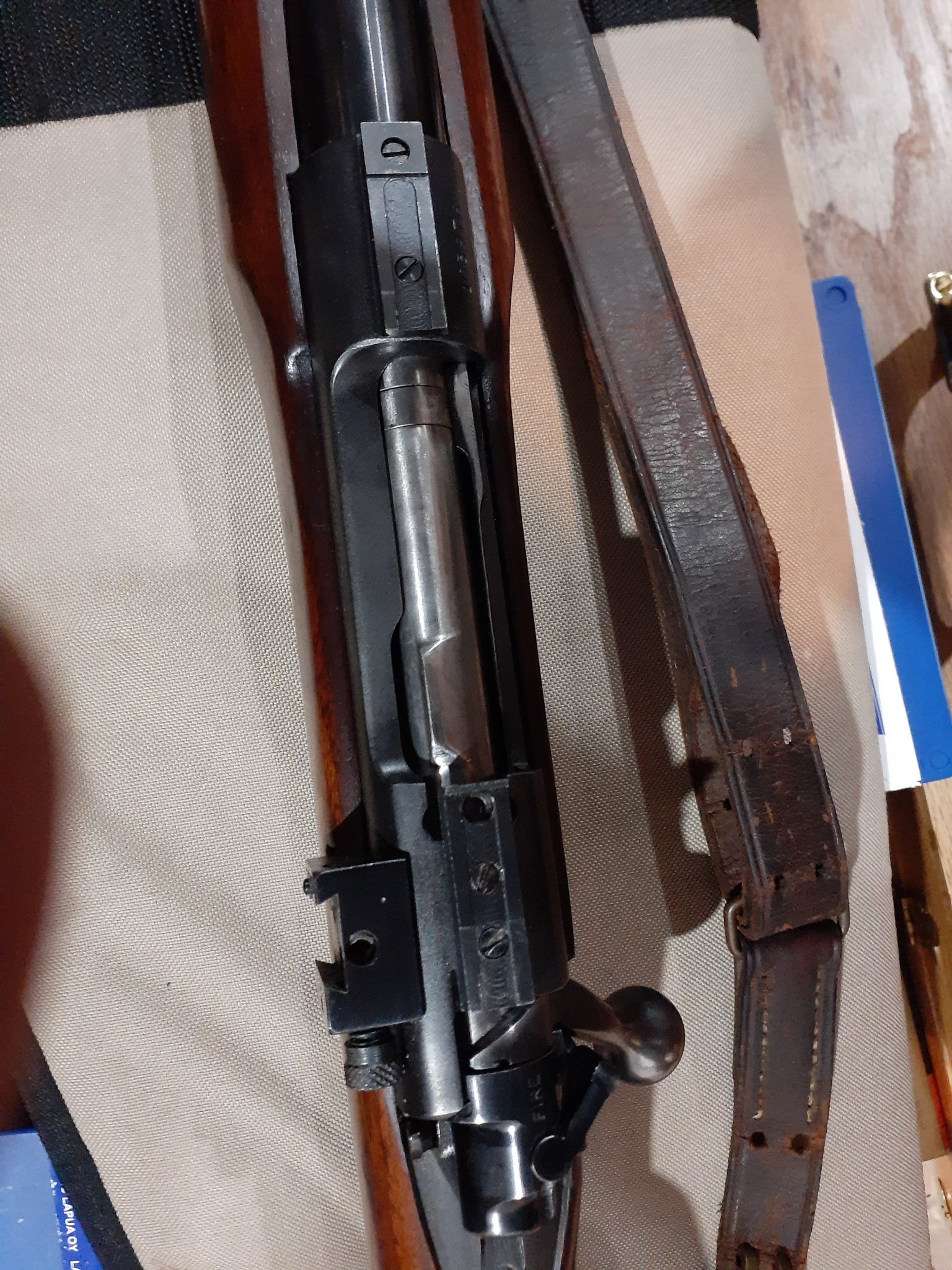

From what little I can see it looks to be a NM but but that's all I can tell you.

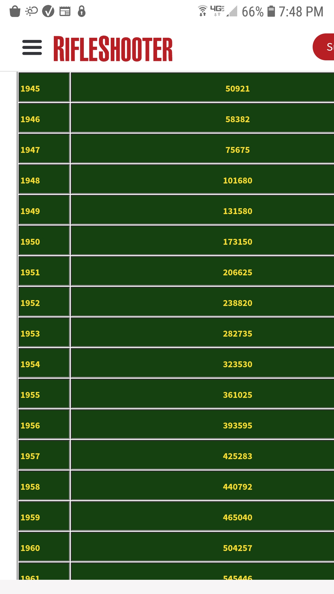

I'd take it out of the stock and see if the barrel date matches the date of manufacture, that the stake marks line up and theres no obvious signs the barrel had been removed from the reciever. If that all checks out it's most likely legit.
Not from the pictures, no. If theres no numbers/letters stamped on the underside I'd need to have them in my hands to take measurements. Theres quite a few different block heights/types that were used on M70's.
The drillings up front of the sight block are for a Winchester scope base.

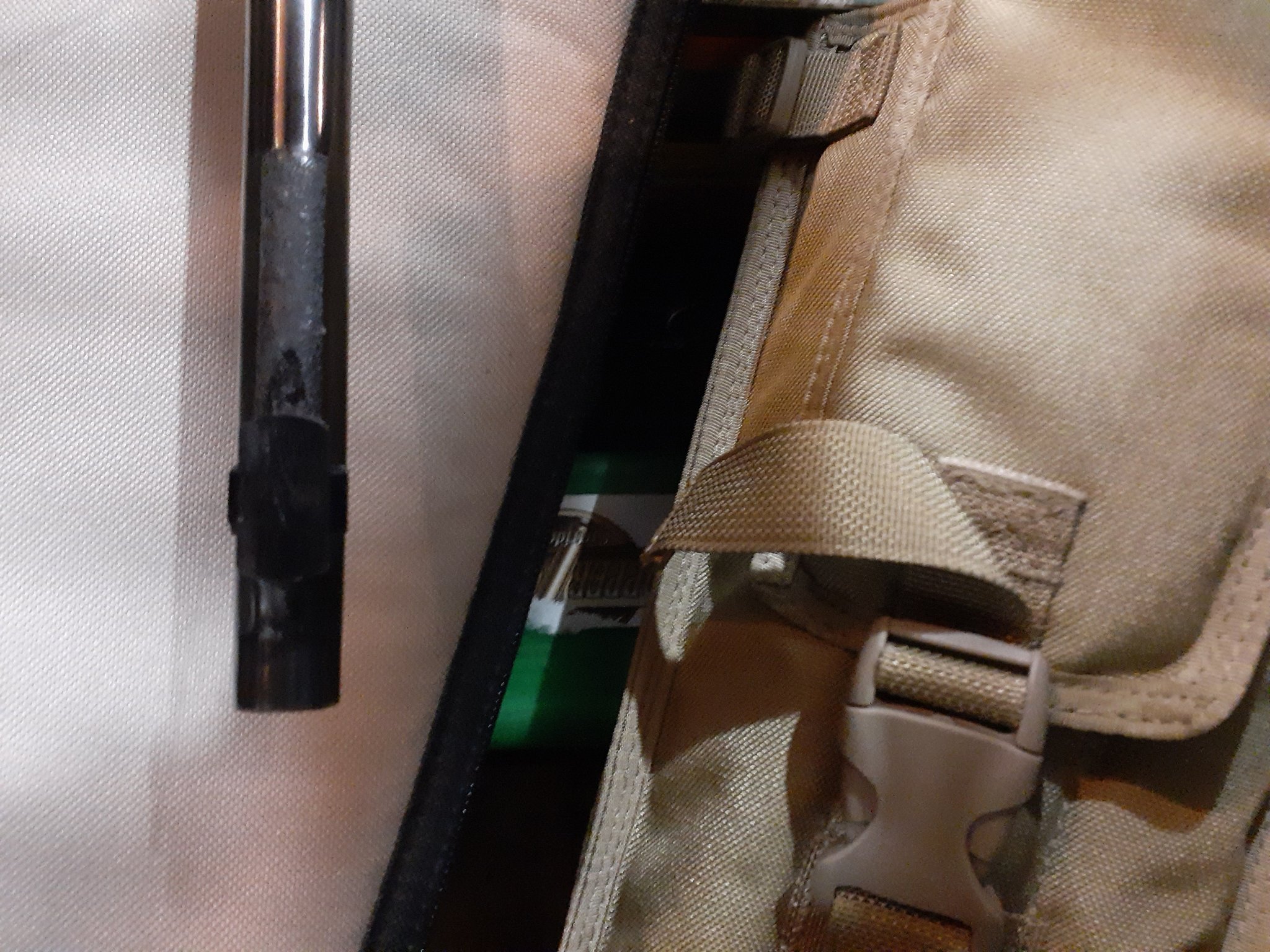

What's the front of the barrel look like.

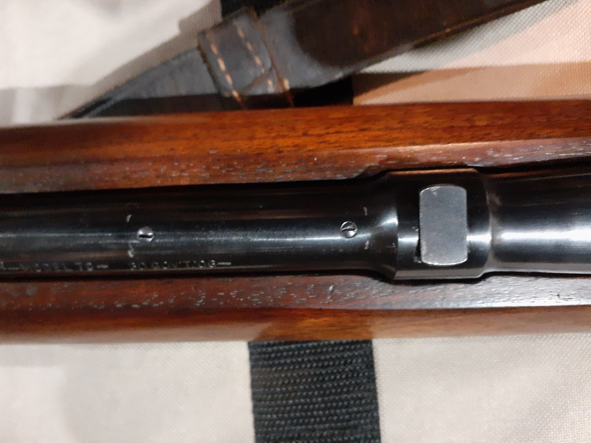

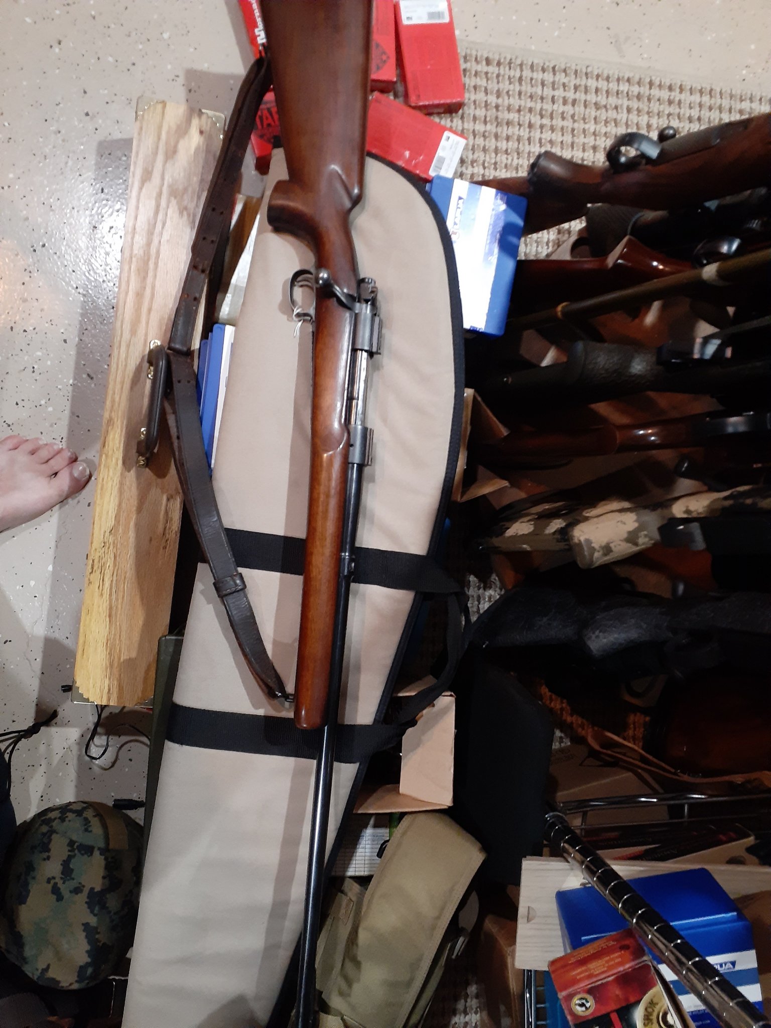

That's a legitimate nm. And with the light barrel, reasonably rare in the condition pictured. The rifle is correctly drilled for a Unertl. In front of the sight block and the front of the receiver.

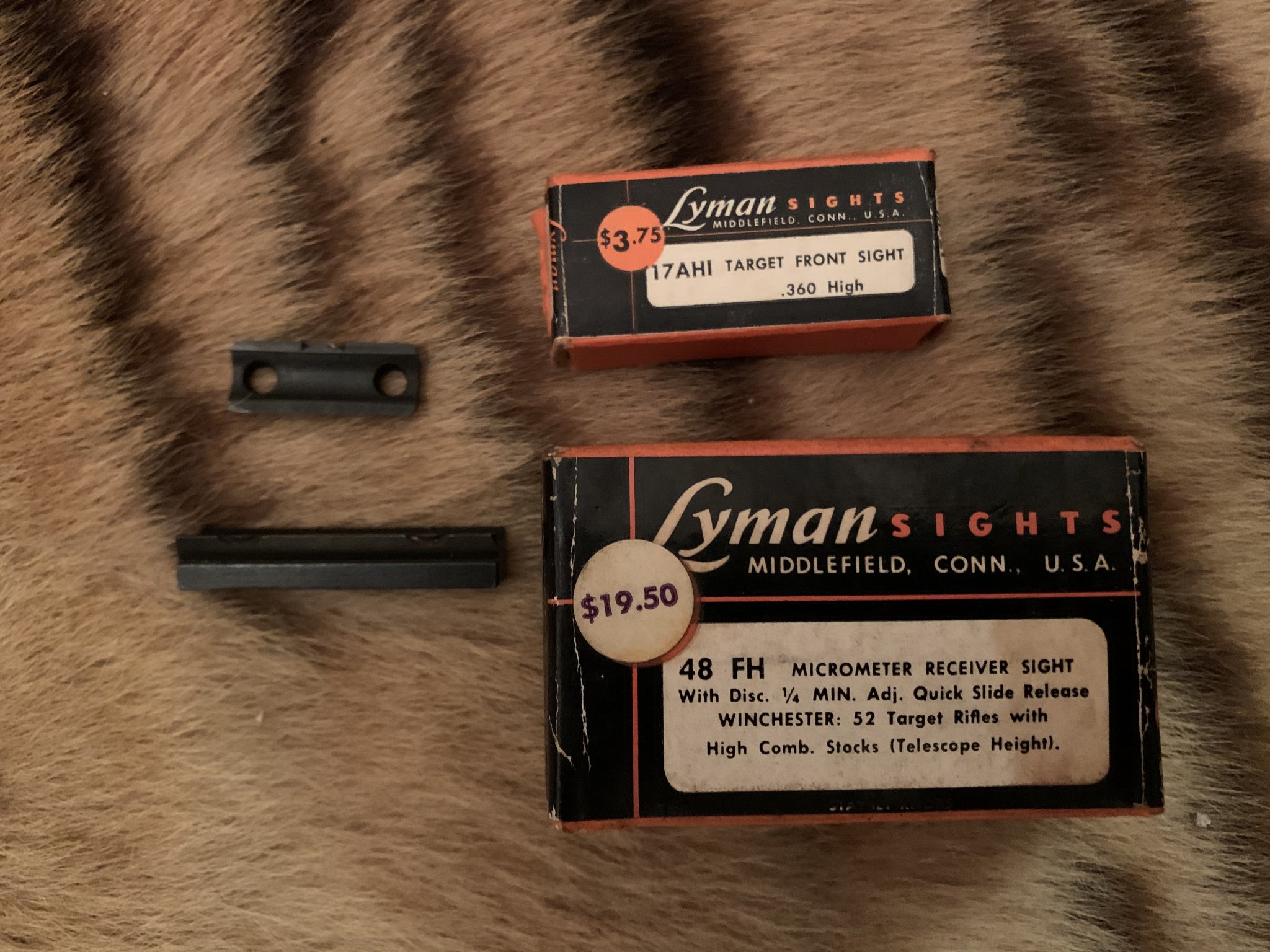

The 'what appear to be Lyman bases' on it are "owner preference" over the longer unertl RTB. It could have been a Winchester A5 or similar short scope.
It has the iron site rear base still on it. A side pic will tell us if it's a Lyman 48 base.
Be nice to see the front end...

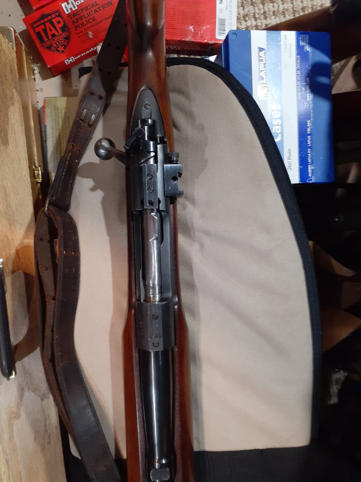

More plcs

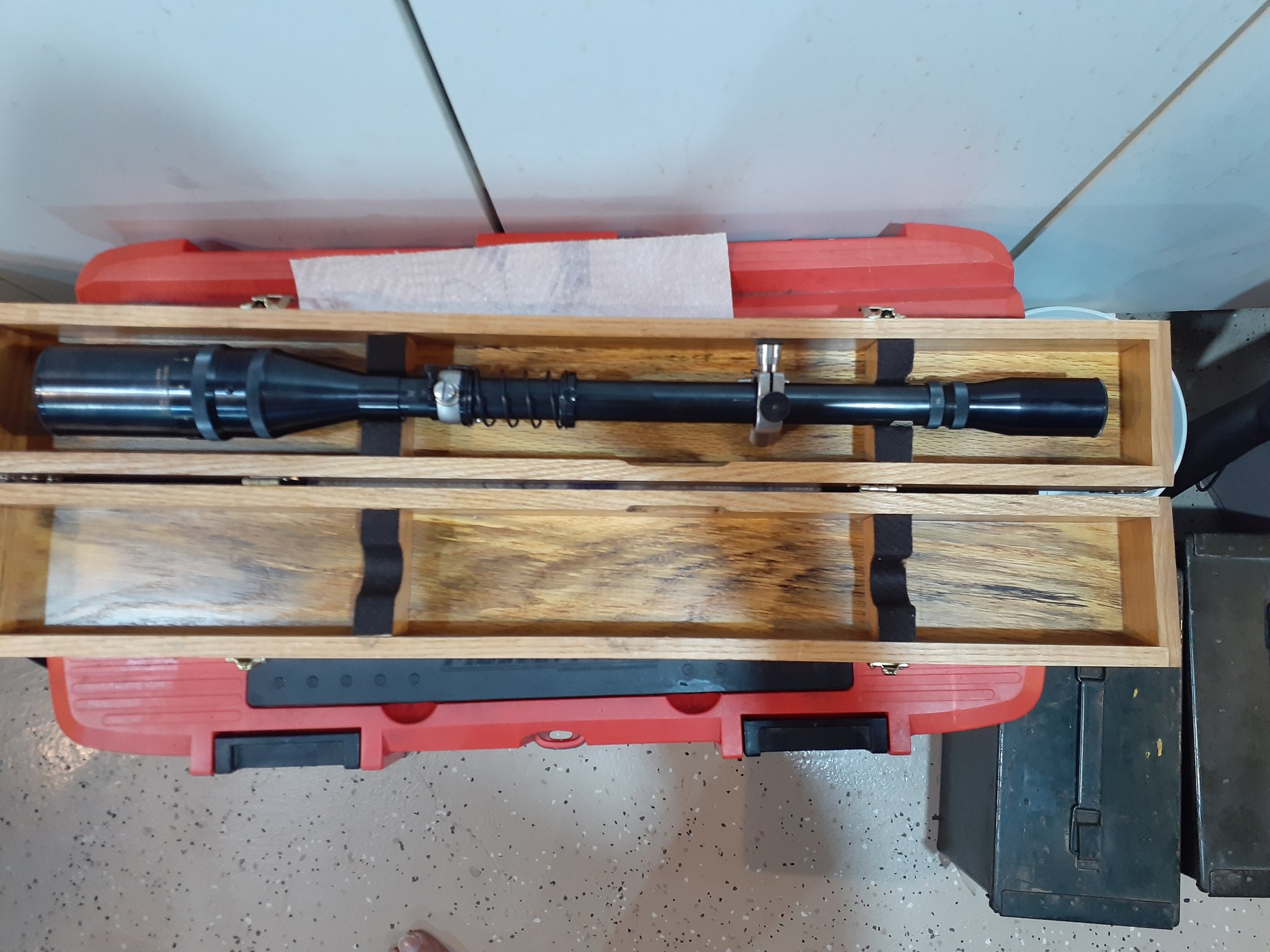

Hope these help would really like to mount the scope in the pic

Does the front sight ramp have grooves in the side of the ramp for a sight hood?

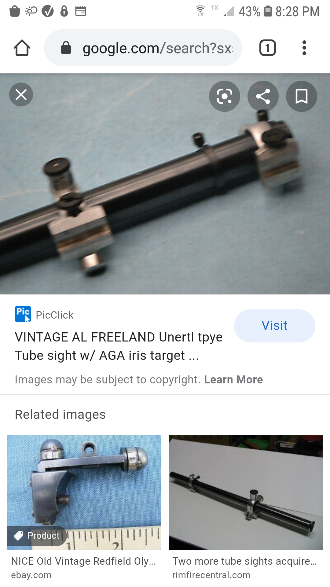

I can confidently tell you that those blocks are NOT Unertl. It's some other kind of vintage mount. Can you measure the dovetail widths? Also, take them off and see if there's additional holes drilled in the action.
From Rule's Rifleman's Rifle, the National Match Ramp lacks slots and machined grooves for a sight cover.
The ramp also has a lower profile than a standard front sight ramp.
Genuine unmessed with factory M70 NM's are rare, many now wear standard sporter barrels that were used to replace shot out factory barrels.
Most common are the fakes built up from parts that are fairly easy to come by still.

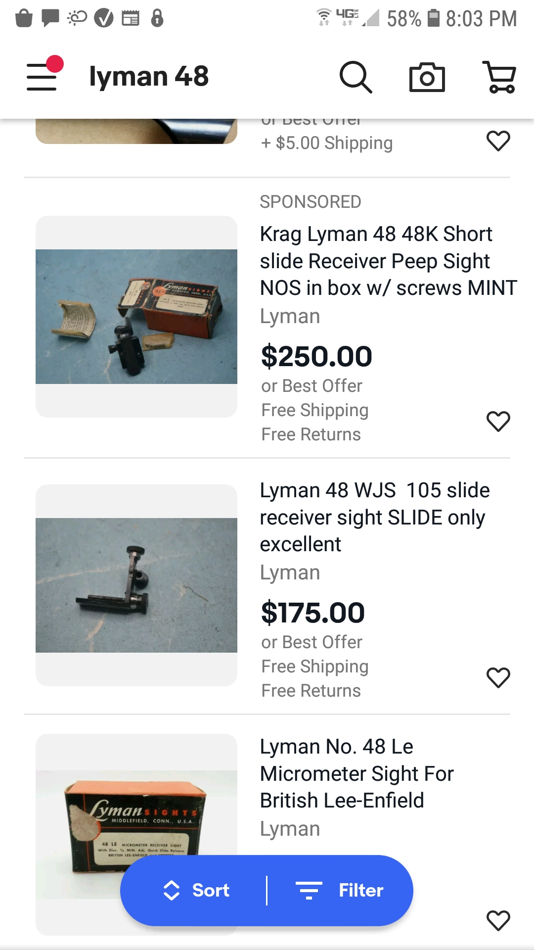

You might source a Lyman WH slide on Ebay for your receiver sight.
Look for WH rather than WJS to account for the fat barrel. WJS will work for most iron sight distances though.
Ive been lucky there. I initially found a WJS in great shape for my M70 than found a WH that should be installed when (if) my gun ever comes back.
I got real lucky and was the only bidder on a W slide blank and got it for less than $100. When I run my scope I will be able to slip the slide blank in the rear sight block and keep crap out of the dovetail - great accessory.

To the OP, mounting the unertl will be a challenge, on the nm barrel contour. Easy enough to remove the tube sight mounts off the receiver. And easy enough to find the correct front receiver mount for unertl. Champions Choice , lavergne Tn still sells them.
Finding the higher tapered front mount that goes on the barrel will be harder. Somebody with Rule's book can find the correct sight nomenclature or a 48/49/50 Shooters Bible would have it. Then finding one.........

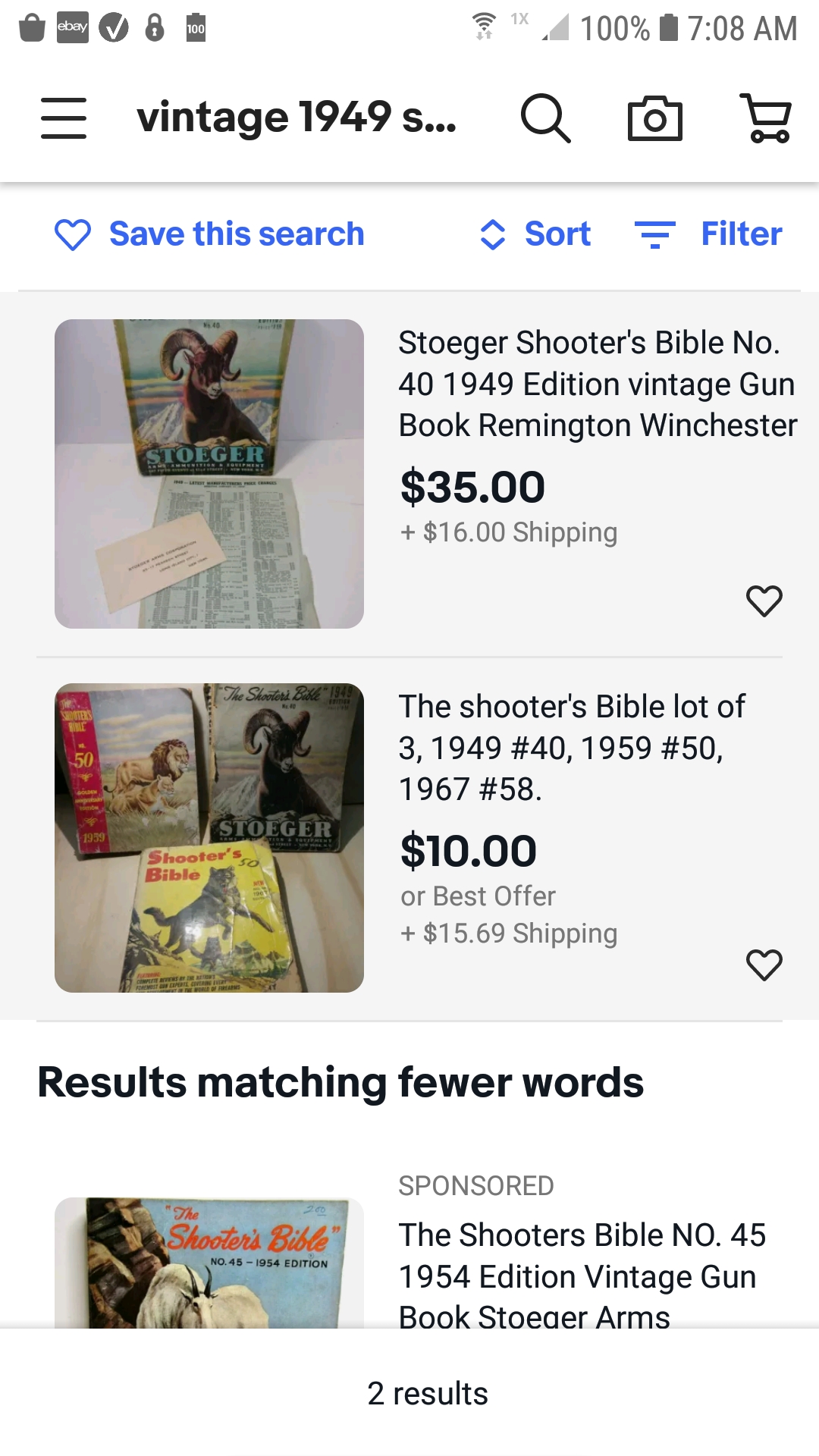

Somewhere in my stash of stuff is a 56 Shooters Bible and it was invaluable finding correct parts. However, two divorces back, it's well hidden......

Here's a pic of what your rifle will look like with a Unertl:
If I remember correctly the National Match rifle was made to meet weight restrictions while still using the heavier marksman stock for positional sling shooting.
You're correct about the weight restrictions, it was essentially a choice between a marksman stock with a standard barrel (such as what the OP has) or a sporter stock with a medium barrel. The marksman stock with standard barrel was popular with shooters in the late 40's to about the mid 50's. I'm not sure when the weight restriction was lifted, but this variation was eventually dropped as shooters gravitated towards other configurations.
The military shooting teams also used the marksman stock/standard barrel combo. IIRC, the Marines purchased 10 or 12 of them in the late 40's. A friend of mine has one and it had a US stamp on the side of the receiver, I think it had a USMC property marked Lyman Super Targetspot mounted. He sold it about 10 years ago, I wish he still had it.
I would not open that barrel channel. It is an original NM stock. Has value. More so if not glass bedded or pad.
This right here! The stock is original and it was specifically made for the standard barrel, don't mess with it.
As noted previously the front sight ramp would not have grooves in the ramp for a sight hood if it is a National Match Model 70. Also we could further determine the originality by having a picture of the oval proof marks and or if there is a sideway oval with a P inside to indicate it had been rebarreled by the factory. Also need the barrel date on the underneath of the barrel to see if it matches the date of the serial number of the receiver serial number. If I was buying what was said to be a authentic National Match I would want to see above all match up. I agree that the stock is from a National Match but that alone does not make it one.

I want to correct a couple of things I posted.
First, the holes in front of the sight boss are correct. I had forgotten that.
Secondly, after reviewing additional non posted photos of the rifle the barrel is correct and original.
