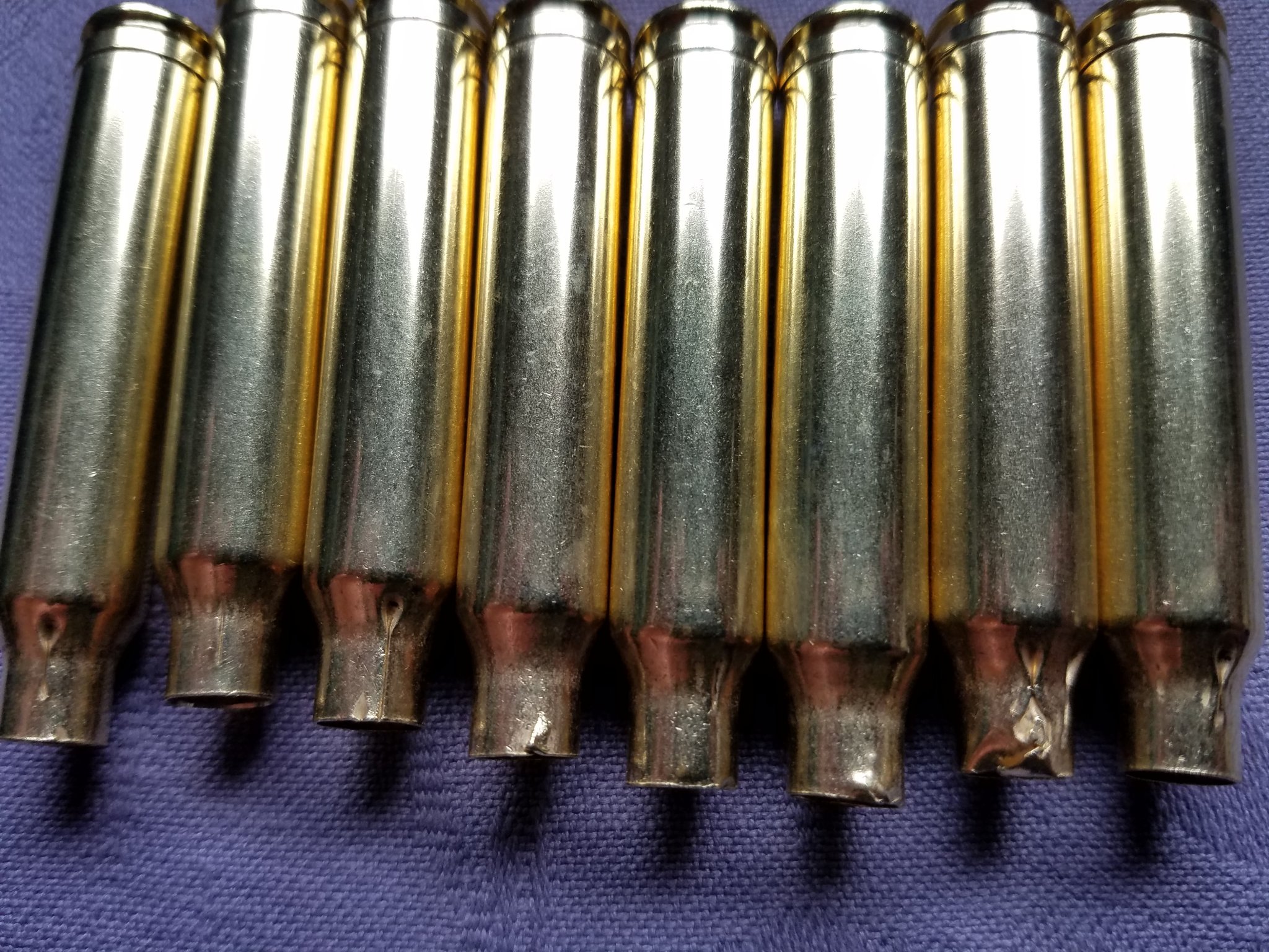

Winchester Blue Bag is fine, but be prepared to cull like 6-8 outta 50 right off the bat. I ain't say'n their QC is shit, it's just NON-EXISTENT. The destroyed, and I mean DESTROYED shoulders, necks, and mouths are almost comical, but not.
Nosler, Norma, and the like are obviously really good, but spendy. I load many 300WM's for a lot of people and have used everything under the sun for them at their request. Just remember when bouncing back and forth to pay attention to the different case capacities.
Very well stated! I have had great luck with Winchester brass, however the "cull rate" is increasing to the point that the Winchester brass is becoming only marginally less expensive than Norma, Nosler et al!
