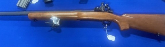

This is a Winchester Model 70 factory .308 match rifle, built 75/76. It has been referred to as the Ultra match, Palma Match or International Match (different stock). This rifle is the same model used to build Carlos Hathcock's retirement rifle, the M70 / M40A1 with the greenie. It is a very specific design to the receiver and the clip slot. It is a long action rifle with a short action ejection port. Very few of these rifles were made and some of the variants are quite rare. This particular variant is a late, 3rd variation. It has an externally adjustable trigger. It is adjusted via 2 screws in the striker channel in the receiver. Will post better pics this evening. Rifle comes with Redfield international sights, front and rear. Most of these rifles went to the military or to Palma teams when hosted by the US. The rifle is in excellent condition, bore is as new. Some small marks on the stock. Rifle is all factory. Don't do pay pal, sorry. Happy to provide references. $1500.00 shipped to your FFL. Serial number range G119xxxx.
How many rounds down the barrel? Is it the original barrel? The original barrels are hammer-forged, with a deep recess at the muzzle. Is the felt on the handstop worn, or has it been replaced? Has it been bedded? These are some of the best shooting rifles in the world, and I have only ever seen one in this kind of condition, with an original barrel. Not only is the trigger externally adjustable for pull weight and overtravel, it is not the same design as the typical Model 70. Still, it is a robust design, and has great feel. It is an Ultra Match. This is a really good price for such a rifle, especially with period-correct sights, which by themselves would run $200-300 minimum.
All correct, original barrel, felt in commensurate shape for being attached to the rifle all its life and not moved around (all there but flattened out). Unknown round count but would have to think very few. No visible ring on bolt face. It is bedded. I have read that rifles this late were all custom shop rifles and were bisonite bedded at the factory. Have also read these were noted as "Ultra Match" variants as the barrels were considered to have been "ultra rifled" , not just a standard factory barrel, as per Winchester advertising. This rifle is not marked with the Palma Match Centennial markings.
