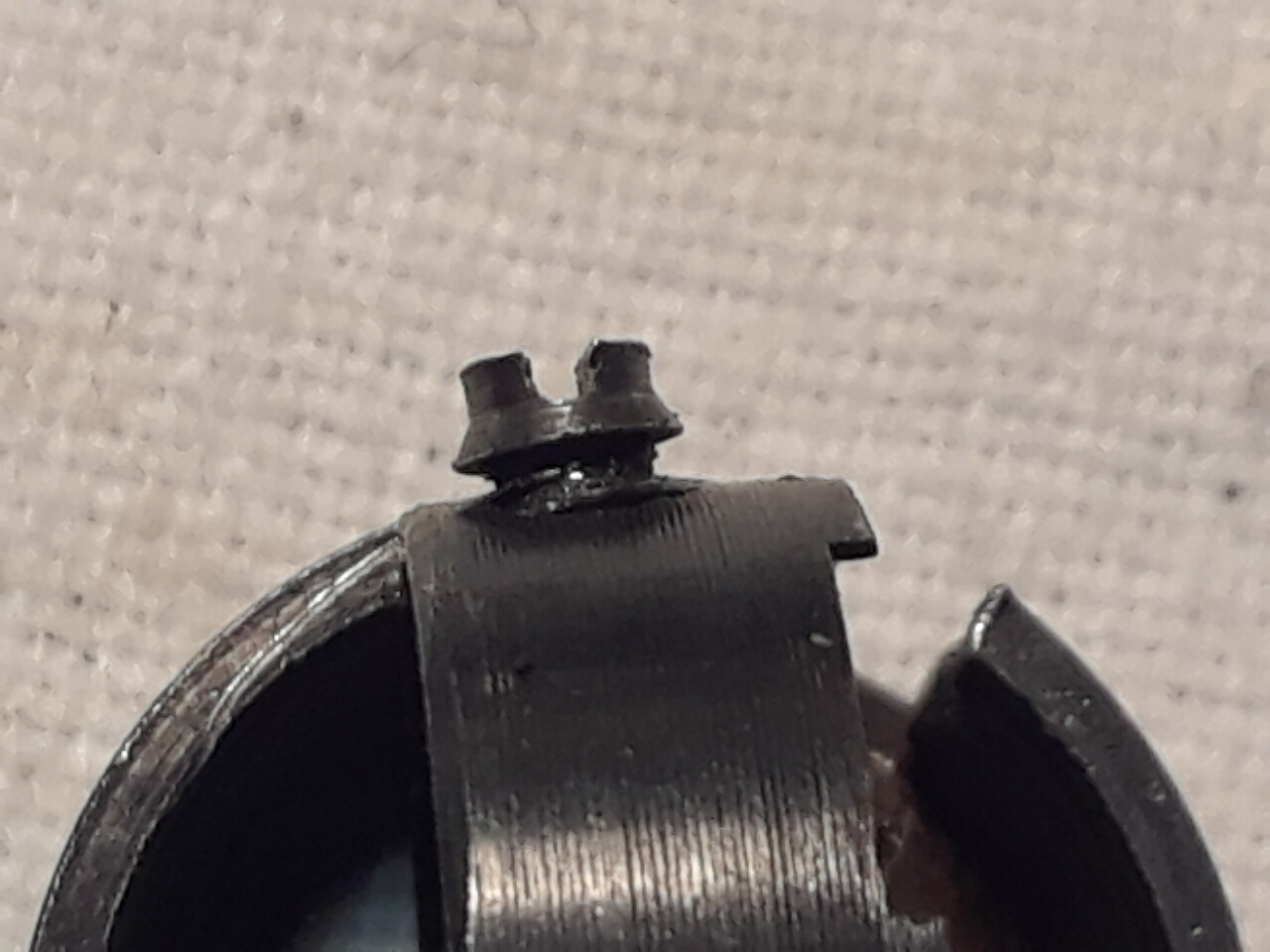

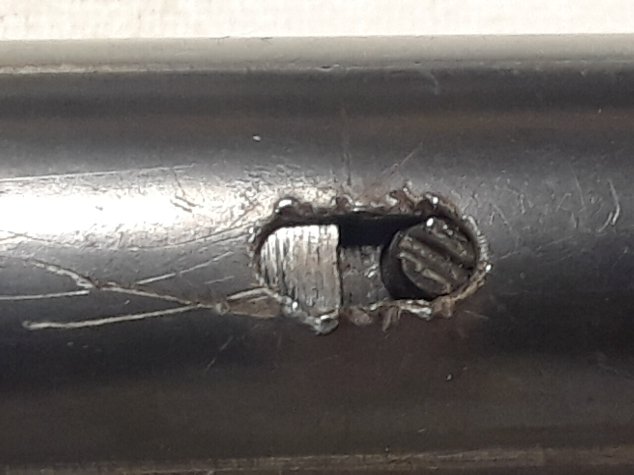

IMPORTANT !!!!! The tube in the video has just been buggered....
The screw holding the cross hair element is a RIGHT HAND THREAD!!!! and to remove the cross hair housing it threads into the cross hair retaining housing and not OUT!!!
If you turn it left you force the collar through the tube hole enlarging it allowing the housing to slop around and usually strip the head of the screw..
The entire cross hair assembly comes out the rear of the scope with the screw turned INTO the holder.
The screw has an inverted cone on the head and I can see the damage to the hole and the tube from just looking at the tube in the video!!!!
I have a picture of what happens when you take the screw out as a conventional screw.
The collar on the screw is LARGER than the HOLE in the tube.
I will post a picture of the screw and the cross hair holder as soon as I find it on my phone.
I keep a record of all the little foibles of scope repair on the scopes I work on and just have to find it.....
Found them .....
Picture two is what happens when you back the screw out.
When this happens I have to planish the tube and get it back to dimension for the screw head.
I have the mandrels to repair this and also another tool to remove the erector cell from the OG end.
You can see on picture #1 the reverse cone head on the screw and on picture #2 how I get most A5 scopes...
Found them .....

I was not the one who posted the video, I was just trying to keep someone from buggering up their scope by forcing the reticle holder screw through the tube and damaging it.
The screw to remove the reticle block threads INTO the reticle block and not out, just enlarging the hole to the point the reticle is loose in the tube.
The original method of retaining the reticle holder is a real mickey mouse way of doing it and I wonder why it was ever done that way but who am I to second guess an engineer or scope designer.. I just try and fix the damned things !! :oops:
