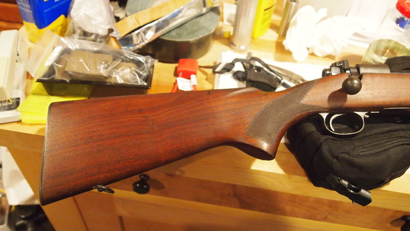

    Well that was cheap but while there I thought lets check out the Gun Library. First thing I saw was a Garand with about 3 inches cut from the buttstock end creating this "stumpy" stock Garand priced at $1300. The Library guy wasnt impressed when I said a little too loud "There is an expensive Garand".

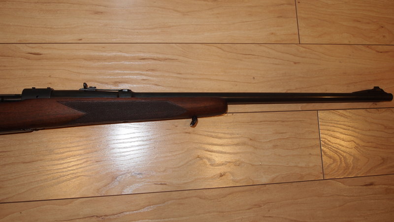

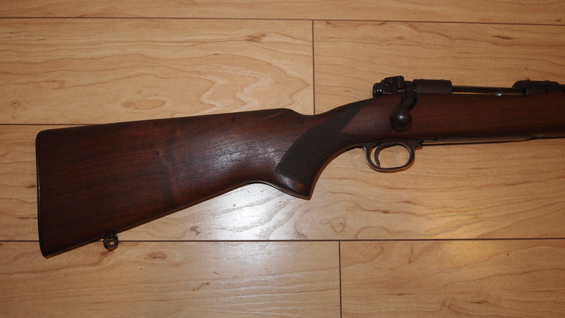

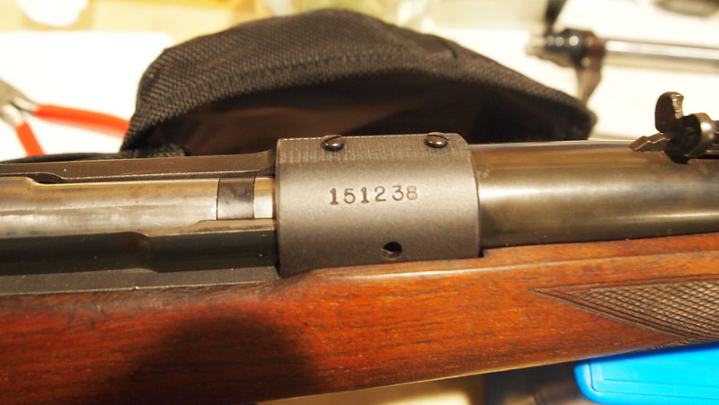

    But along the wall was a 30-06 M70 Sporter, Pre 64, Serial is in the 150K range. The stock on this rifle spoke to me. Its a nice red Military spec linseed oil finish, no shine just well loved by hand. The stock is pretty clean save for some handling marks and with a fresh coat of linseed it will glow. The metal is a matte blue looking almost like park on the receiver while the barrel is more of a semi gloss blue. The only thing polished blue appears to be the safety and shroud.
    $999.99 was the price.
    Im looking at this aborted Garand for $1300 and there is this Winchester that when you look up "Badass rifle" this is the picture you get.
    Im thinking to hog out the sporter barrel channel, replace with a Douglas in the USMC profile, add some blocks, presto chango a Unertl and Im good to go.
    Didnt buy it today but put it on hold. Salesguy said he would be interested in a last ditch Arisaka I have. Im thinking if I can get it for $800 even thats not a bad deal for a great start to a Hathcock tribute.

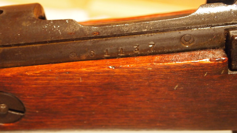

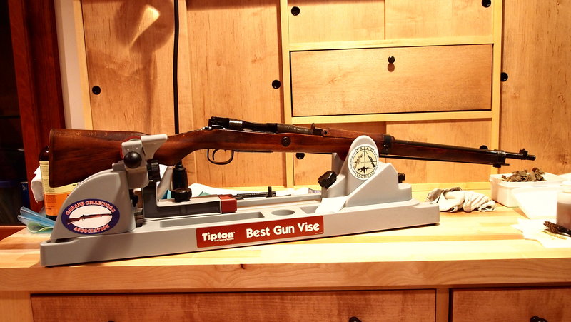

    What type value does an Arisaka last ditch bring?
    I did a "completed" search on GB and a couple of mint ones went for $380 for and and $395 for the other. Neither was a last ditch. One had the mum ground off and one still had it. i woulda thunk that mattered more. But, the price is going up on these. Last of the WWII era surplus you could still get for under $100.
    A store down in WI, just north of Wassau had one for $500. They get a lot of offers but it's been there a couple years.
    I'd say yours is at least $300.

    The Arisaka scored me a savings of $210. Im into it for just under $860.00. Pre64 has sling swivels in route. I need to get some Winchester receiver plugs to fill those abominations on top until I get my Unertl blocks.

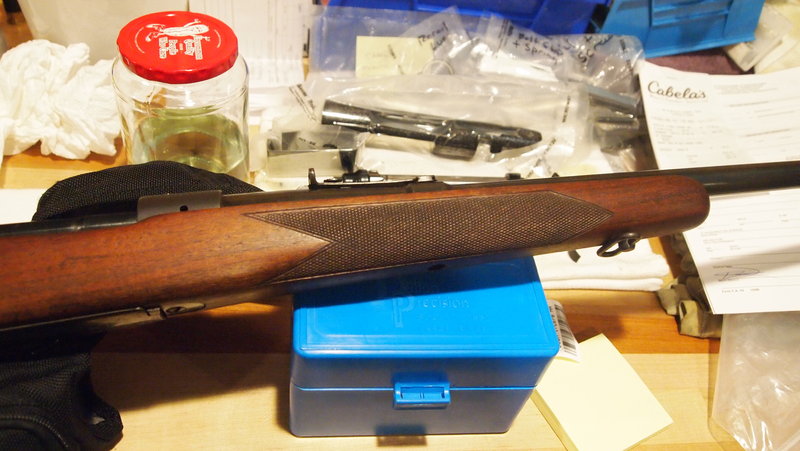

    Im thinking I saw pictures of some sporter stocks that retained their checkering. The pic I posted of the USMC sniper is dark and I can't tell if it's checkered. I don't think checkering was ever included on the target and team stocks.
    As it is I can live with it. The wood is what attracted me to the rifle. I love the mil spec red. Had it been glossy like most of these are I wouldn't have bought it.

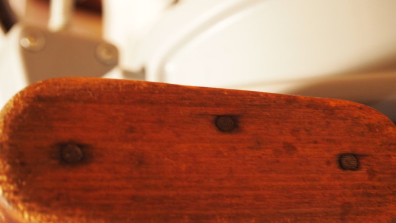

    Trying to discern what the best linseed oil to use to continue the red oxidation would be. I usually use pure tung oil on my stocks, which may not be a bad choice here as it tends to stay the color of whatever it is on, linseed can go black and I don't want that.

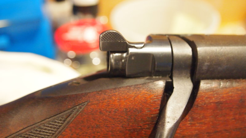

    Flag safety and Winchester receiver plugs installed. The silhouette of my faux sniper is a little bit more legit and those proud of flush receiver plugs screws that came on the gun are gone...

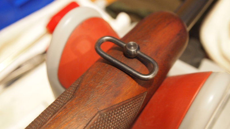

    also got some 1.25 inch swivels that will accept a GI M1907 or 1960s era Nylon M14 sling. Leaning toward the Nylon OD sling on my Vietnam era faux snipers...

    i hadnt realised the different bolt shroud/ safety assembly types, would interchange so readily. Had just assumed because movement direction of the safety was opposite between the type 1's & later, that they wouldnt. but goodwork on finding that out, its handy to know.
    Is it glass bedded, as yet? i suppose you will wait for a heavy barrel, first.
    Im glad you mentioned the safety but I must admit comments and my OCD have turned what was an impulse buy and thoughts of creating a cheap sniper into an incrementally more expensive making of a toy.
    I was surprised also the assemblies would so easily swap out. Not so much for the function but for the machining.. All three assemblies are interchangeable but Im not sure if individual parts are interchangeable amongst assemblies.
    Function wise, and for the most part manufacture, an M70 is nothing but a Springfield 03. On the 03 there are reverse safety assemblies that were direct replacements. Competition shooters favored them as it swung the blade over to the right and shooters that went nose to receiver wouldn't get whacked by the blade on recoil.
    Maybe another WRA/Springfield similarity except Winchester didn't change safeties as a function issue Im guessing more likely a cost matter.

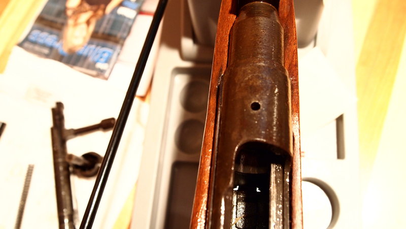

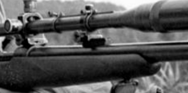

    The one detail bothering me now is the barrel tension screw in the forearm. USMC snipers in Sporter stocks were from WRA with the heavy target barrel and those rifles did not have the tension adjustment. So I want to get that hole in the stock plugged. There are guys that do invisible stock repairs using old GI walnut for repair wood. I need to find one of them.
    I think I know where Im going for blue printing. This party has a target rifle receiver and has offered to take my receiver and his to a local machinist to replicate the clip slot after blueprinting
    Barrel will be a Douglas heavy to represent a rifle that had been rebarreled.
    Kind of concerned about the amount of wood that will be hogged out but it worked for the USMC and I haven't seen anything that suggests the WRA match barrel sporter stocks differed from the standard stock save for the tension screw.

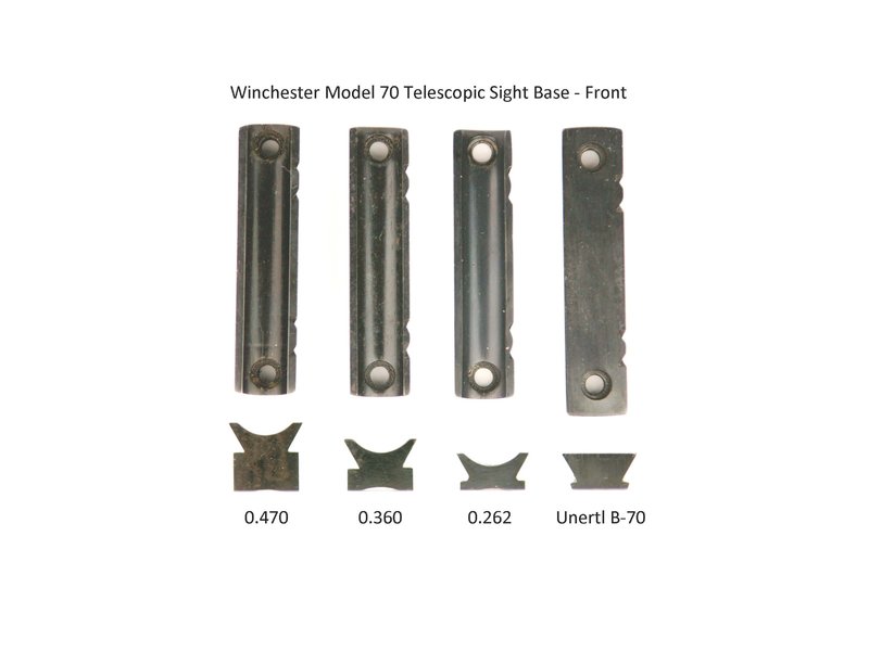

    Probably use Steve Earle scope blocks.

    8. Install blocks for Unertl scope to achieve 1/4 MOA adjustments. I can order Steve Earle blocks. I assume the USMC probably reused the WRA blocks taken off the match barrels they were replacing. If you have proper blocks Ill buy from you.

    I want to get the hole in the stock for the barrel tension screw plugged. I know there are guys on the CMP forums that do magical invisible repairs on much more difficult jobs using old vintage walnut from GI stocks. I can get it done before sending the gun or if its something you can do Ill leave it for you to plug.

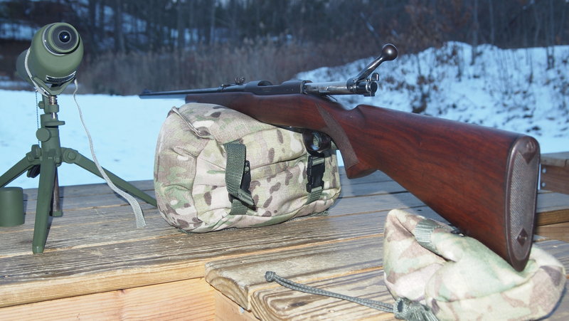

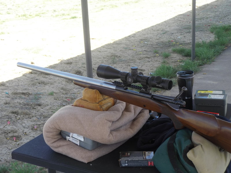

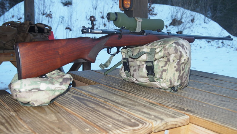

    First three shots were off paper. Two things were at work I think to create the misses.
    1. I had decoppered the barrel
    2. I had no idea what setting the rear buckhorns were on. I started out at three steps up on the elevator as it came from Cabelas.
    Fourth shot hit paper high so I dropped the elevator one and got another high below the first one. So I brought the elevator down to the last step and hit black. Than I just started flinging them. Looks like the favor left but they did okay for being shot by a guy that had a clear front sight but not much could be seen of the black and the slight line of white I was trying to hold.
    [IMG2=JSON]{"data-align":"none","data-size":"full","src":"https:\/\/i.imgur.com\/92mDVV4l.jpg"}[/IMG2]
    What was nice is how well the magazine of the Winchester works. Its M1903 Springfield solid. My Remington followers seem to float and if you are not careful you screw the pooch loading them in.
    Its a light rifle. For every hit Carlos gave he got a little bit back. With a 6 pound Douglas in front of the receiver that should tame some recoil Id think.

    In the photos above original WRA barrels have the front sight block. The picture of the 3rd Mar Div sniper in the high kneeling with forearm support appears to be fielding a Douglas barrel.

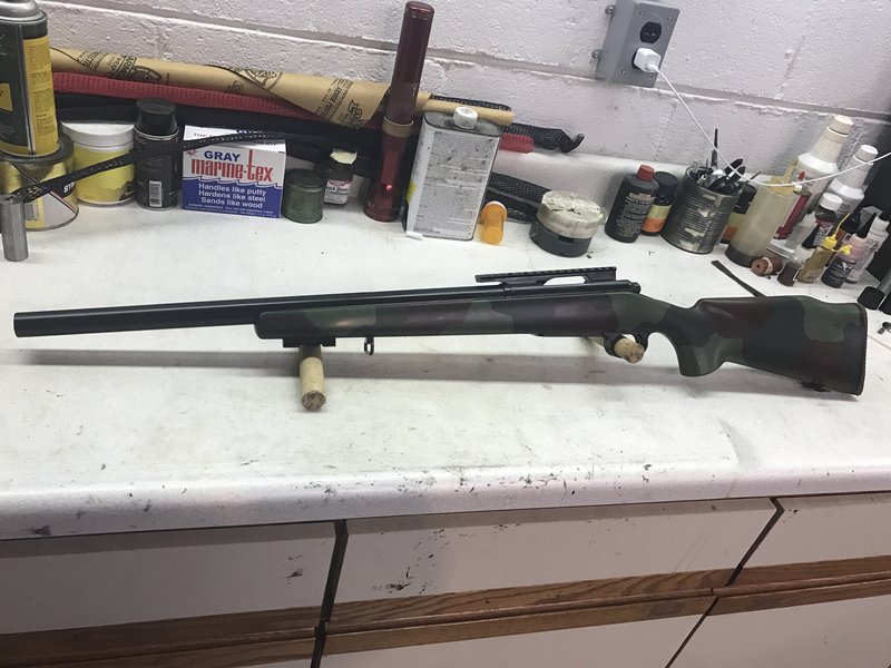

    Talking to the builder it has been decided he will true and fit the barrel from a blank.
    .870" is quite the truck axle ;)
    Try as I might, I've never found any definitive info/drawings for the Winchester clipslot. There was some conjecture that the machining details for the WinM70 were the same for the Remington700/M40, however i dont remember whether this was found to be true or not, it just sounded a little too convenient for me.
    Best bet would be to send your action to someone with a factory clipslotted pre-64 action for reference, to do the machining.
    As for bedding, i'd definitely go "all out" below the stockline, so pillars & glass bedding etc. ostensibly it will look correct, no-one will know any differently.
    Yes Steve Earle for the scope blocks, thats what ive got for my project, (though its still W.I.P)
    below is from an email conversation i had with him, re model70's & the medium/heavy barrell
    "The great Unertl chart lists a standard 1/4" block for the rear, and a B-70 block for the front. The B-70 is a long block with a hole spacing of 1.75". But it's only 1/4" high as well, and from my experience that has not been high enough. Generally we've been using C-70 on the front, which is higher by 1/16"."

    Im not trying to make a copy of the rifle the Gunny was presented by PWS (though I missed a golden chance to as there was a long action Smear McMillan in the for sale section a month or so ago).
    Im making a Vietnam sniper based on the CRF actions that the USMC had bought back around 1942 or so.
    Mine will be an impression of one of those rebarreled with a Douglas heavy.
    Ill need to cut a clip slot and even than there are some differences in the tang.
    Some details will have to slip by.
    Very Nice Sand.
    I see a stock bolt, magnum action?
    Oxide that barrel black and we will be brothers from another mother.
    You from the less straight, Monte Carlo side of the family.
    I like how that bull barrel makes that stock foretip just disappear as the mass of the barrel swallows it up.

    That's actually a standard PRF long action (they didn't make short actions until 1985). The fore-end is actually reduced somewhat as I hogged out the barrel channel with sandpaper and a dowel.
    I'm getting really frustrated with this bullshit of being unable to post my groups from Saturday! IMG_20171218_152137290.jpg
    Finally!!
    The group the Winchester put out is the five shot hole down and to the right of the center. The bottom-center, left low-center and left high-center are my Savage 10FCP. The lone hole between groups is my 25-20. Same as the upper three.
    Funny how stock fit meant so much on Saturday. I got in behind the Winchester and everything felt solid. Even though the bags were frozen. The composite stock on the Savage, even though it's the good one, slid all over the place on those frozen bags.

    Anyone know what height scope blocks Winchester shipped the 41-42 year guns with?
    The Lance Corporal looks to be using an M70 that has been rebarreled with a Douglas #7. That is the style rifle my project will end up representing.
    Did the Marines just recycle the blocks from the thinner barreled WRA originals or did they use a different height block because the Douglas barrel had a different profile?
    Most of my shooting will be within 300 yards but Id like to be able to dial for 1000 yards on occasion.
    It would be nice if when I get setup I can operate the bolt with good clearance from the scope and at my regular short ranges I can get a cheek weld not a chin weld.
    The 373 model 70 shipment in 1942 were just standard hunting rifles with standard barrels and open sights. They wouldn't have had any scope blocks on them.
    The consensus is that these standard sporter rifles, had the sporter barrels removed, the stock channel opened up, and a target barrel installed. Then the blocks would have been added.
    I honestly don't know on the douglas barrels. All the take off barrels I have seen or seen on rifles that I think might be real USMC model 70's have been the factory 50's dated WRA barrels. 1952, and 1956 seem to be the most common. I know the Marines did use some Douglas barrels on model 70's. Some have been for sure Marine take offs, but I honestly don't know what era they were used. Or any specs on them really. I'm guessing the 60s or later, maybe even into the 70's. But I honestly don't know.
    The pics in Nam, on the ones you can tell the blocks, they seem to be the U shaped factory WRA scope blocks. Which would make sense. I have so many orders where the Marines ordered not only rifles but parts from WRA. My first orders from WRA that I have found to the Marines were in 1917 and I have them way past WWII. Heck the Marines were even ordering Winchester target barrels for 1903 rifles from WRA. They were heavy barrels that were like 26 or 28'' barrels.
    But in that famous pic when you blow it up you can see the U shape of the WRA blocks. Which WRA made like three different heights. One tall one for the sporter barrel, one medium for the regular target barrel, and this is the one I think you want. And the shorter one for the heavier bull barrel.
    Here you can see the U shape WRA blocks and it looks like the medium one to me. The .360. The .360 is also on my Model 70 from the RTE shop around 1971.
