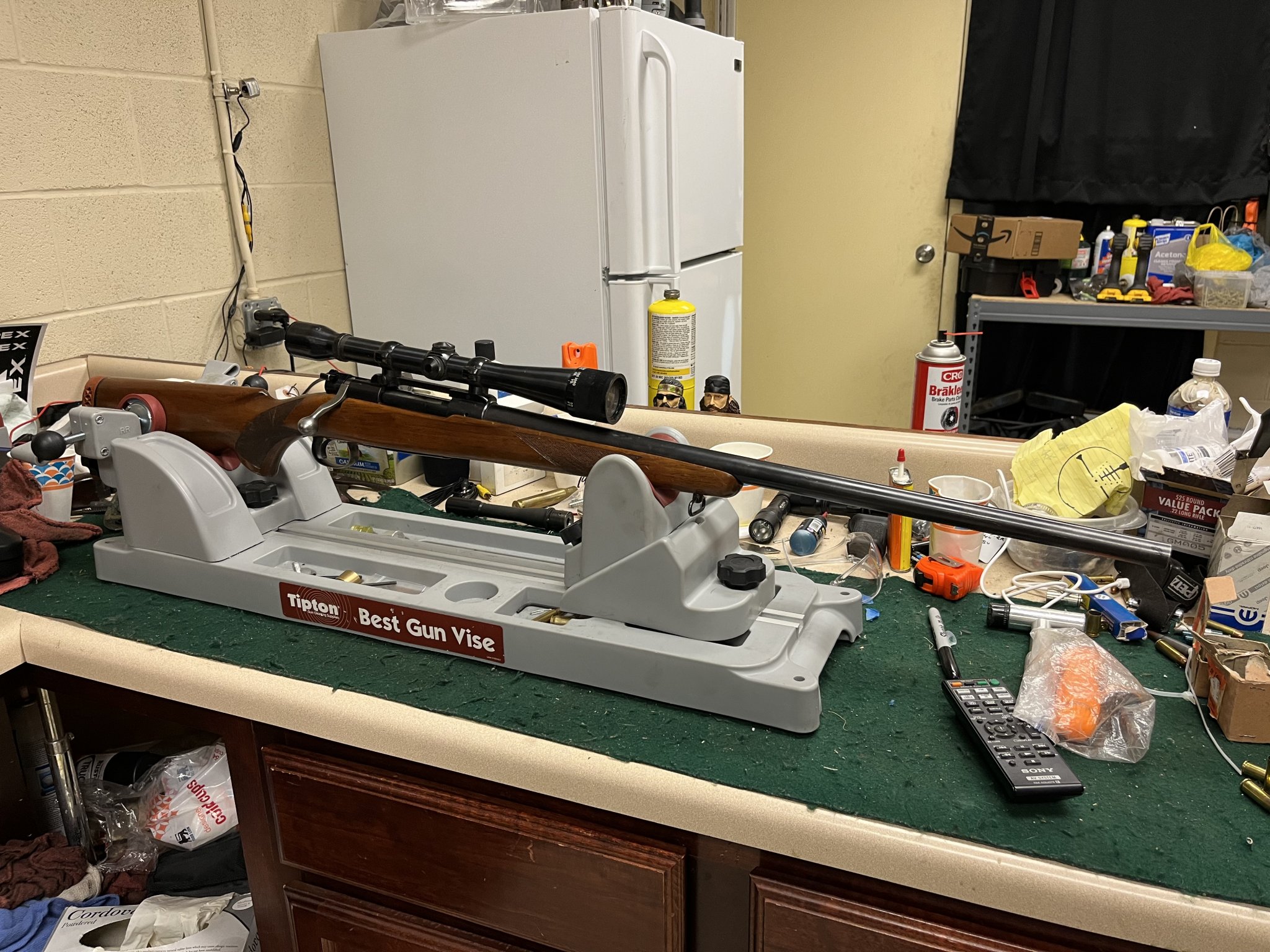

May have stumbled into a Model 54 today. Who knows any about them. I know what I have read online so far. Seems to have been rebarreled so I gotta find out caliber, but I was told 22-250. It’s a monster of a barrel and has “Lovell” stamped on it. Serial number is 40452A IIRC, which should put it manufactured in 1933. I know those was the predecessor to the model 70 in some design aspects. What’s the collective knowledge here on these. Pics to follow when I get back home

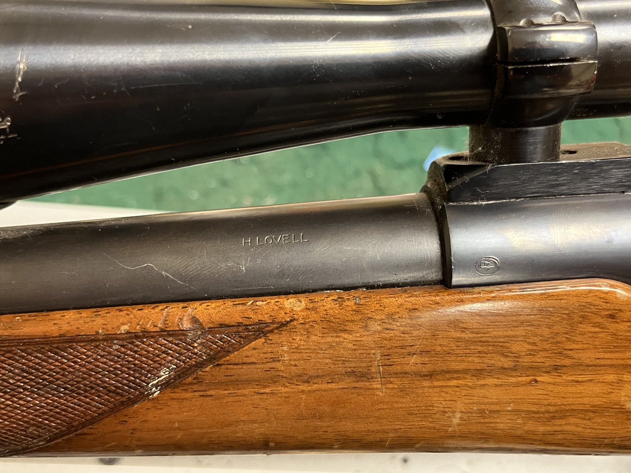

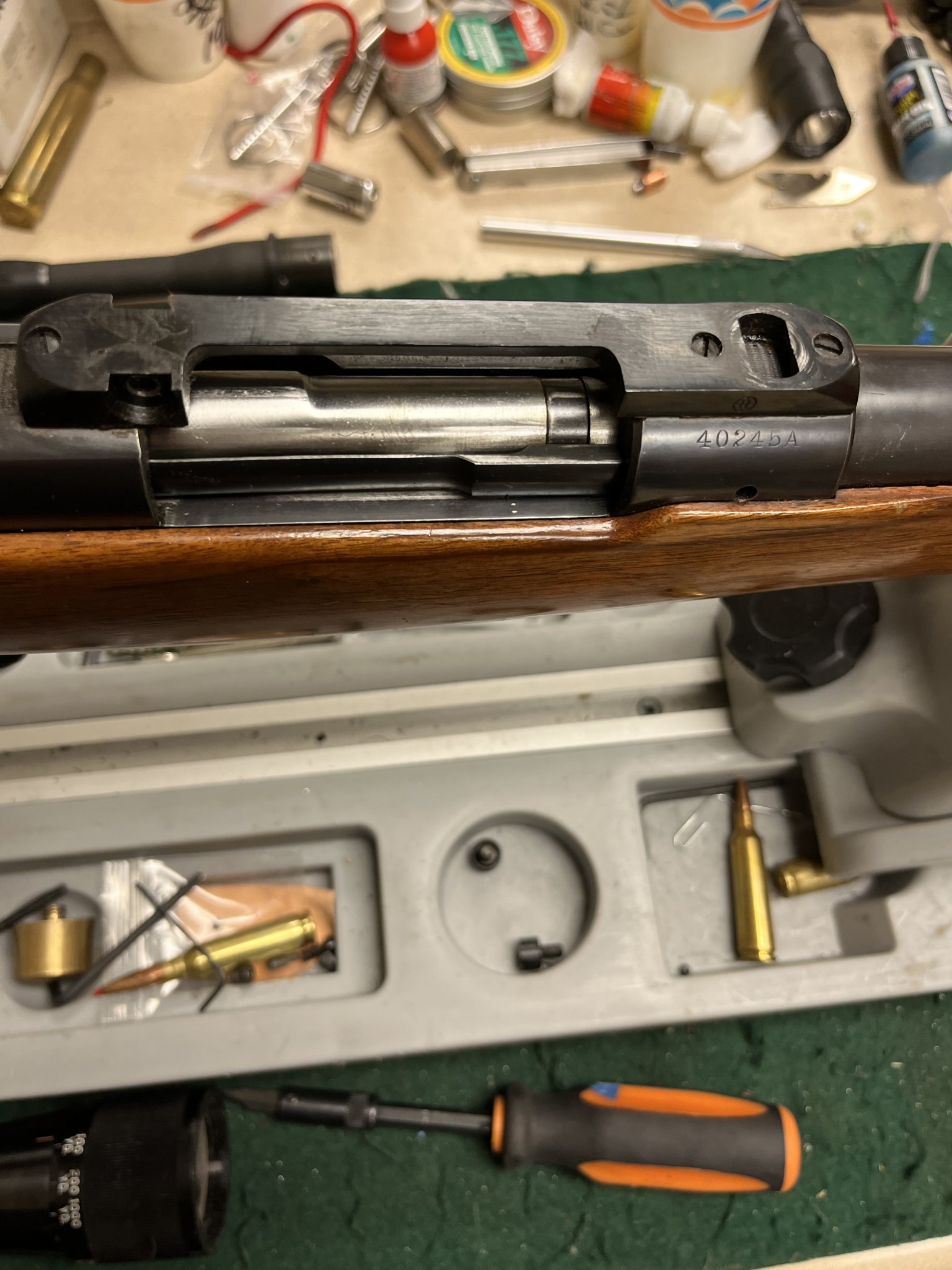

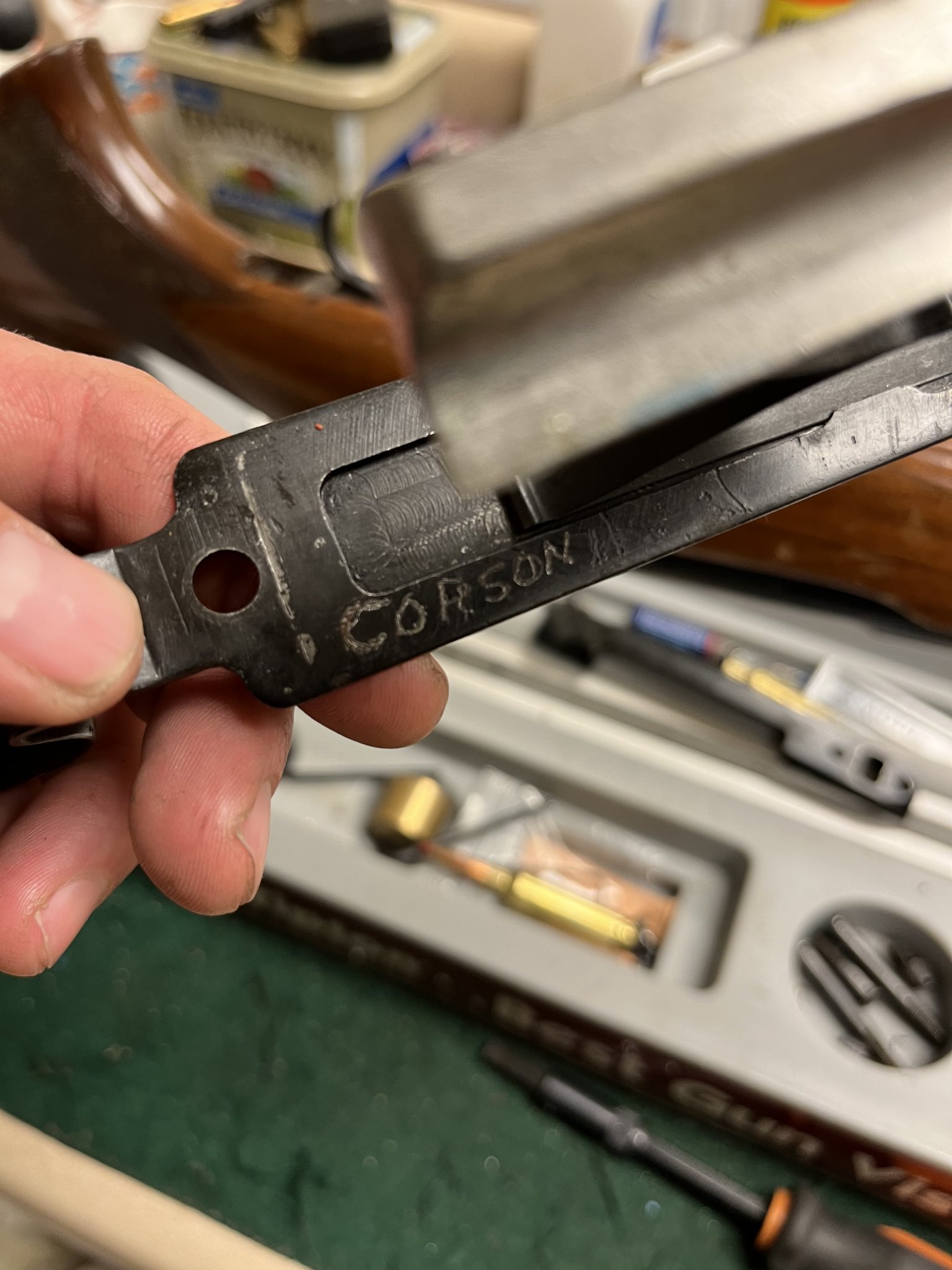

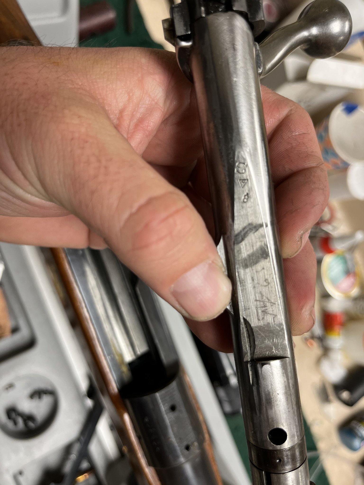

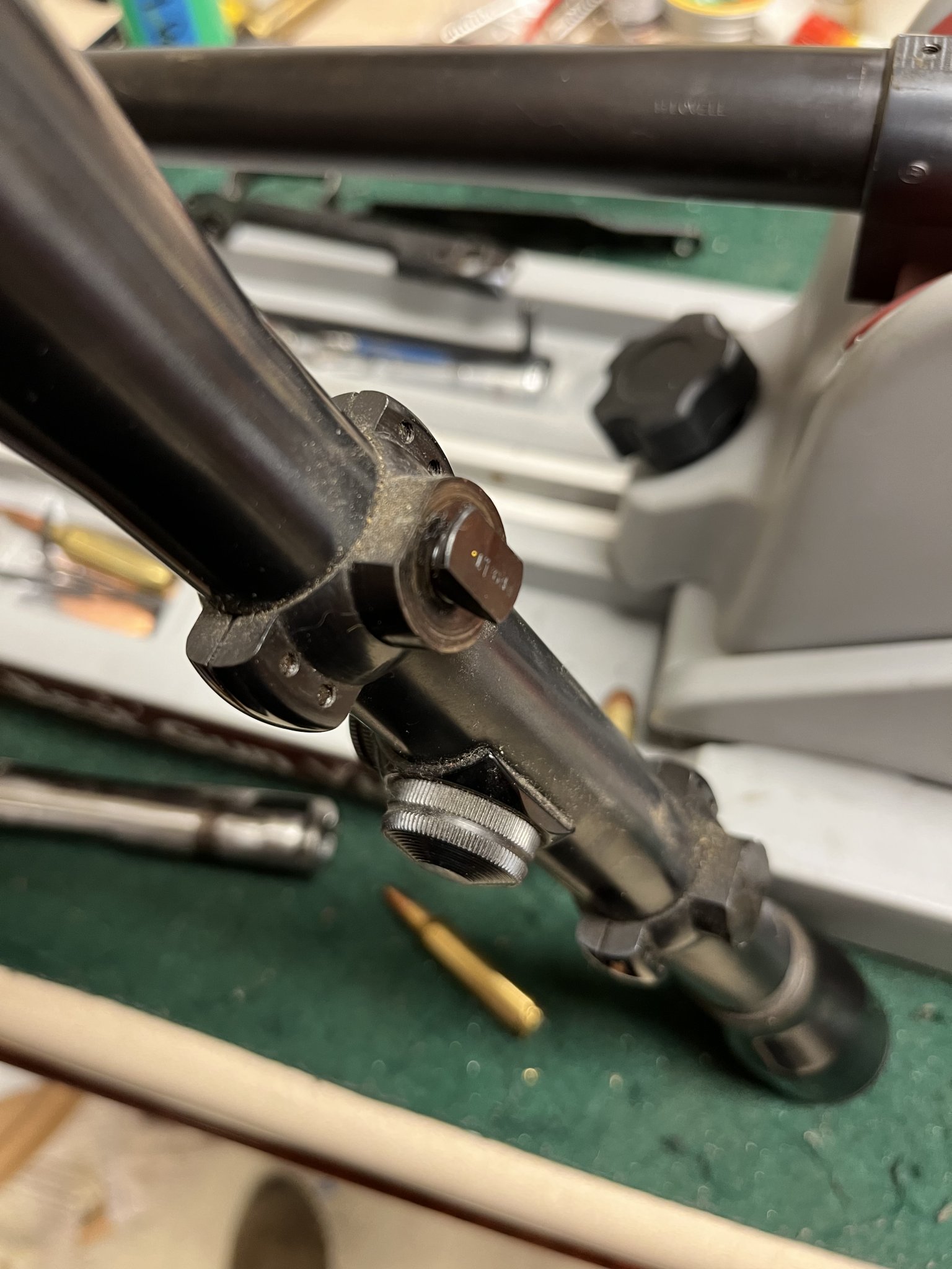

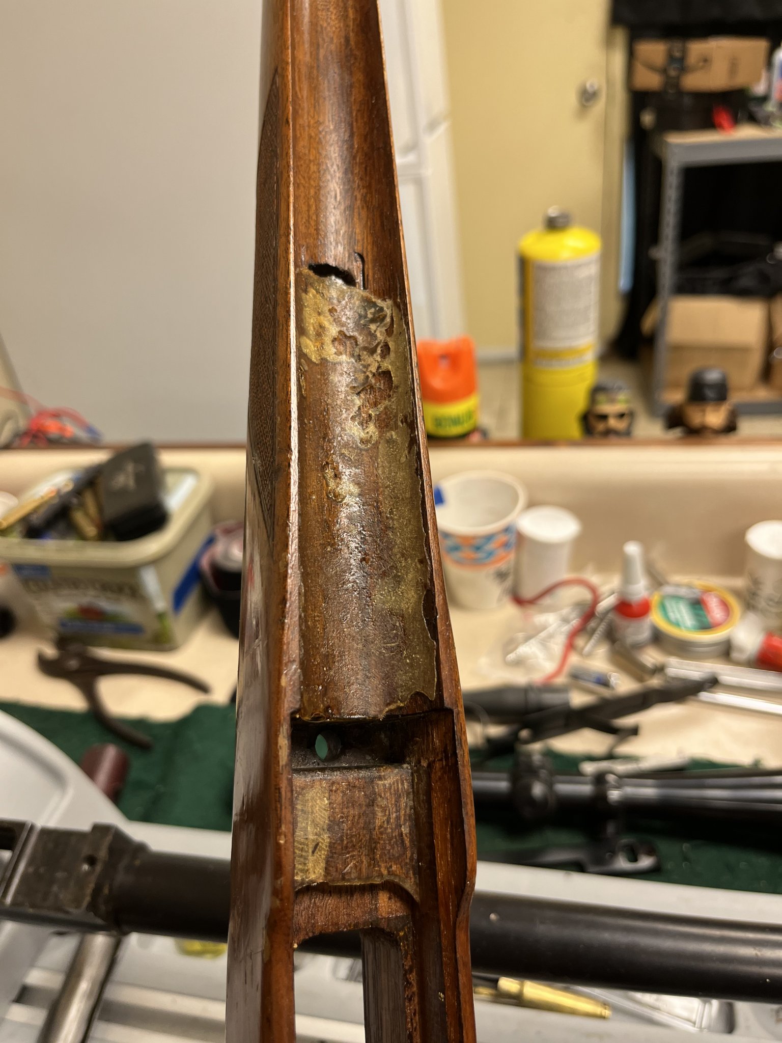

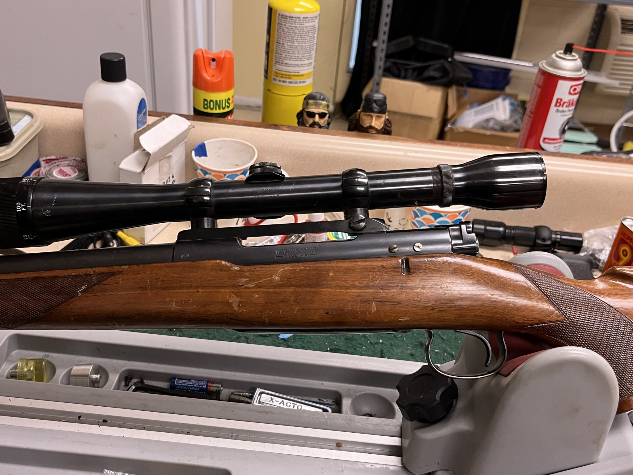

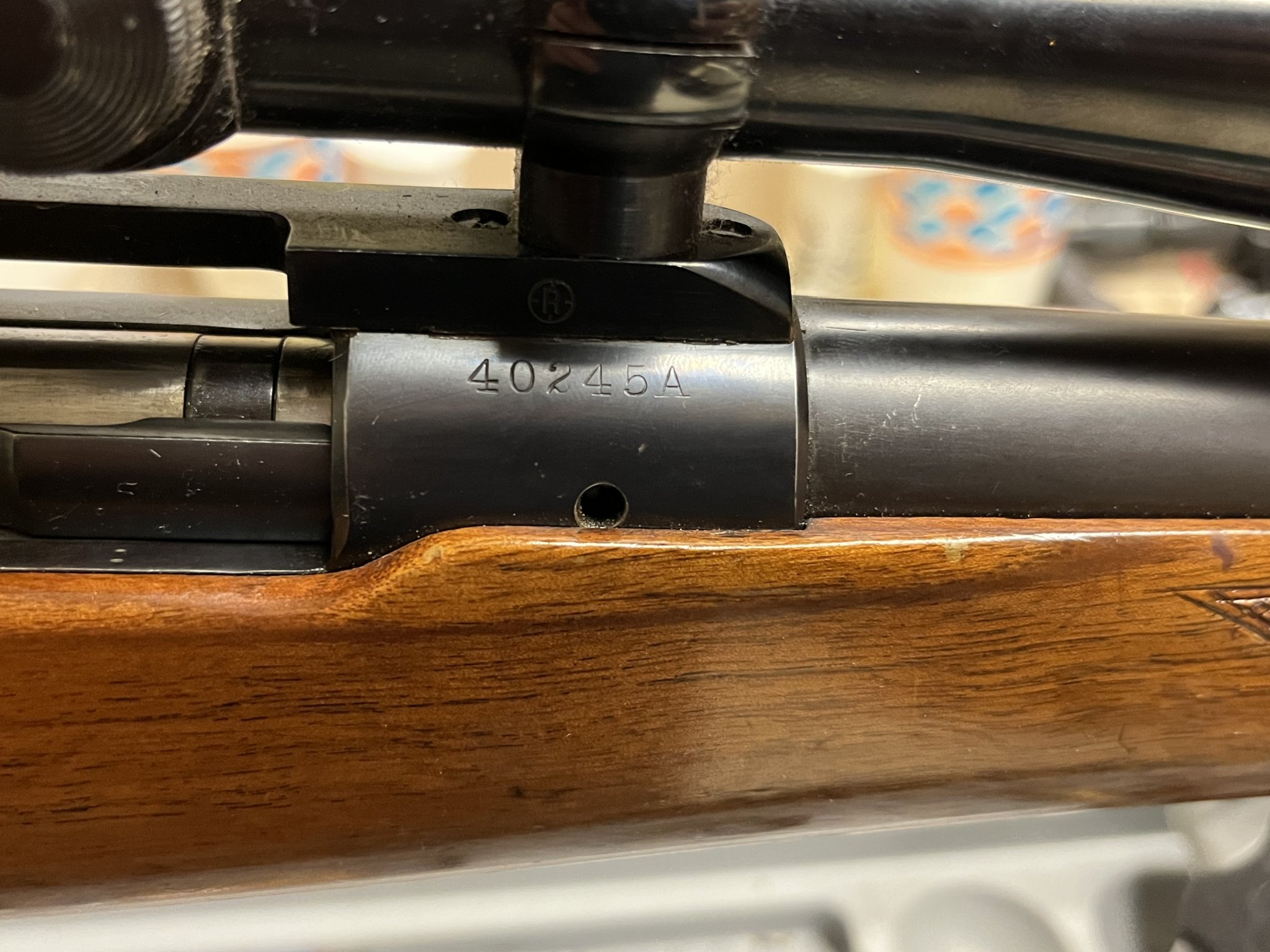

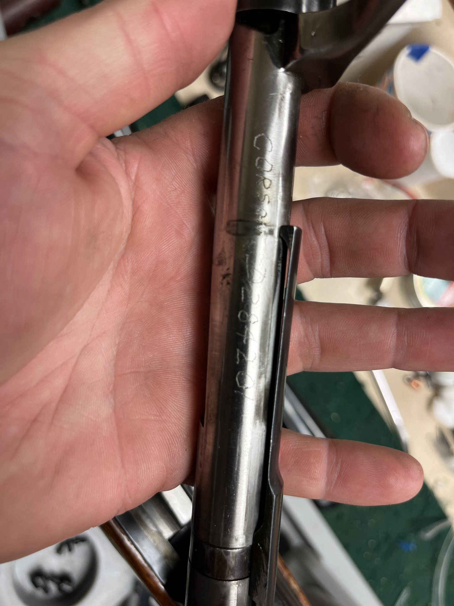

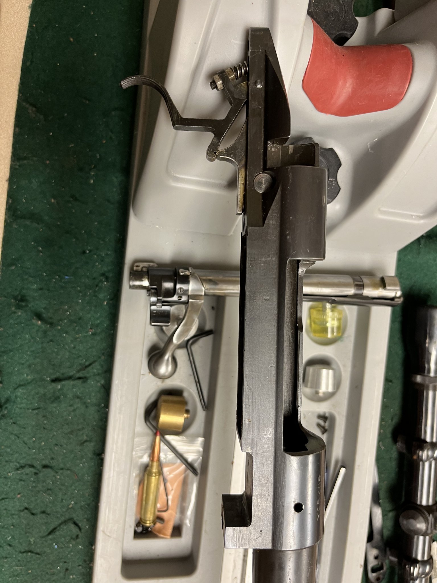

So adding some pics. It has Corson engraved on a few places. The barrel is actually stamped H Lovell. Looks to have been half assishly bedded at some point in its life. A 22-250 case fits in the chamber quite nicely, but doesn’t mean that is the true chamber. Would have to cast it I reckon. The bore is tiny though, still fairly shiny and decent looking. Throat might be toast if it is a 22-250. Might have a blank laying around to get a new barrel for

They have a strange bolt throw that interferes with scope mounts. Thus the 'high' claw mounts.
Henry Lovell was a rifle maker out of Indiana. Of great note in the 1930's. I remember reading about him in OLD American Rifleman issues.

Looks like a standard model 54 that was re-barreled as a "varmint" rifle for woodchucks, prairie dogs, etc... The bolt handle has been scalloped to clear the scope and a rubber recoil pad added. Not sure what to make of the "bedding compound"...if that is indeed what it was intended to be. In 1936 production was stopped and the Model 70 took its place.
That is a late production “improved sporter” It has a one piece firing pin and shorter lock time. The gas port may have been original or could have been done later. I own a couple of 54s. Two of them in McMillan stocks. I converted the bolt to clear optics using Kimber 8400 bolt handles. Don’t worry,they had already been altered like the one pictured.
I just noticed the trigger has been changed to a Model 70. The original was a two stage that also functions as the bolt release. Is yours using a long screw in the receiver sight hole to keep the bolt in place? That was the usual method .That would also mean the cocking piece has been altered to work with the 70 trigger.
That's a cool one for sure. I think you have the right idea to get the chamber cast. If it's a true vintage re-barrel, it could pre-date the 22-250 Rem and be a 22 Varminter. Might be worth checking the bolt head too to see if it's one of the wildcats based on the 30-30 case, which the Win 54 could also be had in.
I always thought it would be neat to find an old beat up 54 and have it rebuilt to be like a Win 70 Sniper. Surely a 54 would be cheaper than a pre-64 70.

It took me a minute to figure out why the bolt would not come out. It was held in by the sight screw.

It's a very nice rifleman rifle.
Dont know much about them.
That's quite the barrel for the era.
Get some nice irons for it or some nice vintage glass....
Will check that place out, thanks. Some old glass would make it look good

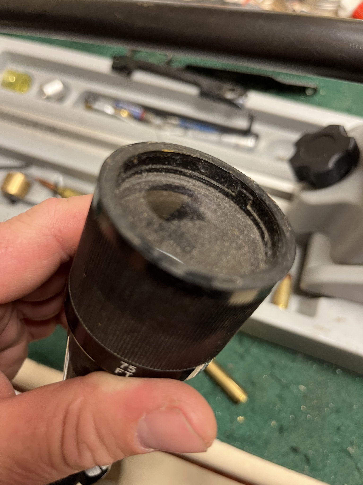

Is the scope a Weaver K-10?
If so it's actually a pretty nice scope. I used one on my M40A1 while waiting for an MST to come along.

Before you re-barrel it you might want to look into Lovell some more. And do a chamber cast. As I mentioned above he had quite a reputation as a gunsmith and firearms worked over by him may be quite valuable. As they are.
It would be a shame to dismantle a iconic gun by an iconic Gunsmith until you know that it’s neither. Cheers

So I found the guy. His name is Hervey Lovell, getting the jist he was a wildcat guy that dabbled in mainly 22 caliber stuff. The reading shall continue as well as sent a feeler to the Cody Museum to see if they could provide any direction as to OG caliber or gun specifics.

So the plot thickens some for me. Hervey Lovell died in 1967, so that barrel has been on there at least that long. He relocated to the PNW in his older years and began playing with larger capacity/caliber rounds. He has the reputation for making pre-war conversions to a couple of varmint geared rounds like the 22-3000 Lovell(22 caliber round going 3000fps), 22 Maximum Lovell, 22 Lovell, and the 2-R Lovell. Most flinging small bullets insanely fast, and based off a .25-20 single shot case.

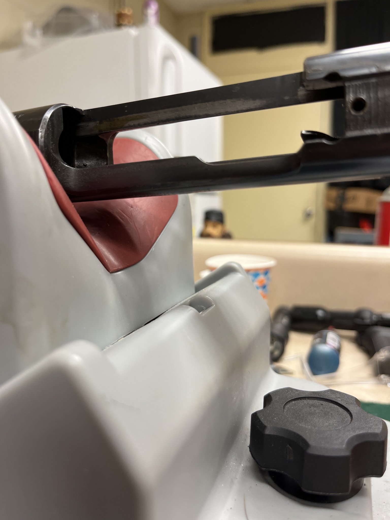

Does the action have a clip slot?
Is the bolt face 30-06 diameter?
The 30-30 receiver was not clip slotted.
The 22 Hornet bolt face had “fingers” on the bottom of the bolt face.
Reactions: Charger442
If it is a standard 30-06 based receiver, I would rebarrel it to whatever you like. You can always put the old barrel back on unless you blueprint the action. The Model 70 uses the same barrel and I have seen a few 54s with 70 barrels. I did that to my most recent 54. I got lucky and it clocked and head spaced perfect. 1940 barrel on a 1926 receiver!

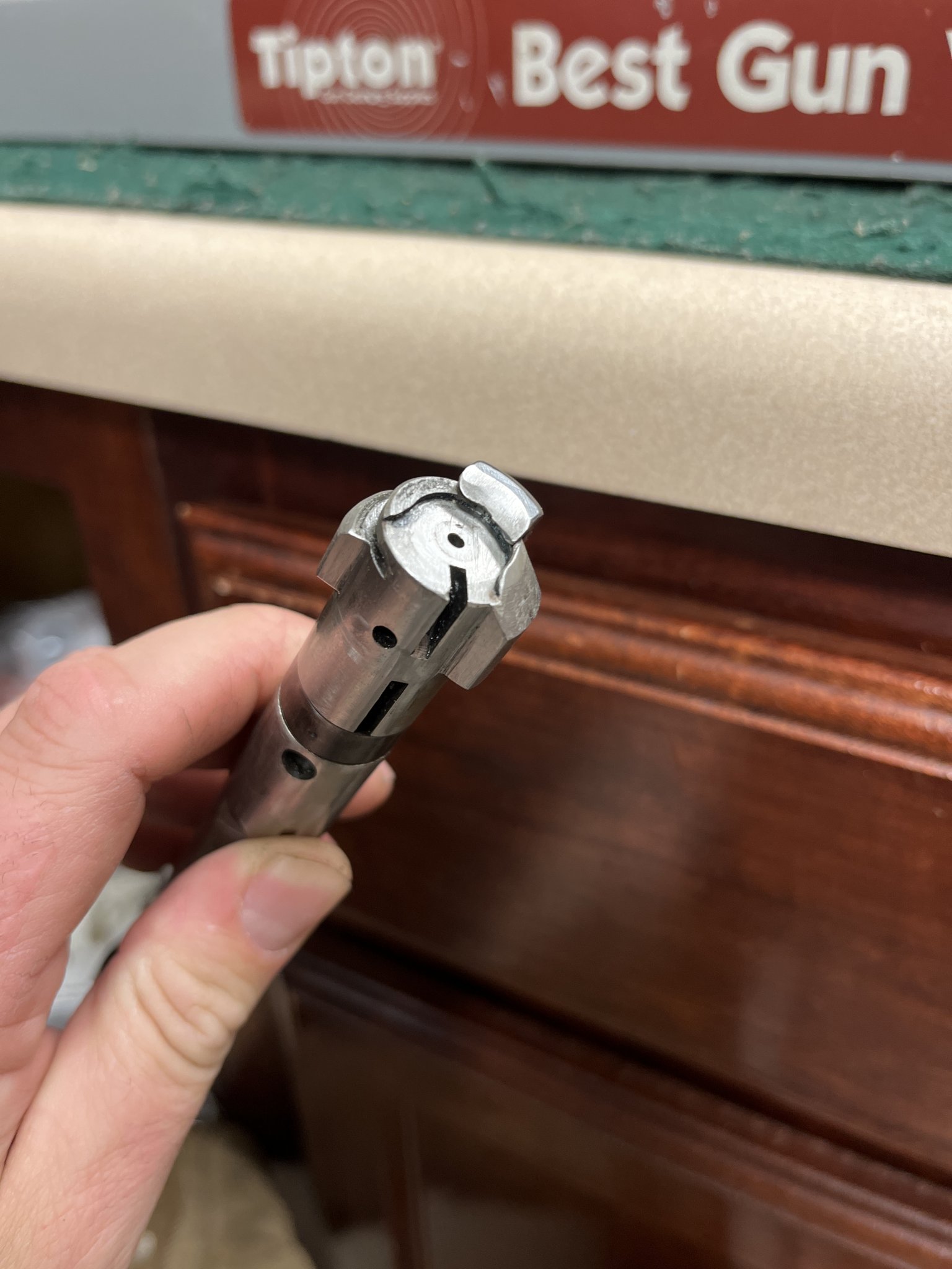

I will have to look again, I don’t remember seeing a clip slot. The bolt face is not a 30-06 I’m pretty sure. I don’t remember fingers, but didn’t really know what I was looking for when I took it apart. I was more or less just checking parts out. I know a 22-250 and 308 case head filled the bolt face. I will look again when I get home. I have stuff inbound to cast the chamber as well
yeah, if it was a 30-06, it would be clip slotted. no telling what it started life as.

Based on your 308 bolt face comment, it's highly likely this gun was originally a 220 Swift, shot the barrel out and was rebarrelled.
Have you measured barrel bore diameter? A 250-3000 chamber would allow a 22-250 to fit in it. But you'd need the bore to be .257

Just getting home and looking at it some more. So it is clip slotted, and bolt face is .476, which is appropriate for 308,22-250, but also for 30-06 in a long action setup. There are no fingers on the bolt, so it very well could have been a 06. Muzzle end mics from .218-.224 rotating the calipers around the bore.

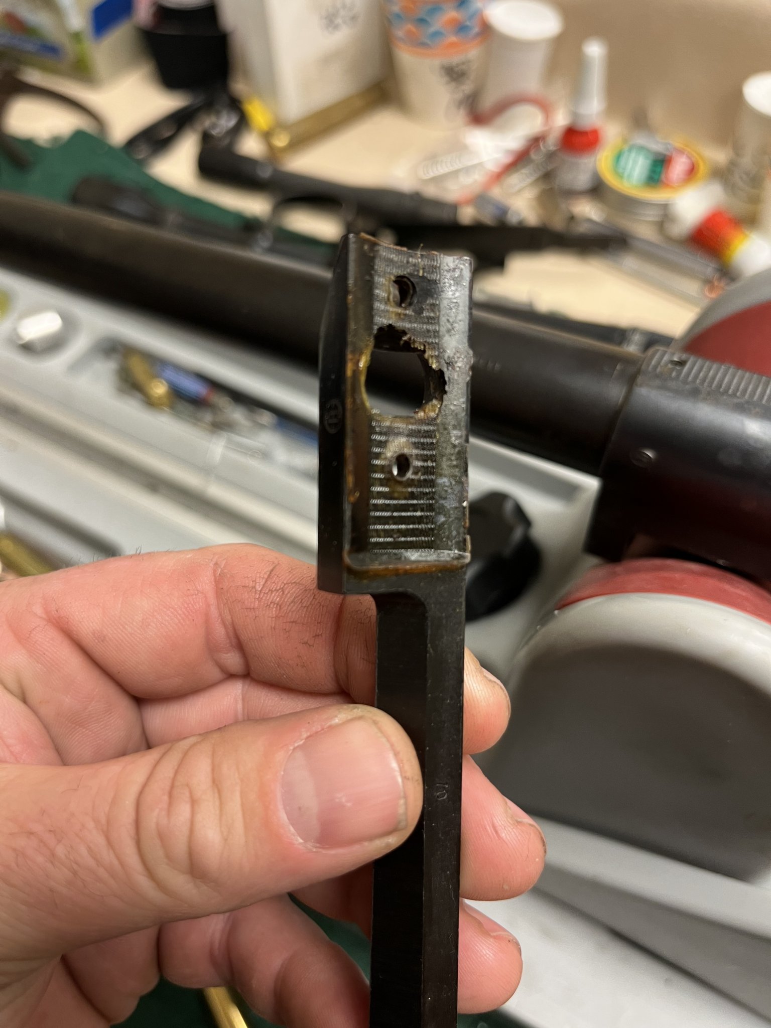

Seems the rear scope mount screw was buggered at some point and rethreaded 8-40 as well. More of that makeshift bedding was applied on the bottom of the mount as well. I believe someone intentionally tried to bed these areas with something.
