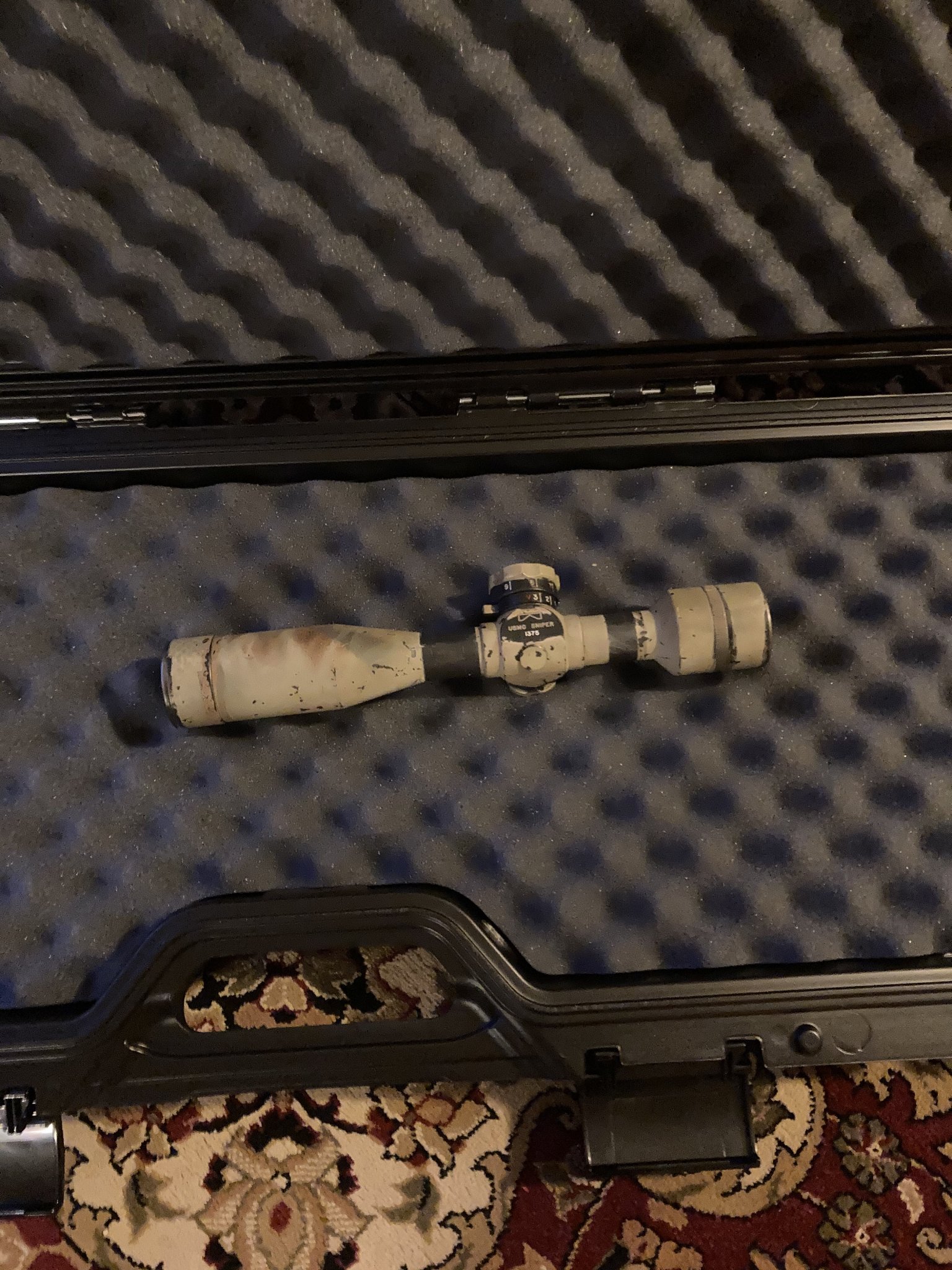

The scope arrived last night and the optics are clear, I'me very happy with it and am excited about putting the whole thing together.
25 yard zero should be completed in a week, first quality range time probably a week after that!
The CMP ships them in a rifle hard case, makes for a big box for a small item.

It is nice to hear/see that they took the time to package the scope properly and address the care needed in shipping optics.
With a case like that maybe even the delivery person, who is having 'a bad day' and decides to chuck your package over the fence instead of gingerly placing it at the foot of your front door, can't harm your beloved scope. Youtube has a field day with showing security footage of the notorious 'package throwers/kickers' and their escapades with customers packages. I am sure you have seen a few of them.
Glad you have the complete package now. What you possess is steeped in tradition and something to be proud of. Hopefully is is a centerpiece of your collection.

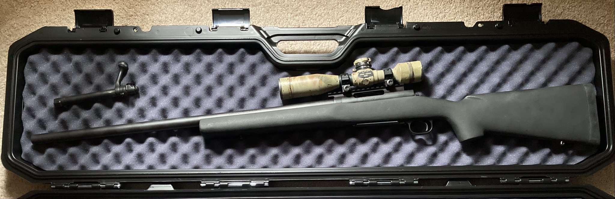

Hi All,
The build got delayed by back-to-back COVID quarantines, and we're now waiting for the correct mount and improved rings to arrive. The ones on the rifle would not work, so I'm going with a 20 MOA rail and Sig rings.
She's going to be a funny looking rig with a desert camo scope on a matte black rifle, but should be easy to pick out in a rack.
I'll post photos when she's done.

Zeroing was pretty quick after getting on paper, hen we took her to Fort Gordon.
I love her.
My neighbor was amazed that the setup (that he built) could go from 200 to 277, to 1000 seamlessly. 200 and 1000 were known distances, but the 277 and others we had to figure out using the mil-dots. It was fun getting back into the game after so long of a hiatus. This is a wonderful combination for those not wanting to drop coin on s M-40 clone.
