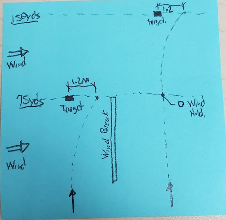

Dope the wind for the distance the bullet is in that wind condition. Take the yardage out of the wind call that is in the "no wind zone"
making your conditions listed above more simple
0-75yds = no wind due to wind break = 0 wind hold
75 yards to target at 150 yards = same wind hold as target at 75 yards with the same cross wind.
75yard target with crosswind = 1.2 mils <-- target at 150 yard with zero wind from 0-75 yds and wind from 75-150yds = 1.2 mils. Can you see how these are the same wind hold and condition?
Here is a diagram showing the 2 conditions. You'll see the wind drift for both situations are the same.
At most ranges I take the full crosswind speed and dope the wind to the full target distance. (for this example it was 2.5 mils) Then I start to look a the terrain and see if there are places the wind is not present. In this example the wind is only effecting the bullet for the second 1/2 of the flight distance so I would use 1/2 the wind call (1.2)
If the wind break is at the 2nd half of the flight path and the wind is full value for the first half, I would use 3/4 of the wind call. (1.9mils) This is because the bullet will have an initial lateral movement/momentum when it enters the no wind section of flight. The wind deflection in the area will be liner rather than exponential.

Is it that simplistic?
Based upon the OP's comments, I'm guessing 0-50 no wind, 50-100 3mph (very little), and 15mph 100-175. So, it's not 50/50, but three wind segments of 0mph (56%), 3mph (32%), and 12mph (12%) = .3mils. Someone would have to use Trasol to see how close my swag.
Interestingly Trasol is the only one that lets you edit the wind zones to such short ranges, neither ColdBore or Genesis will (and all 3 the same engine).
Using 1070 fps and .130 G1 your mph+ranges end up at .6 mils in Trasol.
Using @Jack Master 1/2 the distance and 1/2 the wind call resulted in 1.1 mil or .55 mil half value for 15 mph @ 75 yards.
His method seems to be pretty spot on.

O.K., now I understand. But what if there is wind before the barrier, then the barrier, and finally wind again after the barrier but at the same or a different velocity? If someone can point me to a book I can purchase that explains the different scenarios I would be most appreciative.
