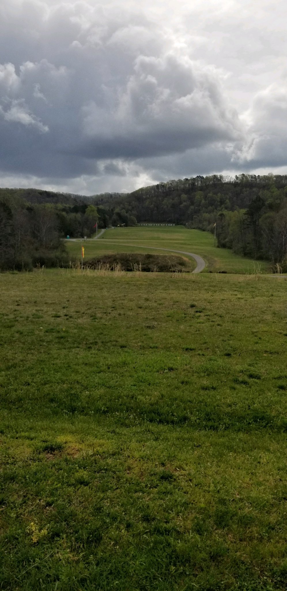

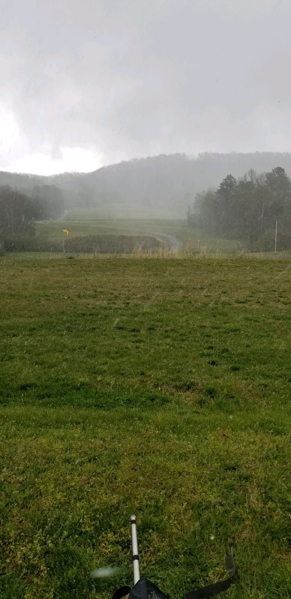

Recently, a friend offered to let me shoot on his huge tree farm. There are 3 shooting benches to shoot from. One at 400yds. to target one at 600yds. and one for shooting at 800 yds. All are on a hillside on one side of a valley. The targets are on a hillside on the opposite side. The 800 yd. bench is at the top of the hill, the 800 yd. target is also at the top of the opposite side. The 400 and 600 targets are at the bottom and middle of the hillside, as are those shooting benches. All shots are level. The floor of the valley is a lake. Elevation from the 800yd. target to the floor is about 110-120 vertical ft.
My question is - Do you guys have any tips for judging wind in this scenario? I can see grass, trees moving at the shooting position for about 15yds in front of me, and across the valley in the area around the targets, but nothing in between. Last time I was there, I saw FV crosswind at my bench, no ripples on the water below and a gusty headwind at the targets.

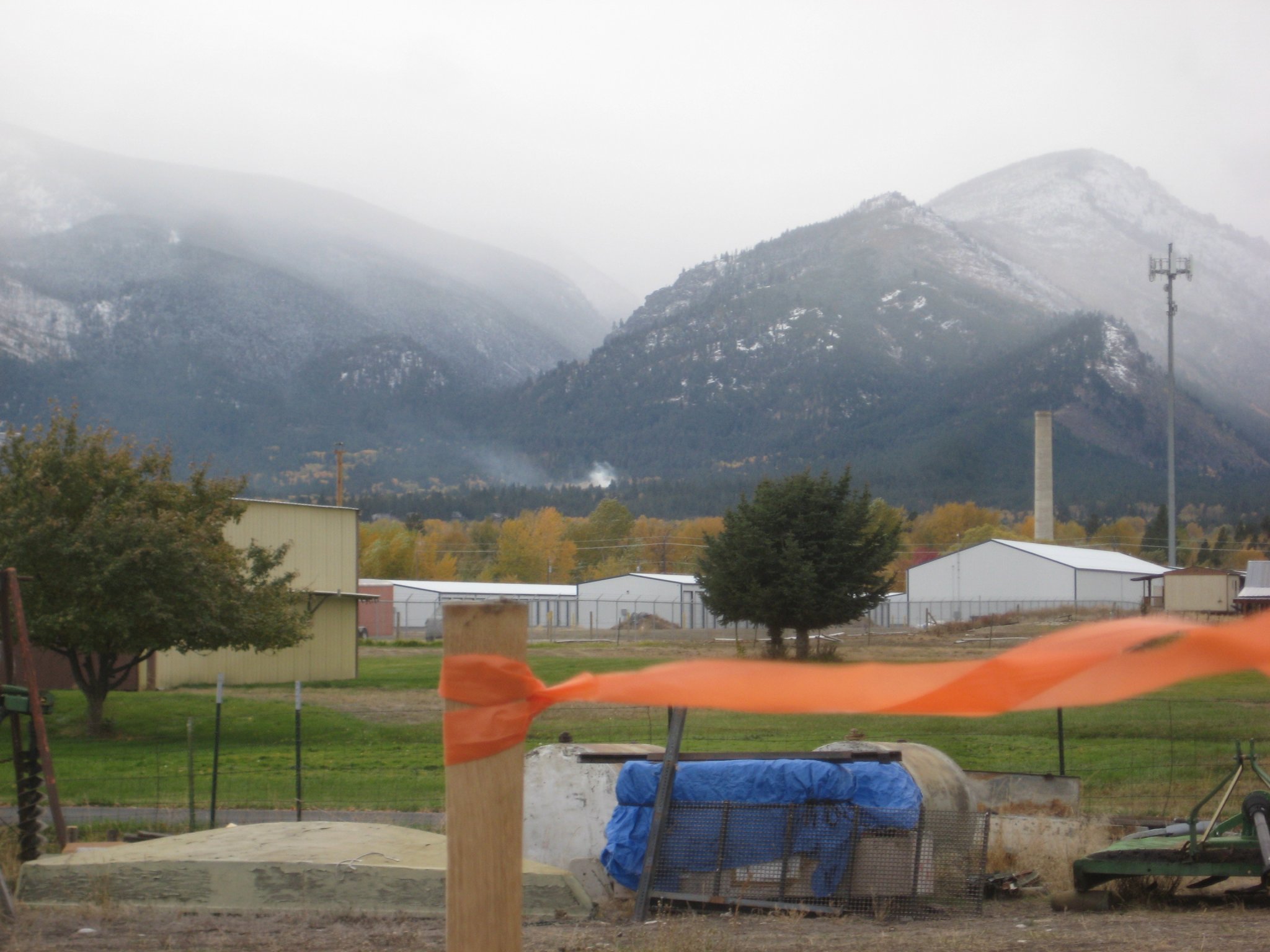

Captured a photo of the "Wind Challenge" here in the valley... The flag closest to me shows the wind coming from the South. The burn pile on the foot hills shows the wind coming from the North... I don't have a Kestrel so I make an attempt to read the wind when I get an opportunity. It is a real challenge for the guy's that travel here to hunt and don't have much opportunity to do some observation.
