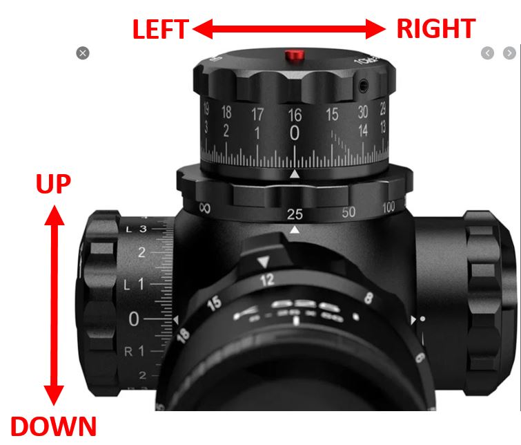

I got a chance to play with a Kahles K525 scope with left windage this weekend and LOVED it but it got me thinking. I am not an optical engineer or designer but why can't scopes have the top turrets be windage and the side turrets be elevation? Is it an internal issue that is limiting the design?

I do shoot local PRS comps (3rd year) and also right eye dominant. I was able to use my left eye quickly to check the bubble level (clamped infront of the erector hanging upper left) and adjust windage on this Kahles with my left hand faster than normal. Then my brain started thinking "what if?". But you are right I was using this Kahles off a bench instead of using it in actual PRS type barricades.

It would most certainly complicate the mechanical design of the scope. Go find out how scopes are made inside to understand that.
Worse than that, it makes zero intuitive sense. Having the elevation adjustment on the vertical axis of the scope and the windage adjustment in the transverse axis does.

Now answer this riddle. If internal mechanical design was NOT the limiting factor why not have elevation on the RH side of the erector?
Because then you have to reach your head over to the side, and not just slightly up, to see it.

Directionally speaking. Twisting a turret on top left or right to adjust for impacts that are left or right makes more sense in my head. Same can be said about vertical adjustments. Spin the dial forward to go up, rotate back to go down.
I already use my left hand for re/loading a mag. Assuming the rifle is on a bench, ground, barricade, tripod, etc. Why can't your left hand adjust for elevation if the dial was put on the left? Then put the parralax/illumination on the right?
