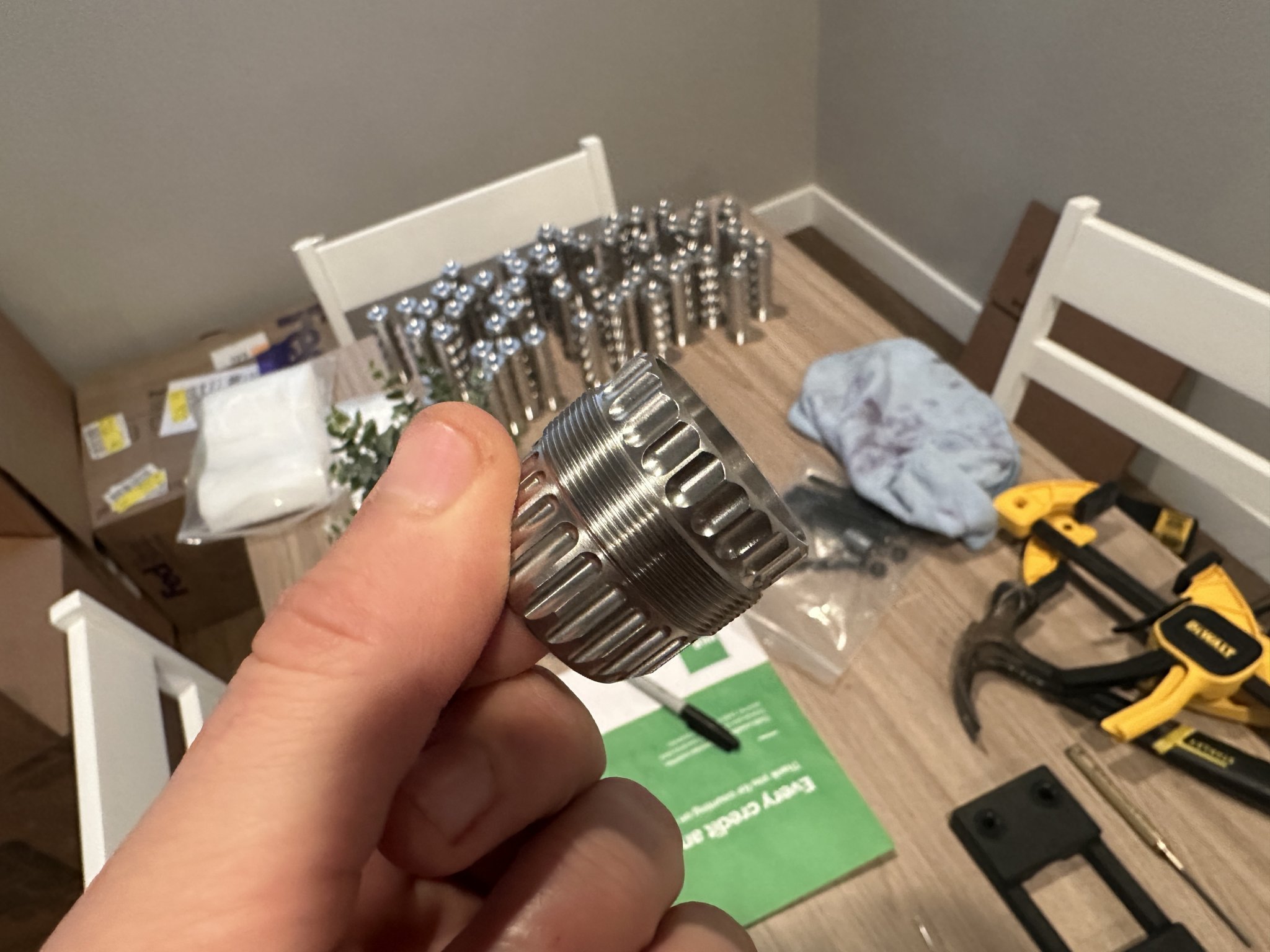

I ordered one a few weeks ago still waiting on shipping information. It was down to the insite or this one. I think they all do a good job at the high end levels probably wouldn’t notice a big enough difference between one and the other.

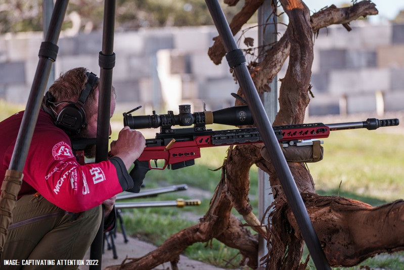

I am the shooter running the AT-X rifle with the Tremor reticle, standing, firing from the barricade with a game changer only.
Full disclosure:
I am not associated financially with Without Warning although he is one of my very good friends and I am proud to see him succeed and see his products thrive in the industry internationally. I have been shooting TMB's in the Australian national PRS series since they first became available and now won't be looking elsewhere, they are excellent.
We worked our way through each of the brakes, firing them as we went, trying to capture footage in that environment. Being that it was clearly not a science laboratory, using robots, in a controlled atmosphere, we were dealing with variables like my body position potentially shifting from shot to shot slightly, wind conditions over time, varying muscle induced pressure on the system / support bag etc. it was hard to try and replicate each shot over an hour of us doing it as I'm sure you can appreciate. However, that being said - I was personally as interested in the outcome as you are, as a paying customer. There was no silly business from my end.
One thing about BJ (the designer), he is serious about making a good product and I believe he has absolutely done that.
I have always shot factory Hornady match ammo in my 6.5 and 6mm Creedmoor barrels, the Tuner was enticing... Even though I have still never really gotten down and dirty with tuning it as such, as soon as the additional weight ended up on the muzzle, the barrels settled down even more with the harmonic dampening taking place, like a suppressor.
I have switched the Area419 Sidewinders off all my match barrels in favour of the TMB's and have another one on order.
As friends here, my input is simply my own, read it however you like. If you ever get the opportunity to try a TMB on the range, you should see for yourself how effective they are at managing recoil. (y)

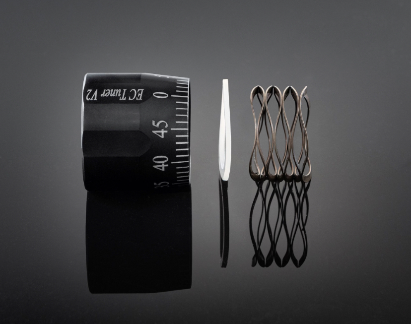

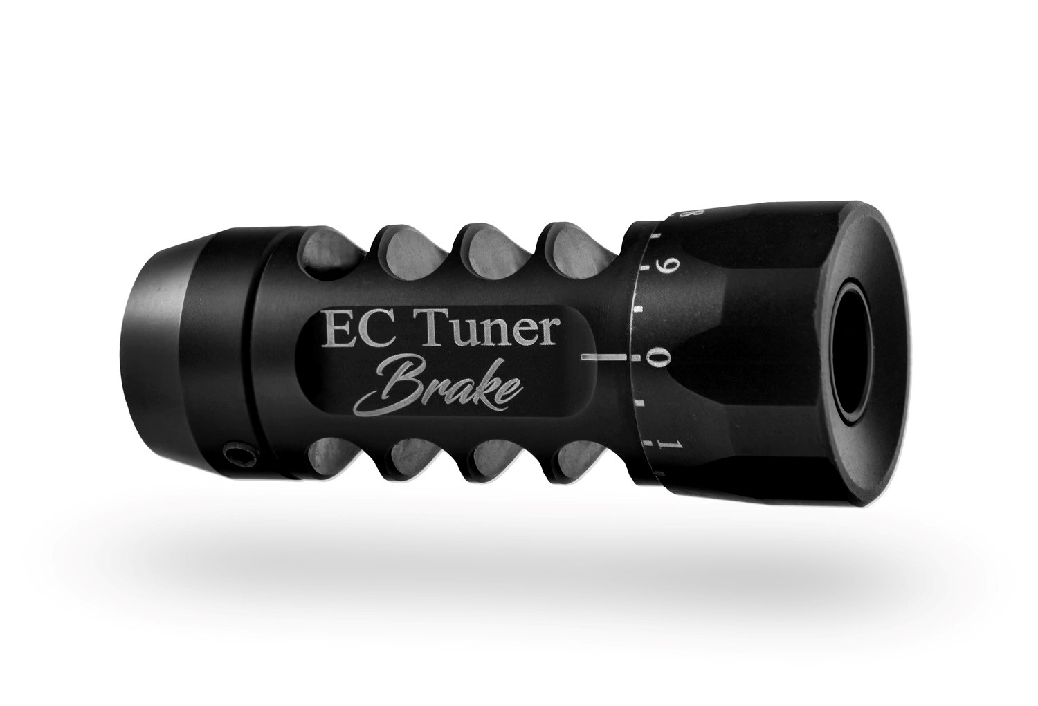

Best brake on the market hands down.
Having shot the ace, hellfire, EC Tuner brake and it beats them all.
Talk to anyone running them and they’ll tell you the same. It’s all I’m going to run now and I need to replace my training rifle 308s brake with one🙂

Every tuner with set screws on the market uses opposing set screws screwed onto a curved surface. Friction holds them in place, there’s very little contact area and they can and do move from external forces. Screw them in until you strip them, they can and will still move. I get emails and dm’s from guys always telling me how the tuner they had moved and they want the tmb because it actually locks in place.
The tmb has cut outs in the jam nut that the set screws screw into. The only way that tuner is moving is if you sheer both set screws. The double sheer strength of the 8-32 set screws in the tmb are around 200 lbs. Ain’t nobody moving that tuner from hitting it on things. At matches I’ve seen dudes take chunks out of barricades and the tmb just laugh at them.
The tmb isn’t ‘just the first self timing tuner muzzle brake’ that was made. It has enormous amounts of engineering that went into it and if people take the time to read what went into it and why, it’s very clear very quickly how much more advanced it is that everything else on the market.
That's a smart design.

The EC Tuner brake v2 uses a spring to hold the tuner in place vs set screws. The previous design did use a set screw with a nylon tip. EC Tuner photo added just to show the spring.
