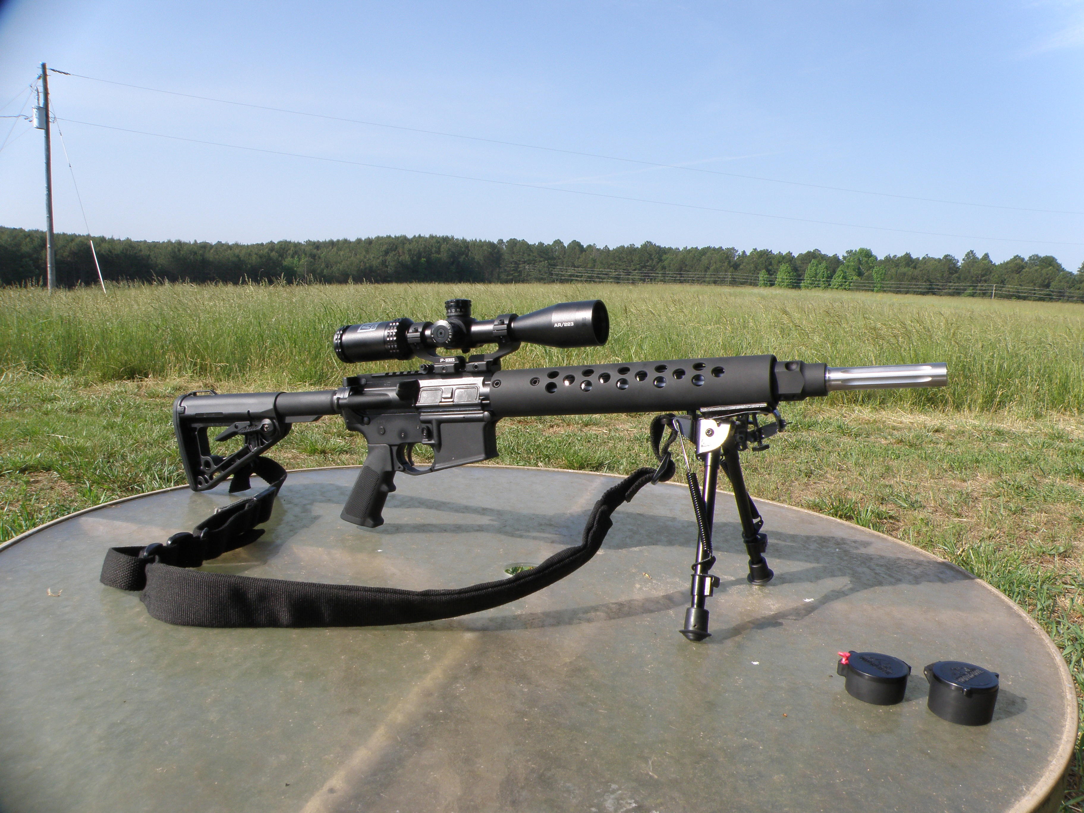

I have a WOA 18" varmint upper that they fluted for me. It is 1 in 7" twist. The very first time I shot it I used my 65 gr. Sierra Game Kings. Two shots to sight in my scope then shot 5 shots to foul the barrel before shooting 69gr. Match Kings in a ladder test. The 69 gr. shot smaller groups then the 65 gr. The picture is of the 65 gr. first five shot group at 100 yds.
PS: It is also fluted under the hand guard. Also has a Giessele SSA-E trigger in the Colt lower.
