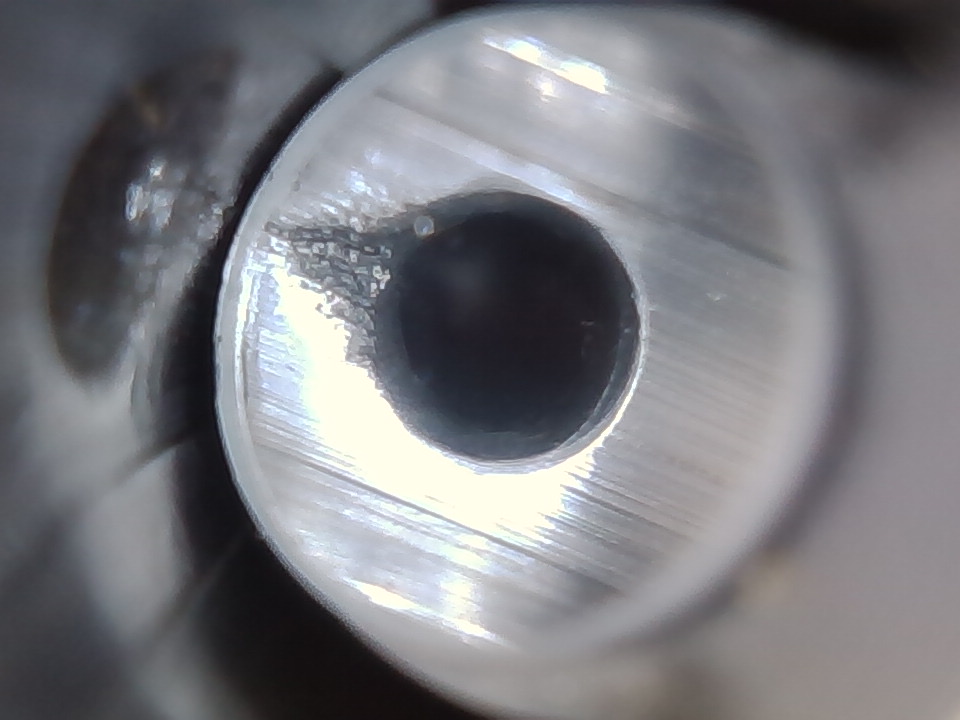

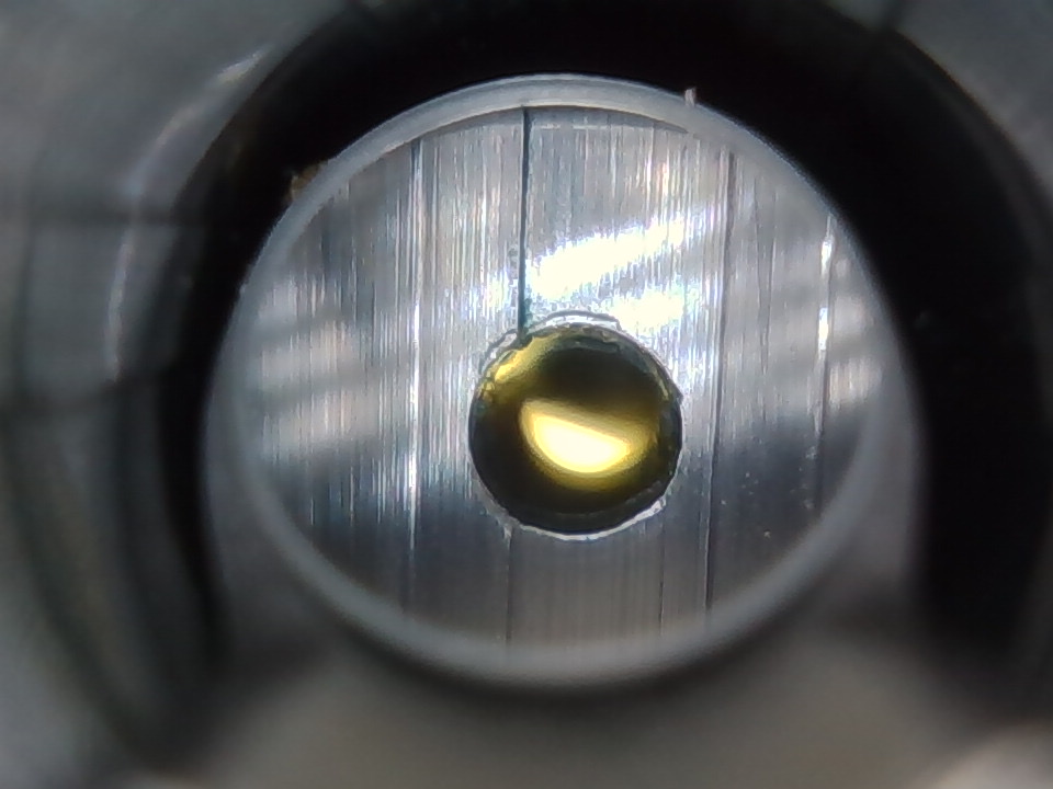

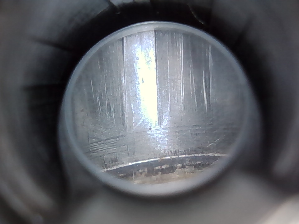

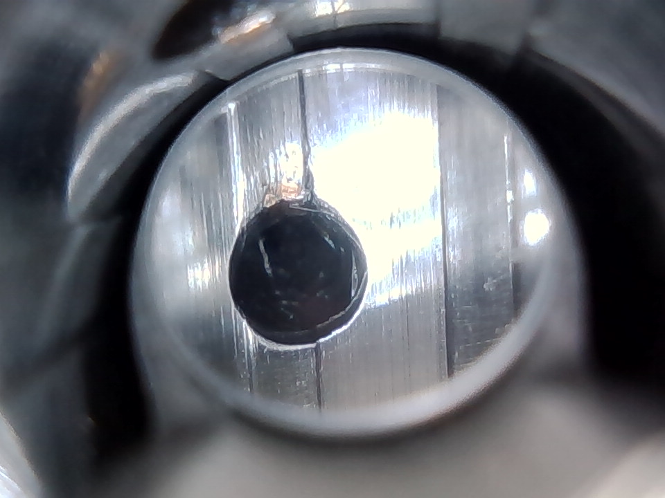

About 6 months ago I got my 16” SDM profile 223 Wylde 1:8 barrel that I ordered direct with WOA. I built it using a BCM upper (thermofit) that I trued the receiver face on and bedded with green Loctite. The handguard is a free floated SOLGM M89 and the I’m using a Riflespeed adjustable gas system with an H2 buffer in the stock. I’m using a LaRue MBT-2 trigger in the lower. The rifle has a NightForce NX8 2.5-20 scope on it. The rifle has been dead nuts reliable from day 1 and eats anything I put in it without issue.
The problem is that it’s not accurate, the best 5 shot groups being 1.2-1.3” (match quality factory ammo and some of my best hand loads). It has about 200-250 rounds through it. I have a Bartlein 20” SDM profile 1:7.7 4 groove by CLE that I built with the EXACT components and it shoots sub 1/2” 5 shot groups with multiple factory loads and a bunch of my hand loads.

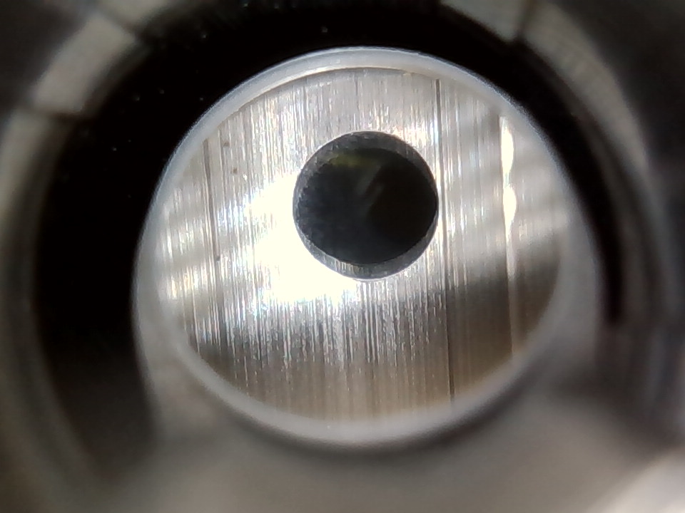

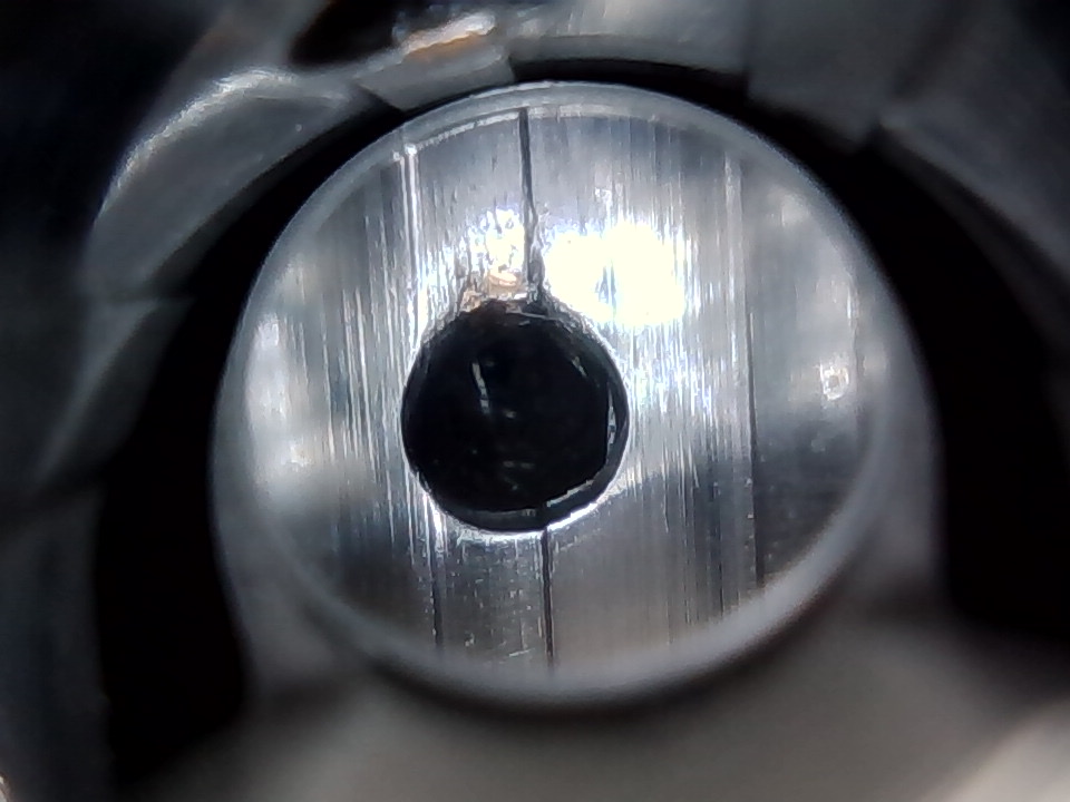

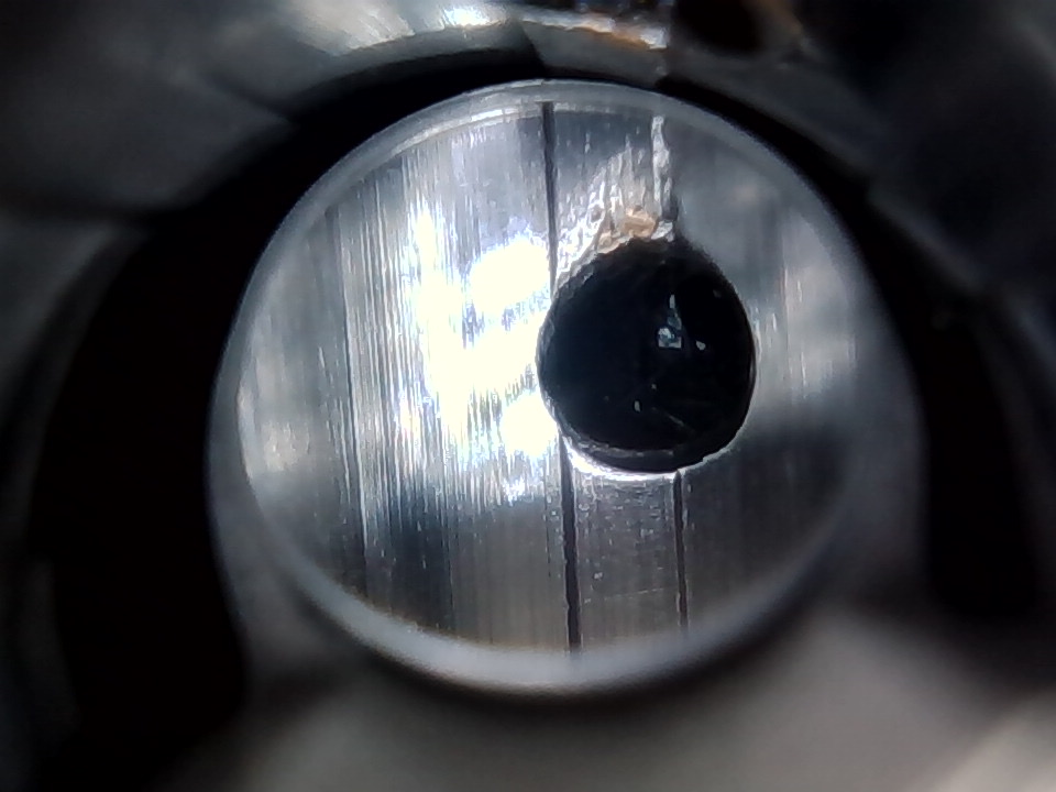

Ive bore scoped this rifle and I saw two potential issues (see pictures):
1) There are radial machining marks left in the leade/throat area from when the barrel was chambered by WOA.
2) The gas port cuts through an entire groove and gets copper build up which shows as a single blue streak on my cleaning patches. The copper accumulation is also visible with a bore scope even after a heavy cleaning with JB + Kroil and Patchout+ accelerator.
I’ve sent an email to WOA to try to get some help. This rifle was not intended to be a blaster and I expect much better from this barrel. I have a Proof waiting in the wings to replace it if things don’t get resolved soon.

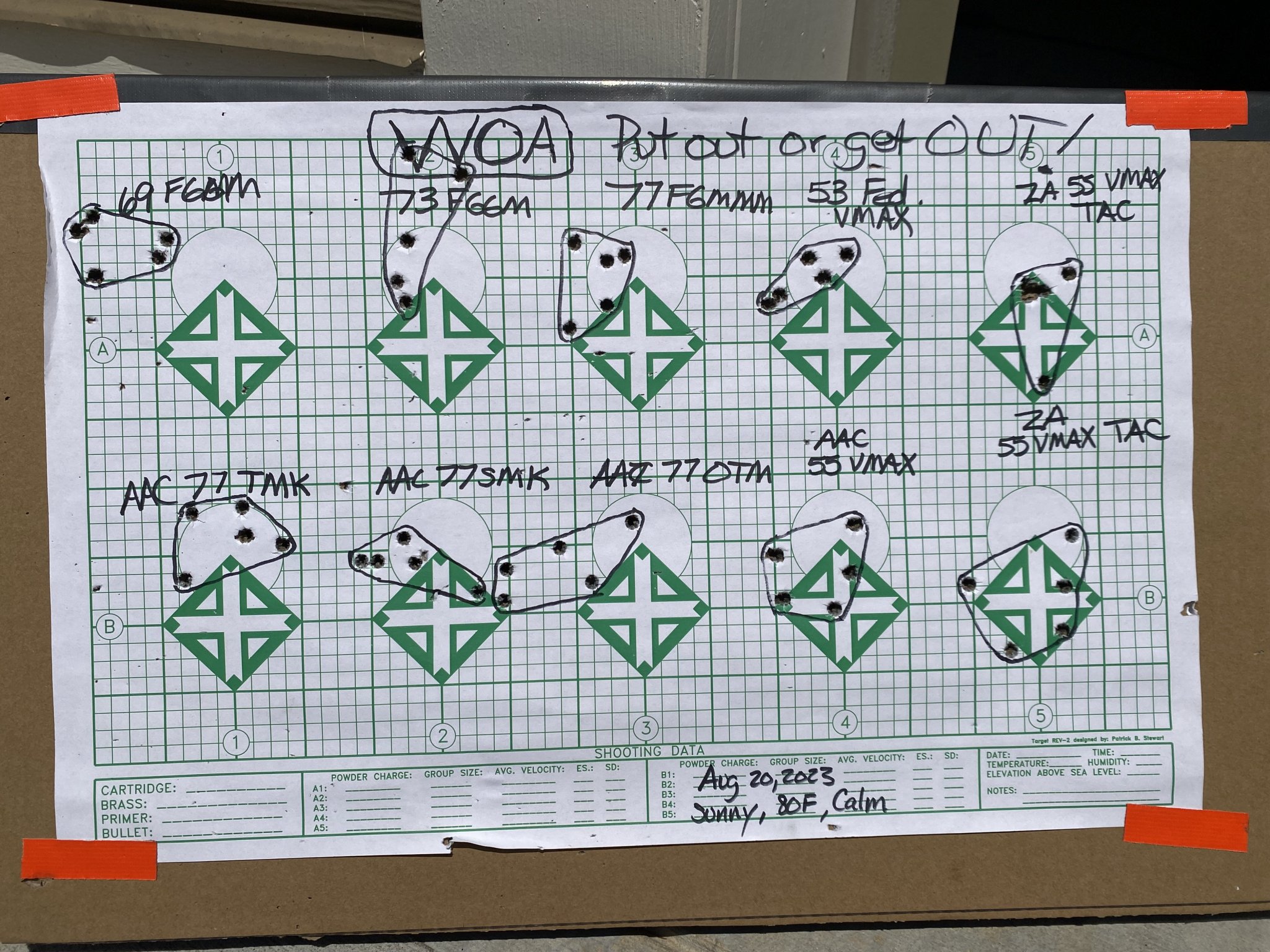

Ive posted the “put out or get out” results from my test of the WOA today, before this test I did the heavy cleaning, so the barrel was pristine. The top row, far right “55 ZMax TAC” was the first set shot with one of my best loads, the first three went into the same hole, the 4th was at 2 o’cloc, the 5 dropped 1.5”. I then shot the 69 FGM, then 73 FGM, then 77 FGM, then 53 VMAX. I then let the rifle cool down for 45 min or so and then shot AAC 77 TMK, then 77 SMK, then 77 OTM, then AAC 55 VMAX, and lastly another set of my 55 Zmax load (bottom right).
Thoughts on what the issues may be?

I'll give the same answer as before. I stripped the copper out of my barrel after 100 or so rounds and never had a problem again. Your combination of cleaning doesn't feature anything ammonia based like Sweets or the Barnes CR stuff. If that doesn't do it, see if they'll return it.

I cleaned it again last night with Patchout/Wipeout + Accelerator. I eVen left a saturated patch in the bore over the gas port so there would be a direct soak on this spot. Patchout eats copper.

I have done some load development (69 RMR, 55 FMJBT), but it seemed futile with this barrel. Everything was 1.5" or worse. That's why I ran this test with factory match ammo. If it won't shoot factory match ammo into decent groups, I don't want it. I'm not going to invest more time & resources in it. I've also shot known "good" hand loads (69 SMK + 24.5 Varget) and a few others through it.... same thing.

Having your gas port drilled in the center of a Land is never ideal, one of the many benefits of having a custom barrel spun up.
The throat of your barrel doesn't look all that bad, I've seen a lot worse that shot quite well. Just keep in mind that there is such a thing as over cleaning, JB should only be used 2-3 times in your barrels entire life span. Basically you can lap/polish your barrel to a point that it's too smooth increasing friction and making copper fouling 10 times worse.
Yea, I wouldn't normally break out the JB's unless I saw extensive carbon fouling I couldn't get out. That certainly doesn't happen in less than 200 rounds, but this barrel was so whacked out, I needed to see what was going on and wanted to try to reset it. My Bartlein has about 1500 rounds and I only hit it with the JB's at about the 1100 round mark. I also only apply JB's with VFG felt pellets, never with a brush.

When I looked at the picture I thought that was a groove it was in. Directly across a land like that is not good. I bet they replace it. If it were me, I would send them the picture explain it and see if they would just send a new barrel.
I've had iffy results with the 69 RMR in several rifles, and I have tried REALLY hard to make them shoot. One group will be .75" and the next will be 1.5", in a rifle that will shoot most match grade bullets into 0.5" or less pretty consistently.
I've played with different powders and charges, primers, brass, and have found that neck tension seems to be a key factor. I'm going to sort some by ogive (bto) and try that next.

I've had good results in several guns with the RMR 69's, but not in any of my WOA barrels & I've not shot extended groups either. With 25.3 gr VV-N540.
But they've done consistently under an inch in every case, just firing a 5 shot string for group whenever I have those guns at the range over several trips.
Maybe a longer string of rounds is needed to shake them out more.

UPDATE!
They tested/inspected my upper… here is their response. I give them kudos for standing behind their products!
“Good afternoon ZA206. Your upper has been inspected and borescoped. John saw normal, expected wear in the barrel, nothing unusual. The build seemed sound, they did mention to be careful with the adjustable gas block and other accessories mounted on the rail to make sure that there is no contact between the barrel or gas block and the accessories attached to the rail. You want as much as clearance as possible.
He did notice one thing however, which goes against our standard operating procedure. The gas port was sitting right smack dab on top of a land. While there is some debate on whether this affects accuracy, it is our practice to center it as best we can in a groove. The gas port is wider than the groove so the sides will overlap into the lands, but we still put it in a groove. It was obvious that someone didn’t use a correctly timed extension on this barrel, resulting in the misplaced port. Due to this we will send a warranty replacement for your barrel if you wish.”
Im taking them up on the new barrel.

So I got in the warranty replacement barrel from WOA. The good news is that the chamber and throat machining look better than my other one and that the gas port is mostly in a groove. The bad news is that it looks like the gas port has a pretty big burr on the muzzle side already. Pretty bad looking gas port right out of the packaging. This is my last WOA barrel. Pictures below…
For comparison, here are pictures of a new Proof Carbon Fiber 223 barrel I bought to replace the WOA. Super clean, super crisp machining and finishing. The Proof has been installed in the rifle and this WOA barrel will be sold off.
Didn't they write back to you stating that it goes against their practice drilling the Gasport on a land?

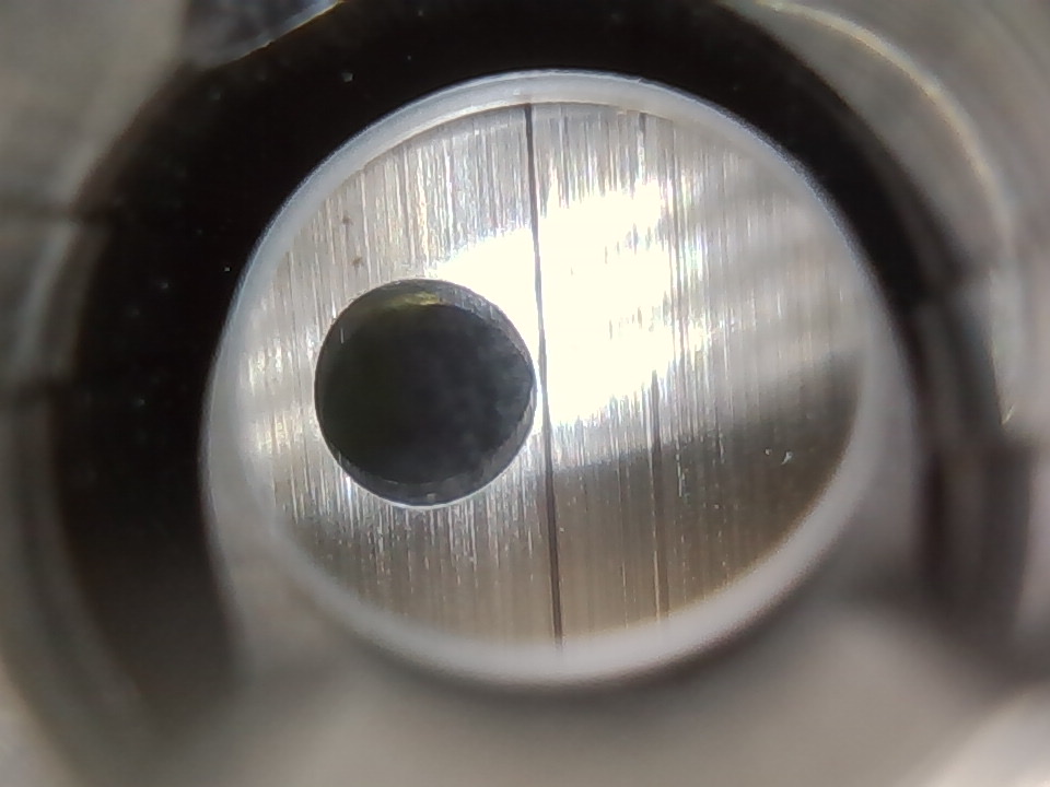

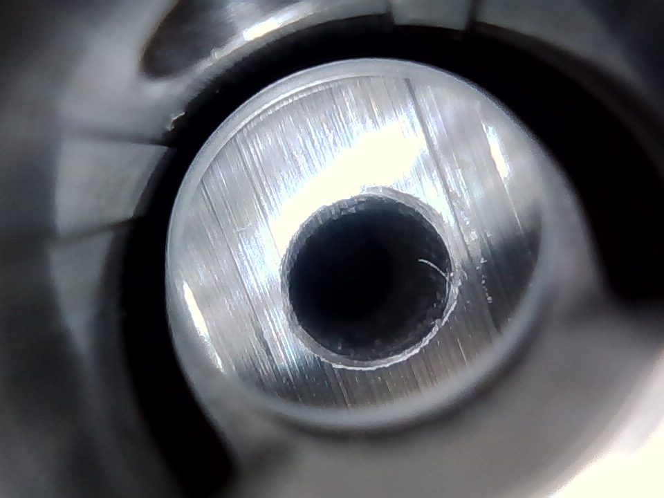

Phone pic of the Teslong screen, but the port looks pretty clean.
Gonna put it against my lottery winning Faxon and BA barrels here soon. 77SMK Razor and MK262 clone hand loads.
Sorry if I missed it... that gas port "looks" kinda big. Have you measured it ?

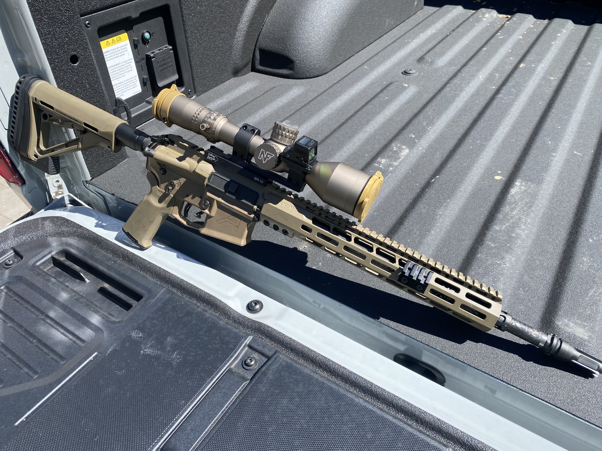

So took this rifle with its new Proof 223 Wylde Carbon fiber barrel out today to get it sighted in and do some break in & cleaning.
After getting it sighted in at 50 yards (red dot and NightForce) I moved back to 100 yards and shot some remainders of a load development batch I had made up for my Bartlein.
Very happy with the results so far. 1/2 MOA right out of the gate in the first 15 shots.

How do you like that handguard?
It’s the SOLGW M89… I like it a lot, but it can get tight under the handguard directly under the top rail. I had to remove some material from this are to get good clearance for the RifleSpeed gas block.

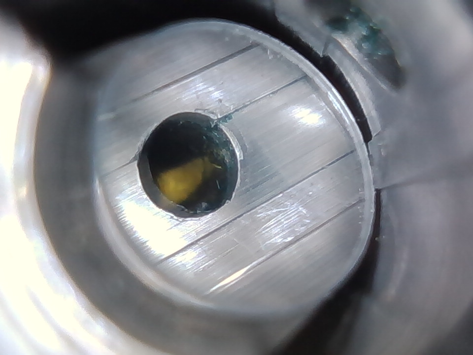

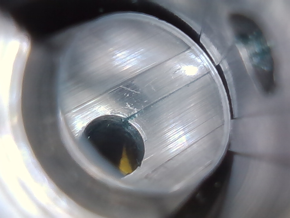

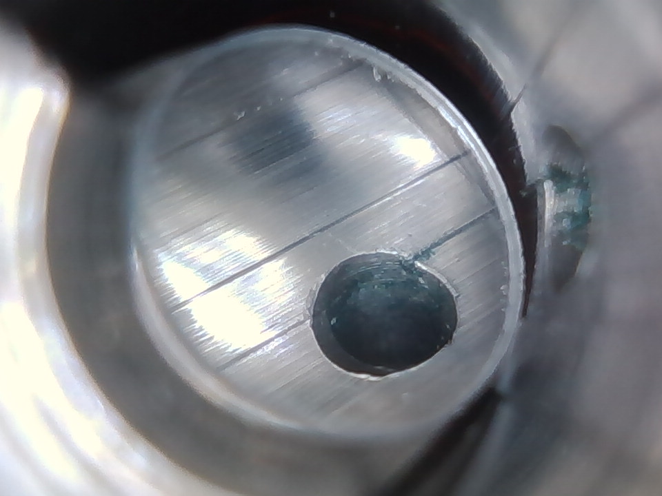

To me, your unfired picture shows a burr on the muzzle end of the barrel. The 25 round picture shows a lot of copper build up and a ton of wear at the gas port… the third picture is nuts.
For reference, here is my CLE Bartlein‘s gas port new and after 1000 rounds.

How come the port position in the unfired picture looks like it’s in the groove but the fired ones look like it’s in the land? Is it from a different angle?
I suck at identifying bore scope images posted on forums. The port diameter in post #46 doesn't even look like the same size to me between the unfired and the 25/50 round pics using a land/groove transition as reference.
