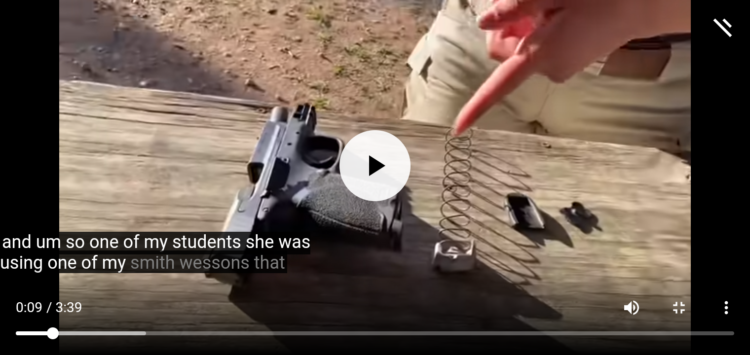

I’m thinking preceding round was a squib load and noob didn’t understand what was going on. Rack, tap, re-engage....KABOOM! Either that or cheap as shit factory or in house reload was double charged. I really liked the “this gun is not in shooting condition”...

Then no one could be bothered to show us into the chamber or the remaining pieces of the case.
From the 2.5 seconds we actually saw the chamber (not on purpose) you can see the case head has left a 'ring' of brass around the diameter of the chamber. She mentions the barrel has a slight bulge as well.
Those two things make me lean towards squib and 2nd round into the squib causing the chamber/barrel pressure to basically go backwards as the path of least resistance was the brass casing. The chamber brass ring makes me think that as well as it signifies the bolt had to be closed and then blown backwards with such force, the case left the damn case head behind after basically a fire jet of pressure blew through the middle of it. Case head separations/overcharged cases generally dont bulge a barrel from anything Ive seen.
The only thing I know of that can line all of these up is a bullet in the barrel. For a new shooter, they generally dont know WTF a squib is. When I have people start shooting I always tell them that when you shoot and a round going off sounds/feels totally different than the others, STOP.

Looks like a case head seperation to me
Well yeah, the outer diameter of the case head is still fused to the outside of the chamber.
I think it was caused by a squib.
The bulged barrel mention from her was what made me think its a case head separation caused by a 2nd round into the back of a squib, over a case head separation due to a shitty/bad round.
They also didn't seem to look in the barrel.
