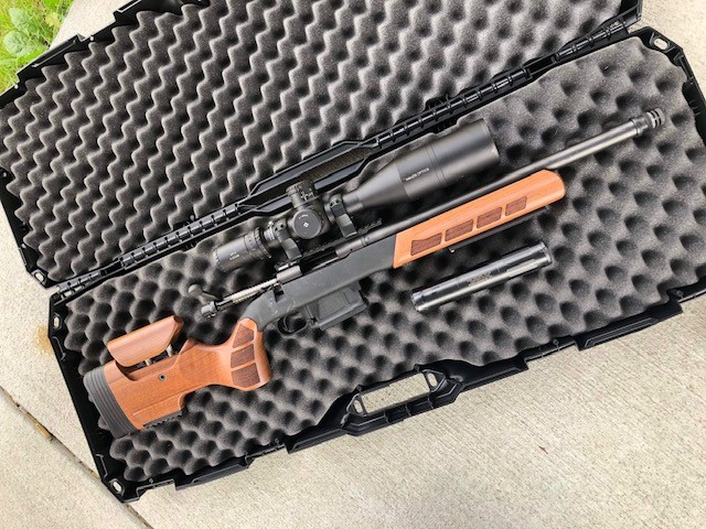

I have been using a Woox Furiosa on a Vudoo for over a year, shooting at least 6 times a month . I have a couple of observations. The butt stock is removable, which is nice, but it is very tough to keep tight and prevent it from flexing vertically. The aluminum spine in the fore end was very loose. I epoxied mine to the main aluminum chassis. This helped some but it too had vertical flex. The wood hand guard is very delicate and short and the m-lok inserts flex so much that I removed the bottom one in order to attach an Arca rail. the barrel channel is also very narrow but there is not enough wood present to mill out a wider channel without ruining the hand guard. I finally made my own stiff, wide and long hand guard. Overall it feels great but it is very light duty. It was clearly designed by an industrial designer and not a shooter. I will keep it on one of my bench 22‘s but it is too “floppy” for positional shooting, especially with a center fire. There is no comparison to the functional quality of MPA, Foundation, KRG, and MDT chassis that I have used. It is my opinion that it is almost a good product if its foundation was solid, it’s modular driven technology is a work in progress. If they improved these areas it might approach becoming a masterpiece arm.

I recently purchased a WOOX Furiosa Ultra with the intention of using it for a PRS rig. I must say the gun is absolutely beautiful. That being said I am unfortunately going to be returning it. 😢 The spine that runs down the for-end of the stock is not one piece and there is a serious amount of flex. Unfortunately there is so much flex that it sheared the head of one of the Arca rail screws off in the first few firings when you run it off of a bipod the barrel makes contact with the stock because it is unable to support the weight. This stock might work on a .22 rig, but definitely not for PRS.
