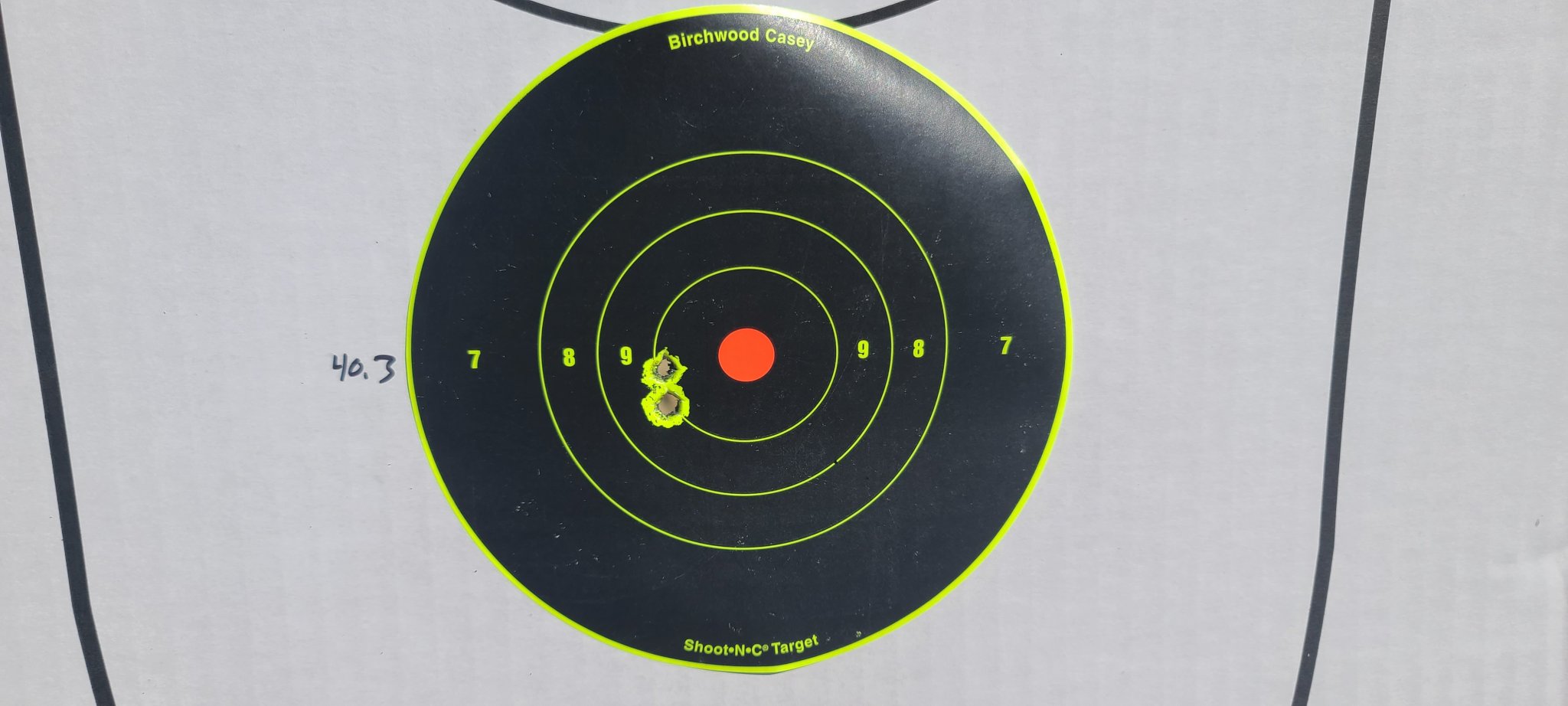

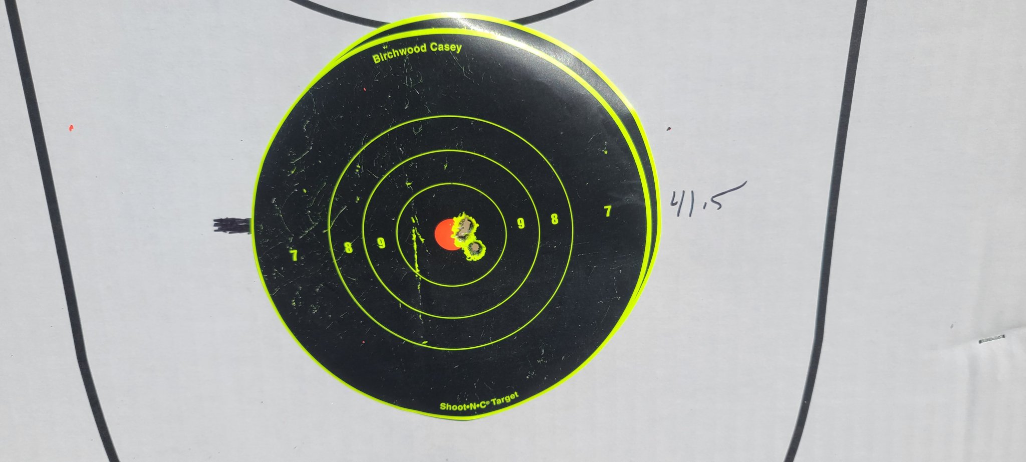

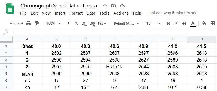

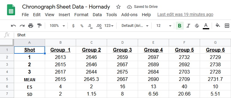

I'll start with the google sheet from the FPS data I gathered;
Something I noticed off the bat... there was very little variation between the loads. In contrast to my hornady brass, I noticed a lot of differences.

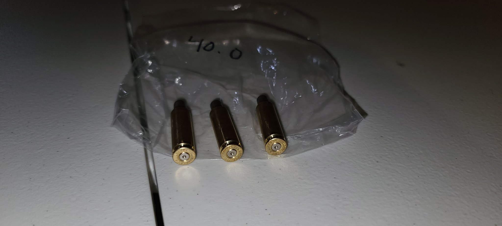

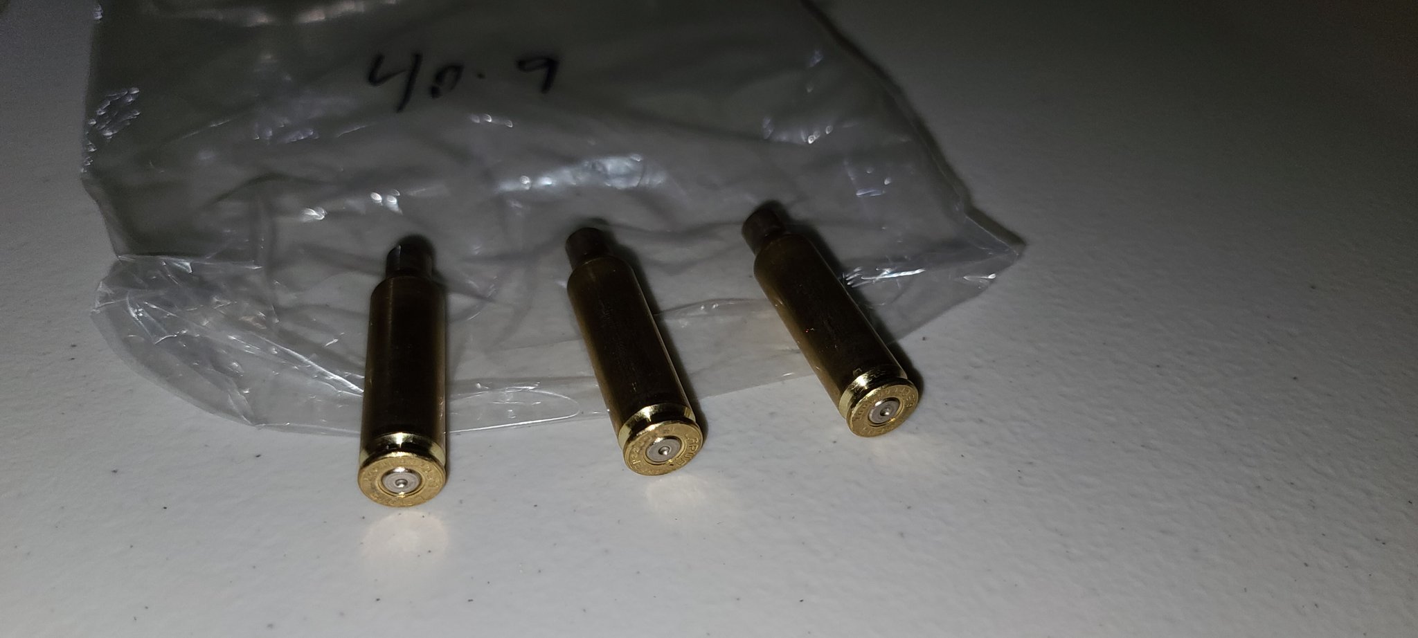

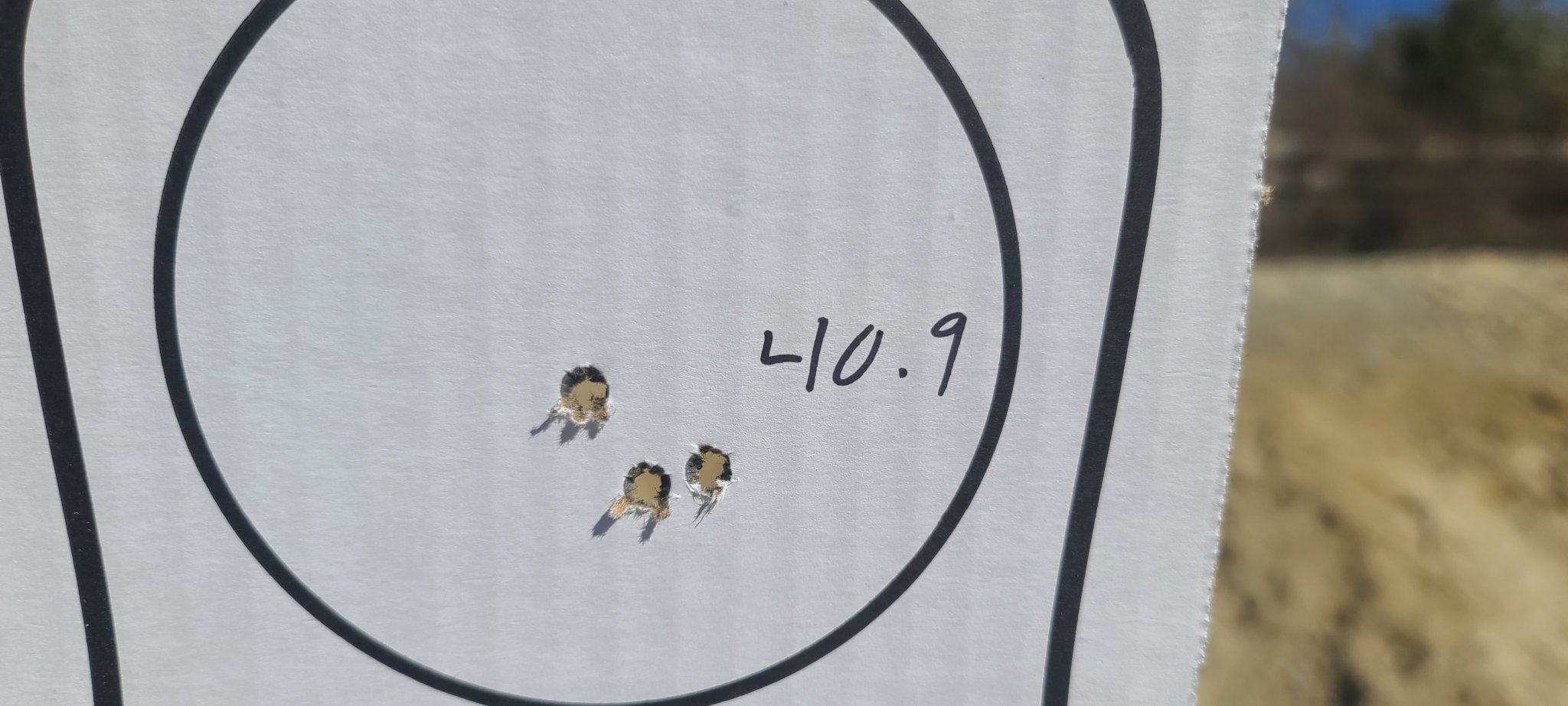

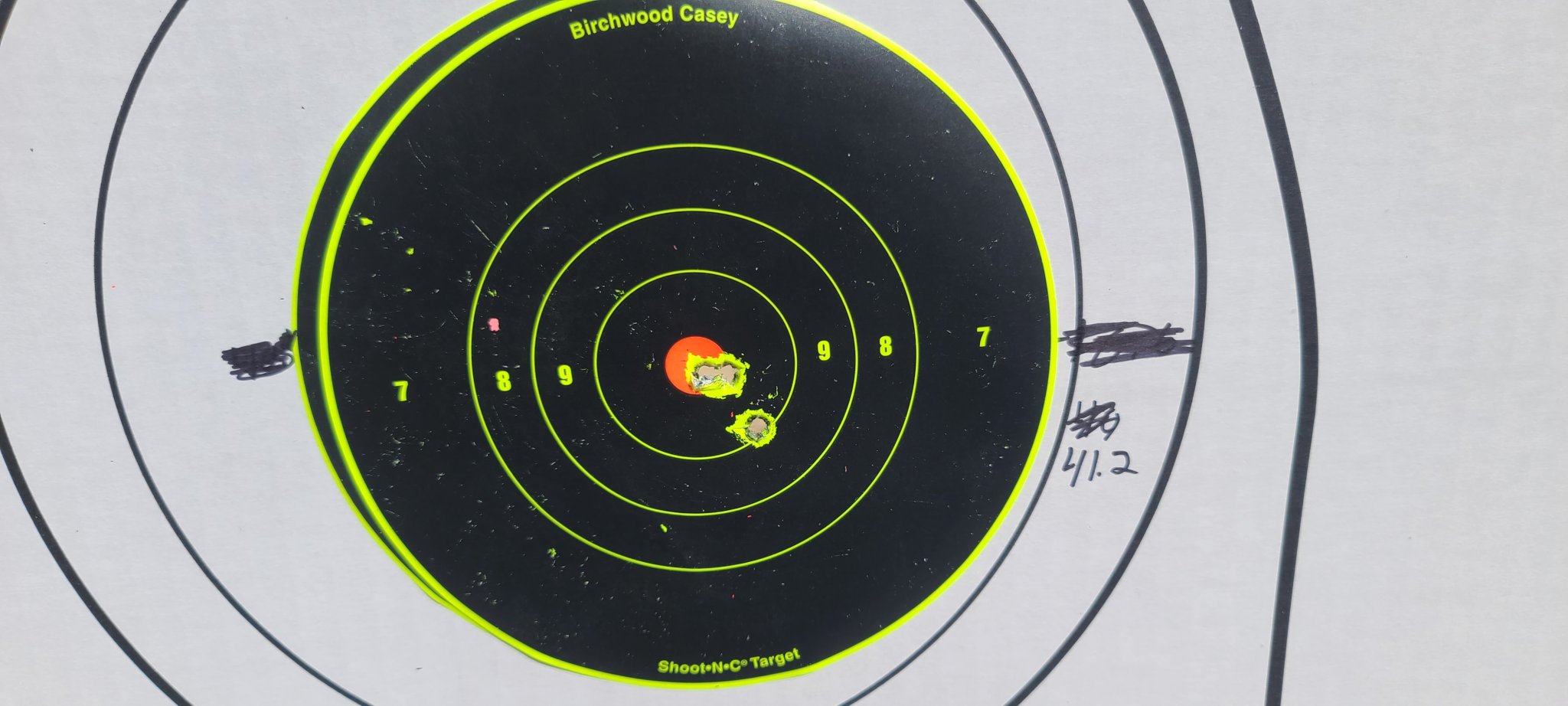

Other than that, the groups were as follows. (They were all 3 rounders)

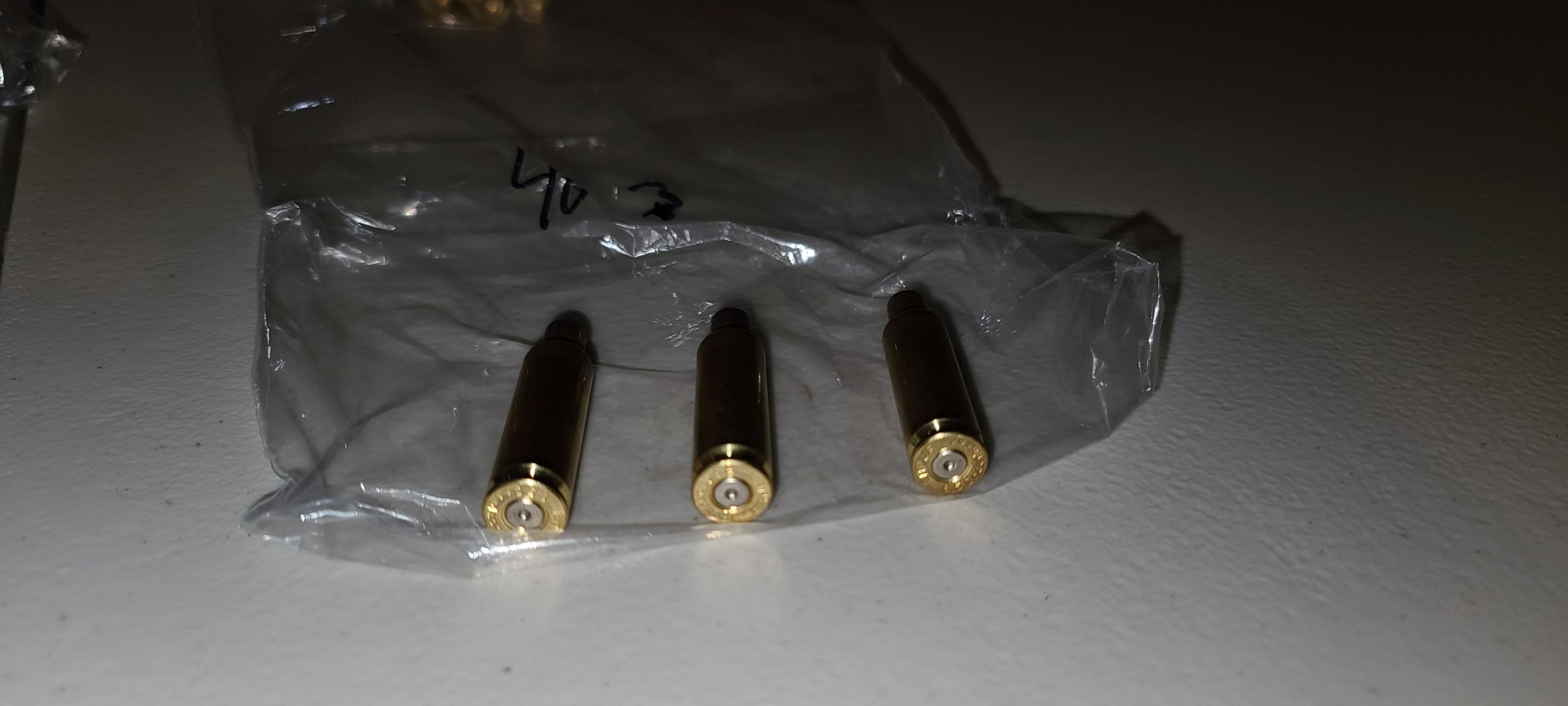

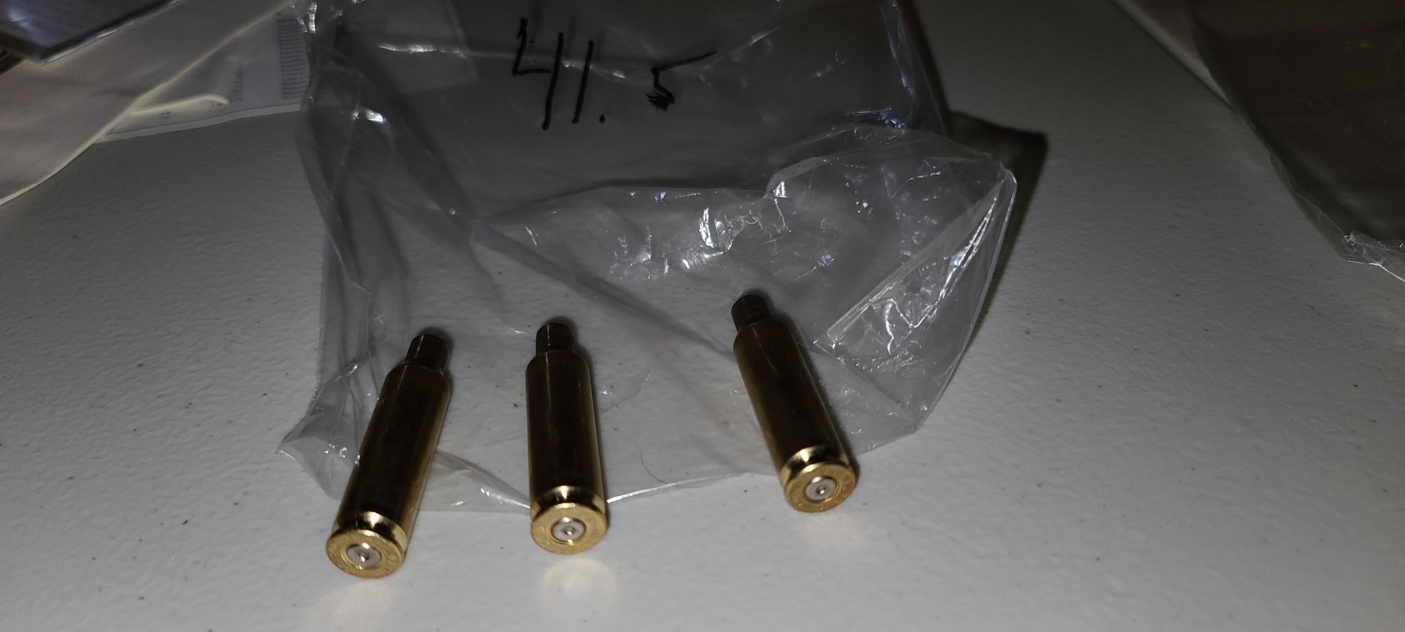

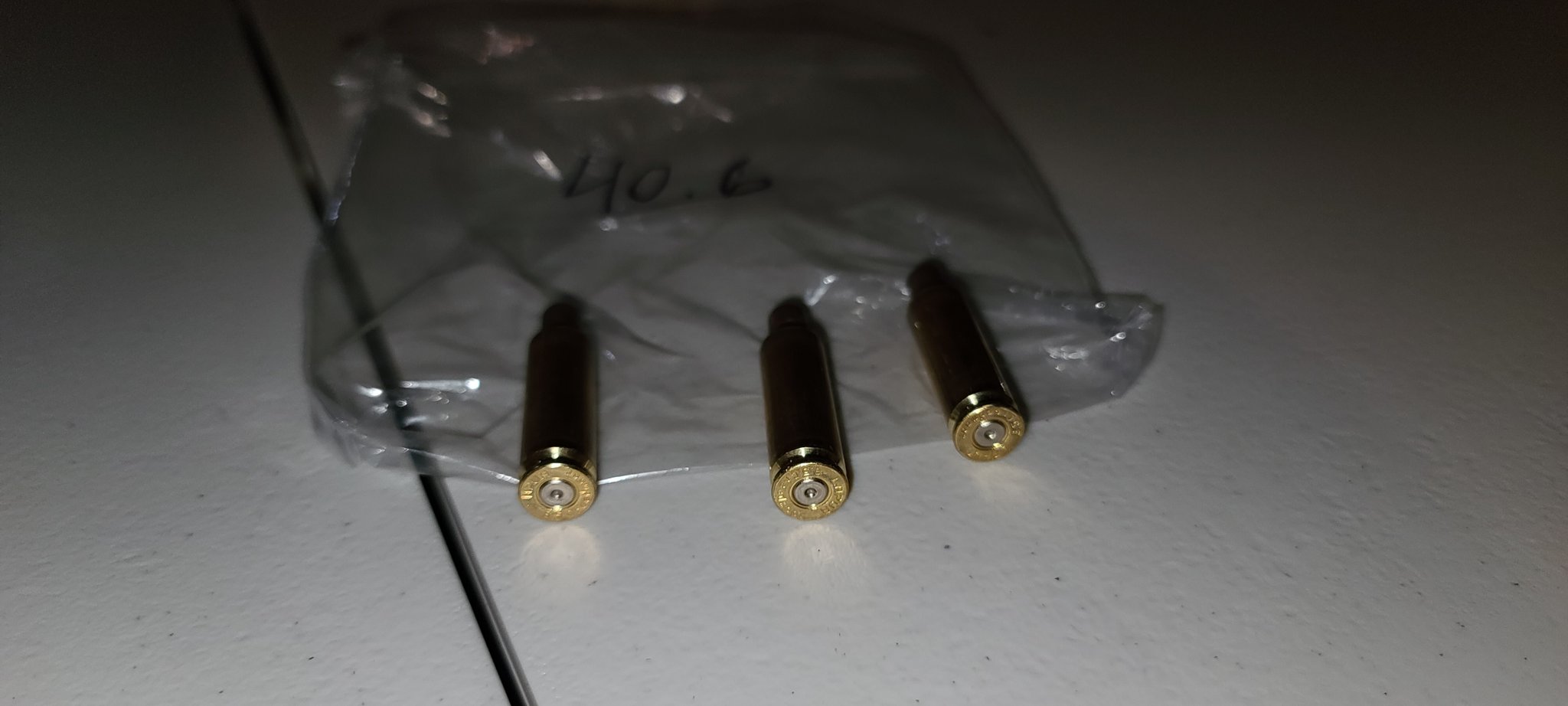

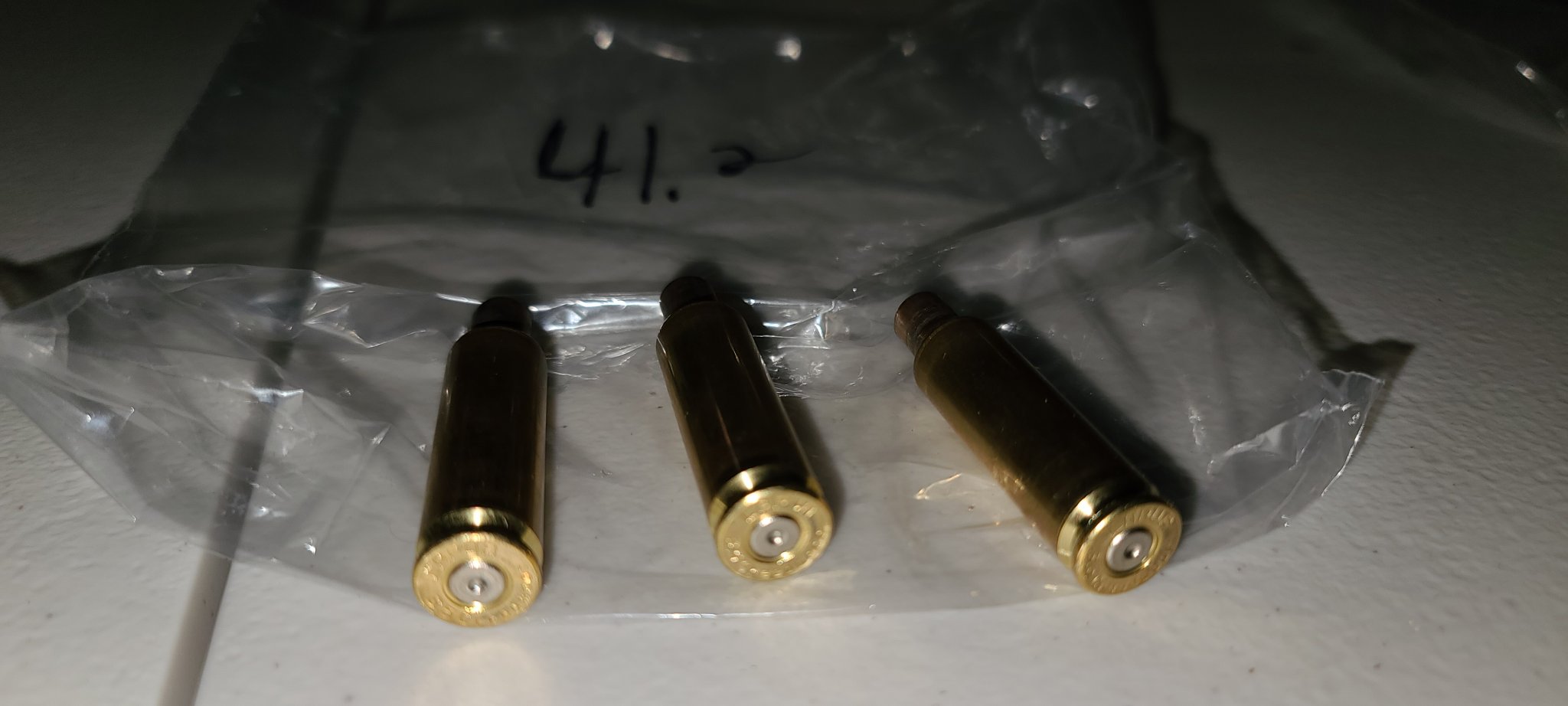

The last set shows no signs of over pressure on the primers.
I am not sure what to say?

Strange to see 1.5 grains with almost the same speed. Flat spots (‘nodes’) are usually 0.6-0.7 for this caliber.
Did you start with a clean barrel? In what order did you shoot the groups?
Some barrels are very slow after cleaning until they get some copper fouling. Can take 5-15 shots.
Hot barrel can also speed up some shots with less powder if you let it sit and cook in the chamber for a while.
1) Clean barrel
2) Started at 40.0, worked up by .3 to 41.5.
The max-ish load I had with the Hogdon brass was 42.5, so I assumed my max load would be about 1 less as Lapua is more compressed.

Strange indeed. Maybe you just got lucky and have a very wide node. 🤷‍♂️ My Lapua loads typically give good me nodes (flat spots in speed with low SD) that are 0.6 gn wide.
Some rifles have very flat speed curves close to (and beyond) max pressure. If you have a tight or min spec chamber, then thicker brass can get you to max a good 1 to 1.5 grain lower. However, your speed is probably too low for that to be the case. And Hornady brass would / should do the same.
Crony check: Recheck your old Hornady ammo, and if you get the same or very similar straight line as before, then you can trust your crony. Or try factory ammo you have measured before.

Your Hornady data looks more normal...what’s the difference between the lapua and the hornady sheets? Small vs large primer? New vs once fired brass?
any differences you can think of in loading process, components, shooting conditions?
Only thing different is the brass. Same bullet, primer, seating depth. Both Hornaday and Lapua were brand new brass.
Maybe 5 to 10 degrees different between the two days? But nothing major.
Nothing that screams no major difference effecting powder charge weights.

Hodgdon lists 40gns as their max load and they call it “compressed”. Likewise, my Hornady book calls 40.9 gns the max, compressed. It just so happens that I shoot 140 Berger’s with 40 gns of h4350 in lapua brass (small rifle) at right around 2700 FPS and I don’t experience compression at my seating depth (~2.86 COAL). I can shake a loaded round and hear powder rattling around and don’t hear the powder crunching as the bullet seats. But, I get a noticeable reduction in shot to shot variation in once fired brass over brand new.
so, you might try this again with fireformed brass and your new chrony. I don’t think a flat speed curve is too unusual at close to max pressure. Your speeds do not seem unreasonable....if maybe a tad on the slow side...which could be your barrel.
you might try five rounds each starting a little lower...maybe 39, 39.5, 40, 40.5...and watch your speeds come up...if they stop coming up at around 40 to 40.5 gns or around 2600 FPS, that might be all you get from that powder/bullet/barrel.
Your numbers/target at 40.6 don’t look too bad but there’s not great results on either side. So maybe 40.4 to 40.8 is a smallish node. With the error in the data at 40.6 though, it’s a pretty small sample.

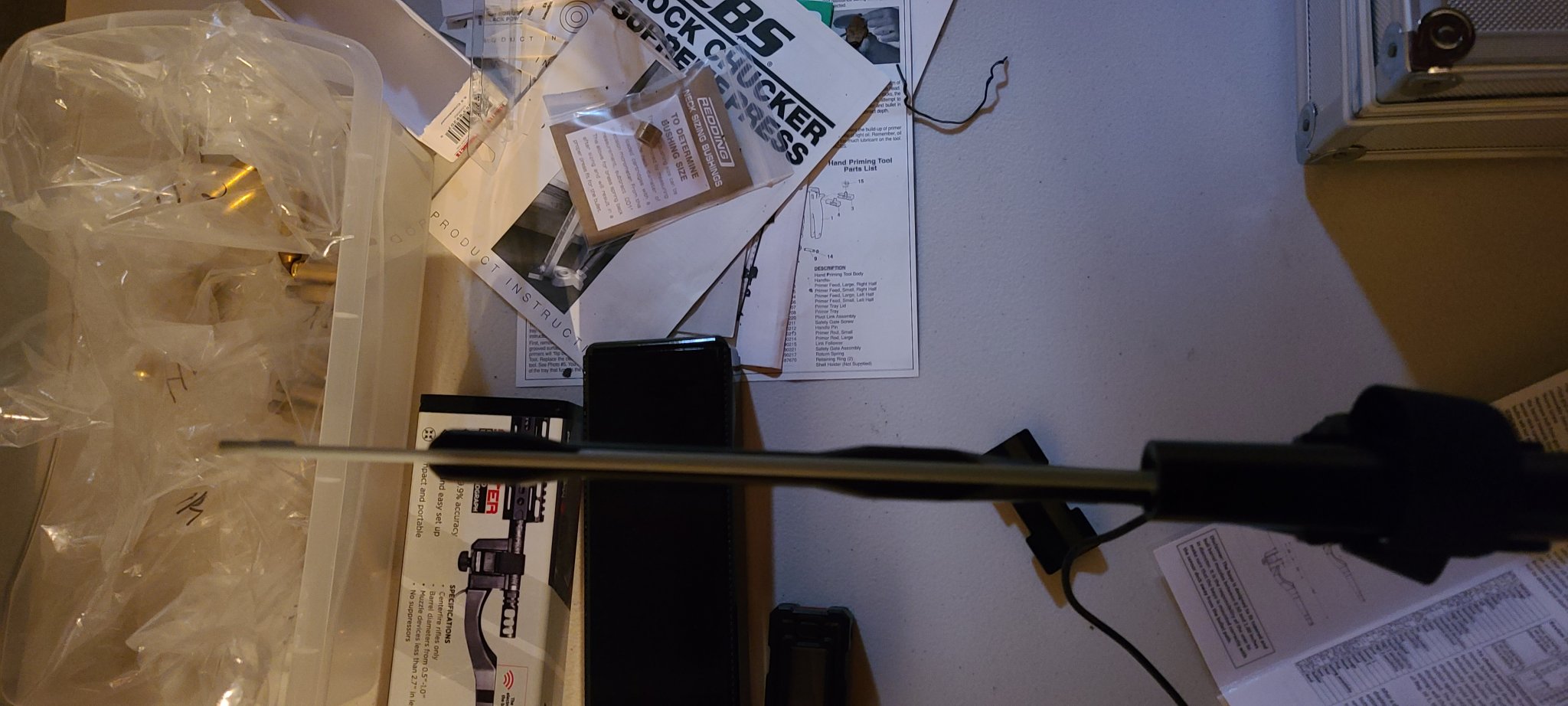

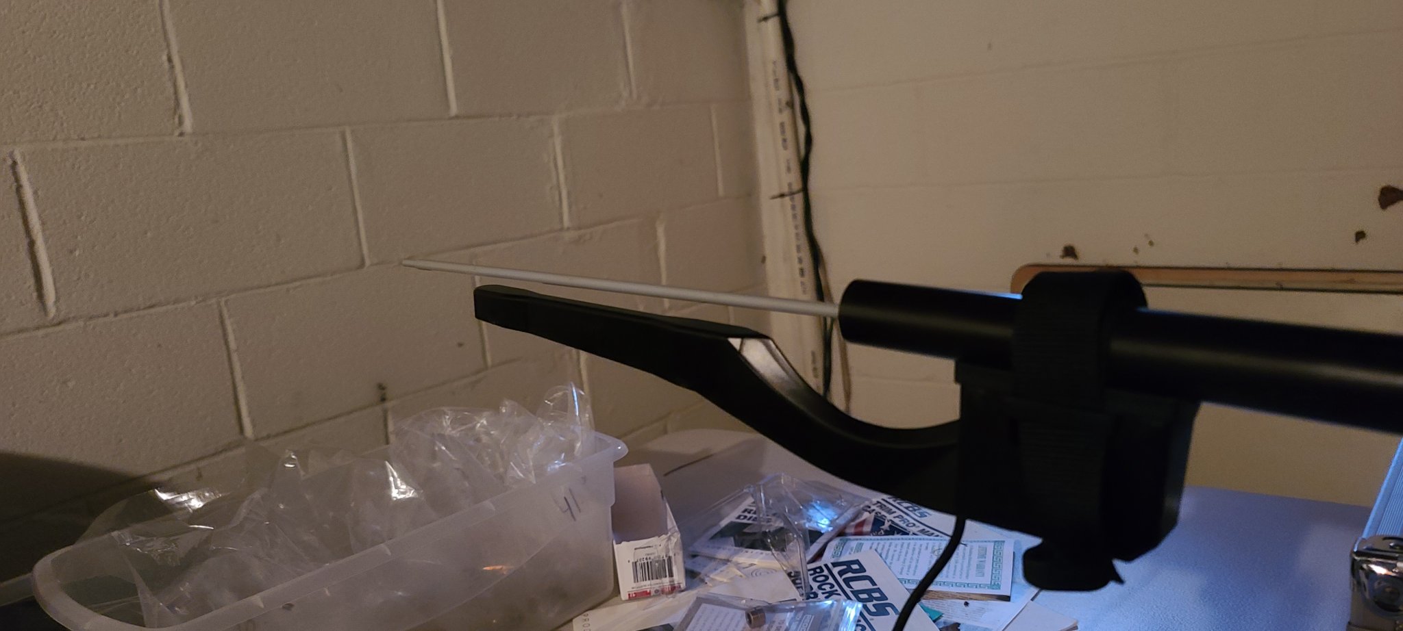

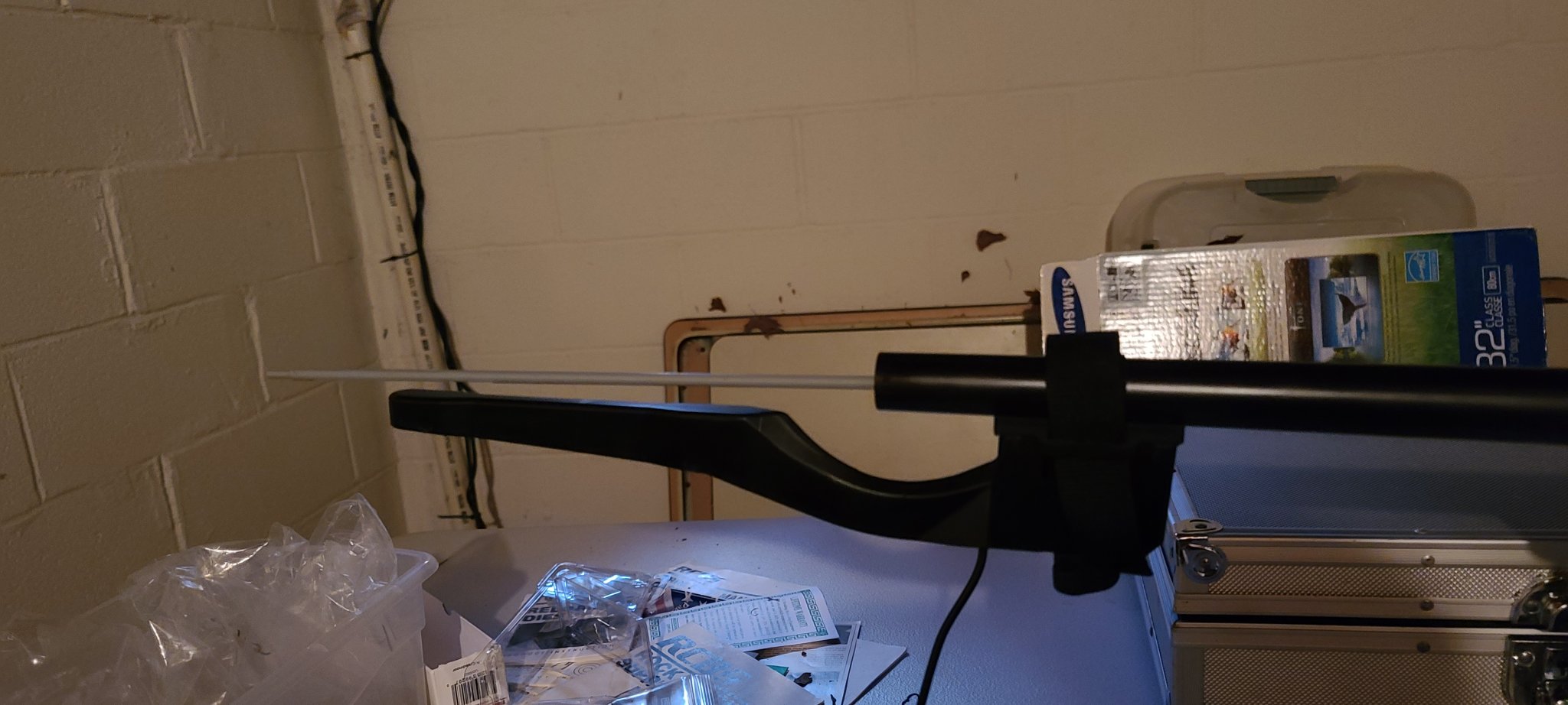

So, got the magneto... does this look OK? The device looks like its a bit tilted up, but according to the road I used its still clear of the round.

Looks like you actually need it a bit closer. You can also run it like that and increase the sensitivity if you need to. I always like to remove the bolt and look down the barrel to make sure I have clearance.
A bit closer in what way?
I believe you want a quarter of an inch between the bullet and the sensor deck. You also want is as straight as possible

I think the barrel is tapered, as it is a bit tough to get it as straight as it is.
Should work. Shoot it and find out. May have to increase sensitivity or use the smaller rubber spacer.

The smaller spacer was worse on the angle, I switched to the larger and it helped reduce the tilt.
Reactions: 2aBaC̶a̶
You can probably use some electrical insulation tape below the rubber spacer to correct the taper problem.

This is more inline with my Hornady brass, as the picture up shows.
Should I increase the powder a bit more? I am still not seeing any pressure signs. Ill post pictures later.
Ok, so with the magneto setup I tried the factory ammo first.
Hornady, 147 Match. Box says 2695 MV.
I did 2 test rounds.
2644
2661
Then I did my handloads.
41.5g
2691
2686
2687
41.8g
2695
2699
2671
Then I finished up with 2 more factory.
2666
2635
40 degrees today.
Your rifle/barrel is just a little slower than average, nothing to worry about. It could be barrel characteristics, or chamber dimensions.
If i was confident there are no pressure signs in a case like this, i normally go up in 0.2 gn increments - and watch very carefully.
I went up to 42.5, and I started getting hard bolt lifts (sticky bolt?).
At 42, I was pushing 2725 my ES at 6 and SD at 3,
I was happy with the combo. Just need to work on my seating depth.
