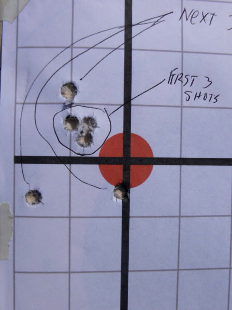

OK one other variable. I took the gun to the range and waited a little longer between shots. Instead of 15 to 30 seconds I waited more like a minute. With what I think is the pet load for the rifle it seemed to tighten up some. But of course I didn't have much of that load. What do you guys think is reasonable time between shots and letting the barrel cool? I gave it a big time cleaning last night and put about 30 rounds through it today so I'm gonna try not cleaning it for a couple hundred rounds as well. I can't tell you guys thanks enough for all the feedback.

<div class="ubbcode-block"><div class="ubbcode-header">Originally Posted By: triplecelectric</div><div class="ubbcode-body">OK one other variable. I took the gun to the range and waited a little longer between shots. Instead of 15 to 30 seconds I waited more like a minute. With what I think is the pet load for the rifle it seemed to tighten up some. But of course I didn't have much of that load. What do you guys think is reasonable time between shots and letting the barrel cool? I gave it a big time cleaning last night and put about 30 rounds through it today so I'm gonna try not cleaning it for a couple hundred rounds as well. I can't tell you guys thanks enough for all the feedback. </div></div>
That will kind of depend on the contour of your barrel, your stock set up, whether it's bedded or not, and a few other variables. A heavy MTU barrel can get smoking hot and not affect accuracy one bit. Some light weight hunting barrels can only take a few rounds before they get smoking hot and start to walk.
What's your rifle set-up?

The rifle is a GAP build. Not sure which barrel only becuase I think it's a little older but it is a full GAP build heavy 25" barrel, McMillan stock, worked trigger, bedding etc. I bought the rifle here and was told it had about 1800 rounds down the tube but I got it third hand so I really don't know what the barrel condition is.

<div class="ubbcode-block"><div class="ubbcode-header">Originally Posted By: triplecelectric</div><div class="ubbcode-body"> What do you guys think is reasonable time between shots and letting the barrel cool? </div></div>
Here's some examples of a good shooting rhythm:
<object width="425" height="350"> <param name="movie" value="http://www.youtube.com/v/uLrsHZSk7XA"></param> <param name="wmode" value="transparent"></param> <embed src="http://www.youtube.com/v/uLrsHZSk7XA" type="application/x-shockwave-flash" wmode="transparent" width="425" height="350"> </embed></object>
And a good way to let the barrel cool.......
<object width="425" height="350"> <param name="movie" value="http://www.youtube.com/v/wJDjyE3mMxs"></param> <param name="wmode" value="transparent"></param> <embed src="http://www.youtube.com/v/wJDjyE3mMxs" type="application/x-shockwave-flash" wmode="transparent" width="425" height="350"> </embed></object>

SB I can't tell if your being sarcastic over the internet. That is a great post. Would you think that that rate of fire would affect a quality barrels accuracy?
Re: Worn Our Barrel?
<div class="ubbcode-block"><div class="ubbcode-header">Originally Posted By: triplecelectric</div><div class="ubbcode-body">The rifle is a GAP build. Not sure which barrel only becuase I think it's a little older but it is a full GAP build heavy 25" barrel, McMillan stock, worked trigger, bedding etc. I bought the rifle here and was told it had about 1800 rounds down the tube but I got it third hand so I really don't know what the barrel condition is. </div></div>
~2000rds should still leave plenty of life for a .308Win and if it was a GAP build then it's most certainly a custom barrel. What kind of groups are you getting? Have you had someone else shoot it? Have you tried different loads?
If this is a GAP then the rifle definitely has the potential. If your optic set-up is top notch then it all comes down to you and how you drive the rifle. I would highly recommend you get some factory FGMM and shoot that to get a rifle baseline so you know what the rifle is capable of and the rifle doesn’t get the blame for "other" questionable factory ammo or your reloads.
Try it out with some FGMM. If it doesn't group, swallow your pride and let someone else shoot it (I do this all the time-I can hold about 3/4 moa at best when shooting groups.....).

No it wasn't that one. Mine came with the HTG stock. I've put some FGMM match down the tube and think I'm building some good loads that group better and more consistently than the FGMM. Using Lapua Brass Full Case Prep RE15 42.4 grains CCI BR2 primers about 2700FPS. Optics are NF 5.5-22. I'm getting sub MOA out of it at 100 but get the more than occasional flier. I would think I should be able to get consistent 5/8. What I think I should do is post some targets and have you guys look at it. Maybe I'm being too hyper critical? I really like the idea of letting someone with more experience shooting my gun and see what they do.
Honestly, shooting .5-.7moa groups consistently from a gun that will do it is heavily dependent on the trigger puller.
Rifles are easier to make consistent shooters out of than people.....

How much load development have you performed? The 308 is a fairly forgiving round, but by no means the easiest to load for.
I think the idea of getting a driver with lots of experience behind it would put the rifle or load concern to rest.

I have built no less than 35 different load variations with the following components. The funny thing is the gun HATES 44gr Varget. The best load I found was the one mentioned before. The weather around here has been anywhere betwee 45 and 65. I'm just a little at my whits end. I'm also shooting 5 shot groups.

I think you're exactly on the right track reloading-wise. Especially with a GAP, you can't go wrong with the SMK. When I was developing a load for my Savage, I played around with the powder charge ALOT....here's what I'd do: (you may have already done some of this)
1. Work up loads in .2-.3gr increments from the "start" grains to the "do not exceed" grains and shoot 4-5 shot groups.
2. Pick your 3 best groups and shoot them out to as far as you're going to be shooting and see if they hold their MOA measurement at 100yds.
3. Pick the load that BEST holds the MOA measurement (not necessarily the tightest at 100....unless that's all you'll ever shoot).
4. Load that final powder charge in .005" increments from the lands out to about .015-.020".
3. Pick the best group and you're pretty close.
You can continue to experiment with what holds MOA the best out at distances, but you should have a good starting point.
My rifle shoots about .5MOA at 100, but holds that out to distance. I have arrived at loads that have consistently shot .3 or better, but, pilot error or not, could not get them as tight out at longer distances (600+ yds).
Another comment about the barrel...I find that I stop shooting because of mirage in my scope before accuracy diminishes.
Oh...your barrel might also be shot. hahaha
YMMV, there are many approaches to reaching a "pet load"
-Erik

Does your group open as the barrel heats? I am no expert but here is what happened to me and I was told this is a sign the barrel is gone. First 3 shots grouped then opened as the barrel got hot. This is from a Warbird so it has a lot of heat. I am done with the Warbird will rebarrel in anothter cal.
