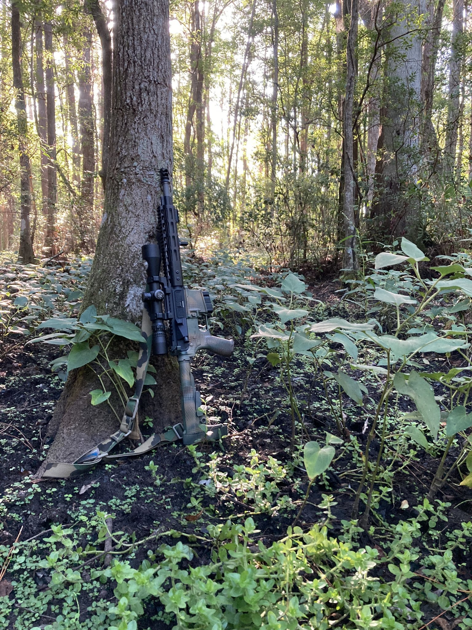

I built a light, not ultralight and definitely not premium, 12.5” Grendel for deer hunting. I will make a couple recommendations based on that experience.
Don’t do ASR on this build. You want 100% suppressed and lightweight? Why do a heavy locking QD system. Direct thread all the way. Lightweight taper mount if you’re dead set on using a mount. (Edit: hell you’re paying for a titanium gas block, why would you pay more money for more weight further down the barrel)
I’ve got a Hanson profile barrel and it doesn’t drift too bad at my 200 and in hunting distances even if I dump a mag at the range. Instinct, not experience tells me not to try much more than that.
I’ve got an 11” handguard on mine. I like it ergonomically. A loss of one inch would be a mild annoyance but not a deal breaker.

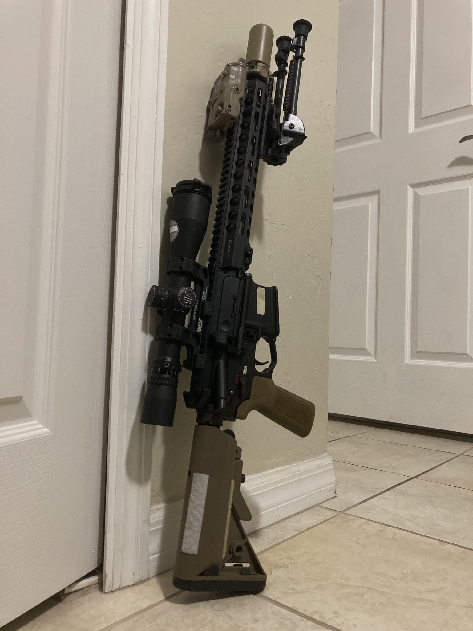

Hey friend,
For some context I wanted something similar to you and this is the route I went,
Barrel and GB
I have a Noveske barrel. It produces consistent sub MOA groups, sometimes sub half MOA groups. I'm pleased with its accuracy. My first choice was going to be a PF barrel as well, but on a whim I jumped on the Noveske.
The GB is pinned by Noveske and it seals tight, even when suppressed.
BCG
JP Bolt works great. Reliability is 100%.
Bootleg adjustable carrier. This was a must for me as I run mine suppressed and unsuppressed. Again, it's 100%.
Upper
I had it setup with a VLTOR MUR upper but I found out that didn't fit on my MARS lower, so I made the switch to a FCD forged upper. It still shoots just as good, has not wobble on my MARS lower. Both have been GTG for this barrel.
Handguard
I wasn't as weight conscious as you are but I didn't want a short pig of a 6.5G either, so I initially used a Noveske MLOK 9" HG which was lighter weight and can be seen is in the pictures I posted above. When I changed the upper, I took the opportunity to put a longer HG on to mount other devices. It now sports an 11" FCD MLOK HG. It's still not a pig but it's not as light when I put a can, LAM, MPVO, WL, bipod etc, on it.
The end product is a very useable 100% reliable hog getter.

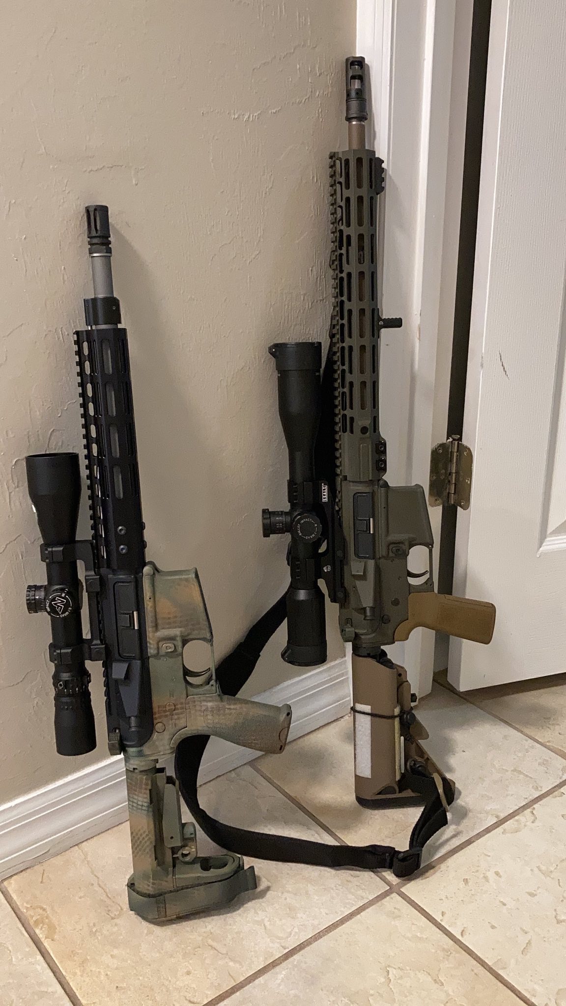

I used to be all in on the Superlative Arms adjustable GB's. That 16" rifle to the right of my 12.5" Grendel in the picture above was my go-to DMR comp rifle and it had a SA on it too. I've never had a SA seize up or carbon lock on me, but I have experienced that with other quality GB's, so it's always a thought in the back of my mind.
The adjustable carrier is just so much easier to adjust over any adjustable GB that I've used, and I can visually verify where it's at [which is a huge value in itself]. By just looking at it, I don't have to shoot and find out that I forgot to adjust it for how it's set up in that moment.

Need some input here after calling around this is what I have being held for me untill I make a decision here by the day.
12.5” Kreiger I can build how I want it
Or
11.5” bartlein carbine+1 gas with tube included
Both are .750 gb size barrels
Most likely be a 11” handguard from v7 I think
This is my first Grendel what barrel would you go with.
What gas length for the 12.5? If Carbine I'd go with the 11.5" +1. You didn't mention, what profile for each?
I have the option on the 12.5" to go Carbine or Mid. Mark at PF recommended the Carbine but could do either. for now that choice is over my head.
LRRPF52 recommended MID i believe with his experience
