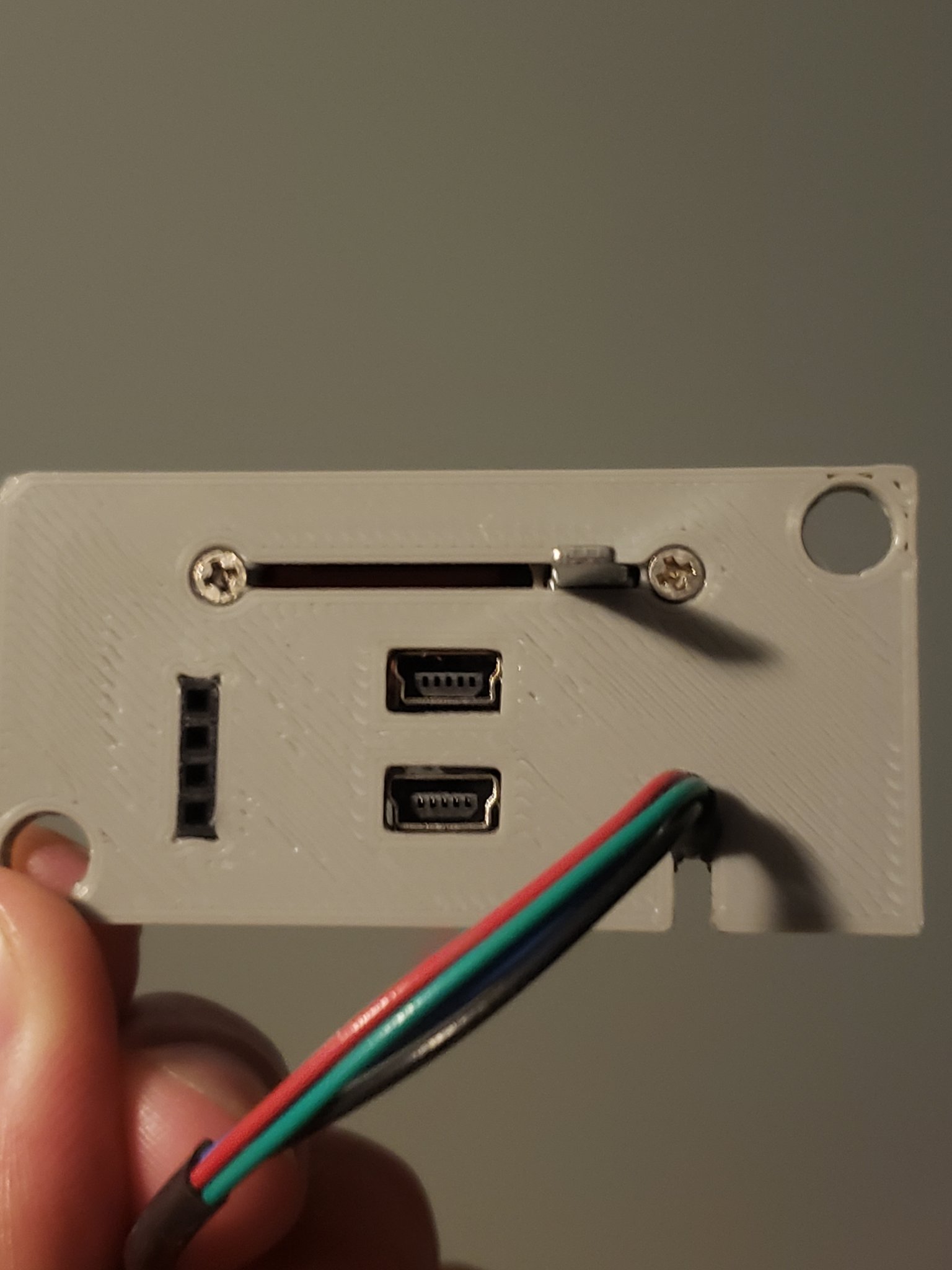

Is this the right one?
I believe so, but need pics of the upper and lower boards to verify.
