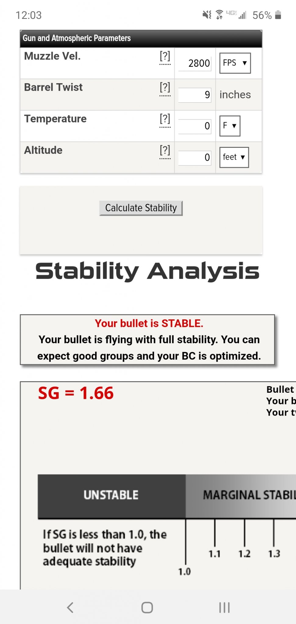

    Running the berger twist rate calculator with 230s, in a 9 twist, at sea level. Zero degrees outside, at 2800 FPS your more then stable enough. So that's the very worst conditions I could think of for a coastal hunt in AK or alike, at sea level, when its zero out.

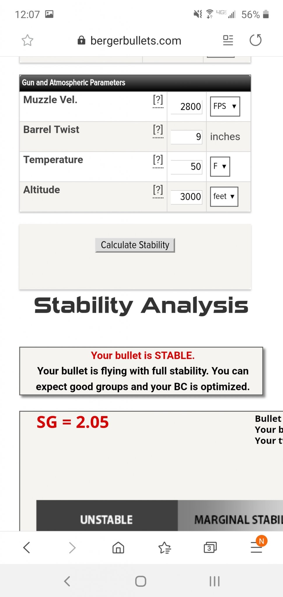

    No need to over spin them like crazy. 1.66 SG is plenty in those extreme conditions. The second pic is 50 degrees at 3000 elevation and your already into the 2s. Depending where you hunt, a 10 twist works well too.
    A 9 twsit covers you in every way even with extreme cold and at sea level. Just food for thought before chasing an 8 twist..
