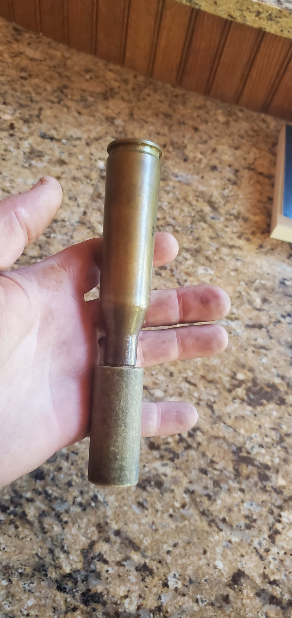

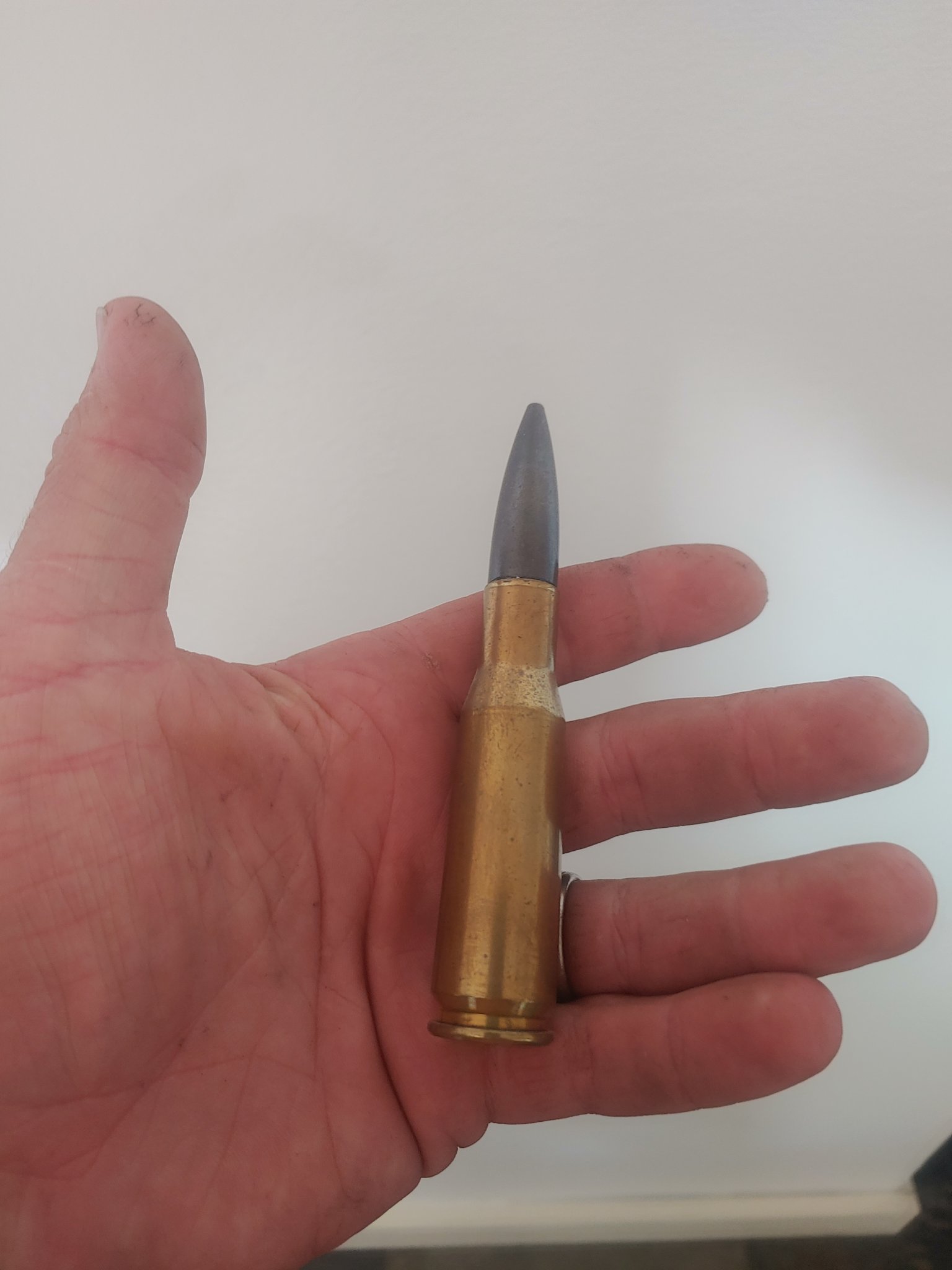

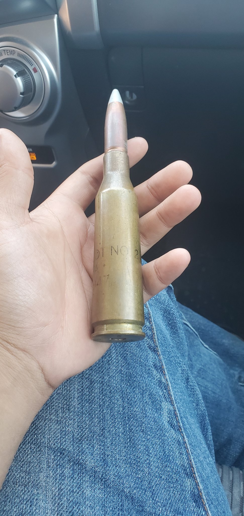

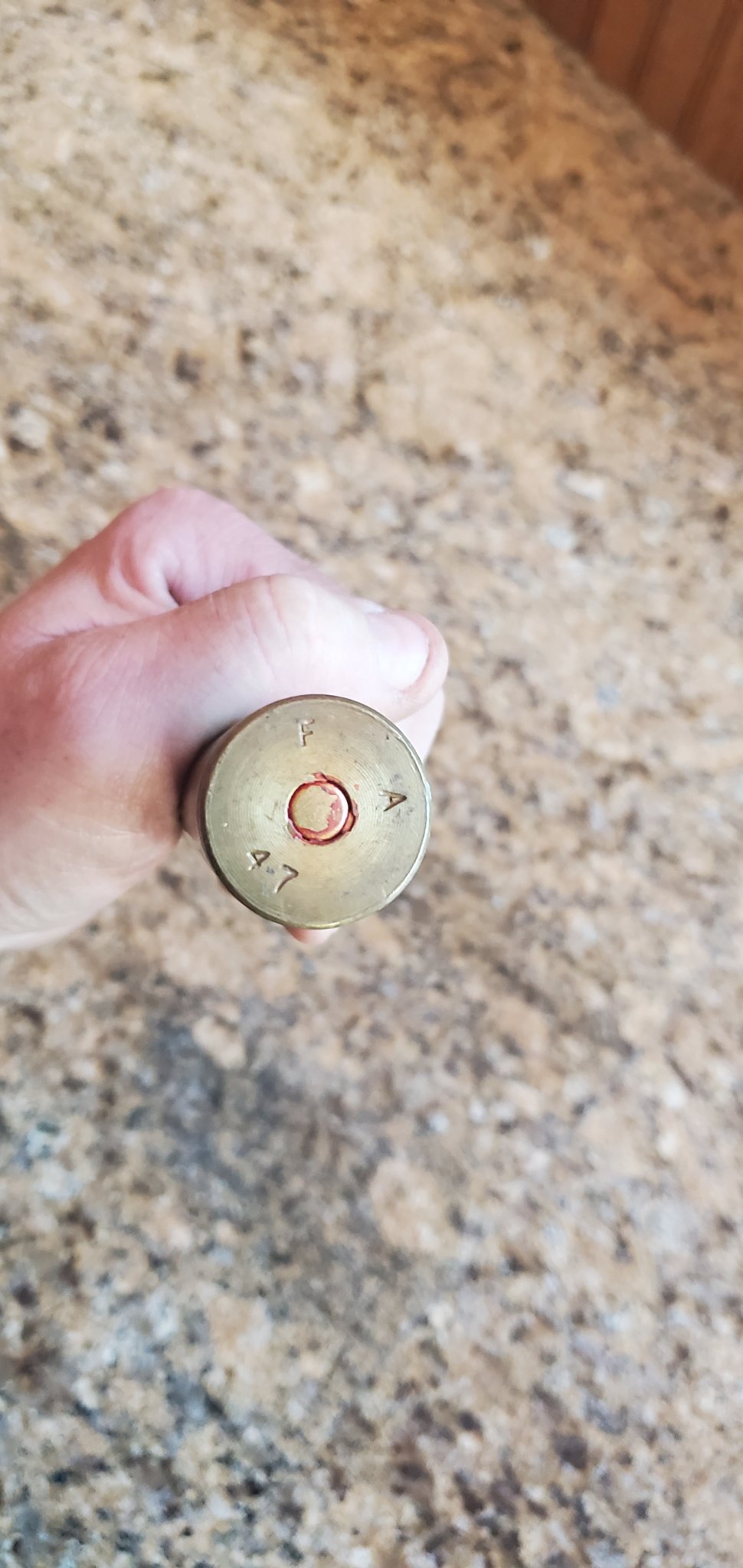

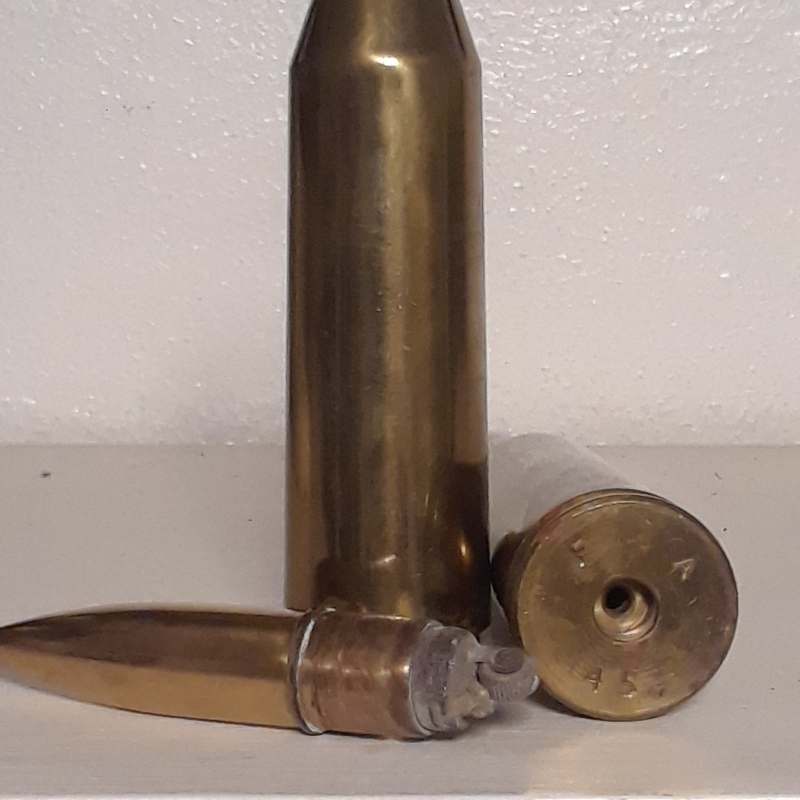

WTF am I looking at... necked down to 50bmg
Long_Action
Jul 19, 2009
726
2,543
46
Michigan
1947 head stamp with a 50bmg bullet. Thinking it is a EXP round as it has an individual mark. Just picked it up from from the old gunsmith in "Shooter". I bought a cartridge collection from someone in their 80's. Lots of questions...
Top 2 pictures are my hands lol. Bottom pic is my 14yr old. After doing some research and measuring, I've concluded that it's a 60 caliber machine gun round.
Possibly an experimental cartridge based on what FA was doing in 1947. The other markings on the case may provide better search results.
That being said I could have sworn I saw something like this in Vintage for some other large MG I'd never heard of.
