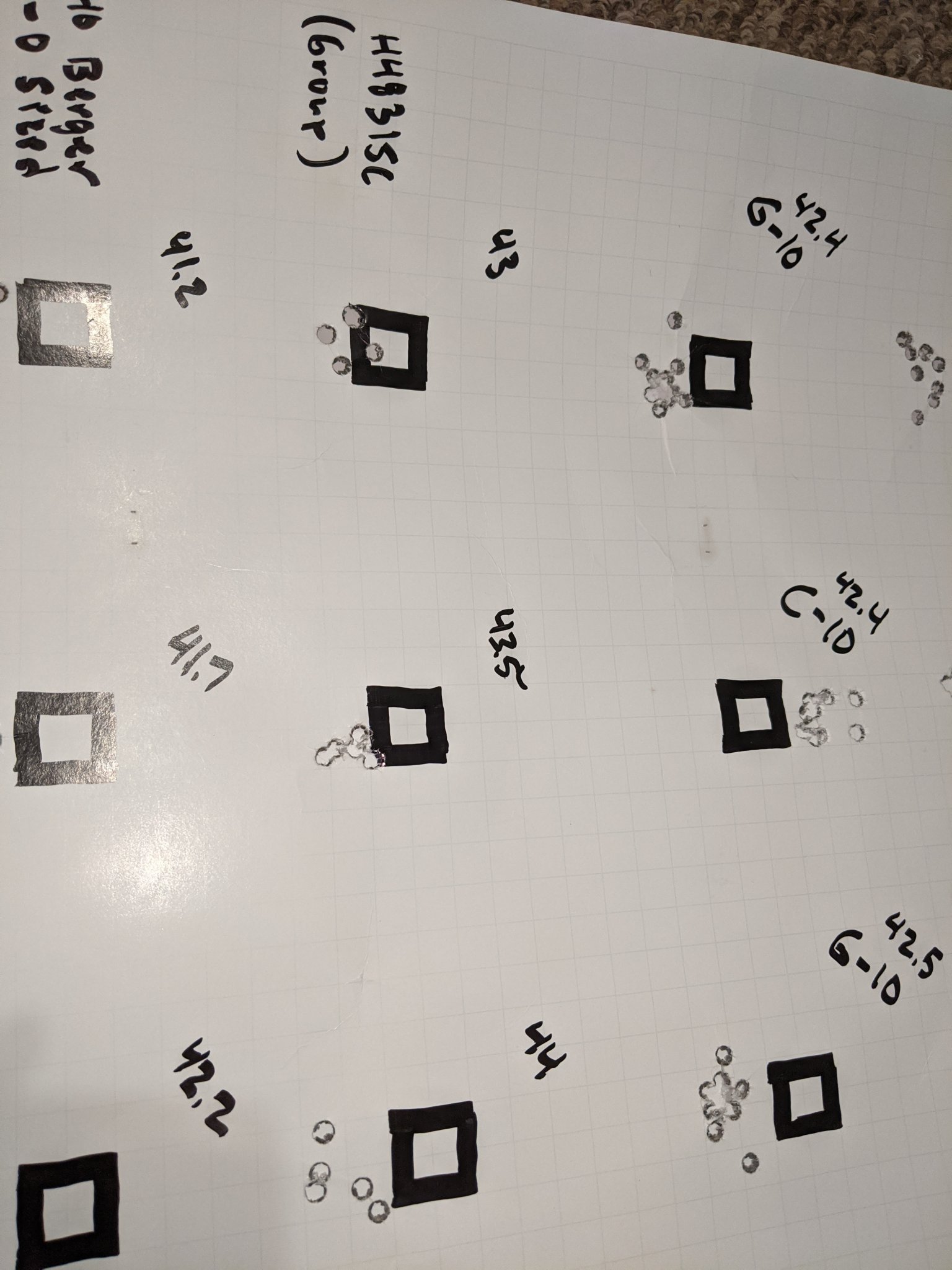

I know that 6.5 Creed with 4831 with 140 gr bullets your stopping point is compression before pressure. I'm not sure where you will be able to get with a 129 but 44 grains was compressed enough with a 140 that you get a good amount of seating creep due to compression of the load. The rounds are creeping down range too. Running high 2500 real low 2600.
I was using H4831SC basically just messing around. Loaded up to 45gr which felt like you were seating a pillow.
