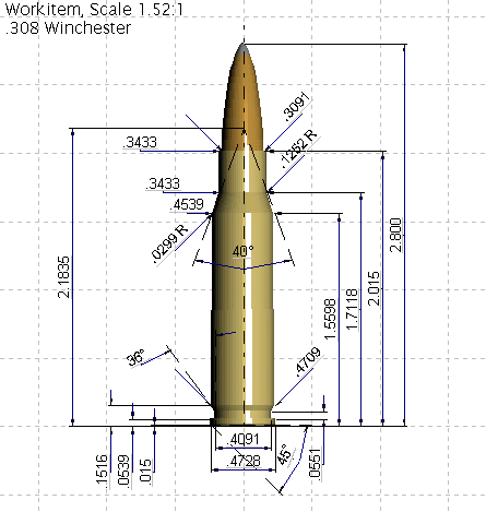

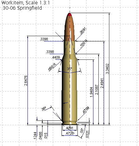

The 7.62x25 case head is ~.38" in diameter, the 30-06 is .473-.475 on your rifle.
