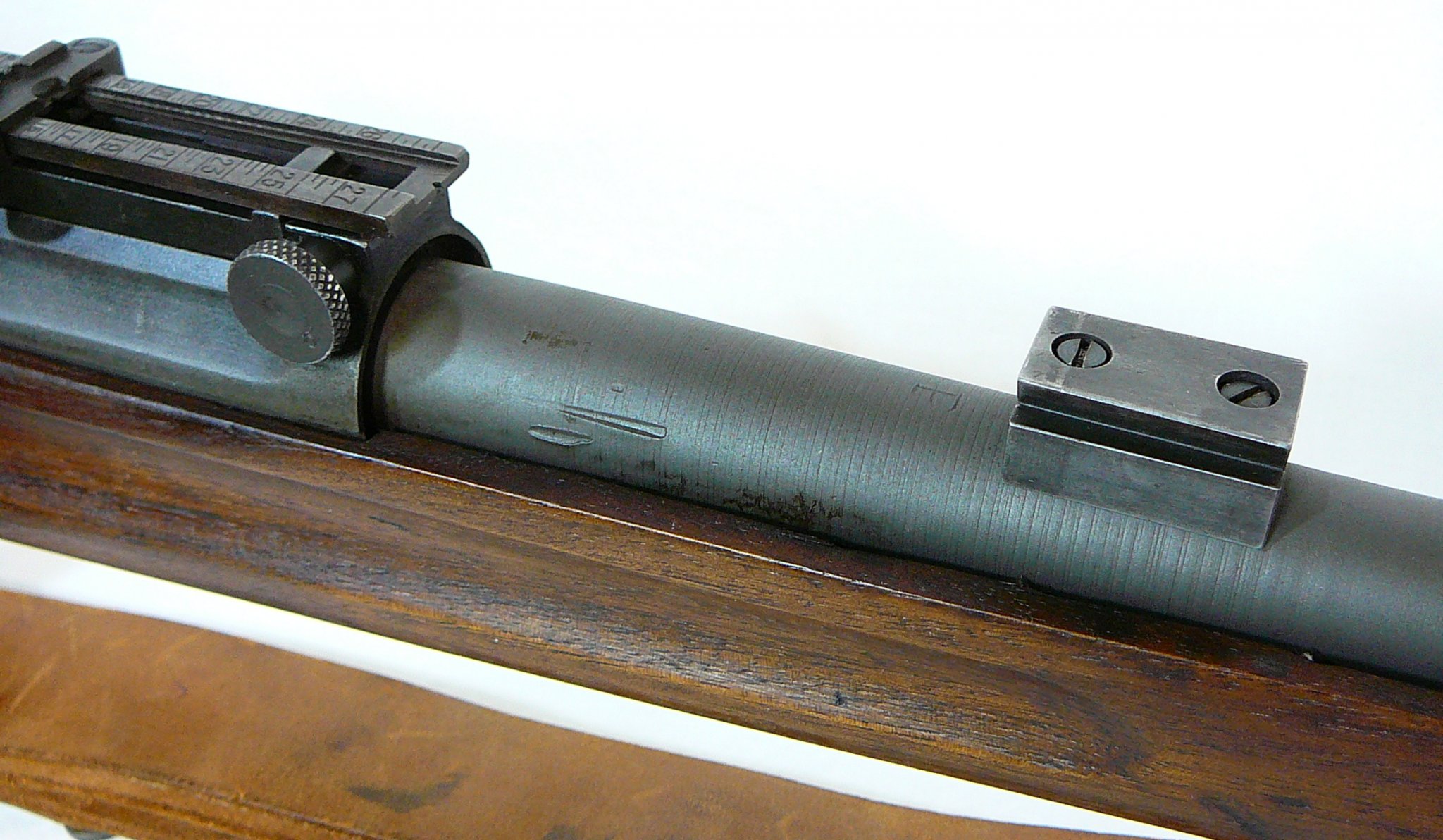

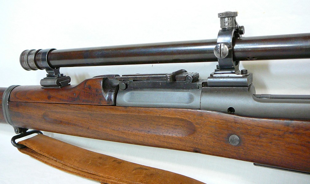

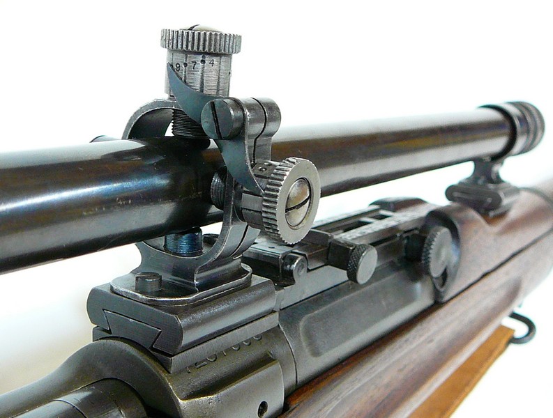

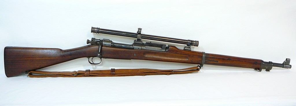

I'm starting a new research project so if you have one of these rifles please contact me. There has to be more of these out there. The Marines built 40 of these for Sniper Training around May 1941. Which 20 (each) went to the 1st and 2nd Marine Divisions.
Then the Marines built 80, forty each to the forming 1st and 2nd Raider Battalions in Febuary/March 1942.
As of right now, only 3 of these are known. One that is about 300 digits off this one in the 1.25 range. Then a third that is in the 1.33 serial range that was actually sold at CMP auction.
I think most people that know of this variation, think of the Mann Niender as a WWI rifle, but it really wasn't. There were a 150 built in May and June of 1917 by Niedner for the Marines, but he was then fired as being a potential German Saboteur. Winchester then received the contact for the A5 sniper rifles, but that was not a Mann Niedner style rifle. By the time the Marines started to produce their own version of the Mann Niedner in house at the Philly Depot, the war was basically over. So the Mann Niender's were used in training or by the Marine rifle teams in between the wars.
Some Mann Niedners were built with a heavy Remington or WRA barrel, sporter or commercial stock with lyman 48 sights, and were called Free High Pressure rifles. The Marines nicknamed these rifles as "Free Rifles"

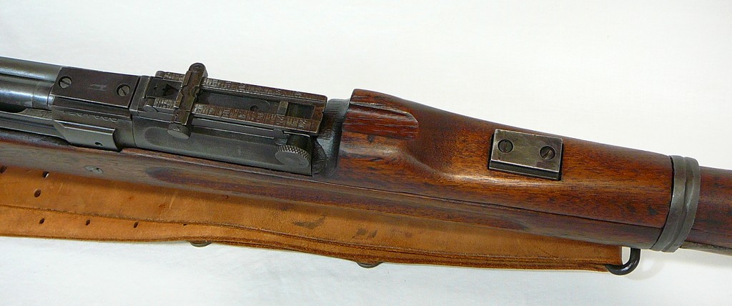

Just reading the docs, I do believe this receiver was likely at one time built into a Free High Pressure rifle for the Marine rifle team. That is why I think it has the lyman 48 sight holes. The holes were drilled before it was parked the last time, so I do think they were drilled while in service.
At the start of WWII, almost all of the Mann Nienders left in the Marine Corps inventory had been broken down and show up as loose components in storage at the Philly Depot. It appears at the start of WWII, the Marines just removed the parts from storage and built sniper rifles out of them.
As for this particular receiver, I believe it was in a shipment of 50 1923 National Match Rifles that the Marines had kept in 1928. At least one from this shipment was built into a Free High Pressure rifle, which is still located at Quantico. I assume this one was as well.

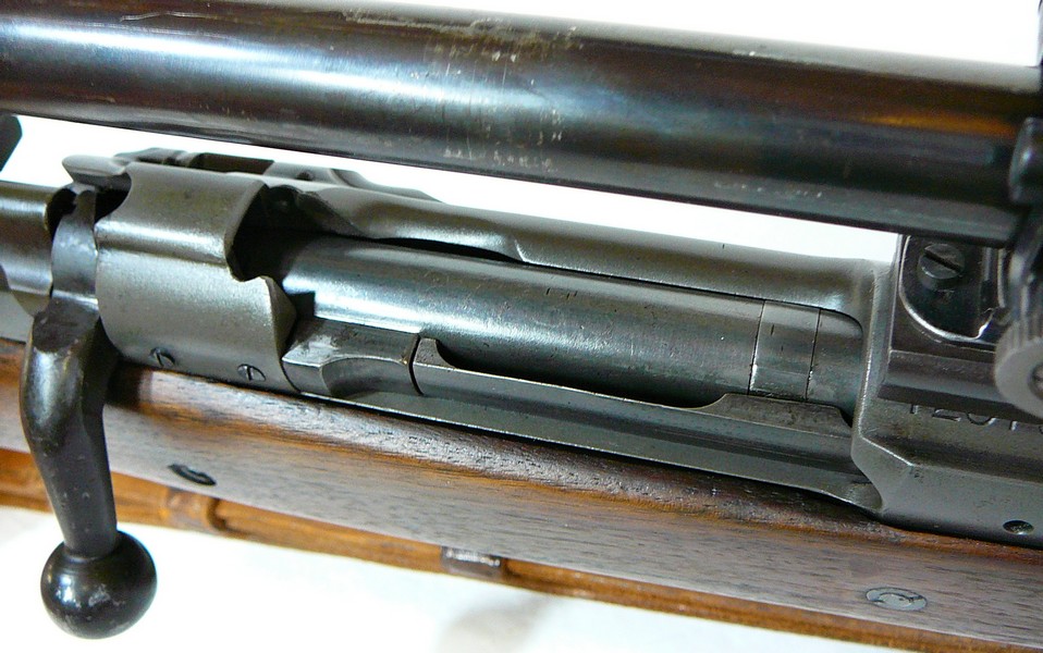

The serial is 1257998. Serial on the bolt is faint, but is 1277332. Barrel is a 5/38 and has the same vise pattern as you see on the Unertl Special Target rifles. The Marines drilled the Hatcher hole, and put in a 2nd gas relief hole in the bolt. The bolt is a straight handle J5.
If you do have one of these rifles please contact me. I don't think a lot of research has been done on the WWII Mann Nienders yet. The Unertls have always overshadowed this rifle, and everyone always thinks of these rifles as only a WWI rifle.
But the WWII Mann's have a very interesting history. For sure 11 of these were used on the Canal and probably more that were not recorded. One was pictured in use on Bougainville. The 5th Marine Division received 20 in 1944 and the 5th Division participated in action on Iwo Jima.
These probably saw a lot more action than ever has been recorded as the entire war the Marines kept on confusing this rifle with the 8X Unertl Sniper. Everyone had a tendency in the Marines to just call them both the 1903 Sniper in logs and official reports. Which caused mass confusion for the HDQ Marine Corps.
These were also the main training rifles for the Marines that went to sniper school in 1943 and 1944.
Again if you have one of these please contact me, there has to be more of these out there.

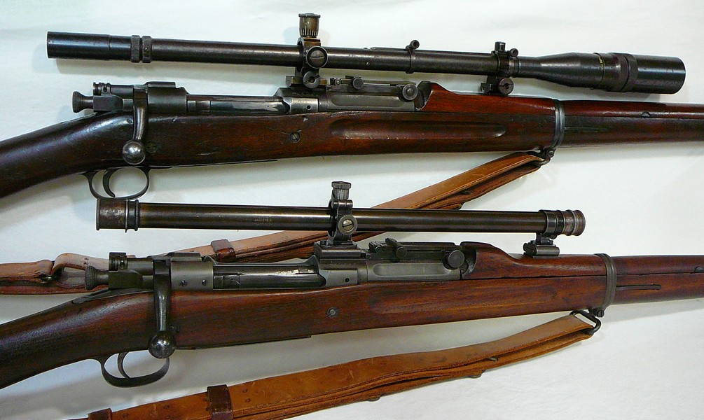

But here is a side by side comparison bwt a real Unertl Sniper and the A5. I could see how they confused so many back then and even today.
I think the A5 is also the reason that there are claims that regular rifles were used in the building of Unertl Snipers. Of the 3 A5's known so far they were also at one time team rifles as well. But they look like the normal complete Marine rebuilds. Unlike the Unertls which still retained the original SA finishes and the NM features.
I think the sightings of these A5's have lead to the story of the Marines building Unertl snipers on regular rifles.
It's pretty clear in the docs over and over, all Unertl Snipers were NM rifles. But even the Mariens called the A5 a standard rifle.

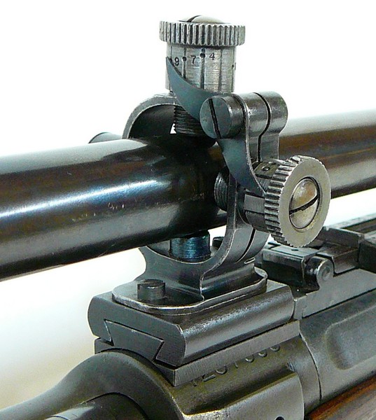

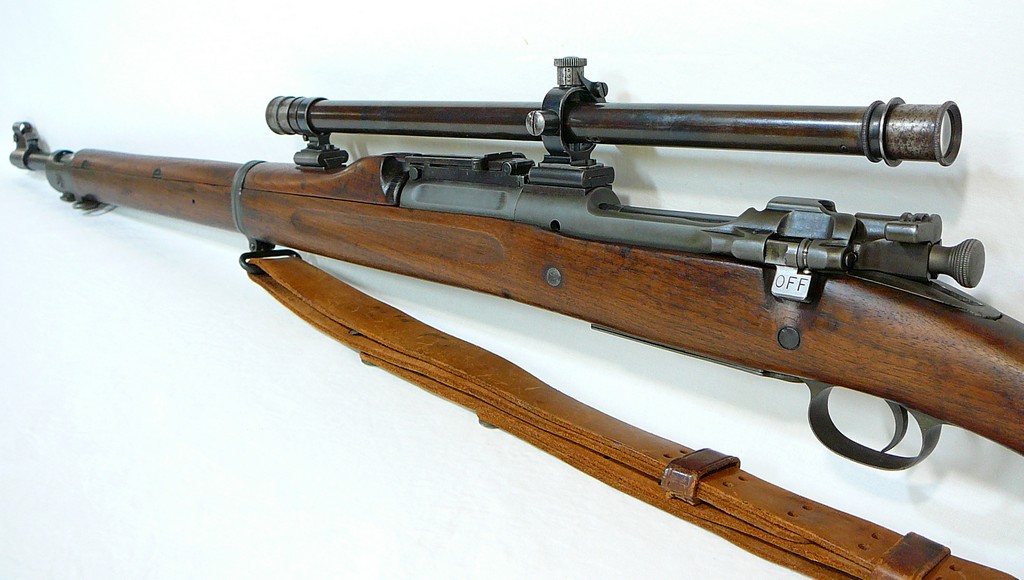

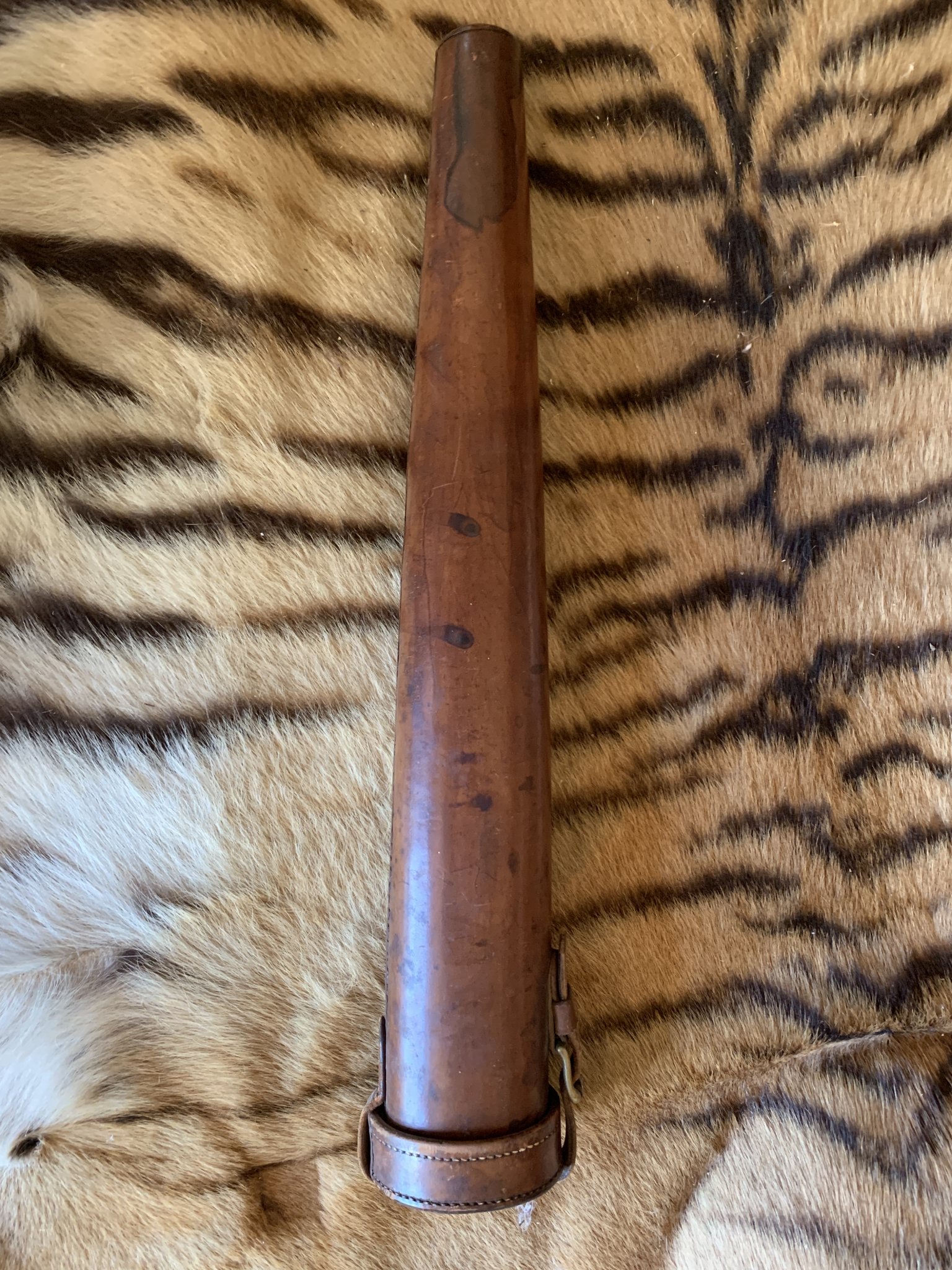

I will post up some photos tonight. I am not sure but I was told that was the original purpose. The scope case is too small for the USMC Unertl.
Interesting...
How can you tell?
If it was real, it would literally be a one off. Nothing on it matches up to a real USMC Sniper. The thing is when you get these sniper rifles together, you see very distinct patterns. The Marines are very much a creature of habit and you can tell it in their work. LIke for example I have detailed pics of about 30 Unertl sniper rifles, which this one is half way trying to clone, and they are almost all identical.
There are little tweeks that the Marines did that are dead giveaways, plus serial ranges and barrel dates. It's getting really hard to clone a Marine sniper rifle and have it pass.
The distinct advantage we have now is, we have thousands of pages of unpublished team and sniper records from this era that deal in nothing but these specific rifles. So they give a lot of clues what to look for. For example many of these weren't released till 2012 at the Archives and Senich's scout sniper book which had been previous the gold standard on these rifles was written on about 70 pages of sniper docs, we have thousands. That is just how much more info we have now, that we have only had access to for a few years.
This rifle doesn't show any traits of being USMC except for one. But that trait is VERY poorly done. Otherwise I think someone faked the one and only trait that even remotely ties it to the USMC. :(
My thoughts of this rifle, it was someone's scoped match rifle back in the day, most likely mounted by a civilian gunsmith. Someone found it and faked the one USMC trait on it to what we say is correct, and that is where is stands now.
I do think the scope blocks were mounted back in the day, I just don't think they were put on there by the Marines.
