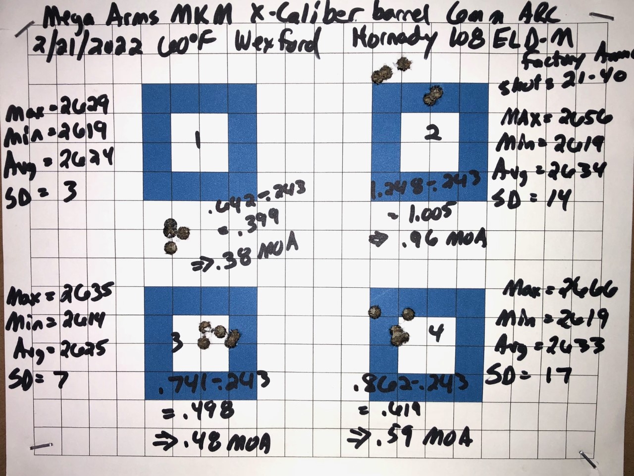

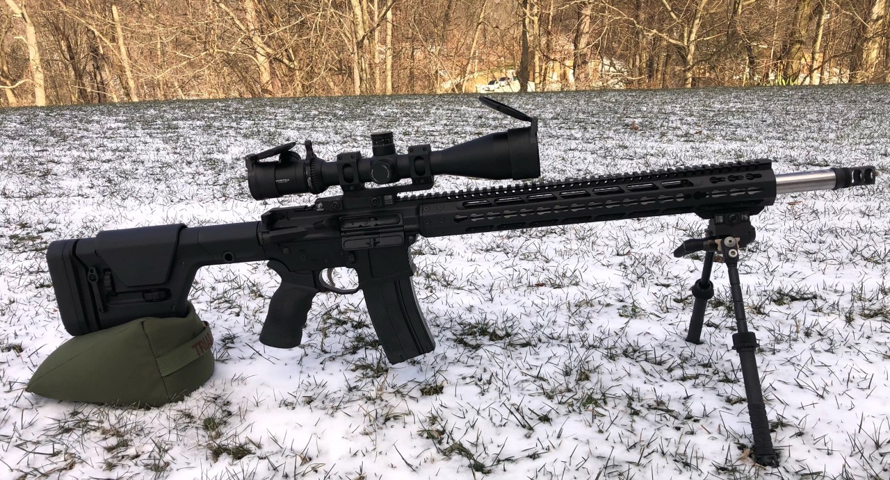

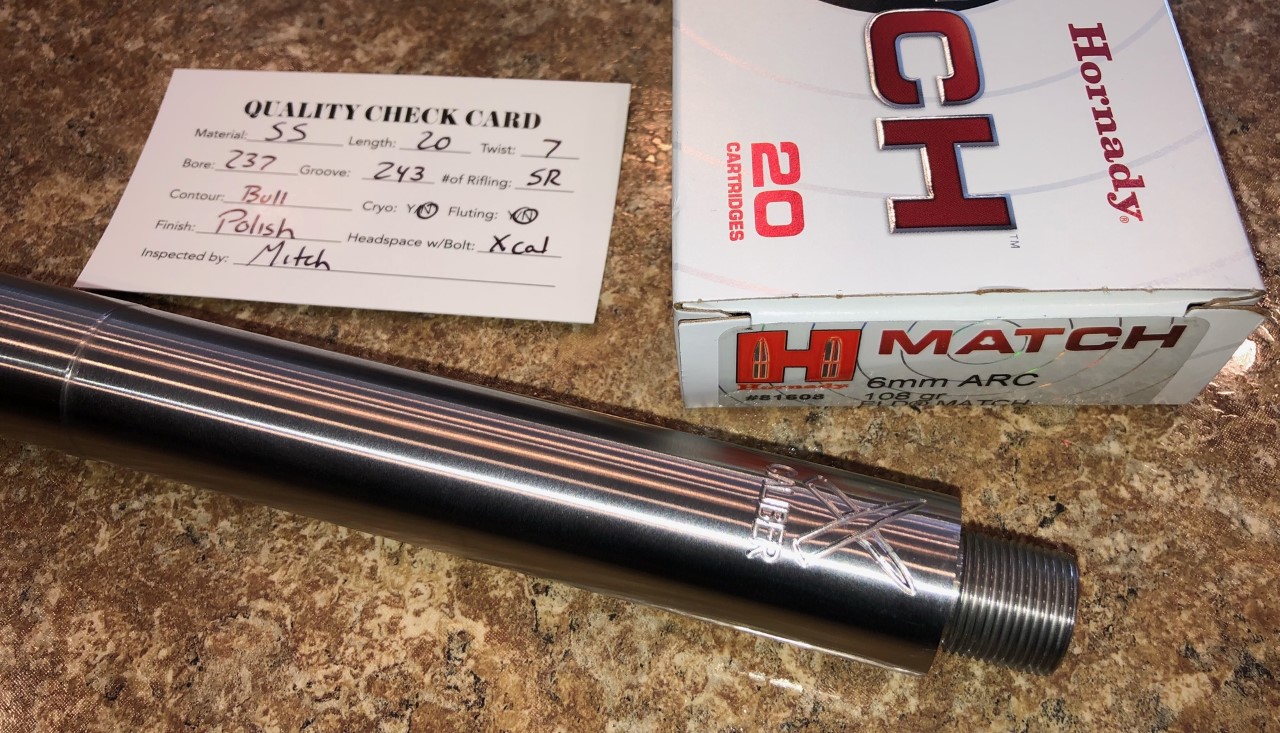

Last year I built a 6mm ARC AR and used X Caliber for the barrel. It has been a really good barrel and I wouldn't hesitate to order another one. Attached is a pic of some groups during initial shooting and scope zeroing.
Reactions: Devildog6.5G

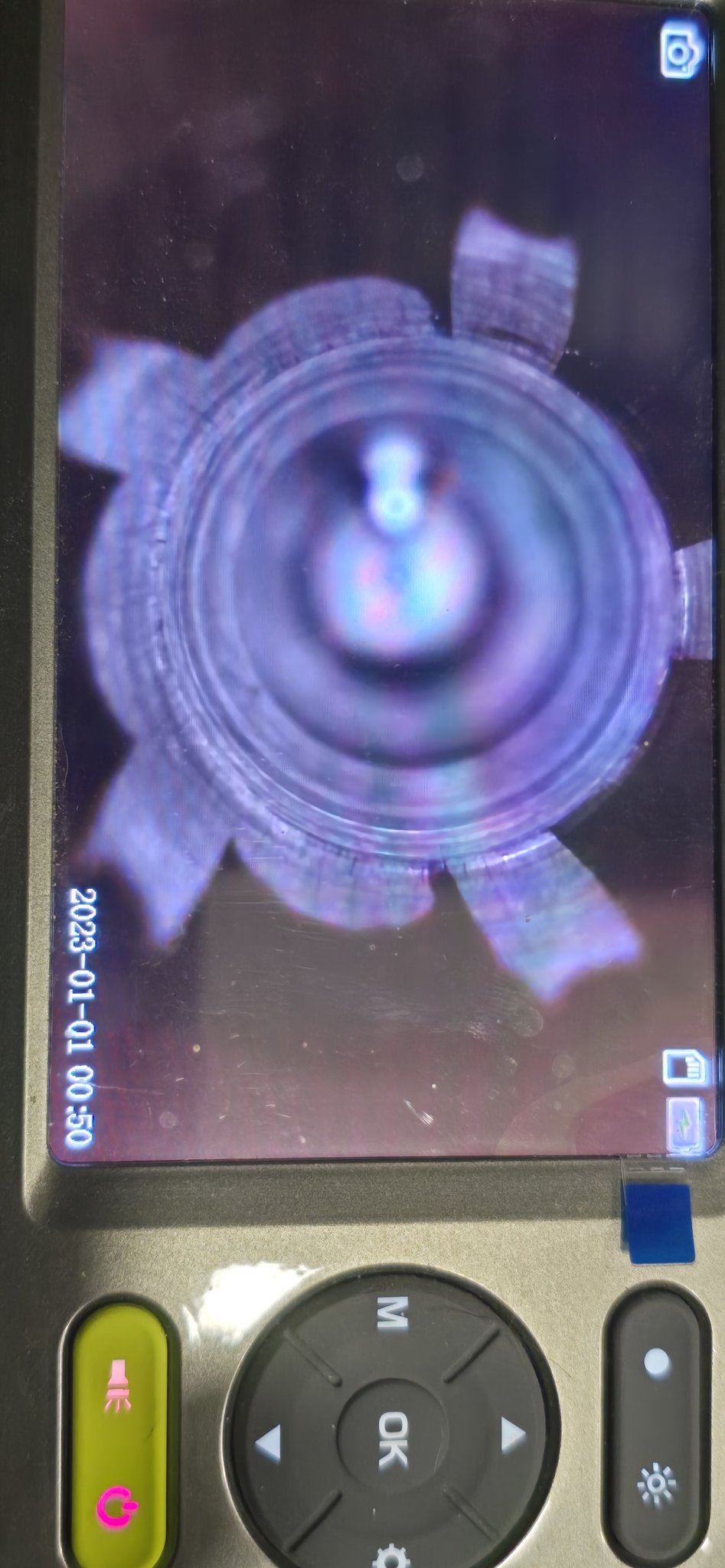

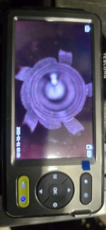

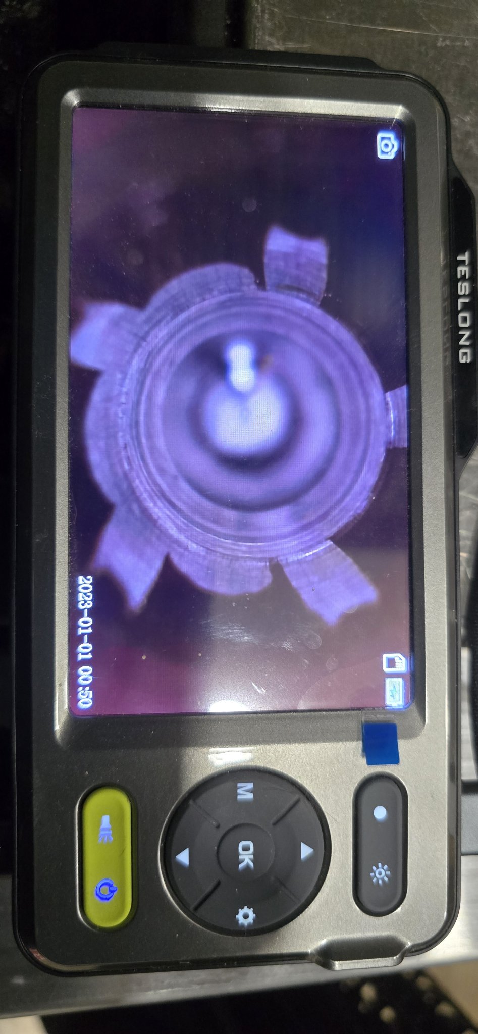

A few months ago I finished my X-Caliber 22" ARC DMR profile. Just finished the brake in process. I must say I am totally impressed. I only use X-Caliber and Shaw. I had my first send back with this ARC and I was a bit nervous. Couldn't chamber a factory round. Called customer service, sent it back and they found a bur. Sent it back reassembled and Damn!! Between the customer service and the barrel I will only be using X-Caliber! I haven't even developed a load yet. Just run of the mill mid charge of Lever and 100gr Hornaday to season barrel.

Yes! For sure. They were genuinely concerned when I started giving them measurements of the factory and the measurements of dummy rounds I made to try and figure out what was going on and why it wouldn't chamber. My dummy rounds were deeper than book. Was on speaker phone and guy chimes in and says send it in, we will reimburse shipping. They got right back to me saying there was a bir in chamber. I had nothing short of a great experience with them. I was pleased at how they handled it. They also expedited the fix due to the nature of the problem. 2 weeks total from me sending and them back to me.
