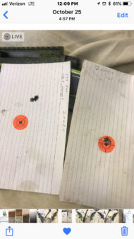

Sorry didn’t realize what wrote did get in my post these 2 groups are from 2 different 308 win don’t think I have had any shoot more than 1/2 moa all i know is they shoot better than i can

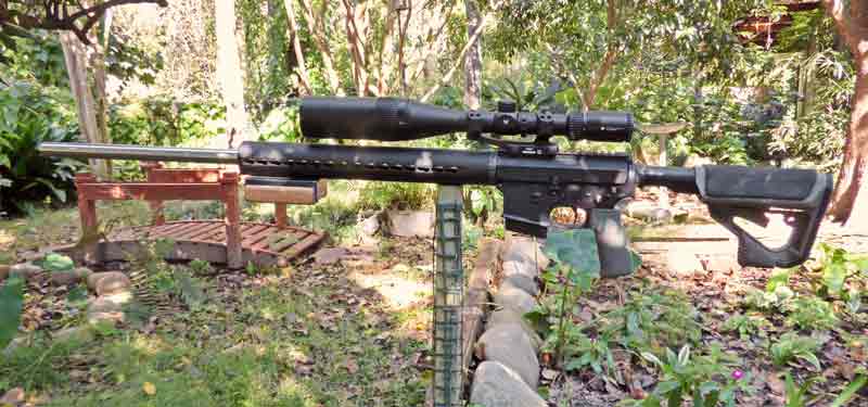

I am breaking in an AR-15 barrel from X-caliber and so far it's shooting pretty good.
Got it on one of their sales. A bull profile 28" +2 gas shoulder 1:7 5R but requested NO gas port/no dimple (Straight pull side charger).
Took it to a 600yd meet (I'm new at this) and got 10 X's out of 60 , wind gave me 5 8's (not my fault :) ).
22 Nosler, 88ELD's, IMR4350, 2880fps.
So far I am very happy with it.

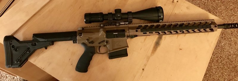

I have 2 barrels in AR10 platform from them, 6.5 Creed and .243 Win. Both shoot very well for what I do and the distances I shoot. I will but again from them when needed.
