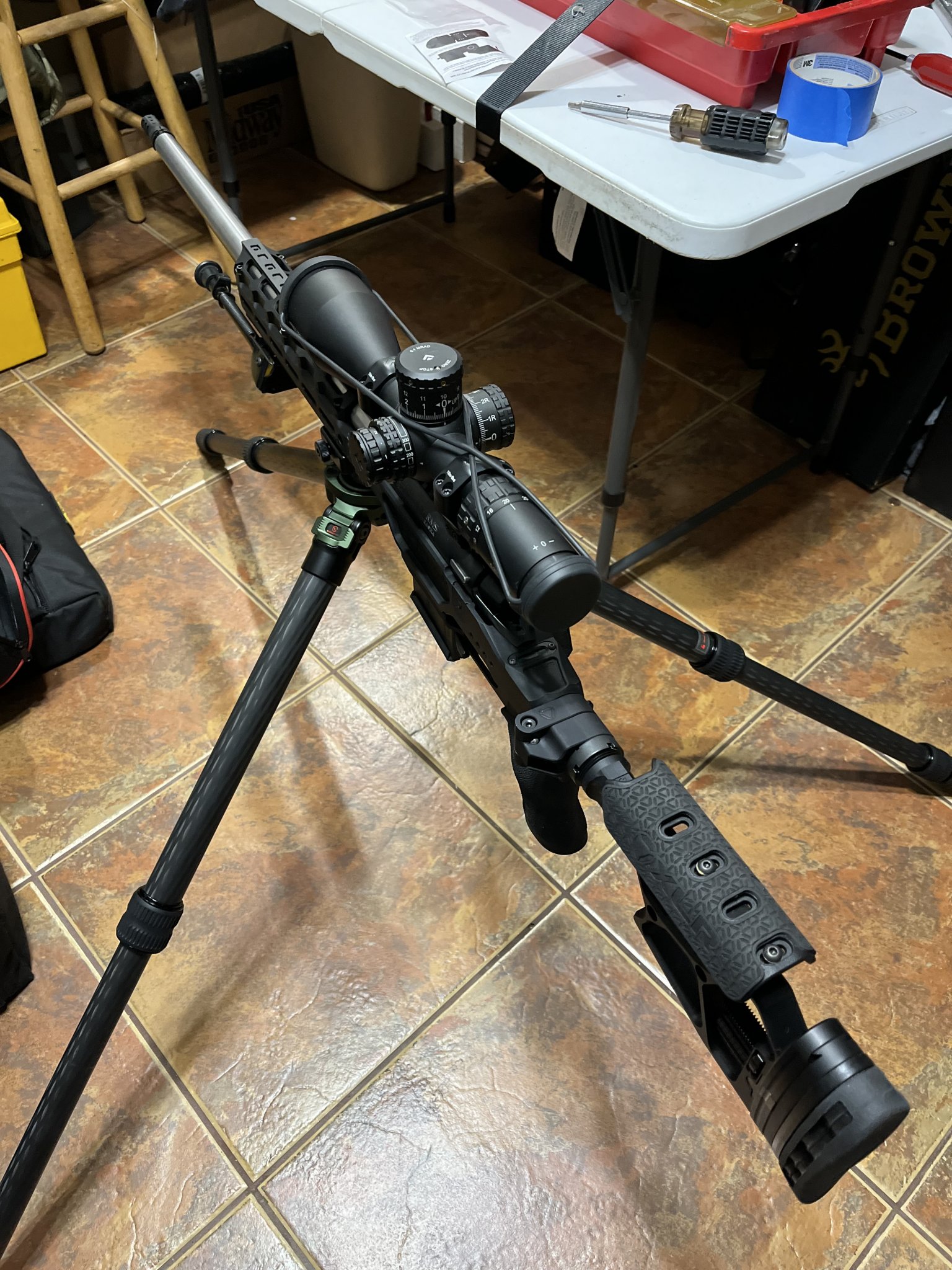

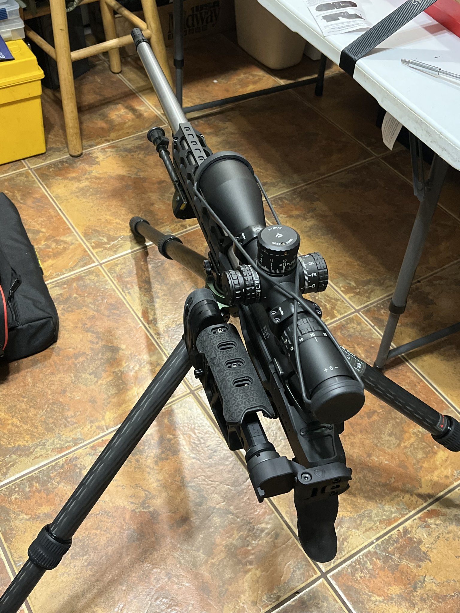

Finally found one and installed. Pretty freaking nice. Locked in you don’t even know it’s there. And will fit into a 40” soft case now 👍

The cheek piece is easily removed along with the butt stock and they do need to be removed as in my case before installing the folding adapter, the handle of my cleaning rod would not clear the cheek piece. My only concern was losing the adjusting wheel which will swing freely once the cheek piece/butt stock is removed and seems to be held by a very small ball bearing for the detents. I avoided this happening by wrapping the the wheel once with masking tape to hold it while cleaning. Absolutely doable without the folder but considering the solid lock up of the adapter I felt being able to fold the stock out of the way was convenient and worth the cost.

Solid lock up on the adapter I received. Others have commented earlier versions weren’t great but I can’t imagine what more I should expect as this unit has zero play when extended. And as per the instructions I was able to tune the lock up and the swing tension when folding/extending. There is no lock mechanism when folded as mentioned which would have been nice yet this adapter stays put when folded for cleaning so no issues there. I thought $150 was a bit high but I was more concerned with the lock up when extended and the butt stock feels as solid as before I installed the adapter. I have no experience with earlier versions and this is my first chassis and am very pleased with what I received.
