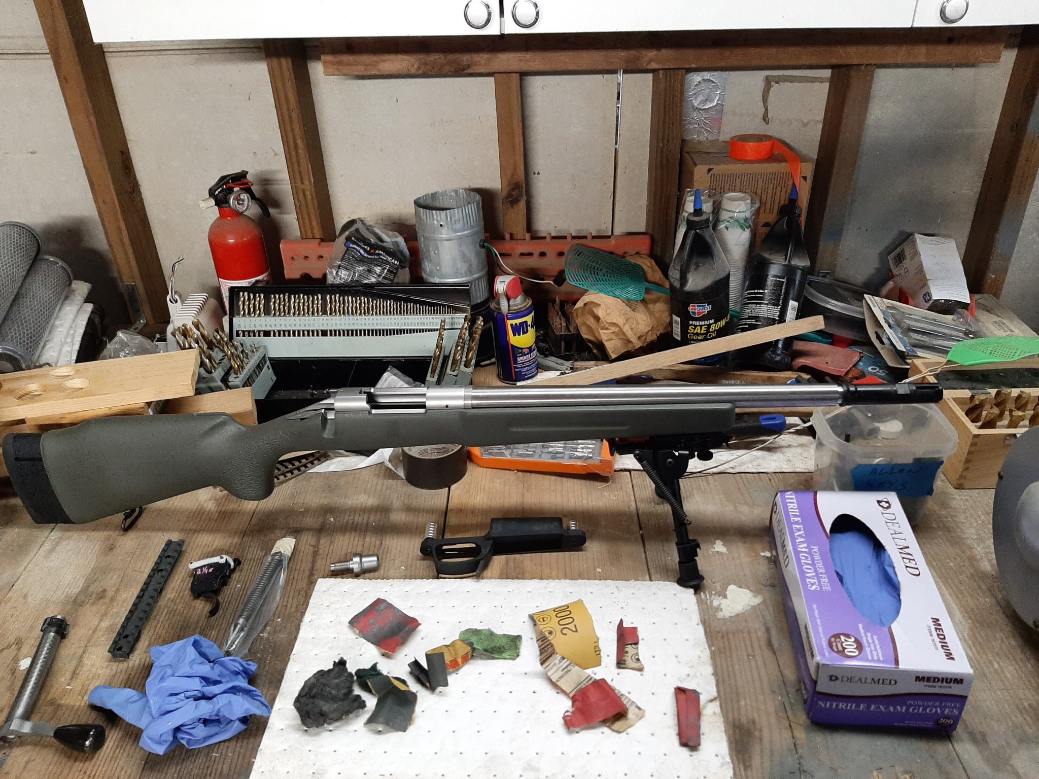

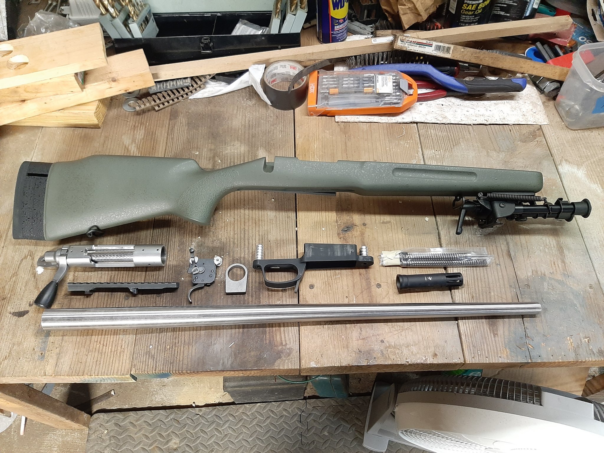

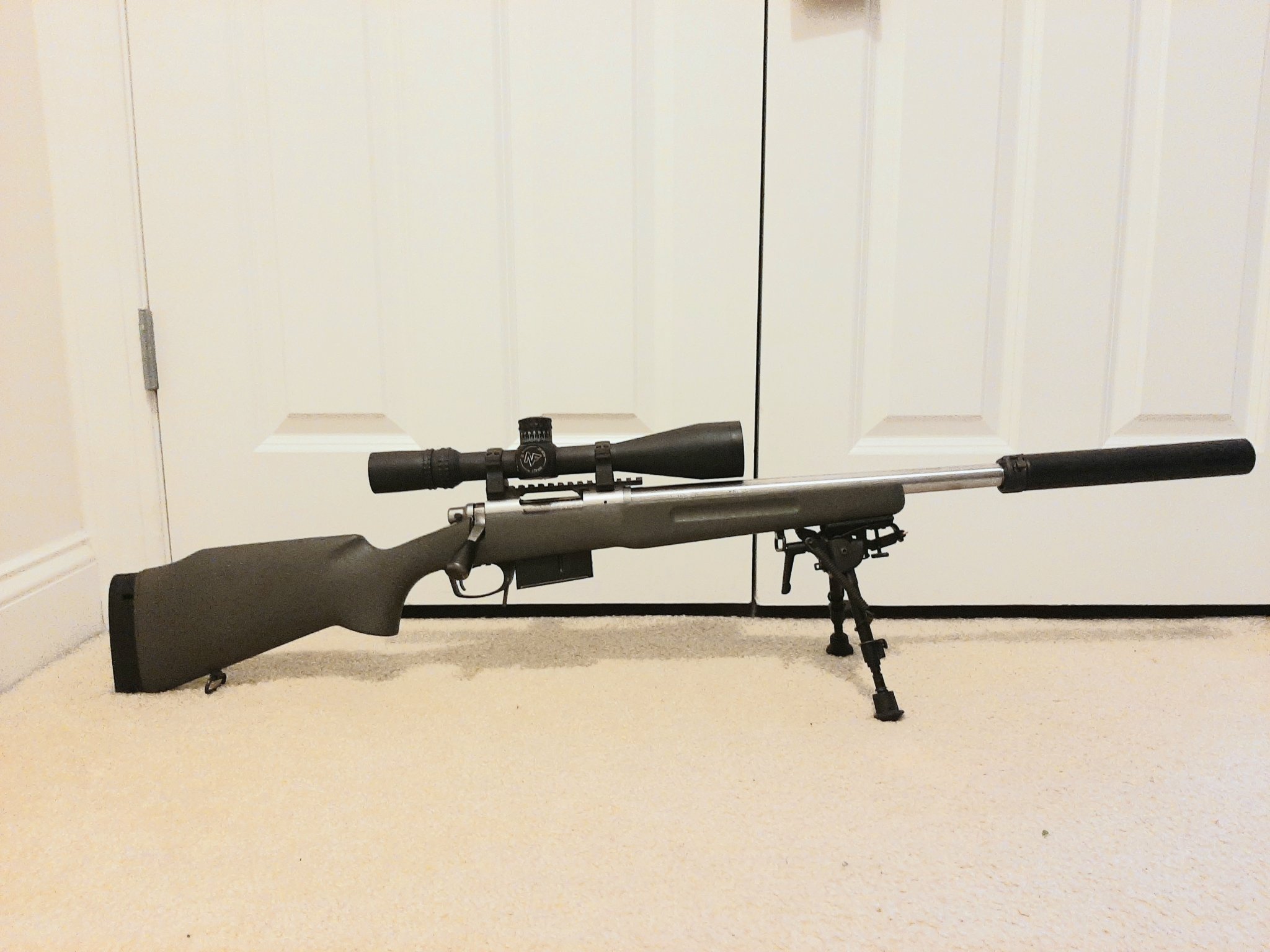

    Was looking for another USMC rifle i could use my Fa762ss on and the Xm-3 popped up. Seems to be the stepchild of the USMC rifles and wanted to have the oddball in my collection so off we went!
    Picked up a nice stainless action from a hunting forum for a steal that already hsd the bolt knob conversion. Sent her off to LRI to have the double radius ejection port and clip slot done (excellent as always) and off we went. Used some badger parts in place of the titanium pieces that are a 1:1 match minus material. Also built it after one of DARPA's test rifles that used a Badger M5 dmm instead of the M4. I use all my builds in competitions so i was pumped to keep it "spec" and get the dbm.
    Stainless r700sa opened up to 1.070
    Hart XM-3 profile in 10 twist 308
    Badger .315 stainless lug
    Badger 306ux lugged base
    Tuned walker trigger (2lb break)
    Mcmillan A1-3 w/witchta swivels (had them move the front swivel back 2" to clear bipod. Oversight on DARPA)
    Badger m5
    Nightforce steel rings (steel was test rifle spec, ultralite was final issued)
    Nightforce nxs 3.5-15x50 moa (went ffp, same look, better function)
    Surefire CA762SSAL/RE flash hider
    Surefire fa762ss suppressor
    Harris 6-9 brm-s
    Turner aws sling olive (not pictured)
    Holland oversized firing pin/spring I added to keep cratering to a minimum. I plan to sling 200 class bullets in open class and wanted to make sure it could handle the abuse better.
    All work minus the lug slot/ejection I do myself...part of the fun. Still needs paint (hardener dried up on me and i didn't catch it until i went to go paint). Also need the unobtanium UNS mount. Had a contact here on the hide who flaked out so i have a guy who will machine one for me or PVA expressed interest in making a run if I got enough interest. I made some dwgs off a legit sample so ill be sending Josh the print and see what we can do. If you are interested in one let me know.

    18.5" (overall, not the M40 series version) for the lords caliber to reach ford pinto speeds. I'll put you on the list also then! If its too few for PVA (which I suspect it will be) I may see if the local machinist here is willing to do a few other than mine. I'm capable, just dont have the machine accessible unfortunately.
    And do it...just the way it handles in dry fire I can tell its going to be a favorite for sure. I'm going to run it at the Guardian match in April and see how she handles in actual practice.

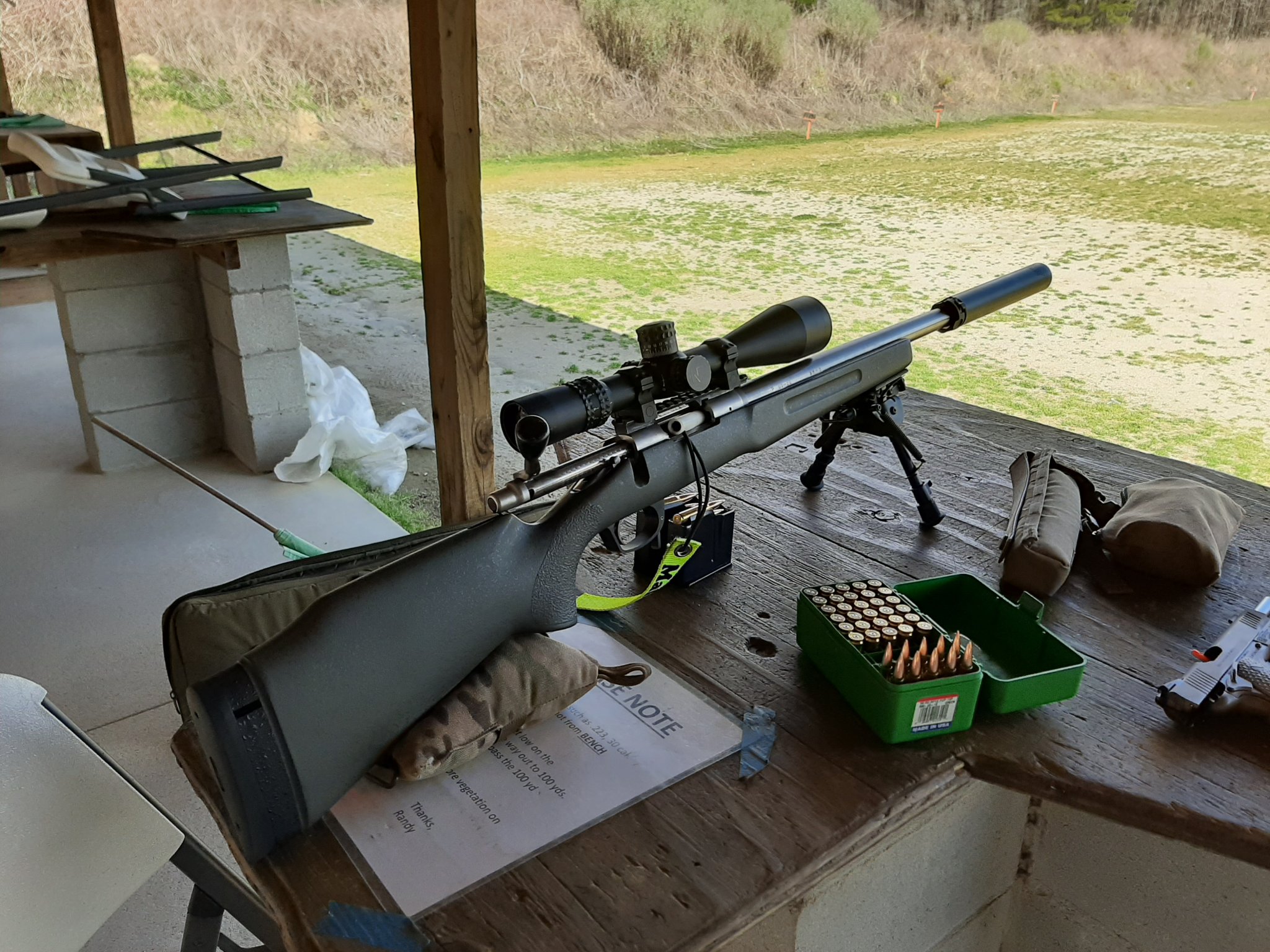

    Took the ole girl out for her maiden voyage. Took some of my M40a5 loads (44.1gr IMR 4064, 175 RDF .060" off lands, win brass) to "break in" the barrel before I get into load development. Extremely pleased with the results considering this is not a load tuned for this gun and rounds 2-60. Groups are a mix of suppressed and unsuppressed
    Gotta say, recoil is a bitch without the suppressor, like feel my organs shifting. Granted this is shooting from a bench (quite the fudd range). Betting 99.8% this will be shot suppressed only.

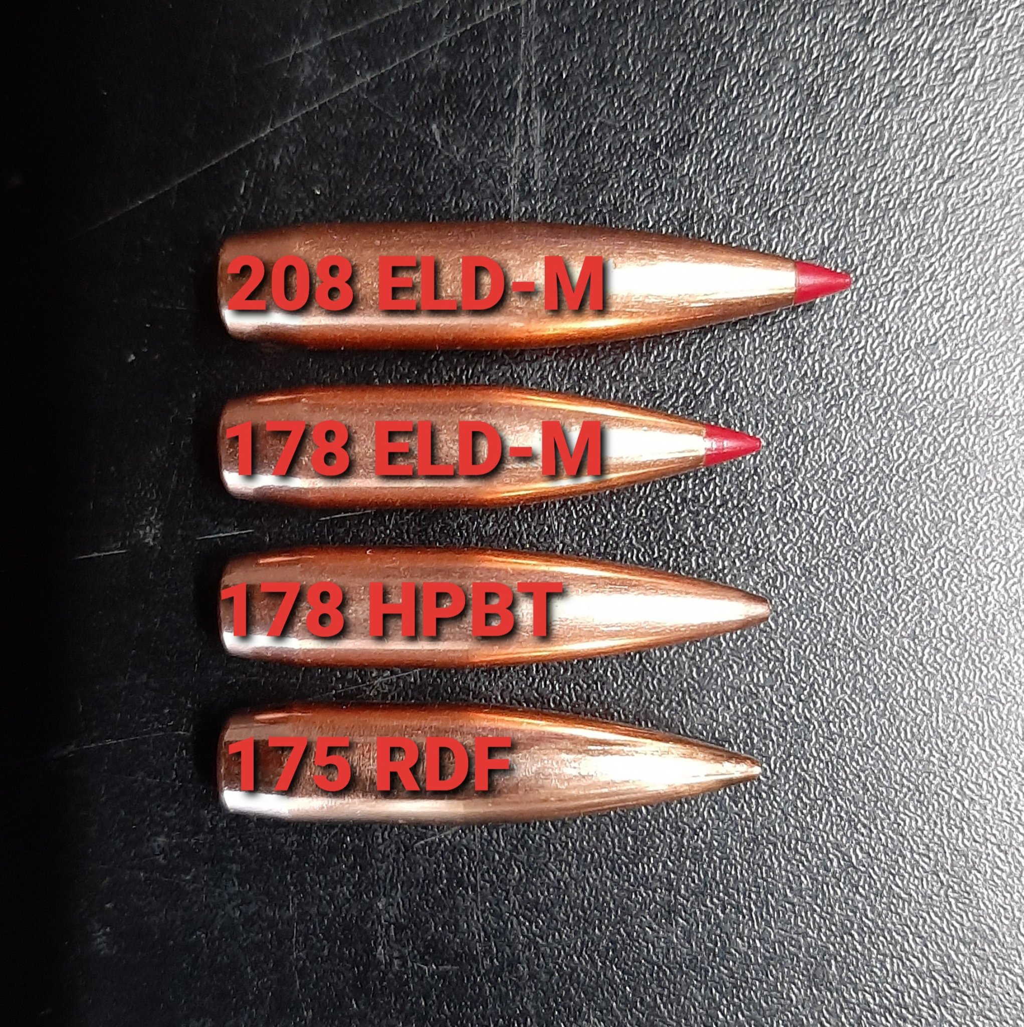

    Going to work up a load and test these 4 bullets. I have quite a plethora of RDFs but would ideally like to work loads up for the 208ELDM and one of the tac legal bullets.
    EDIT: I have a stock pack coming from Triad thats probably the best match to the Eagle I can find until I get a legit one. I could use close to an inch to get a proper cheek weld.

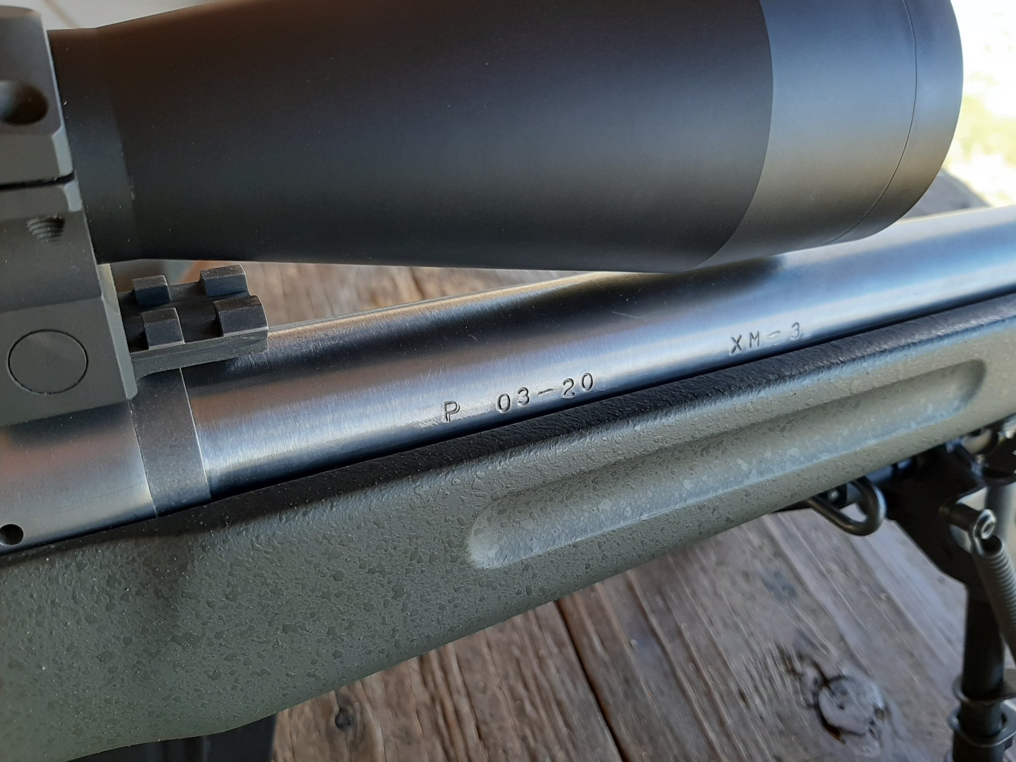

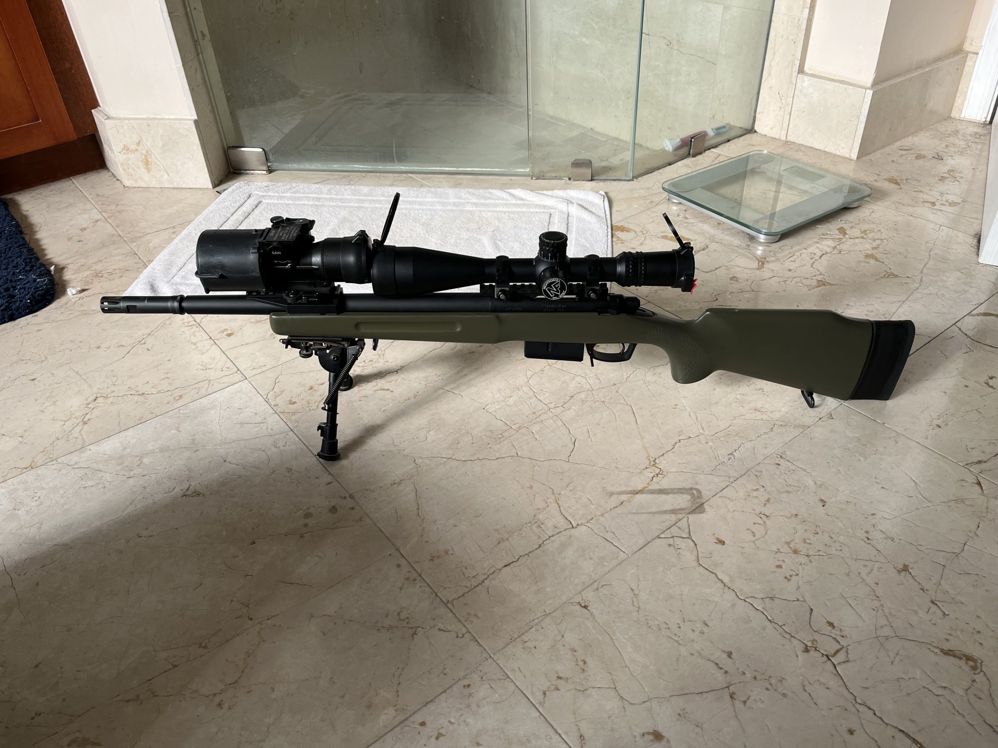

    I wanted to give a little love to the XM-3 with my version with the badger M5 bottom metal or the version that never made is to market but in the eyes of many, was the version that should have been. Parts are to spec, Hart, IBA-mount, CMP-EFR, SF flash hider, PVS-22, stainless S## Rem action, Mil Spec NF, the FA762SS is owned - not pictured. I also have the sling, cheek pad and most of the parts kit.
    Only item that isn’t is the trigger is not a Walker by personal preference. Could be easily installed though any day.
    Currently having a second one being built with the original bottom metal and another with a modernized version with the newer McMillan A1-3 stock and chambered in 6.5cm so I can still use the SF can on it.
    Currently having a second one built with the original bottom metal and a modernized version with the newer McMillan A1-3 stock and chambered in 6.5cm so I can still use the SF can on it.
