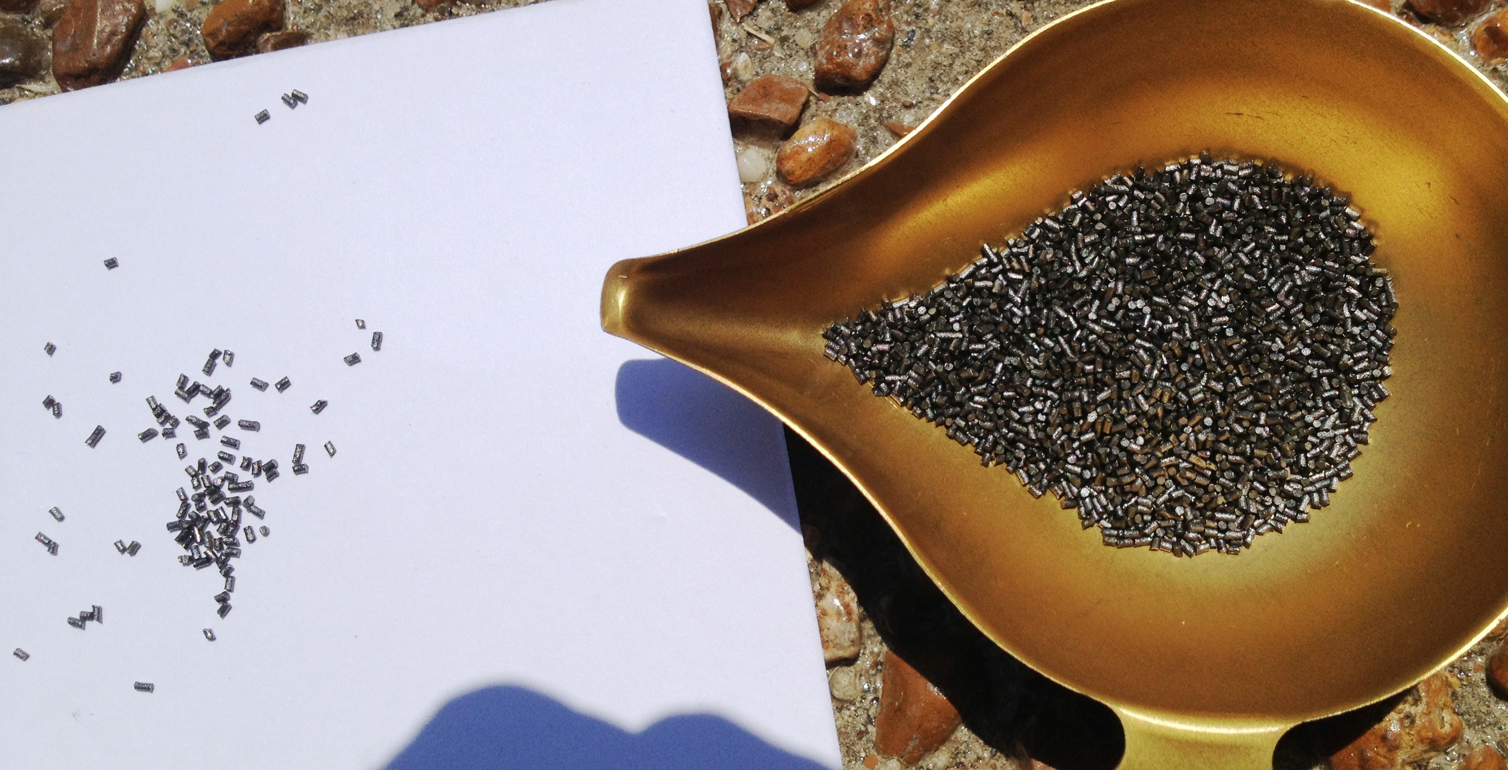

FYI I have a bunch of M118LR "12" so out of curiosity I pulled one this morning. My sample has 44.0g of the mystery powder.
That looks exactly like RL15 are you sure it's not 43 grains? Perhaps they upped it because of a slower lot of powder.
I also thought it looked like R15 too, but as Darkker noted above may not be exact R15 powder formulation.
This particular sample of 1 was 44.0 grains, but again that doesn't tell us much from a 'statistical probability stand-point', this was just my curiosity pulling one...

Edit 28 July - I came up with 43.9 on my RCBS balance beam on another '12' round I pulled down tonight. Usual cautions apply - you should definitely start lower and work up on your rifle, your mileage may vary, only you can prevent forest fires etc...
