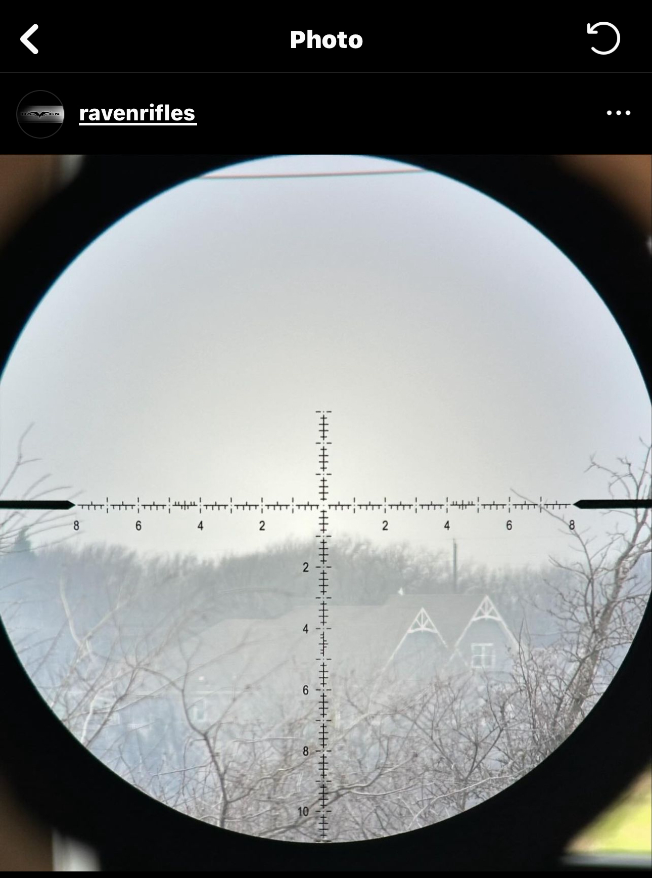

Also mpct 3. Is best reticle. Circles and ranging uterus
Glass is much better on zco versus NF
I prefer the MPCT3x reticle. It doesn’t have the “shooterus uterus” above the crosshairs. Better FOV for hunting, IMO. 👍🏼
For anyone else wondering lol
