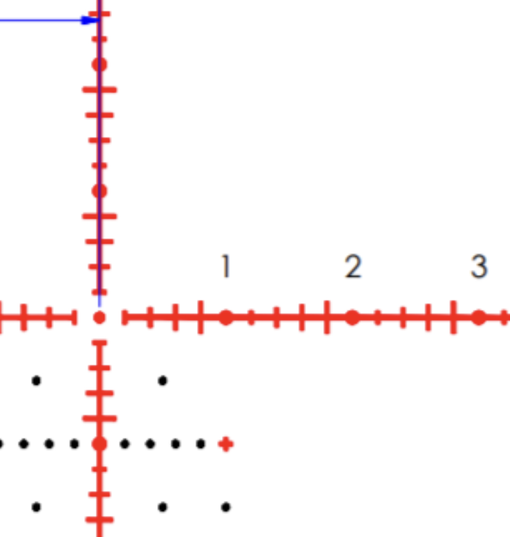

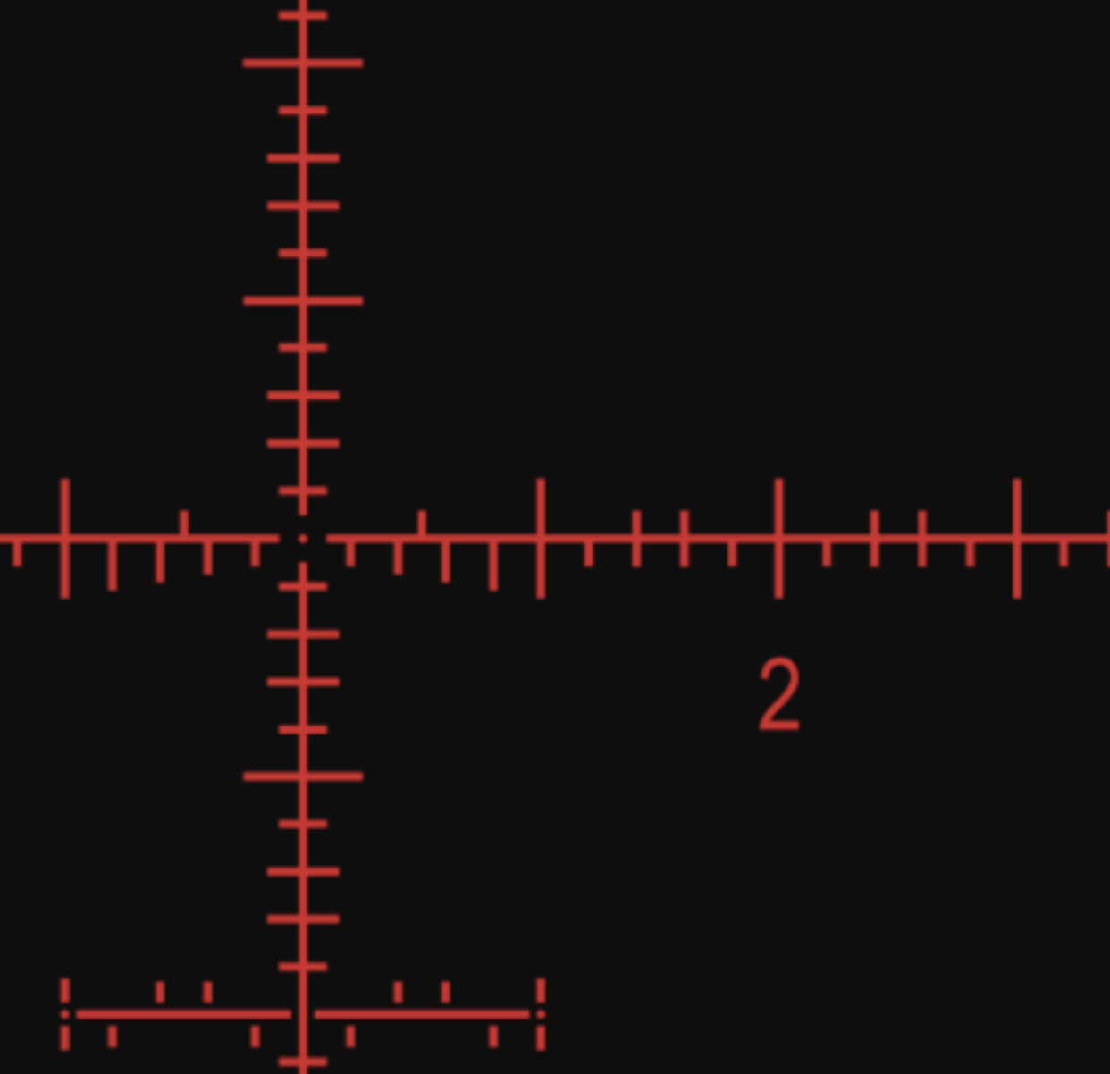

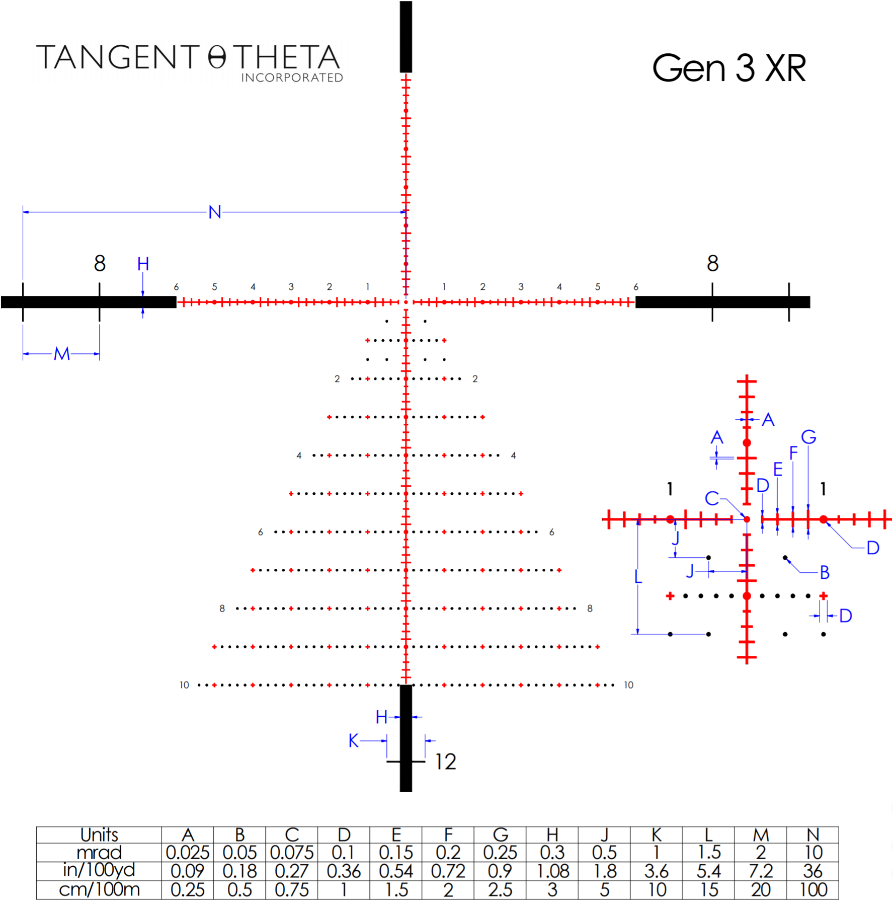

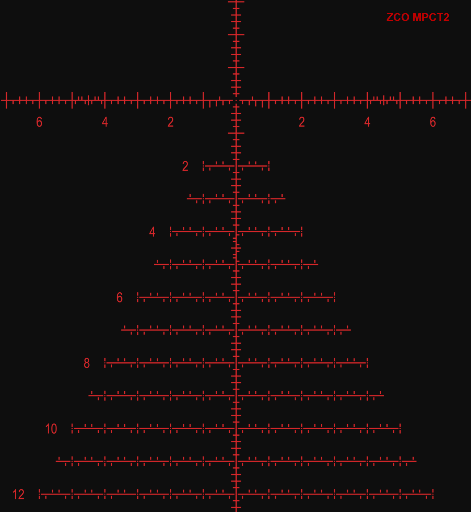

    Thanks for the long term review Dt, can you elaborate a little more on the differences that you see between the reticles, specifically how does the MPCT2 work "exponentially better" for you? I am not a competition shooter but I'm always looking for ways to quicken my response time between transitioning from target to target.
    It’s all subjective. But here is a picture of the windage on both.
    The way the first mil has a .5 mark helps me find all the values very fast.
    The other mil marks are .2 small, .4 and .6 is large, then .8 is small again. With all whole mils being the large hash.
    With the gen3xr, the way the hashes just get larger and then a dot on the full mil, I have to manually count marks and I also mistake the .8 for whole mil because I’m used to the full mil being a large hash on most reticles.
    The most obvious is when shooting a mover. It’s usually anywhere from 1.2 - 1.8 and anywhere in between. I’m much, much faster on picking up which hold I want to use. On mover stages where say you only get 3 passes, being able to take every shot ASAP is a big deal.

    As someone far less experienced, I looked at those two reticles and wondered how one could possibly work much better than the other. Your answer makes perfect sense. Thanks for dropping some serious knowledge on us!
    To go even further, look at the mpct 2 or skmr reticles. They are similar.
    I know that the first small hash is .2 and the next two large ones are .4 and .6.
    They are very obvious and easy to remember.
    If you need .1 .3 .5 or .7, you just bracket those.
    Personally, this is easier for me than the steadily increasing hash marks as the gen3xr. Some others might not find it the same though and prefer that.

    Dt, I appreciate you taking the time to explain that, now I understand what you are saying and see how that can help. Curious, what you're saying mostly focuses from 0-1 mil in the horizontal, but from 1-4 mil they have the two tick marks at the top at .4 and .6 mil but it seems like it would have been better to keep the top tick mark at .5 mil like they do between 0-1, and then they do something very funky between 4-5. I don't know if these have ever been explained adequately but curious your thoughts on how these other hash marks may have helped you in competition.
    The way I understand, they did the 0-1 mil with the .5 because most holds are inside of 1 until out to distance or with movers. I also suspect (no facts to back this up) they also had to change it up a little to keep from being a direct copy of skmr reticles.
    I personally would rather have the 0-1 look exactly the same as the 2 mil and out (like skmr does).
    Between 4 & 5 mil they give you a .1 graduation in order to assist in reticle ranging. Although reticle ranging isn’t used very often anymore, you want a finer graduation so you can get more exact measurements. I will say I kind of like the way the Tremor 3 does the .1mil “Tree” as they call it better than the ZCO, but the ZCO is fully functional as it is, and the rest is way better than the Tremor 3. I have been able to get very precise ranging using the ZCO reticle and .1mil hashes out to about 1,000yards of known and un-known ranges so it wasn’t like I knew the range but checked with the reticle and matched my measurements to my known range.
    Reactions: gebhardt02
    I am opposite, I think I would prefer having 2 mil and out exactly the same as 0-1 so you have the .5mil hash along with the .2mil hashes all the way. But that’s theoretical, in use I might now like it that way. And I am pretty damn happy with it just the way it is.
    This is my thought as well, I prefer the .5 on top and graduated .2 marks below. Obviously we are nitpicking here.
    Yeah, very nitpicking, cause I really do like it the way it is, but if I was gonna TRY a change at all, I think it would be keeping the .5 on top all the way out. However, I don’t know if I would like to have the .2 marks grow in size the way they do all the way cause then you get that kind of sound wave look the Gen 3 XR has, so if I kept the .5 mil all the way out, I would still make the .2 marks go from small at .2, then large at .4 & .6, back to small at .8 and then the full size 1 mil. But no matter what, I wouldn’t change the 0-1 mil at all because the growing lines help draw your eye to the center.
