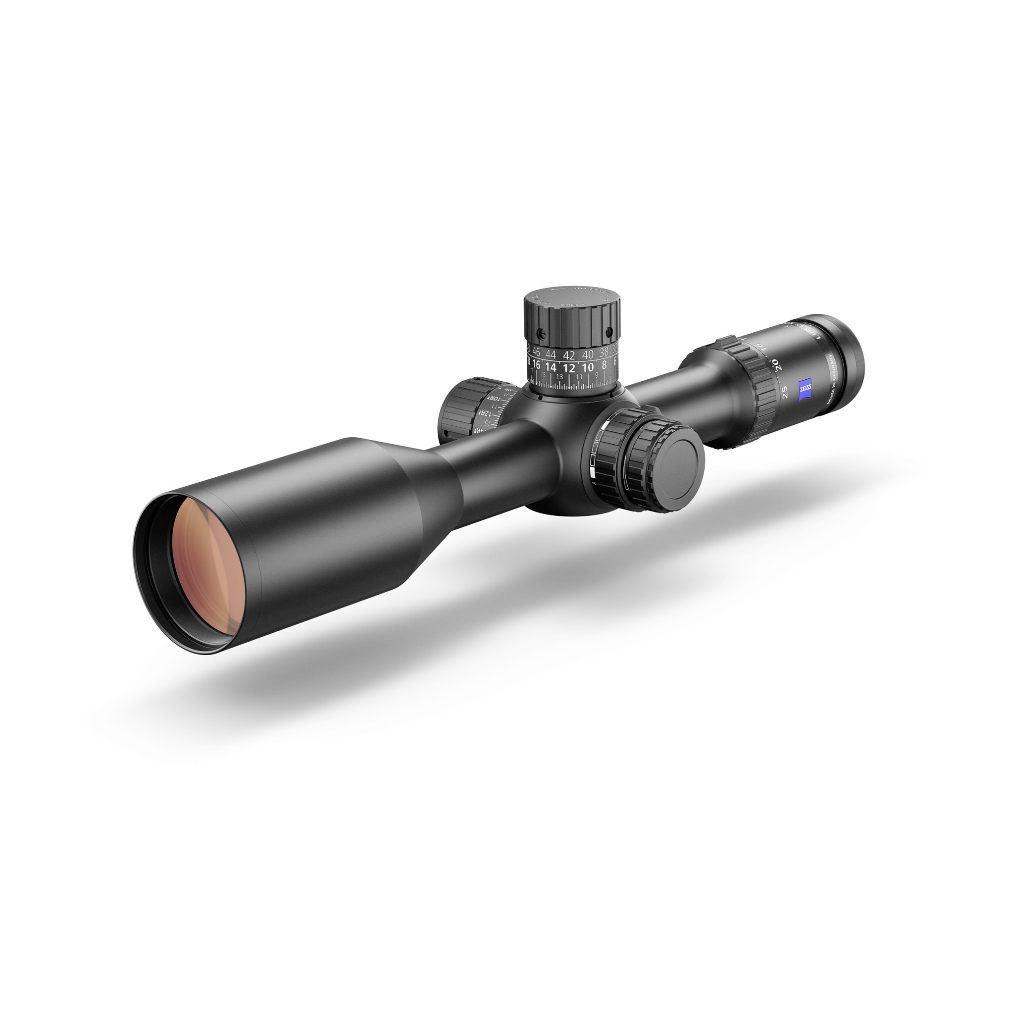

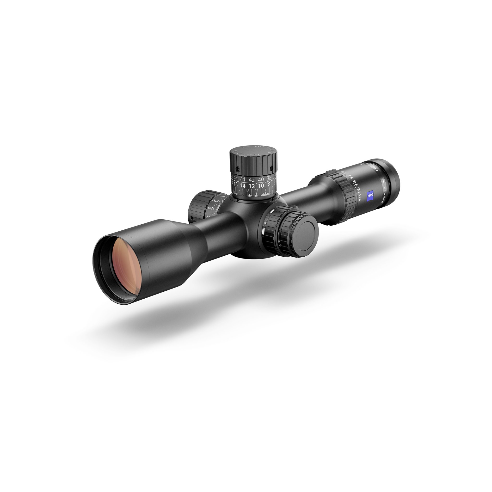

    ZEISS announces the release of the all-new ZEISS LRP S5 first focal plane riflescopes. The new long-range riflescopes from ZEISS include high-performance optics, best-in-class total elevation travel, highly repeatable, precise, and tactile turrets as part of a compact and heavy-duty riflescope – with a daytime visible illuminated reticle. Furthermore, these scopes offer two new first focal plane reticle designs – and are available in either milliradian (MRAD) or minute-of-angle (MOA). The ZEISS LRP S5 is designed, engineered, and manufactured in Germany and is built to withstand up to a massive 1,500 g-force of recoil. The product family consists of two models: 318-50 and 525-56 and is available in four unique configurations – all with 34 mm main tubes.
    “For longer-range shooting, precision is crucial. With our new ZEISS LRP S5 we have decisively expanded our product line to provide an elite riflescope that can dominate at every competition,” states Kyle Brown – Director of Marketing and Product for Carl Zeiss SBE, LLC. “With the compact and heavy-duty design of these riflescopes we have validated and proven that they are ready to tackle the toughest shooting competitions and the most difficult hunts”, emphasized Brown.
    The optical system delivers exceptional image quality and renders the finest of details.
    The premium optical design utilizes ZEISS Fluoride lens elements, SCHOTT glass and ZEISS’s proprietary T-Star lens coatings for optimum color fidelity, image brightness, exceptional resolution and edge-to-edge sharpness within the entire field-of-view. The scopes deliver 90% light transmission to the eye, clearer visuals, faster target identification and validation of the finer details down range. The exterior facing lenses are final coated with ZEISS LotuTec protective lens coating process for anti-fogging and to repel water, dust, dirt, fingerprints and more.
    Tactile and Highly Repeatable Turrets – Precise shot placement, regardless of distance.
    The ZEISS LRP S5 riflescopes offer an external elevation turret with larger font sizes and dual row engraving. The turret also incorporates the mechanically robust ZEISS Ballistic Stop feature, which provides a rock-solid return to zero. In addition, the all-new ZEISS External Locking Windage Turret (ELWT) feature allows the shooter to pull out on the locking collar, make necessary adjustments, and then lock-in the selected setting.
    The MOA-based turrets are adjustable with .25 MOA click values and offer 30 MOA of travel per rotation. Each click is audible and provides a tactile confirmation for every adjustment. The MRAD turret features a more pronounced click at whole MRAD intervals.
    The 3-18x50 and 5-25x56 scopes offer best-in-class - 140 MOA or 40.7 MRAD - total elevation adjustment which enables shooters to engage targets up to 1500 yards - and beyond. When combined with the side parallax adjustment, infinitely variable reticle illumination, and a European-style fast focus eyepiece the ZEISS LRP S5 allows the shooter to precisely engage the most distant targets.

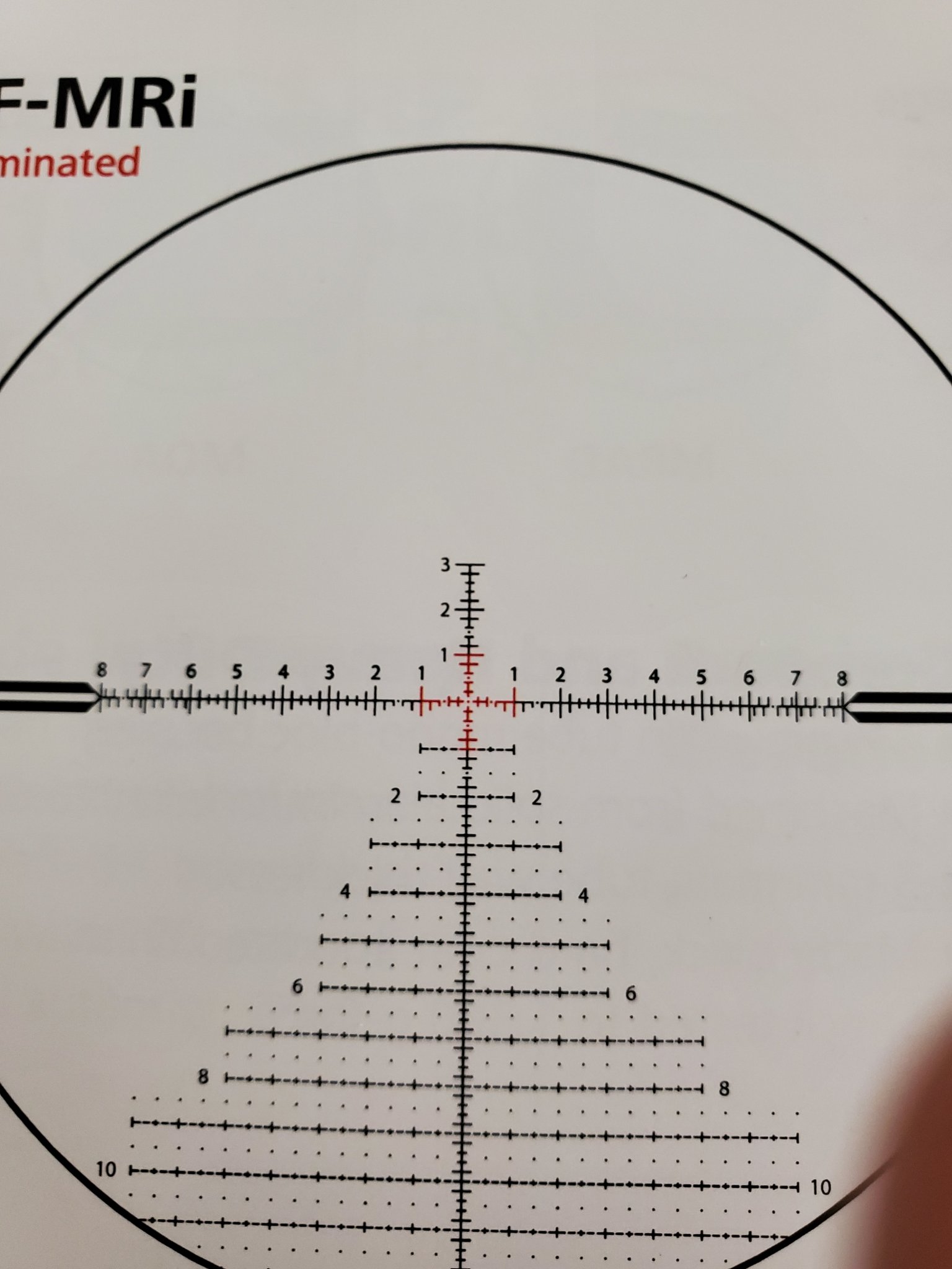

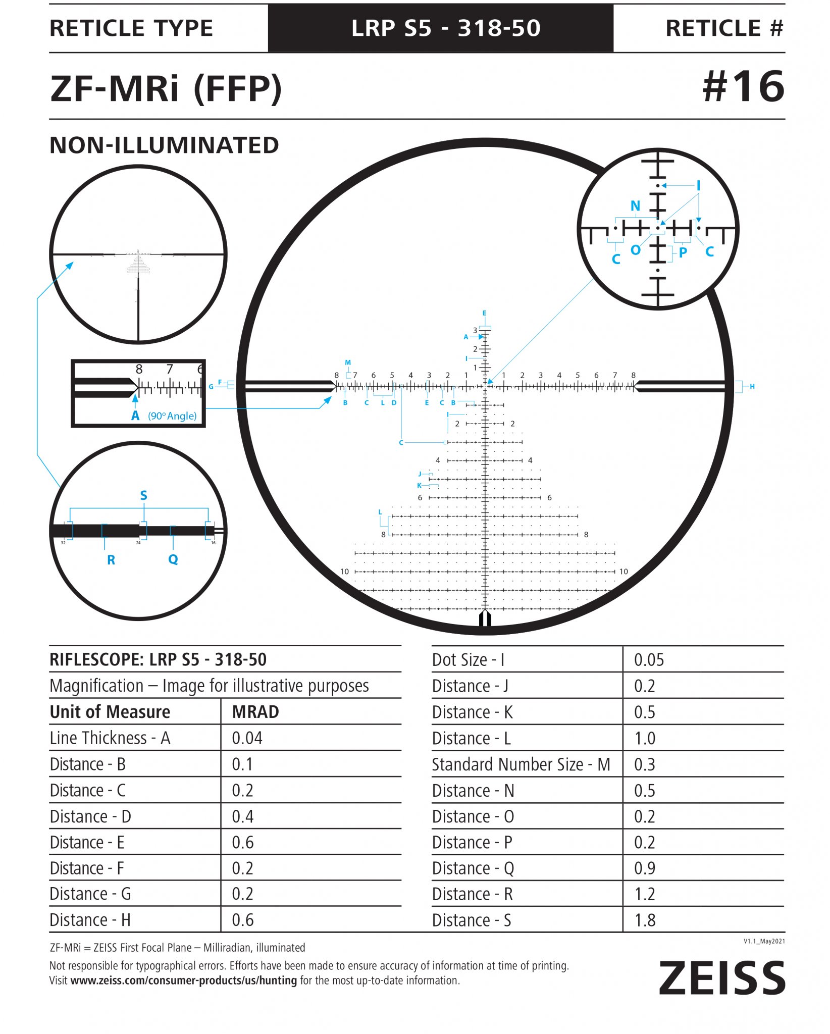

    Two new illuminated reticles ZF-MOAi and ZF-MRi provide intuitive aiming solutions
    ZEISS also introduces two all-new First Focal Plane (FFP) reticles. The ZF-MOAi and the ZF-MRi illuminated reticles represent MOA and MRAD smart reticle designs respectively. Each incorporate distinct, clean, and easy-to-understand reference marks along the main horizontal and vertical lines of the reticle; and they offer relevant windage hold-offs in the field-of-view below centerline. Both offer fine line reticle subtensions and floating center dots to serve the demands of precision shooters and long-range hunters alike.
    Only the center section of each reticle illuminates to provide a finer point of aim while viewed against dirty targets or in harsher lighting conditions. The diffractive reticle illumination technology is digitally controlled, creates an ultra-bright daylight visible point-of-aim, and has an auto-off feature controlled by angle and time sensors. These two new reticles provide very intuitive aiming solutions for improved shooting speeds and for extremely precise shot placement.

    The reticle is better than ZCO. But why they have to start tree at .2 mils? Also would prefer illumination but isn’t required

    I really like that they went with a slightly thicker line for the lower magnification use. Should be perfect.
    Also using thicker lines then the 5-25 on the 3-18 is brilliant one of my pet peeves with most 3-18 ffp.

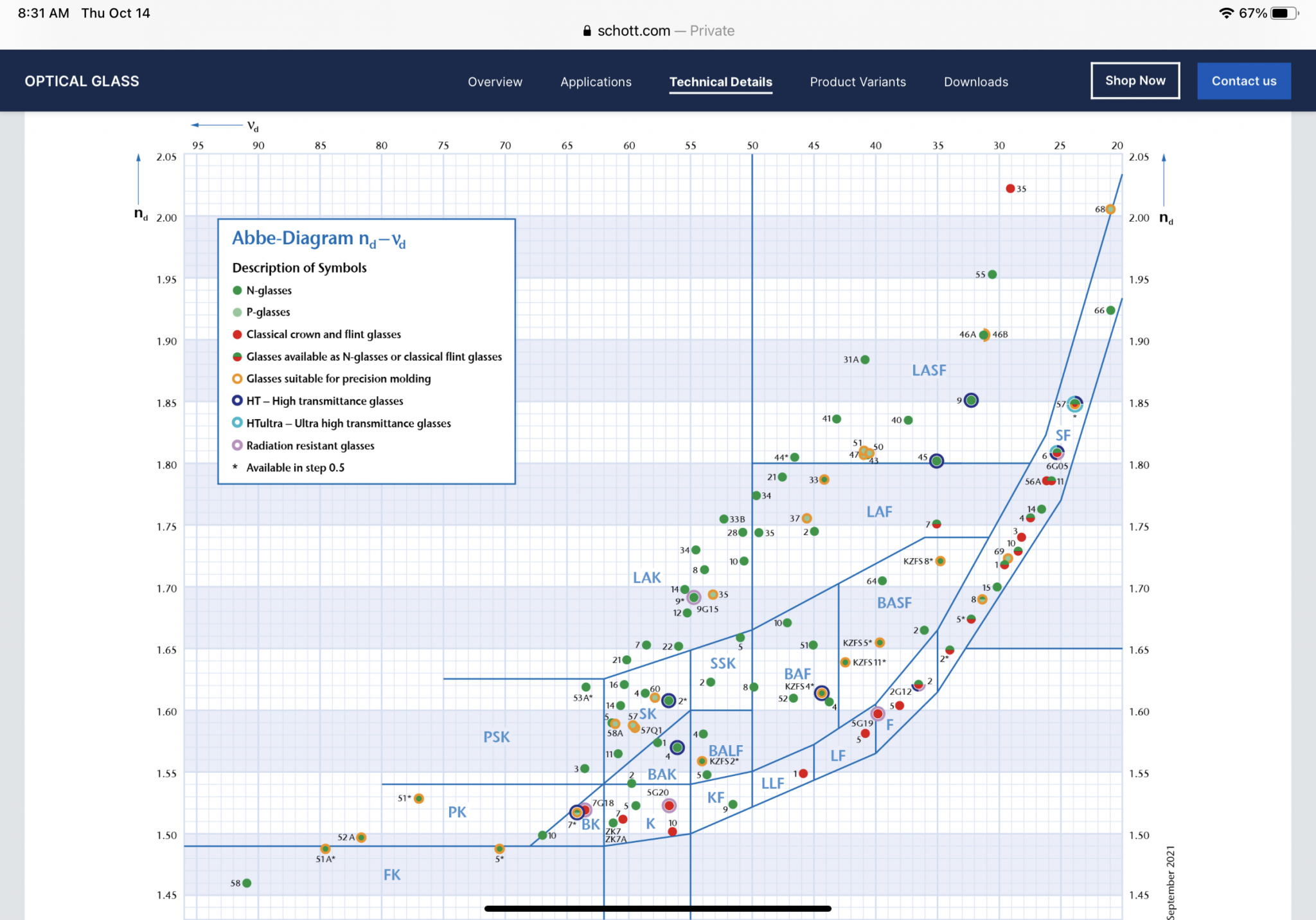

    Researching the ZCO has taken me down some amazing rabbit holes! If you spend any time obsessing about optics, you really need to spend a couple of hours (minimum) on the Schott Glass AG website. It’s amazing to understand the different attributes of optical glass, and the choices that manufactures make for their product lines. BTW…the tier-1 glass typically comes from the upper right quadrant. I’m curious if Zeiss (and others) uses Schott glass for “all“ of the elements in the scope?
    With Zeiss owning Schott, while not impossible, I find it highly improbable that they are using mix-and-match glass in their high-end scopes. I’ve seen stranger things, though. I’m not a betting man, but if I were, I suspect this scope is going to have some of the nicest optical quality on the market. It’s the form and function that may not quite hit their mark.
