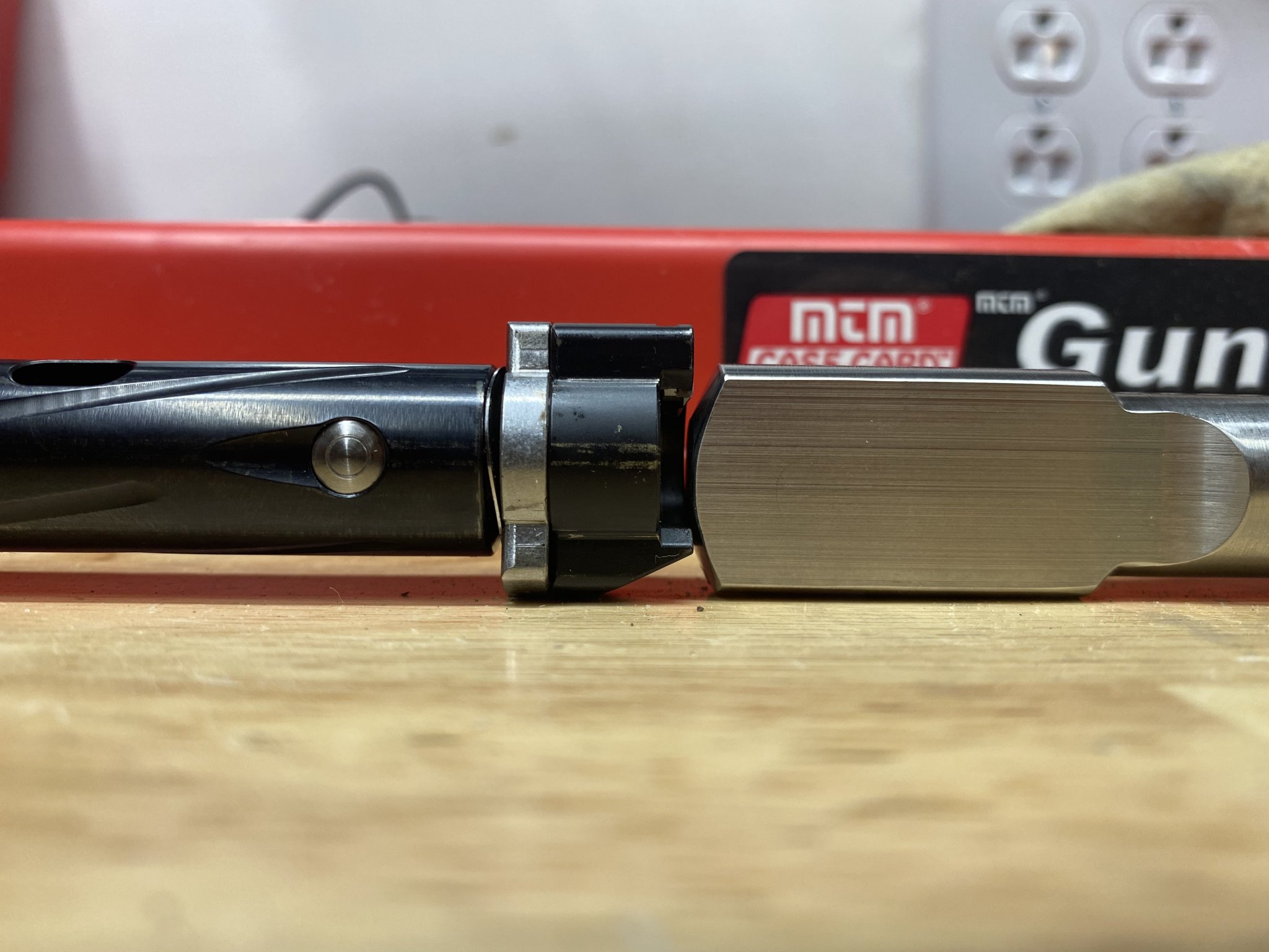

So I got my Rem 700 action wrench today, slot cut out for a Bighorn Origin. Seems like there is excessive play once inserted. The two pictures shows the amount of play, in one photo it’s all the way left and the other it’s all the way to the right. Is this normal? I don’t want to torque anything and risk damaging something.
Here’s a picture at the back of the action, I’m holding the wrench to the far left
Those of you who have a Zermatt, PVA, or bugholes, how does yours fit?
The paddle at the end of the wrench measures a hair over 13/16”
This may be normal I don’t know, this is my first build so I’d rather be safe than sorry

So talked to a guy from Rokslide, his Bugholes wrench is tight, no slop. I’ll call PMA on Monday to see what’s up with this. It’s 3cm smaller than the raceway (is that what it’s called?). Checked it in my Bergara B14 action and the same thing.
This wrench from PMA is advertised for Remington 700 actions. Consequently, one is told that a Rem 700 action wrench will work in a bighorn action or most 700 clones. Either this wrench is way off or a regular Remington action is smaller (I don’t have access to one to find out)
Reactions: RushB
That does look awfully narrow and not as much engagement on both lugs sides as I would hope for myself.
I’d send it back myself. I prefer my external nss.
Anything that’s rem700 footprint should have the same diameter cylinder action and the action bolts match. The other stuff is just close and it seemingly isn’t very good here.
My origins bolt lug diameter is .986, my ptg700 bolt measures .986, my factory 700 bolt measures .988
You got it, there’s no way I would apply torque with that much slop , just asking for trouble.
My Bugholes wrench measures .9725, my Origin bolt measures .984. It's a great fit in the action. Your wrench looks way undersize and I wouldn't use it.
Reactions: justpassingthru
