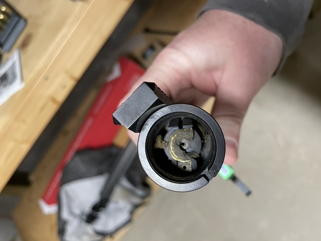

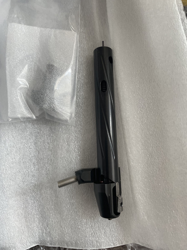

It was a beautiful sunny day in Alabama. While engaging a 1200 yard target with the most prefect 90 degree trigger press you have ever seen, a louder then normal boom went off. “IMPACT” belted from the RO. In my head, I knew something was not right. I proceeded to clear the rifle only to find a very heavy bolt. After a couple of taps, the bolt came free and fell complete out of the rifle! Oh, what a day my friends!

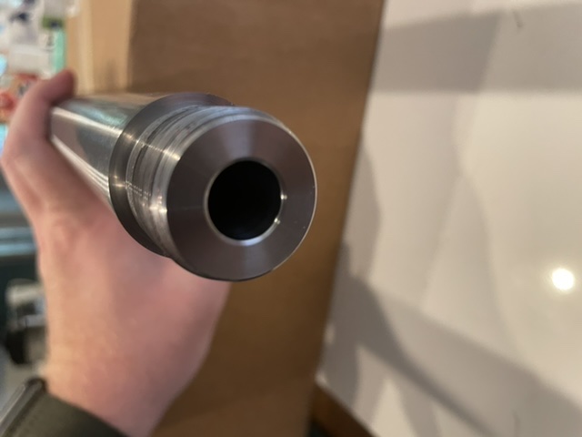

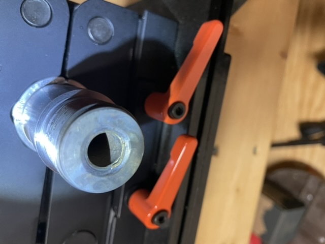

While I’m not completely ruling out an overcharge on my part, I do find it weird that I had a hit at 1200 yards when it happened. I would imagine an overcharge to send my bullet any where but the target. I was using premium brass on its third firing so I didn’t suspect any issues there. After talking to a couple of smiths, they believed the chamfering on the chamber was cut too large which left the case unsupported and lead to case head separation. Edit: after further investigation, it’s seems the Alpha GT non OCD brass more at fault with thin web and soft brass.

Old camber (brass still in chamber) vs new
What kind of barrel vise is that ?
What he’s getting at is that its possible to over anneal the necks. The heat conducts into the web, which anneals it as well.
I think your kaboom barrel has way too much chamfer. Hard to tell what the angle is from a pic, or how much clearance the breech face had from the bolt nose. If the tenon was short(lots of clearance), that would only add the problems if the chamfer was too large.

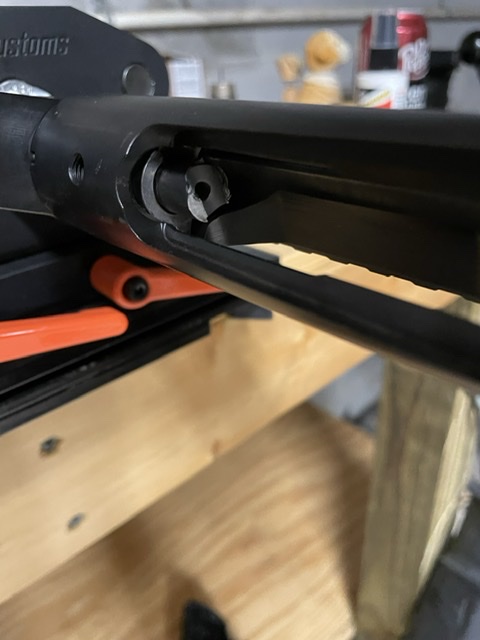

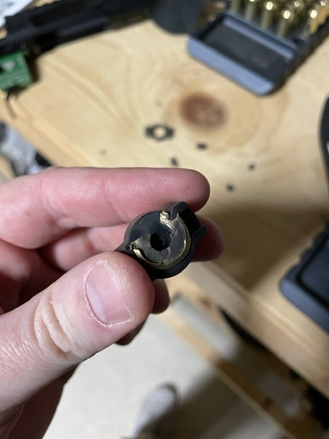

Why did the bolt fail at the cross-pin? Isn't that an unloaded item during firing unless the bolt lugs displaced the engaging surfaces on the receiver? Or did it break because of the force required to unlock the bolt?
High pressure gas once the primer says "buh bye!"
Interesting, is that from the gas traveling down the firing pin hole? Aside from it kinda being a fluke I’m not sure why the bolt head failed where it did.

No it happens often enough when you obliterate the primer on a full house (or bonus pressure) load. The firing pin becomes a plunger and flies backwards at mach Christ under pressure from said gas until it bottoms out, and the abrupt stop overloads the thin portion of the bolt head which is at that point the glue holding everything together between the bolt lugs and the now rearward pushing firing pin.
It's hard to tell if the chamfer is "too large" from a pic like that. Depending on the cartridge, angle of the chamfer, and actual depth of the chamfer, the case may or may not have been well supported.
I have some barrels with pretty wide chamfers that still have full support of the case web.
The lugs did there job containing the explosion and while the pressure is released via the ports. My guess is the energy traveled down the bolt head and broke at the weakest point with the thinnest material.

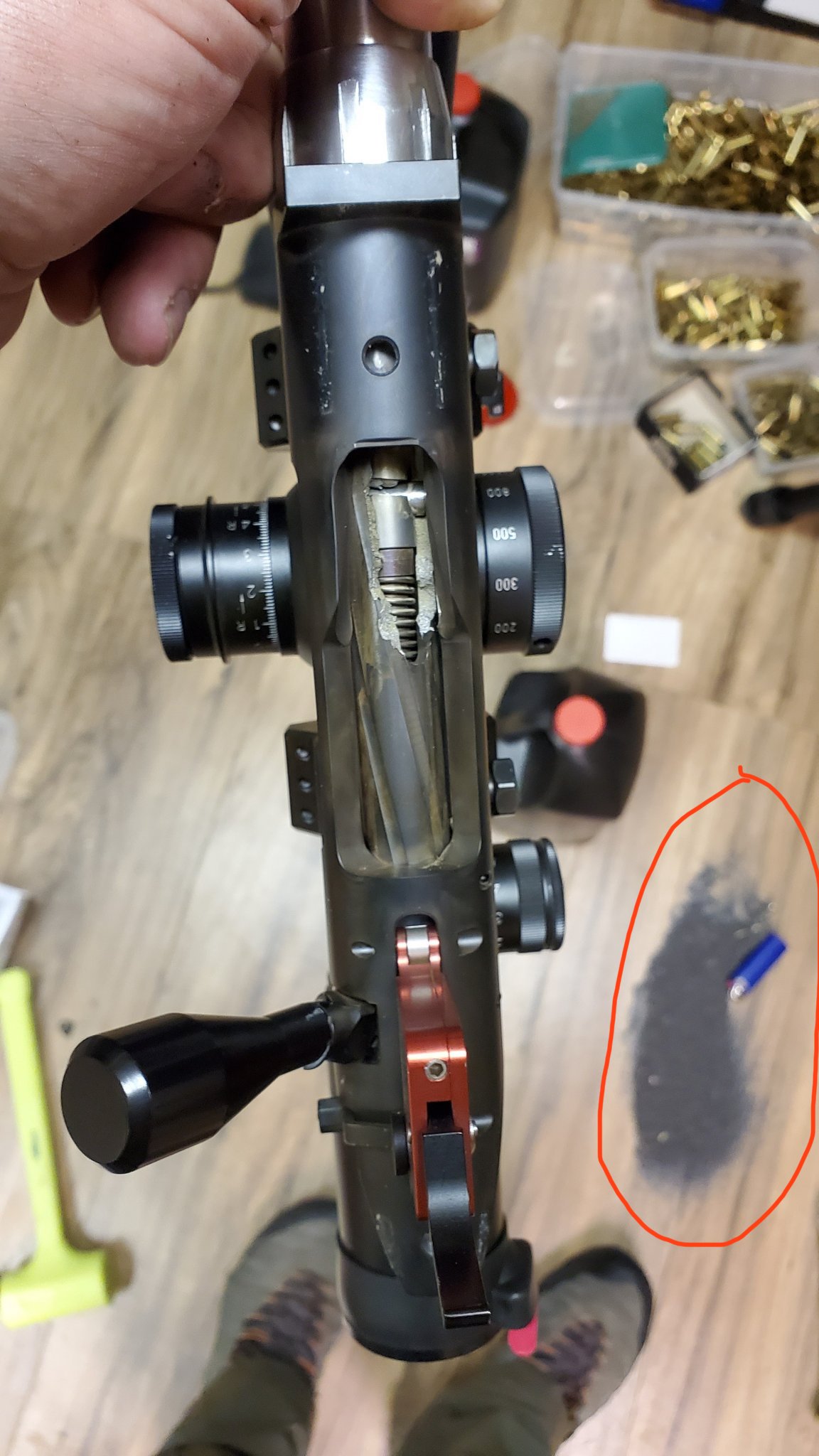

Completely agree. I only knew there was an issue as it was louder than normal with a suppressor. I probably would’ve never known until I lifted the bolt with a brake.
Like a champ. No damage to the scope, trigger, or chassis. That action is locked up like a bank vault. The barrel is a CF. It was setback and shoots fine. That was the very first round down it. I mixed up AA#7 and Ramshot TAC loading 6.5 Grendel. 28gr of Accurate#7 in a Grendel....
Dang. Any idea what kind of pressure that would be?
Knocked the bolt stop flying, damn near sheared the bolt handle.... You won the lottery that day my friend.
