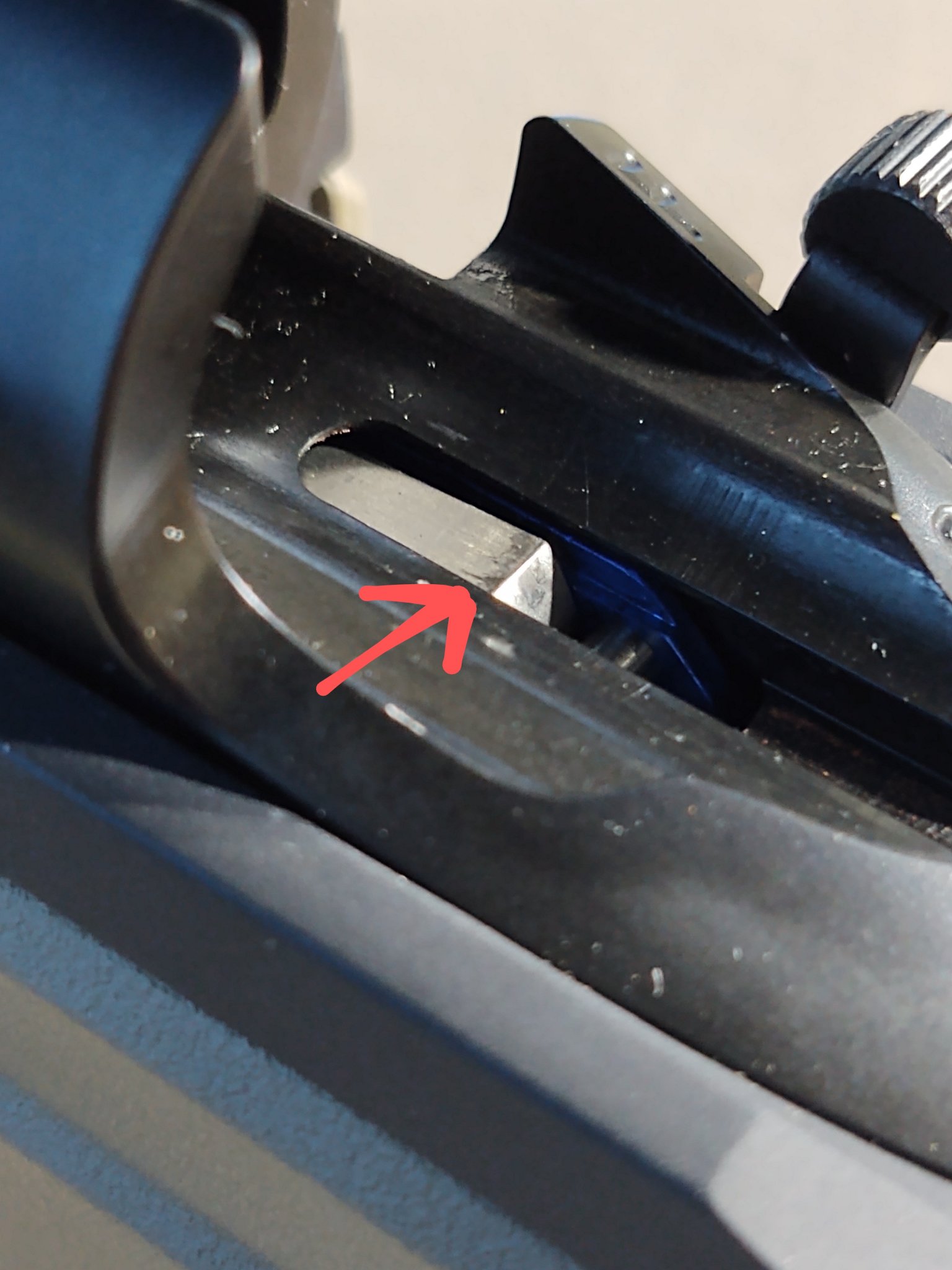

    If you look on the inside of the plates when you manually push the sear down, you'll likely see some rub marks where the cocking piece is dragging. I've noticed this a few times with the trigger techs now.

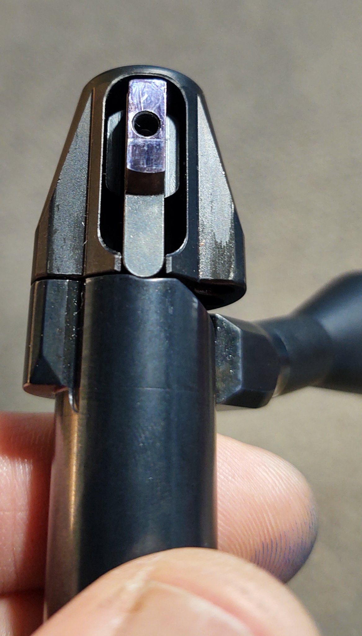

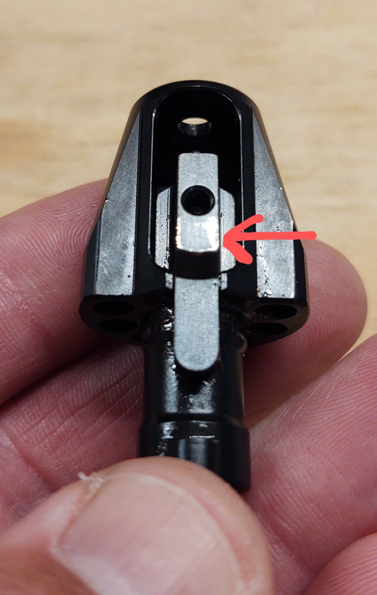

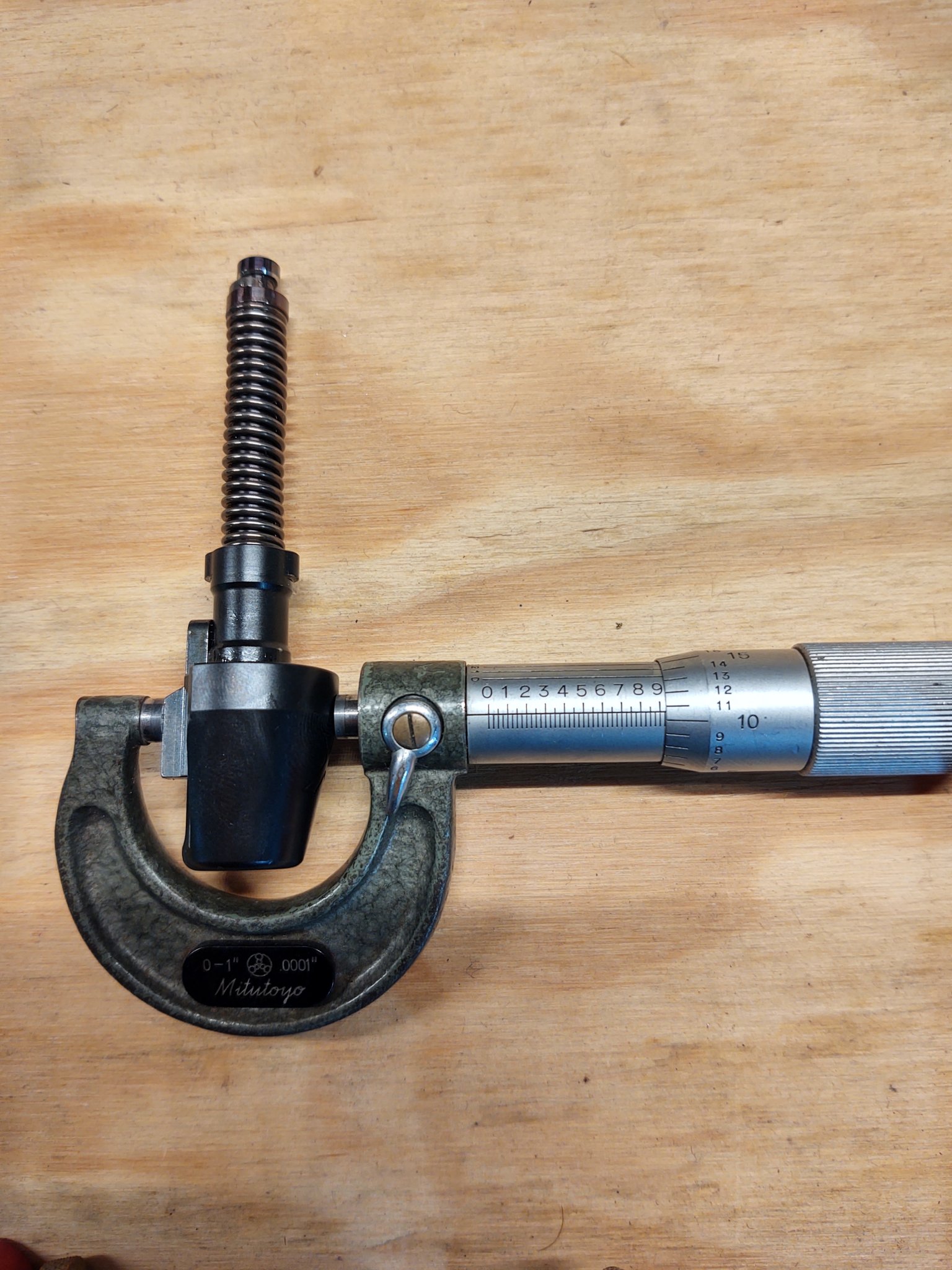

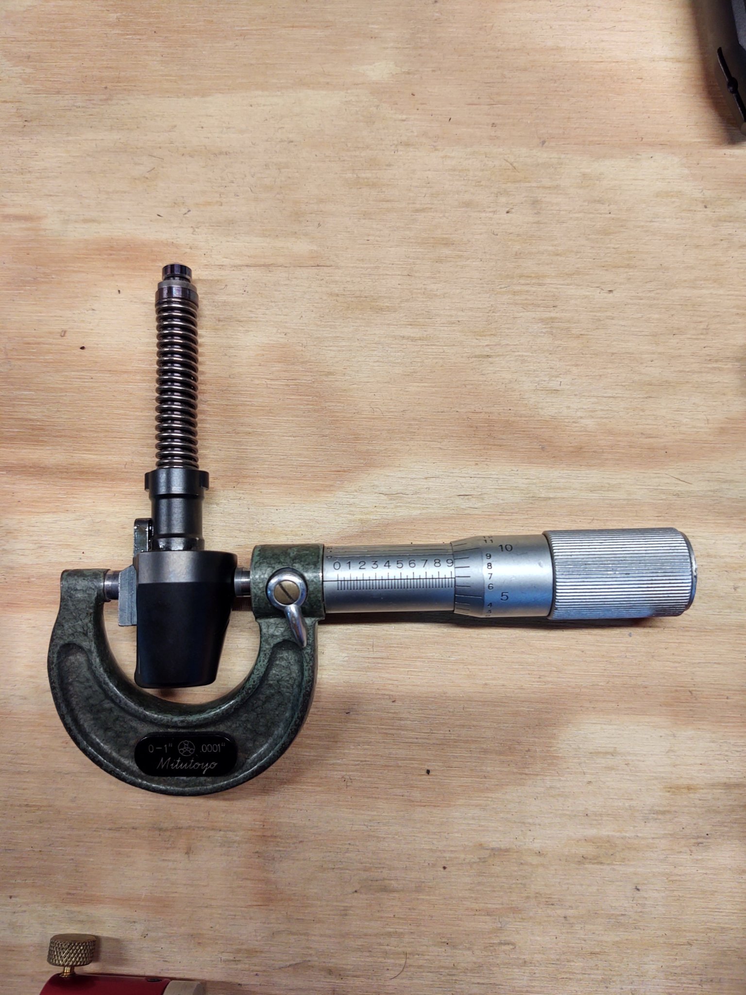

    I started down the road of fitting the trigger to the action today. First I measured the current cocking piece height to the top of the shroud directly adjacent from the cocking piece (using the fixed anvil of my mic and the round portion of the cocking piece as a reference, to be repeatable).
    First measurement before starting:
    Witness marks of dragging on the sear:

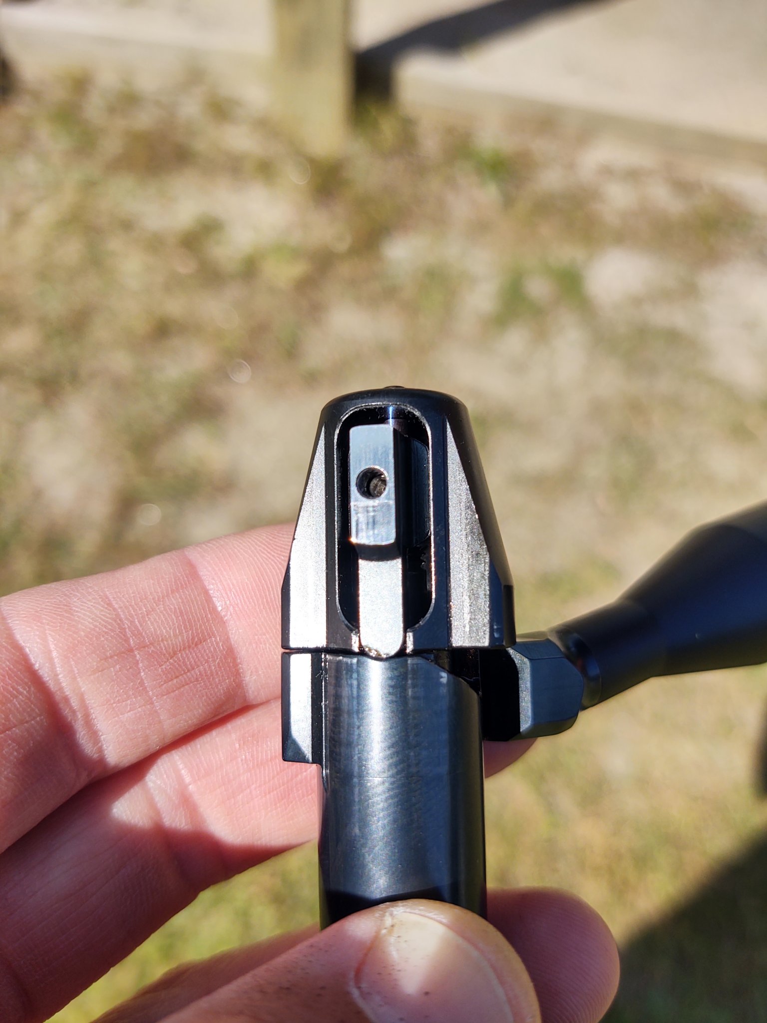

    Witness marks on the cocking piece:

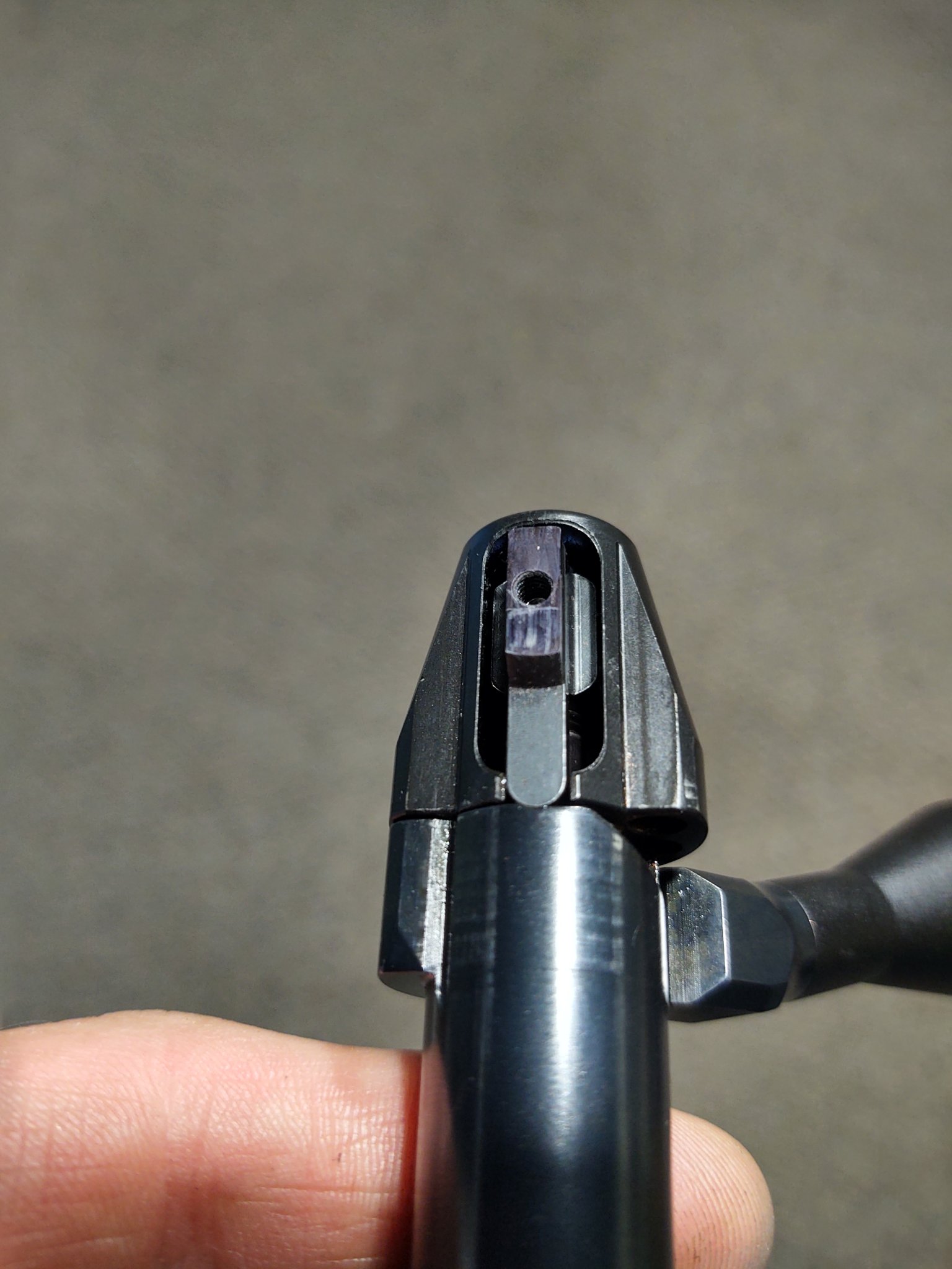

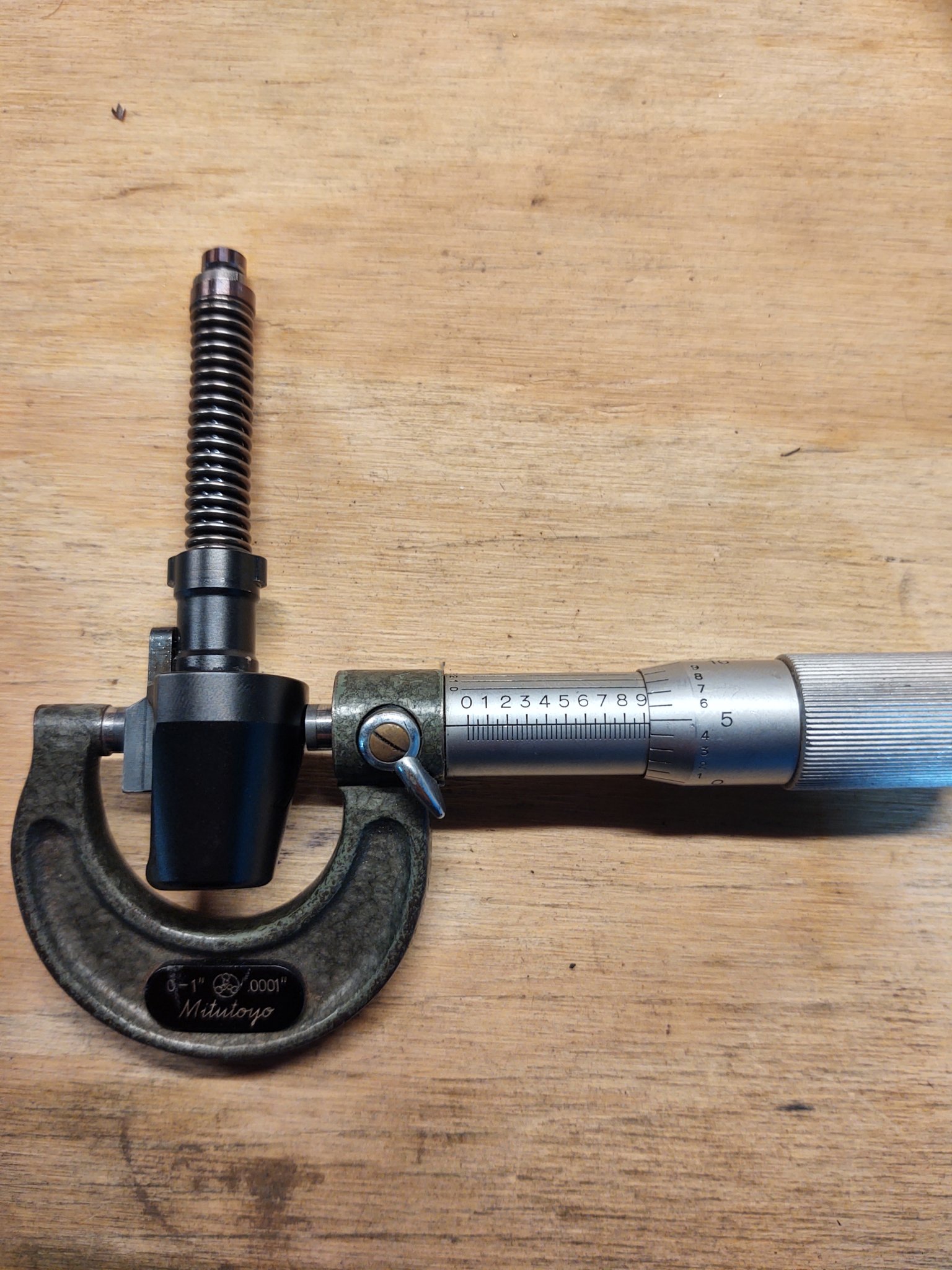

    First round of fitting, honing the cocking piece on a flat diamond stone:
    Testing the fit using a sharpie and a few dry firing, still dragging:
    Remove a bit more:
    Still too much contact:
    Removing a little more:
    Looking pretty good:
    We went to the range and put 160 rounds through it with no FTF! There bolt lift and close was much easier, not as easy as the Vudoo but much better! The accuracy seems pretty good but after 160 rounds I think there is a little room for improvement, still slightly dragging (it was polished to a mirror finish on my ceramic stone, you can clearly see the witness marks):

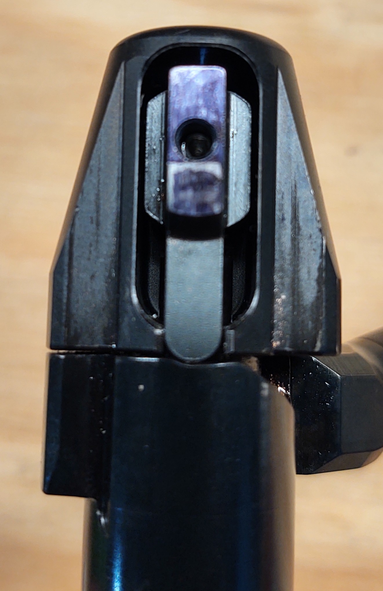

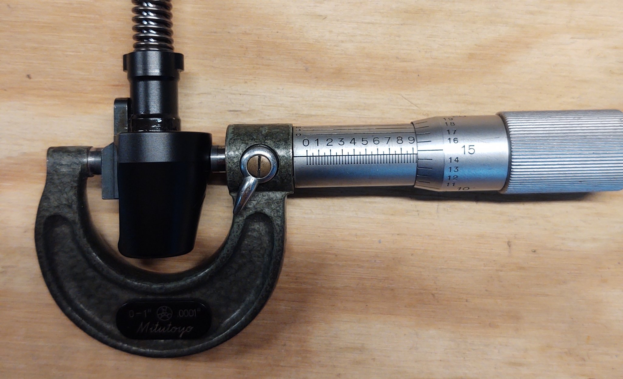

    Will I think I'm finally happy with it. I too a bit more off the cocking piece last night for a total of about 0.010"
    I check it with ink and it looked pretty good only very slight contact not enough to remove the ink.
    We put another 150 rounds through it today and had no FTF. Here is the witness marks after the 150 today:

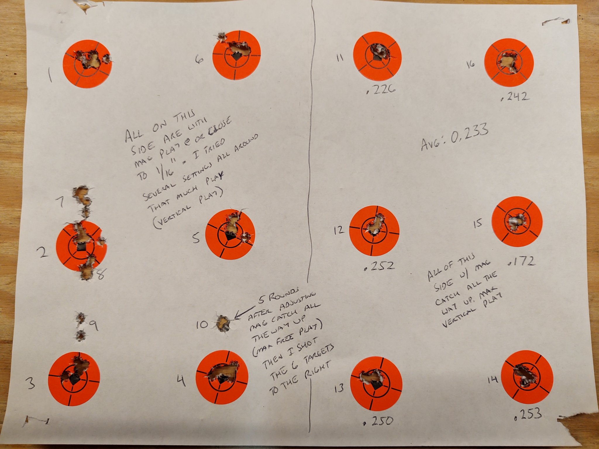

    So I wanted to circle back around to this now that my daughter has put a few hundred more rounds through the rifle to report that there has been no more failure to fire. So that is resolved.
    However I have been seeing some inconsistencies with the accuracy, both with my daughters shooting and with me shooting. I was able to get a fairly calm day to do some troubleshooting. It turns out the magazine height is both very sensitive and very critical (the last part being an obvious statement). What I am finding strange is that I have to adjust the magazine to the lowest possible position for the fliers to go away. But then occasionally it will not pick up a round from the magazine. I have tried it at the 1/16” of vertical play, absolutely no play (adjusted so heigh the magazine just barely locks in) and all in between. If I don’t have the magazine all the way down the bolt will either dent the case in the magazine as it slides over it, and or shave some of the bullet off or the bullet will not go cleanly into the chamber. I can feel it when it gets a little hung up dragging going in and you can see the round POI shift from the group. I spent a lot of time making the most minute adjustments but I don’t think it is perfect just yet. I am going to bring a different chassis next trip to the range. Here are the targets with some notes so you can see the flyers and accuracy gin or loss I am talking about.
    Reactions: deltawiskey
    Very interesting results jbell - I've not played with the mag catch adjustment much since going with the minimum amount of play that would still afford easy latching of mags in the Hawkins DBM in a Manners PRS1T stock. I've pulled the Bartlein bbl that I fitted & chambered twice to address mistakes made during the initial chambering, all of which could've been easily avoided if I'd had more information concerning the headspace gauge that ships with the action. And each time, the work done improved groups' size & consistency. However, at this point, my two V-22s (oldest one is in the 10XX S/N range, I did the bbl work on a Krieger sendero blankw/EPS reamer; the newer one S/N 17xx, purchased as a bbl'd action with Bartlein Kukri chambered by VGW with Ravage reamer) both feed smoother than the RimX, and shoot slightly smaller & more consistent groups. I've never asked Mike Bush for info on his Ravage reamer, but since the newer of the two V-22s feeds consistently smoother than the 1st one that I used the EPS reamer on, I'm going to assume the Ravage reamer has some taper from rear to front, perhaps as much as the Win M52D Match reamer. To that end, I've purchased a M52D Match reamer from JGS, and intend to pull the Bartlein off the RimX - again - to set it back .050" and then use the M52D reamer to modify the existing EPS chamber. I've kept several of your Snipers Hide 6x5 Rimfire Challenge targets fired in very good conditions with the Bartlein/EPS chamber, so if I can get comparison shooting done with the same lots of SK & Lapua ammo on days with good conditions after using the 52D Match reamer, I'm hoping to have a valid comparison of the two chambers on the same bbl in the same action.
    Of course, it'd be great if I had time to get out and do the comparison you've done to see if different mag catch heights have as marked an effect on group sizes in my rifle as they did in yours, but I'm still working at drilling our winter wheat crop, and will probably swing right on into fall harvest as soon as that's done. Just no time to get the shooting necessary done before temps drop-off as we move closer to winter.... If only I could be lucky enough to snag a decent lottery jackpot, I'd build a nice, fully equipped indoor or underground testing range, and could then get all this sort of shooting done without time & weather constraints....
    Reactions: Hi-Wall and jbell
    I was shocked to see how much a difference in accuracy a small amount of magazine height made. You can feel it in the bolt when chambering a round.
    I find it interesting that the 20+ different magazines I have used in 3 different V-22 barreled actions with 4 different trigger manufactures and I think 4 different chassis / stock bottom metal configurations shooting at least 8 maybe 10 different ammunition there hasn't been one reason to make a change or modification to any of it (other than a rifle shooting X ammo better than Y and).
    I know I'm only dealing with a sample size of 1 with the RimX but I'm starting to think there may be some solutions looking for problems.
    **This is not a dig on the RimX, it's designers, or the company, nor is it a Vudoo vs RimX statement. It's just my thoughts in general. I absolutely acknowledge the design work and innovative thinking that has gone into the RimX, but I question it's validity. Again sample size of 1...
    If any of y'all were around in the Scout days maybe you remember the Stiller 2500XR struggles I had. That was rough!
    Those are some nice groups. The rounds that "felt funny" when feeding, did they all feel that way at the same point in the feed process or did you notice it?
