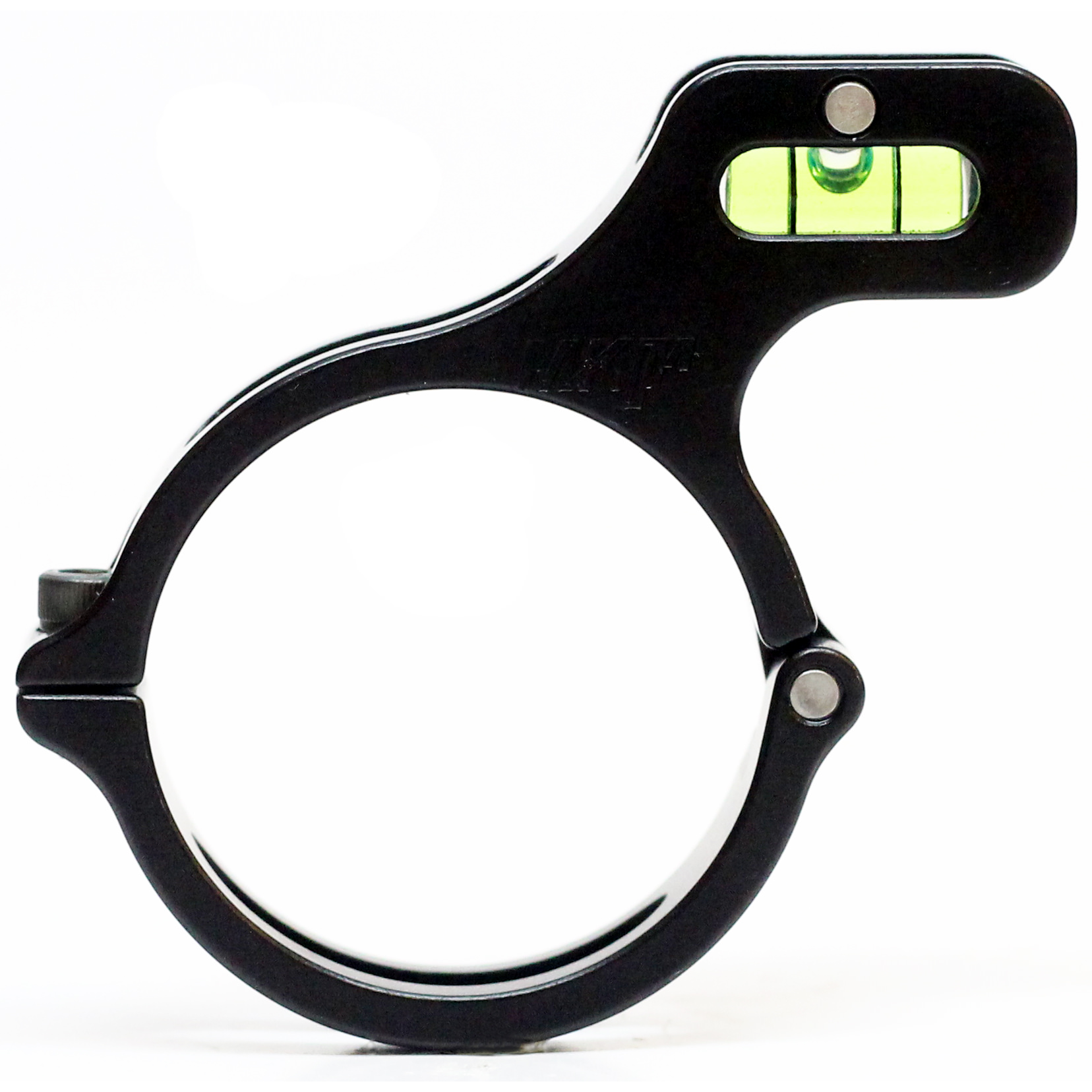

    Consider stocking our 36mm Levels for these scopes too, better price than competitors and excellent function:

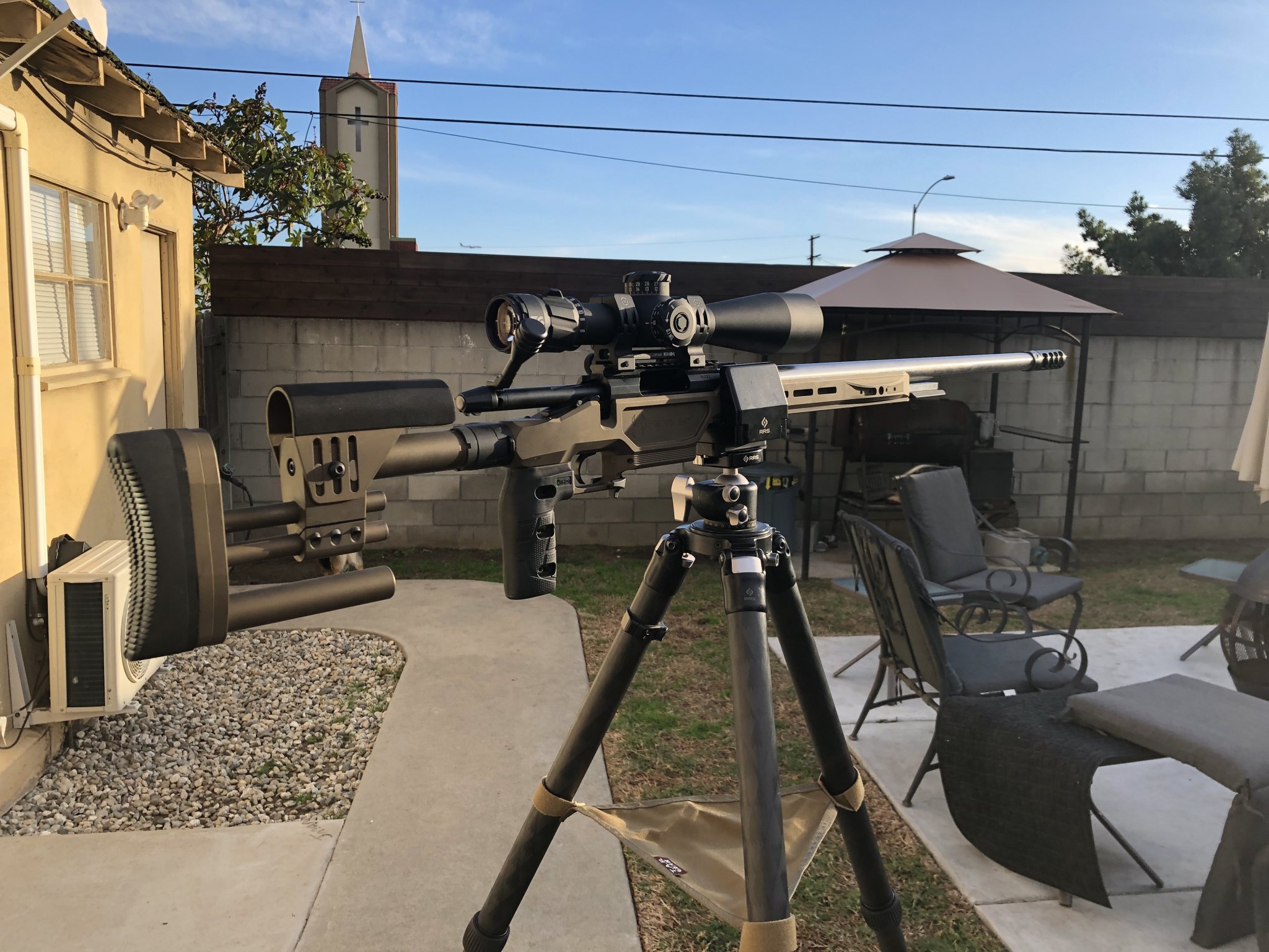

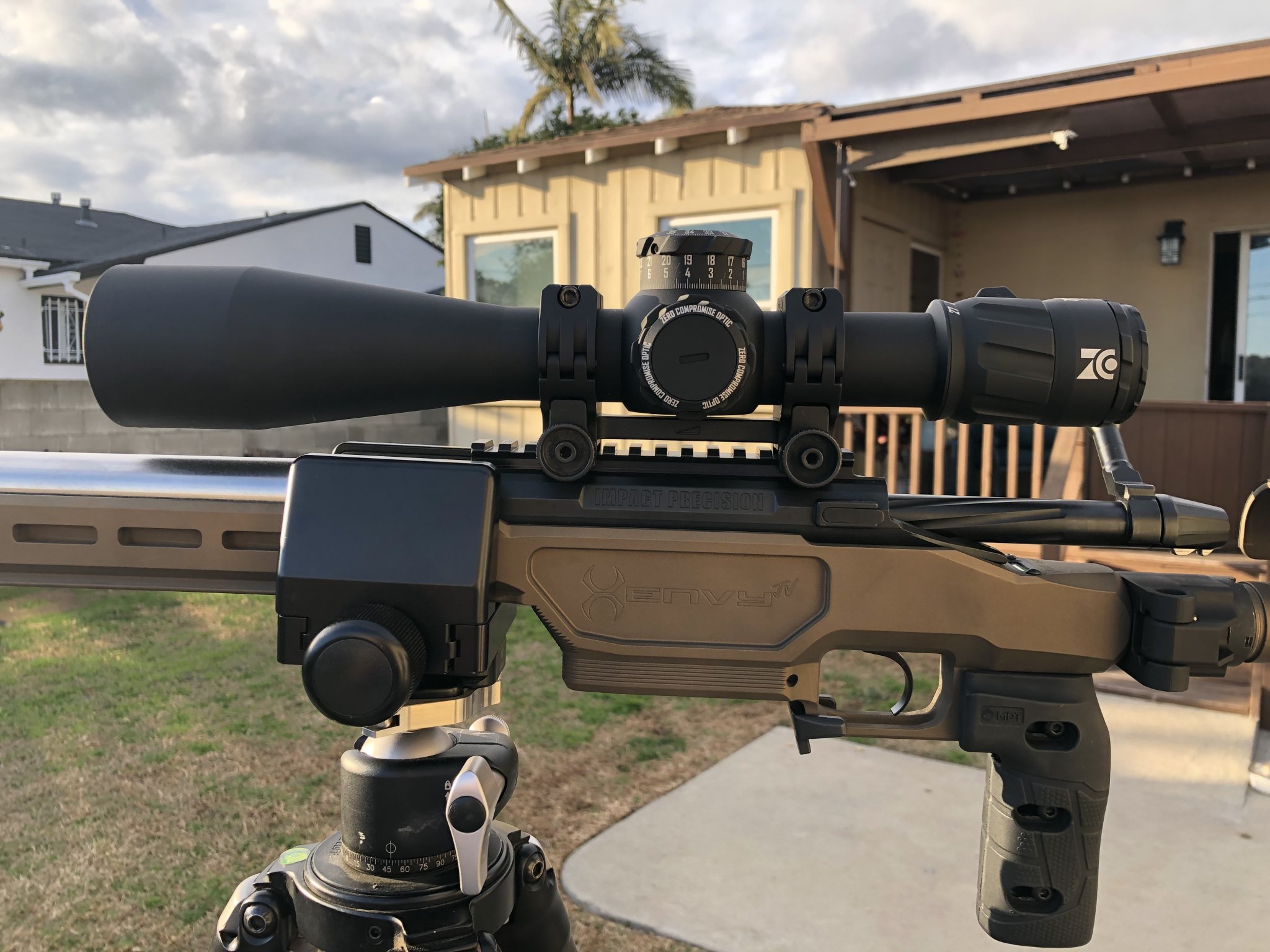

    FYI, I have a 1.5” 0 moa spuhr on my zco.
    It’s on an AI-AT with the low scope rail.
    I have just over 23mils of elevation left after zero’ing.
    Yup that's about what I figured would be left. We need a 6 mil Spuhr to get out to 2k
