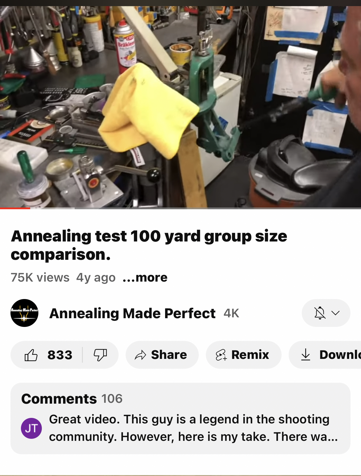

Lou may use a Zero now a days. However in this video he’s using a little rcbs press to size. Point being I don’t think op will gain anything by moving to a t7 or a zero. Rcbs presses for sizing and arbor presses for seating seam to be a pretty common for Benchrest. Maybe an arbor press for seating would be a better investment than a new press. I use a MEC with the floating shellholder to size and seat using an arbor press myself.

Lou Murdica uses a zero press. Does he need to? No. But will it load ammo up to his standards? Yes.

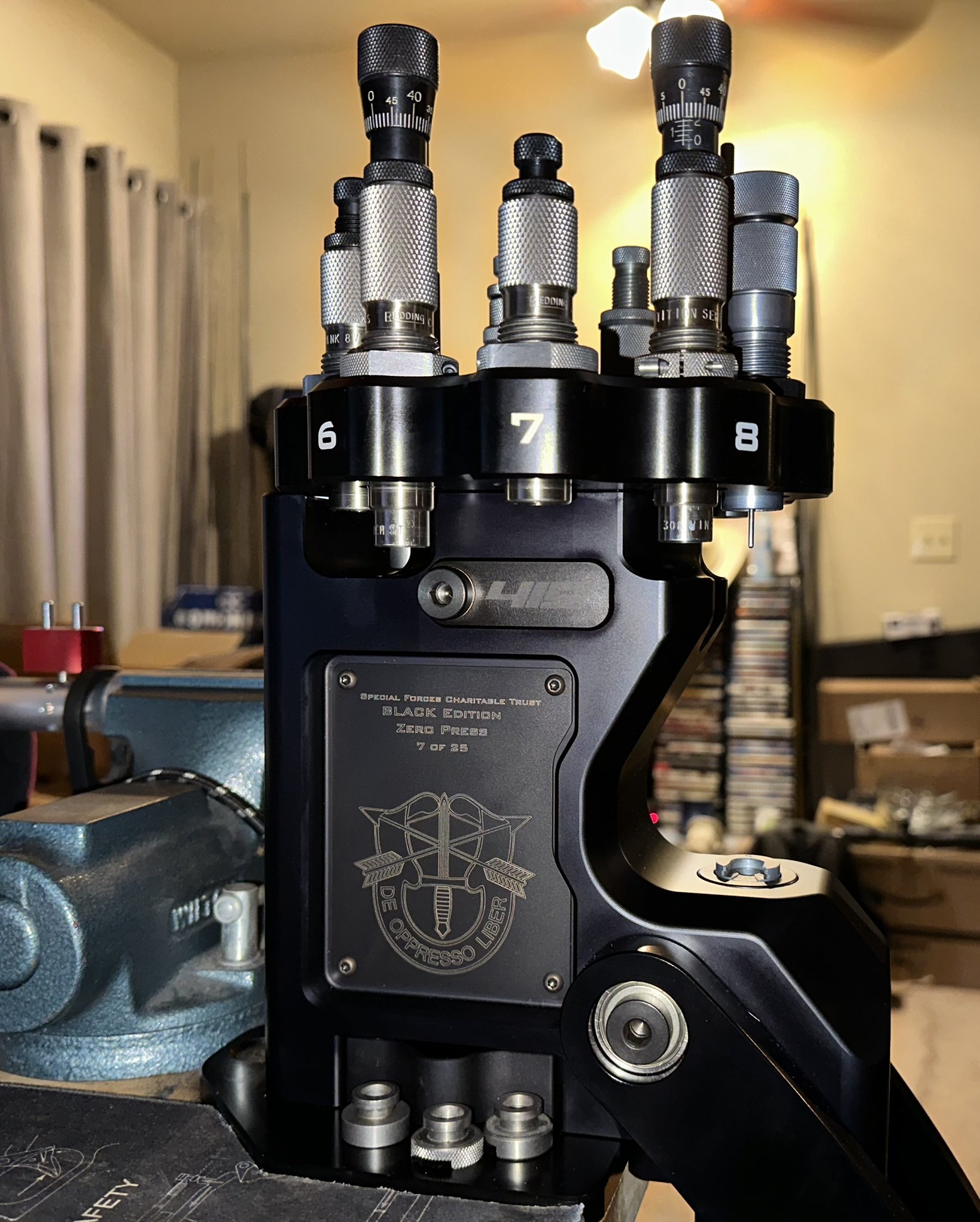

I currently have a T7, but have a Zero on order. I like the T7 a lot and I feel it makes quality ammo. I dislike the way it catches (or doesn’t) spent primers, and this causes it to need to be cleaned frequently, but other than that it’s been solid. I’m giving the T7 to one of my employees as a gift and treating myself to the Zero.

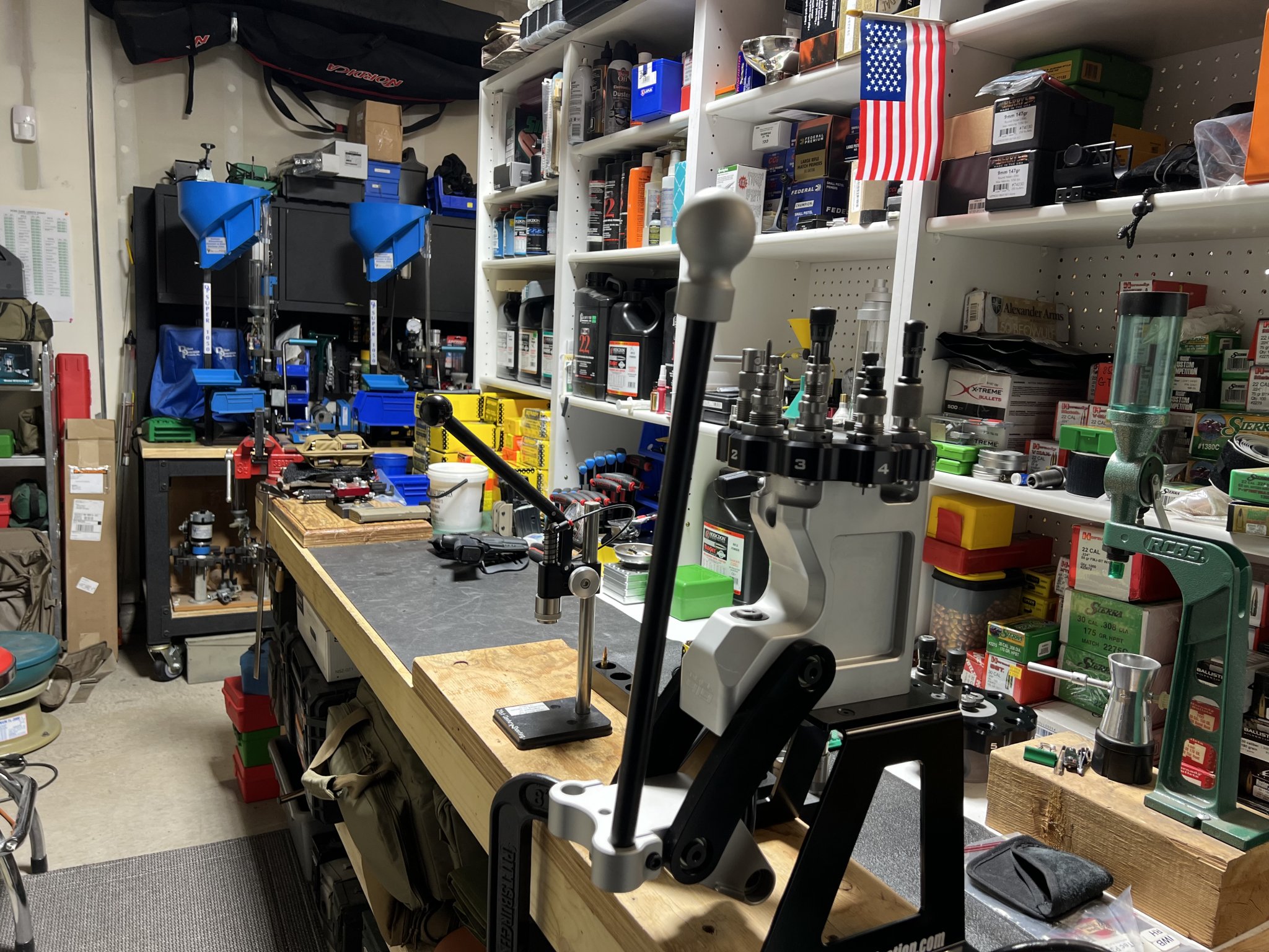

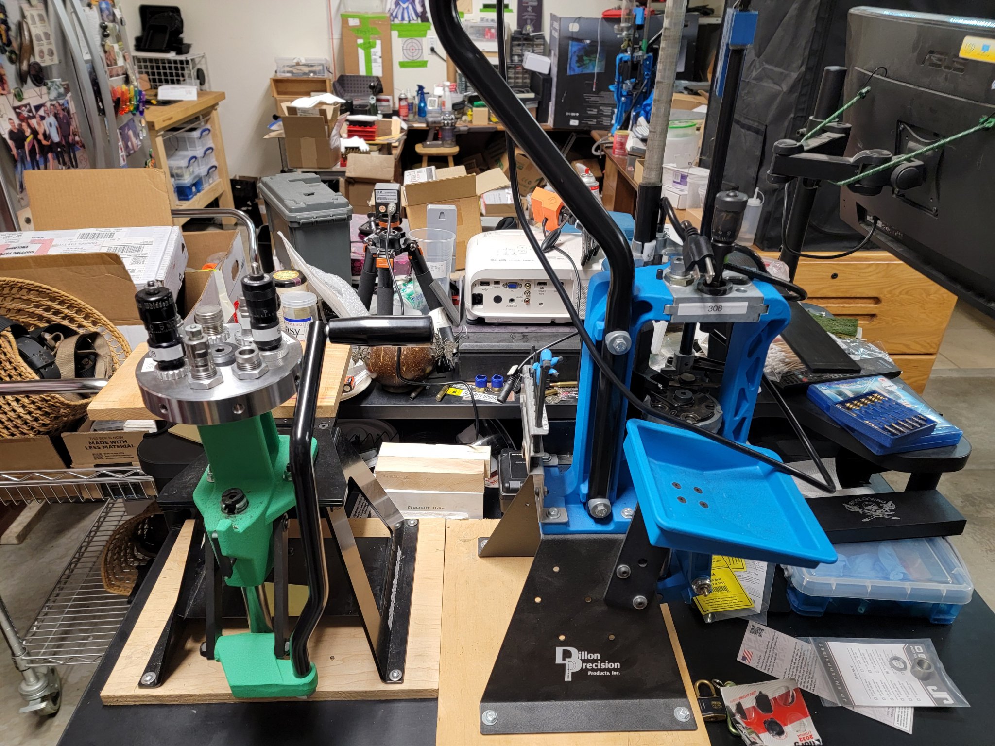

I'm still somewhat new to handloading - I went from progresive to handloading on a 650 to a T7 with the creedmoor head and inline mount/handle - I love it, using norma brass and berger hybrid bullets it make some nice ~.5 MOA ammo for my man bun gun 🙂
